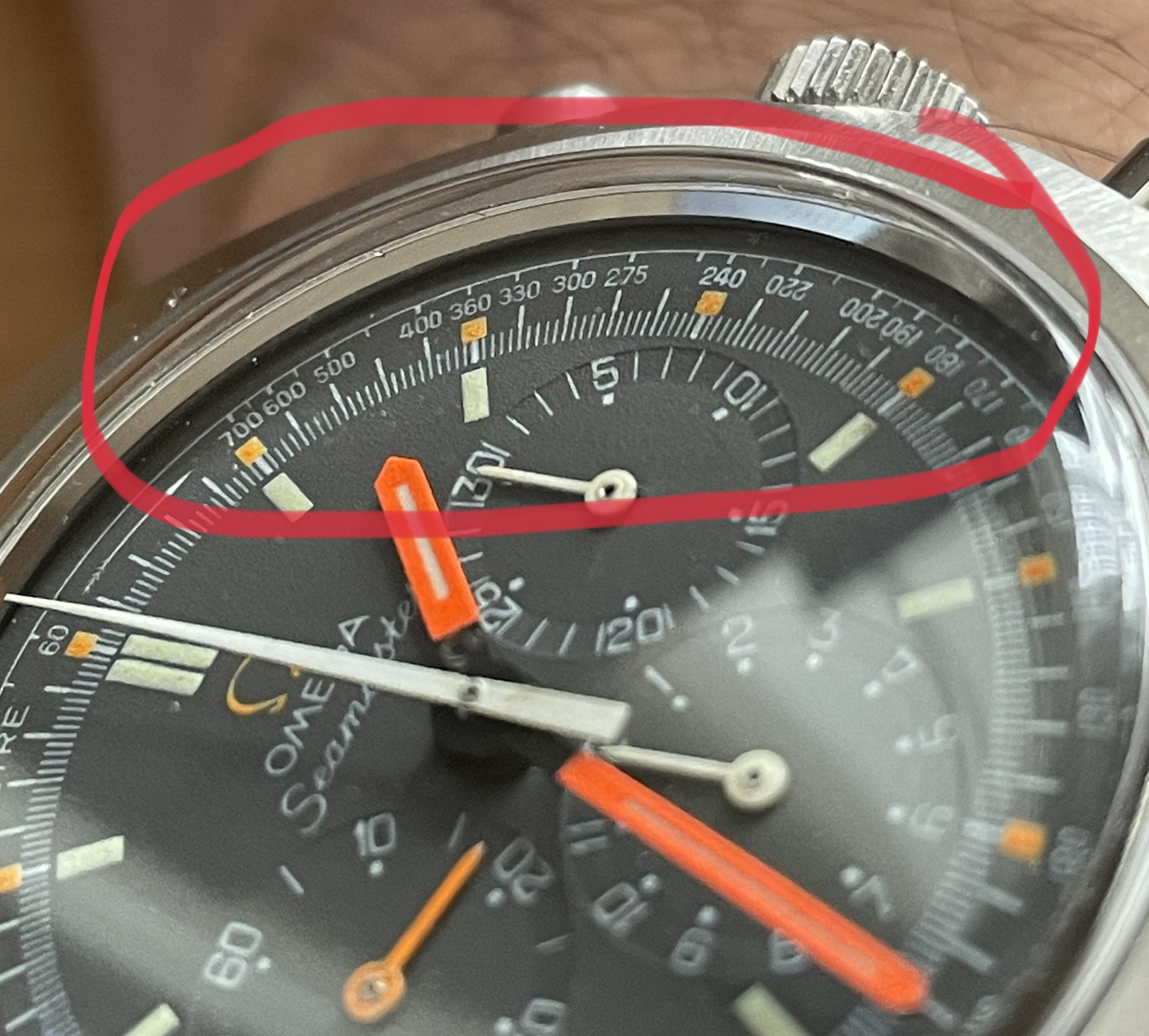

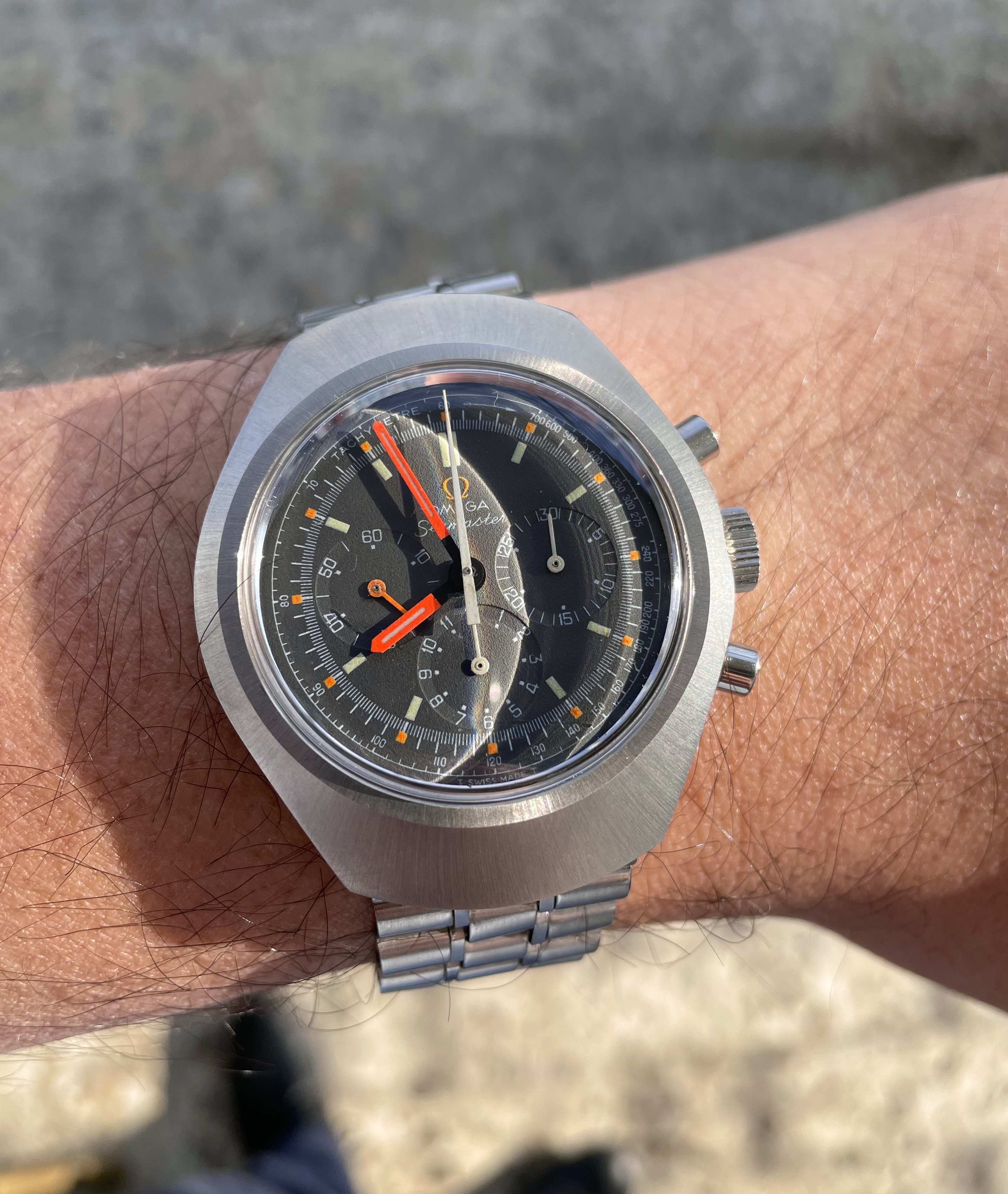

Hi! 2nd advice appreciated this time:
While wearing the watch some days, it somehow looked different than before. After having a closer look I realized there is a gap between the dial and the tension/compression ring which other same refs. doesn’t have that strong. Call me a nitpicker, but somehow it changes the appearance of the watch in my opinion making the dial look as it would sit too deep in the watch.
Unfortunately I don’t have sufficient pictures of the watch before I gave it to STS to have it case refurbished. The local watchmaker who put the movement back together (see above) didn’t knew the reason as he is not very familiar with Omega, but meant the reason could be the crystal not being pushed down enough? Any thoughts? Again thanks for your help!

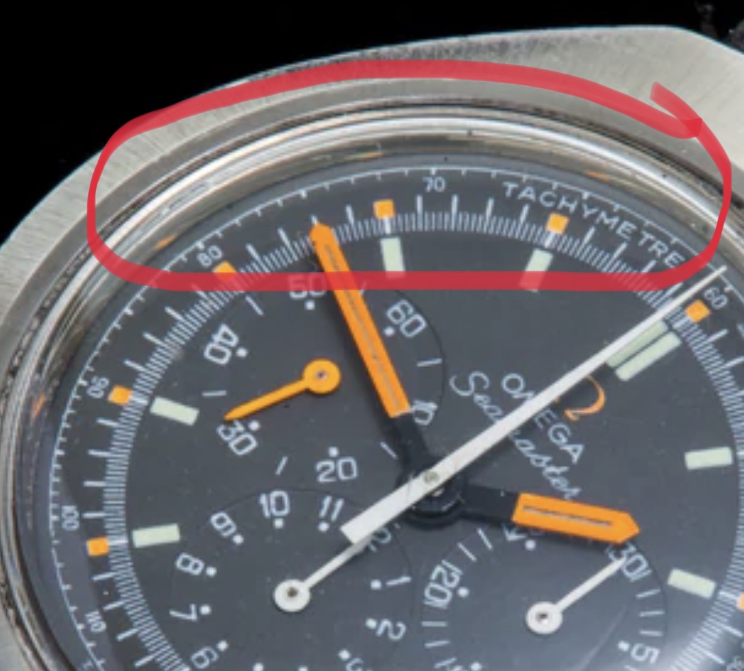

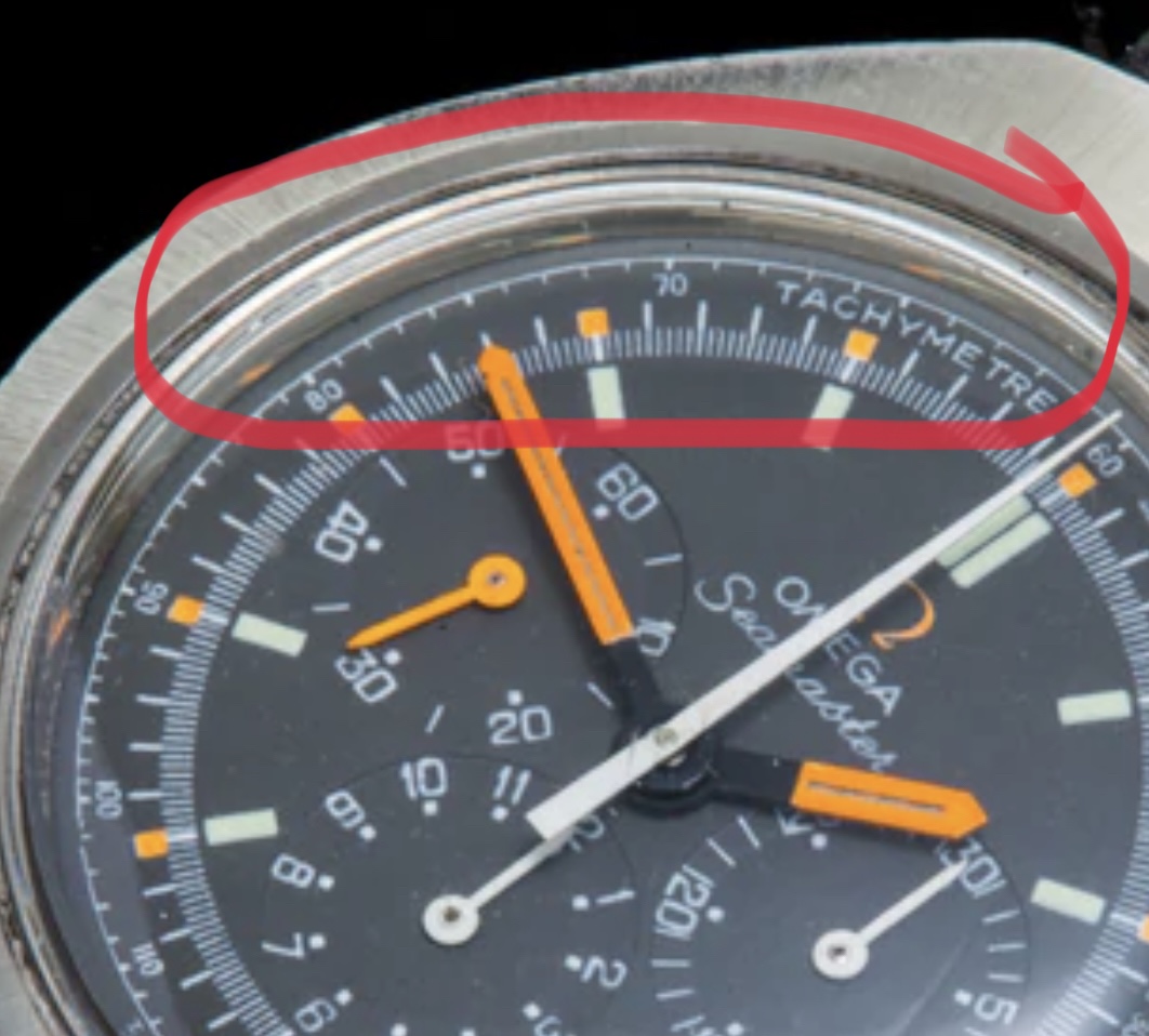

Here a sample of different 145.024

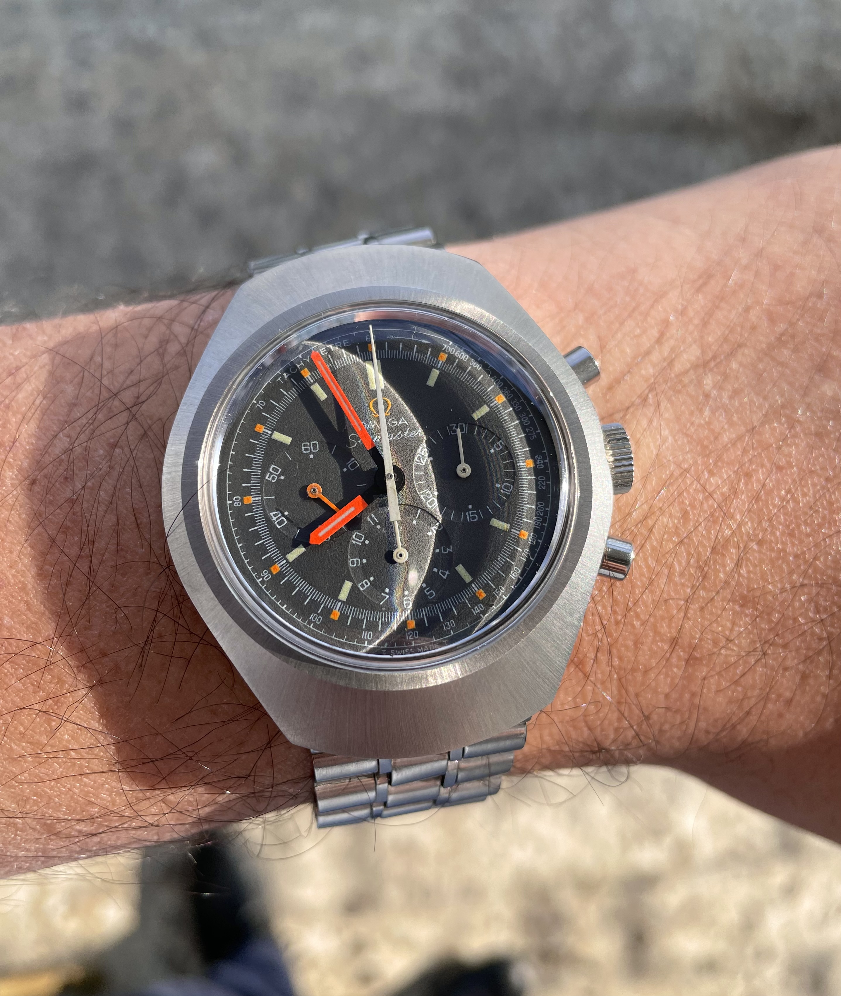

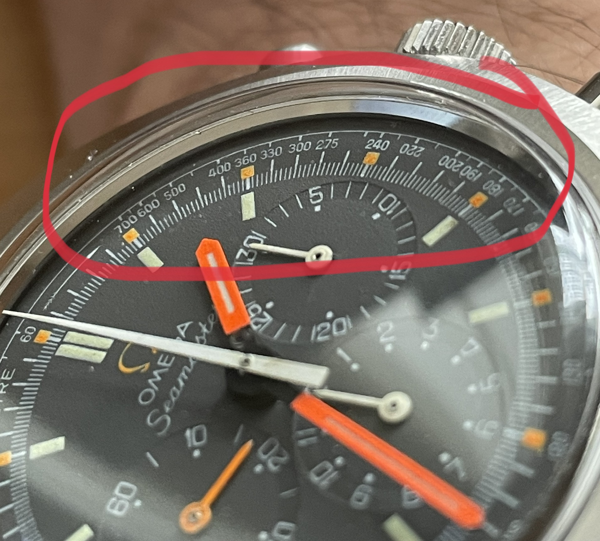

And mine

Well, that certainly doesn't look right. Youi will need to get it to a watchmaker who can look at it and figure out what the problem is...
