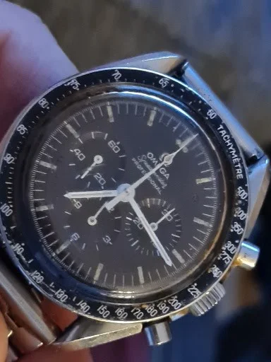

Hello everyone, I have become the heir of an Omega and did not know the value of it. My best friend, however, shook me awake and recommended me to repair the watch.
I have found a renowned master watchmaker that repairs historical watches and he has made me an offer.He is Omega Certified.
Since the watch is not functional and has never received any maintenance, I would like to have one carried out.
A potentially negative point is that the dial was repaired once because the dial feet were broken, which is what you from the front
Unfortunately, can recognize.
It is an Omega Speedmaster Professional , serial number: 2963XXXX
145.022-69, DON Bezel, Tropical Dial
He now proposes the following :

My question is not about me that I distrust the watchmaker but I want to know what is meaningful to let do . The research on speedmaster 101 has unsettled me even more. A watch that possibly loses the patina and thus its collector's value would be the horror for me. I just don't know anything about it!
Unfortunately, I don't have any other photos at the moment.

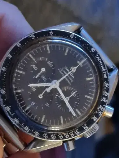

The movement service sounds standard and a good idea.
I would skip the “Optical repair” part as that is where you can easily lose the vintage appeal and value of your watch.
Your photos are not focused and it’s difficult to see dial details.
3
Thanks for the tip. Unfortunately, I don’t have any other pictures since the watch is already at the watchmaker’s.

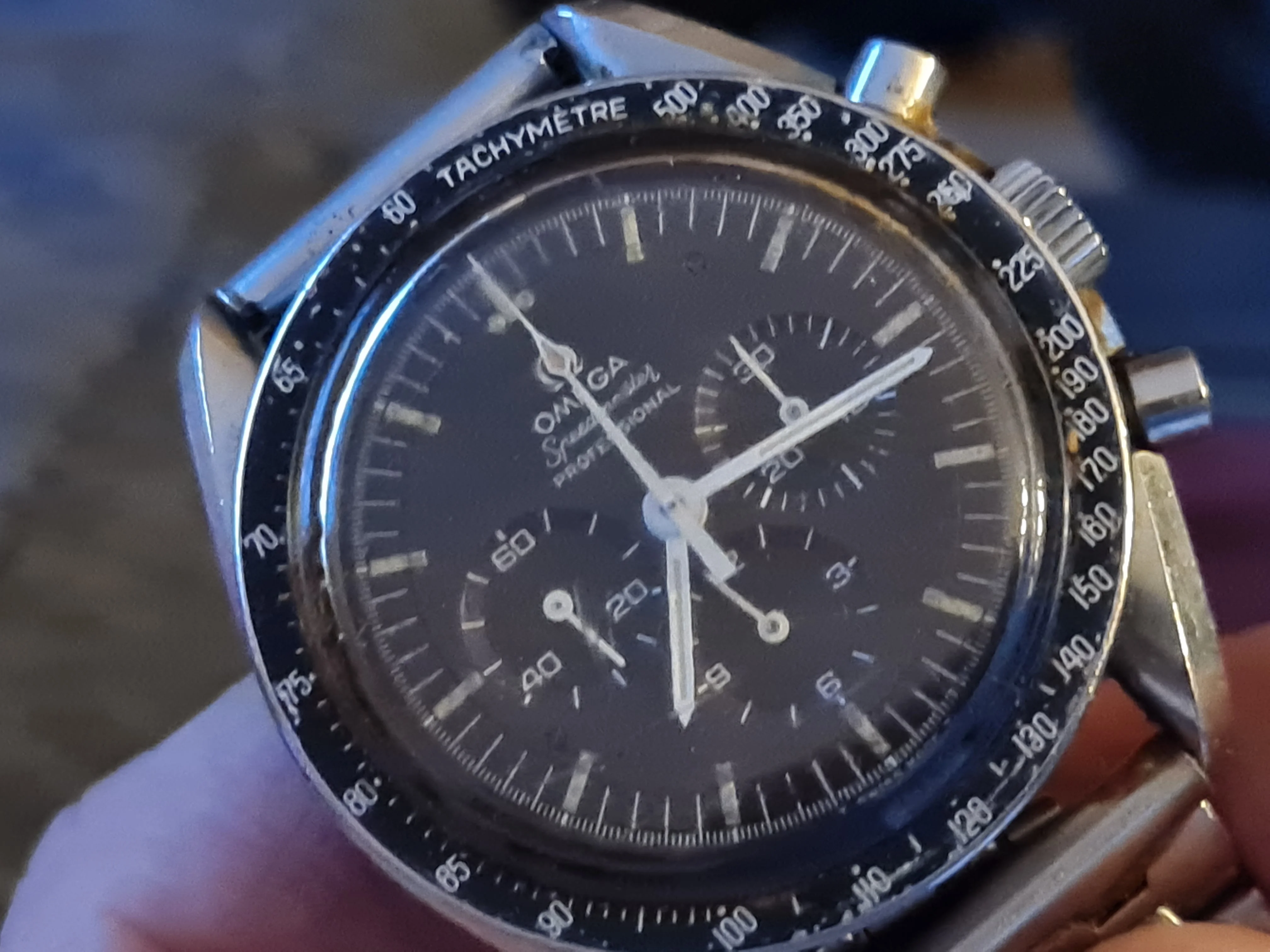

Hello and welcome!
Absolutely get it serviced.
I also would recommend not doing anything listed under "optical". You can also source another mid-case that has better shape and keep your original one.
One thing you will want to do is get the incorrect service hands replaced with correct hands.
If you can I would get the new service hands re-lumed with a lume color/patina that matches the rest of the watch.

The optional cosmetic repair is very fine work, and only a very few people in the world are really capable of doing a good job of it. It's not just a matter of making the case and dial look better, because you want them to look the way they originally looked.
In general, I would not recommend doing that work because it could end up detracting from the watch.
