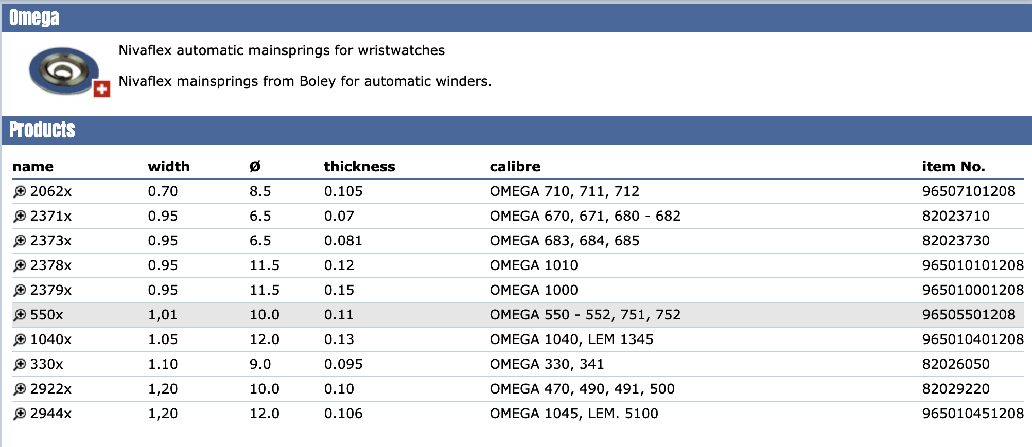

Does anyone know the correct OEM replacement mainspring part number/s for the 552 movement?
72205501208 | MAINSPRING

Just email Otto Frei or Jules Borel and just mention Omega 552 mainspring
OEM or generic. OEM maybe about $25.00 not including tax or shipping
No idea on generic
