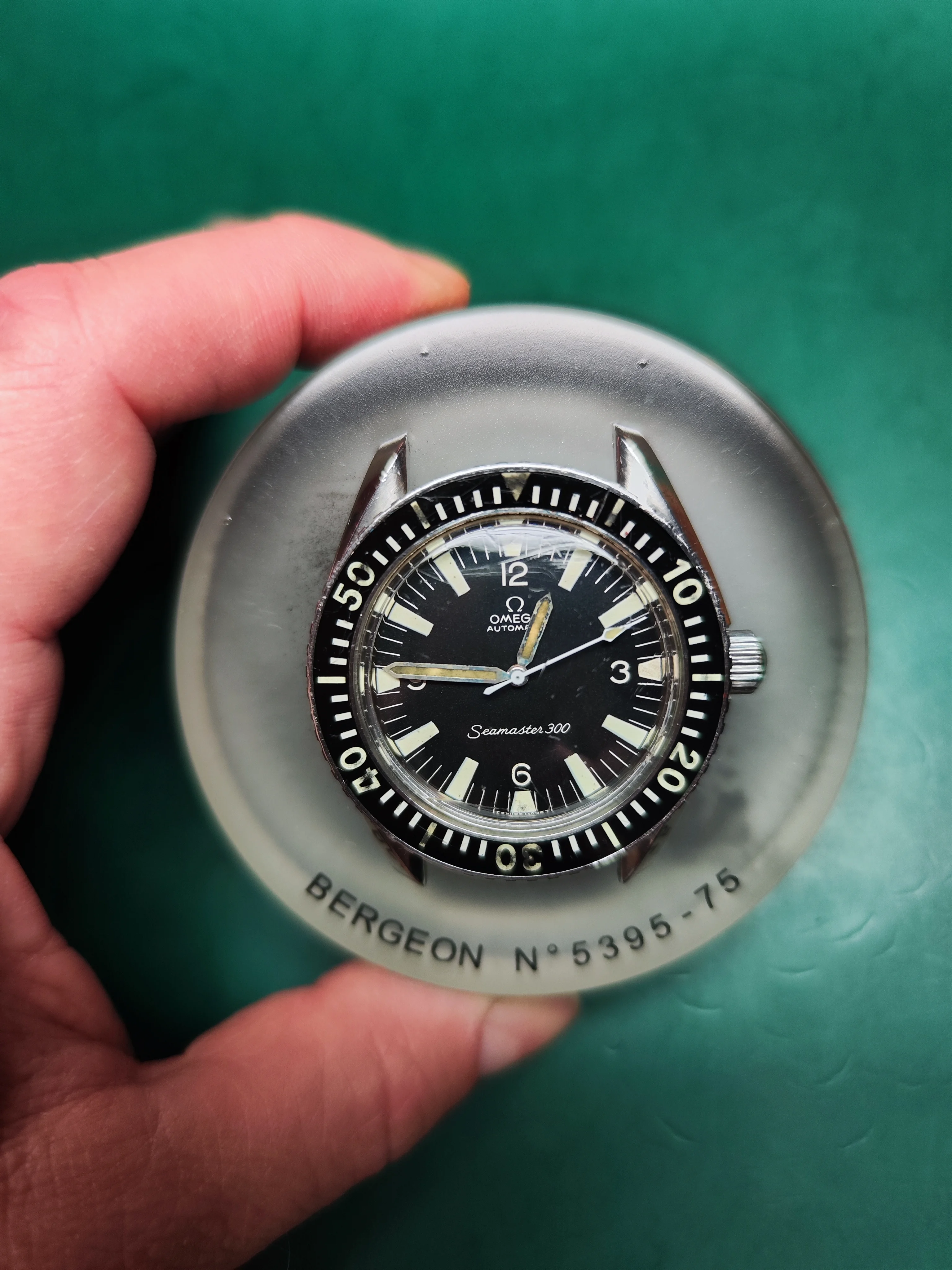

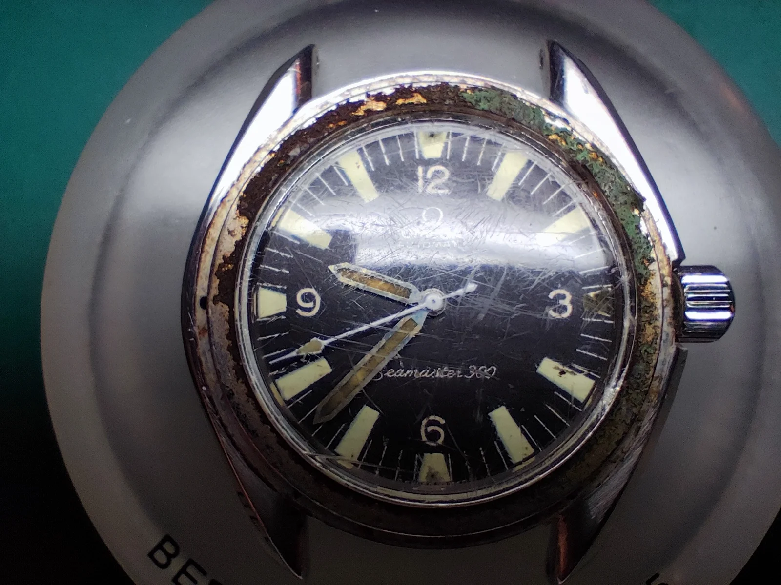

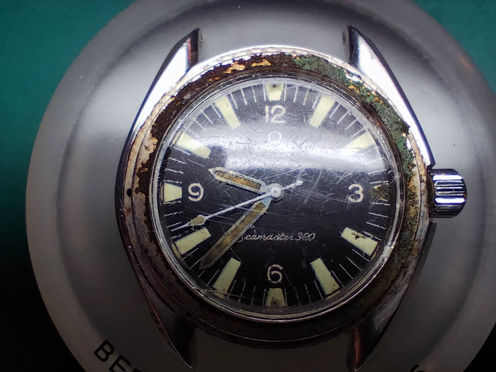

I was asked by a local jewellers recently if I fancied an Omega project. Turned out to be a one owner 165.024. Watch only, with original bracelet. Seriously grubby and potentially with some previously undiscovered life forms. Also a heavily punished plexi. But I thought it might turn out ok if I give it some tlc.
The bracelet, a 1039-516, is fully intact and serviceable, but heavily used and not something I'd want to rely on.
Well, I've given it a few hours of my time and wanted to see what some of you knowledgeable collectors think about it. This is the first one I've spent any time with and am wondering if I should buy it.

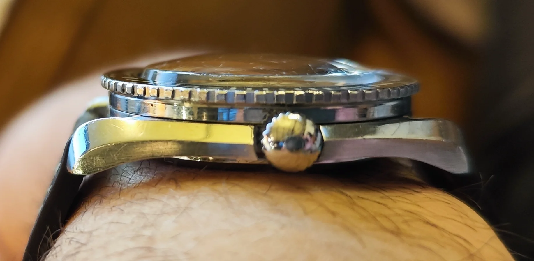

The head actually looks pretty good and honest. I don't think it's been polished. Screw down crown works well. Bezel assembly was completely fused to the mid case. The original insert is marked but intact. x2 ball bearings and springs are missing.

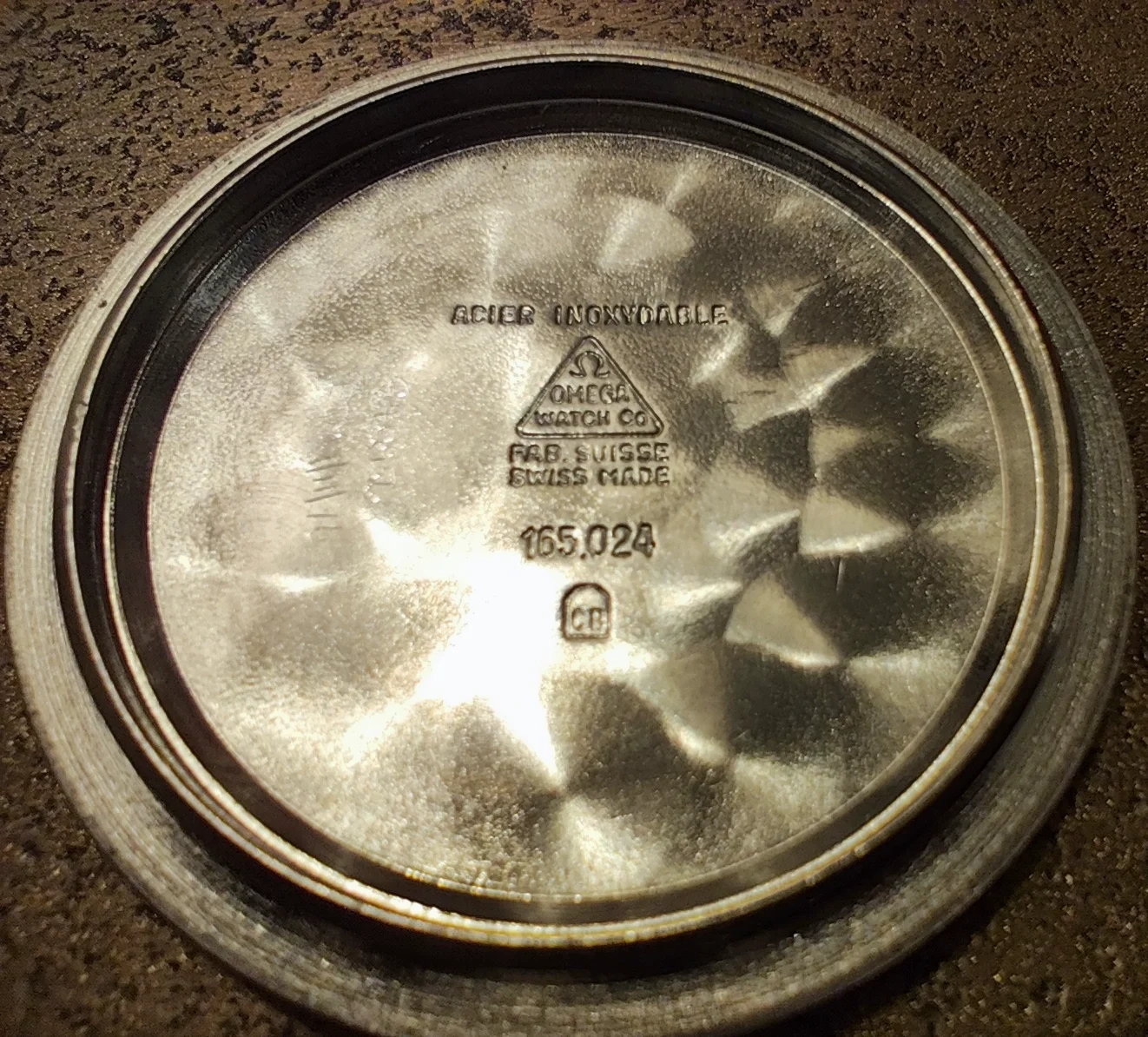

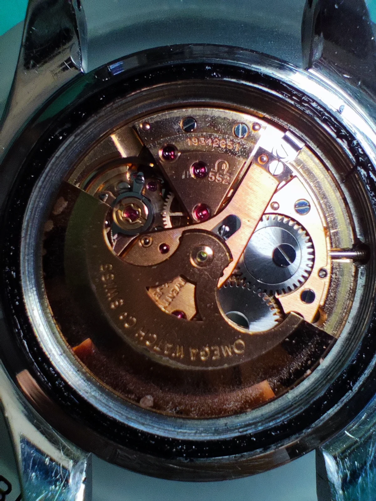

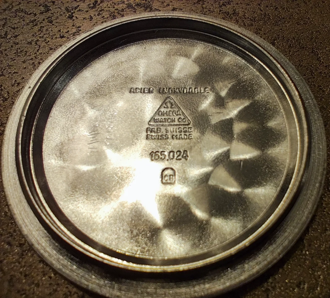

The cal. 552 is a little grubby, but running ok-ish on the Timegrapher. Clearly needs a service though. The movement number is a 19..... Isn't that pretty early???? One marking on the caseback would imply it was serviced in 1976. The rubber gaskets had turned to goo. Horrible to clean up and an indication that it's not been opened for a very long time.

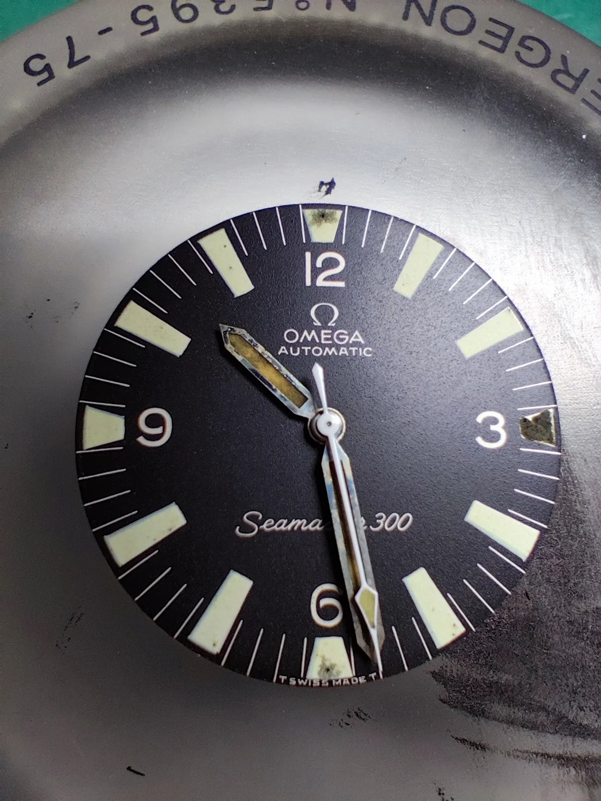

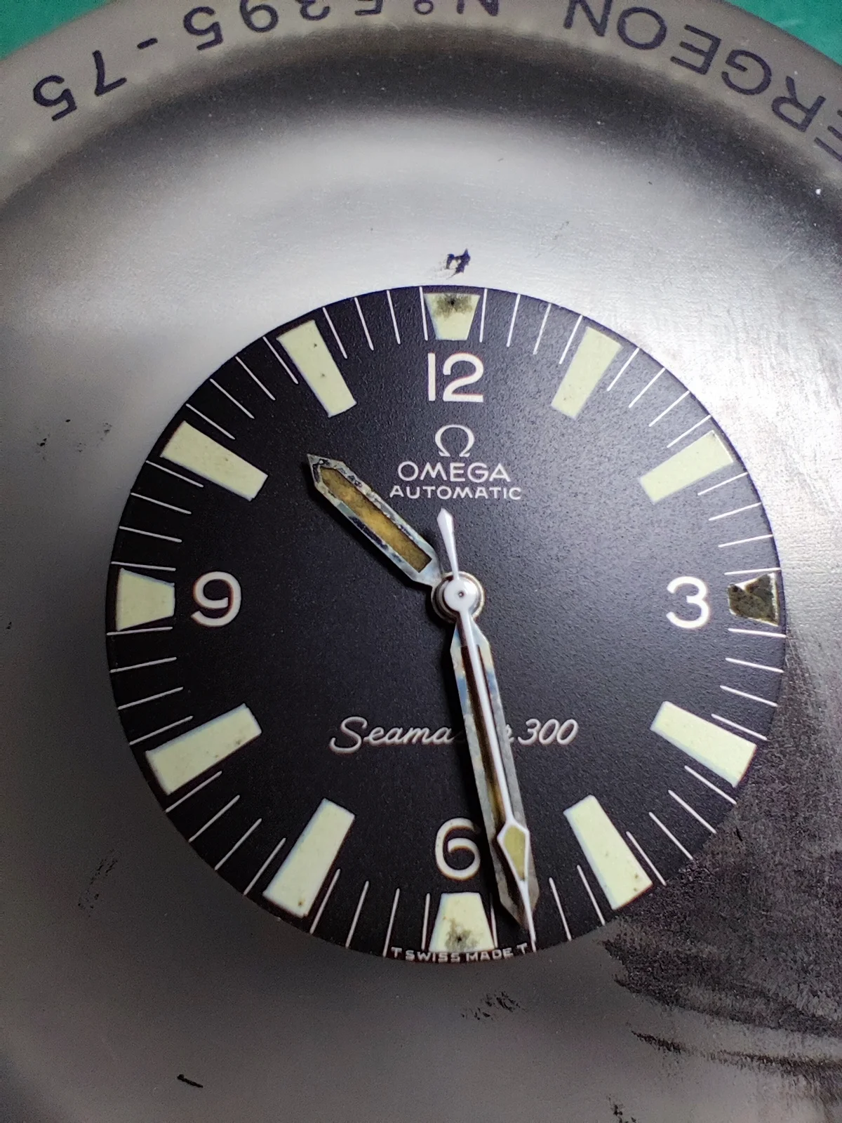

The dial was a little dirty too and the tritium on the 3 o'clock marker had almost turned to furry, flakey black mold. Really horrible looking. This cleaned off but took most of the lume with it. Looks much better now though I think. The hands aren't too bad but were certainly going a similar way. Perhaps the discoloration is from being damp???
The plexi is the original and although I've polished it, it has some heavy battle scars and could probably do with replacing.
Apologies in advance for the poor pictures. I'll get some better ones in due course.

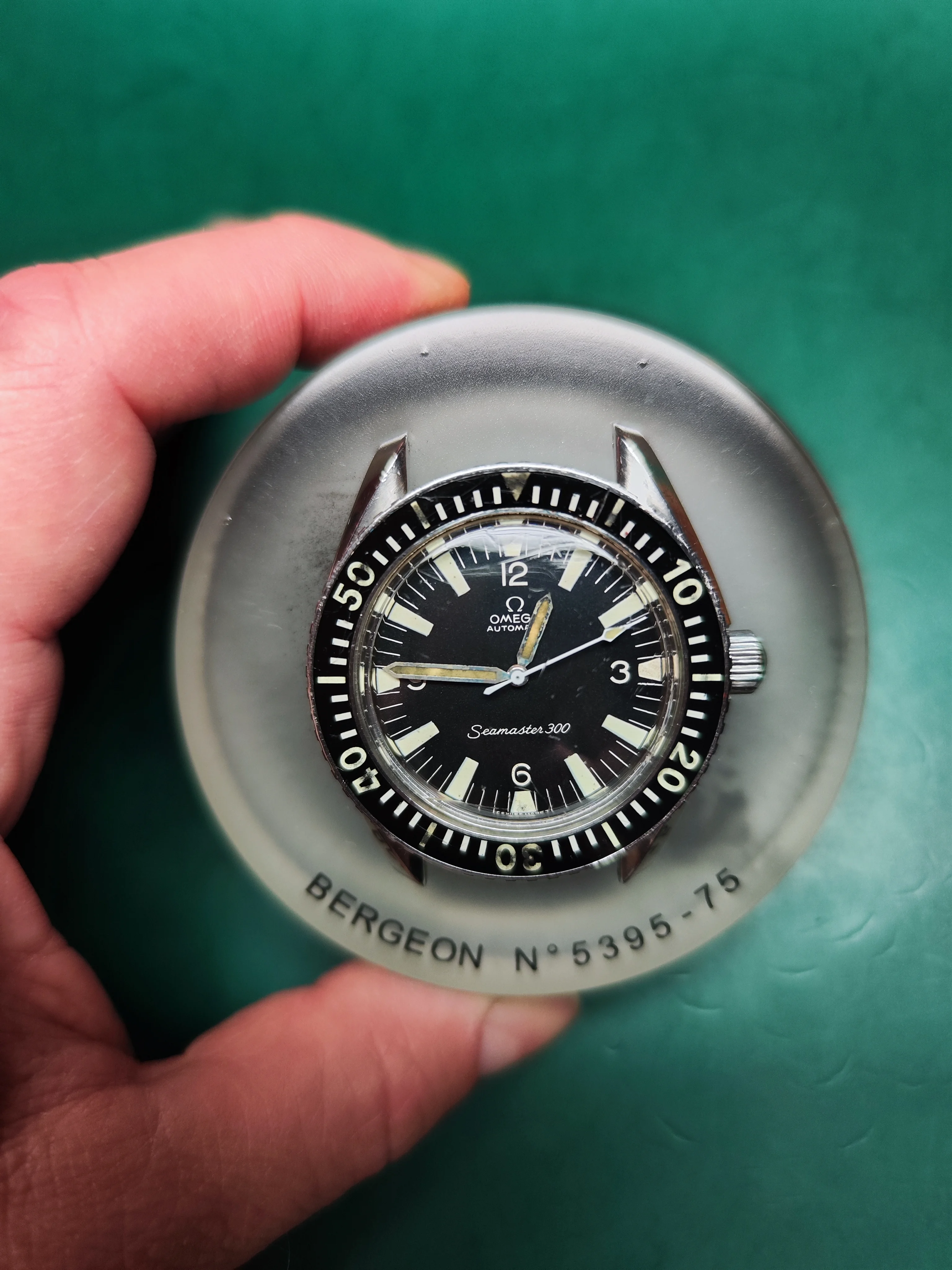

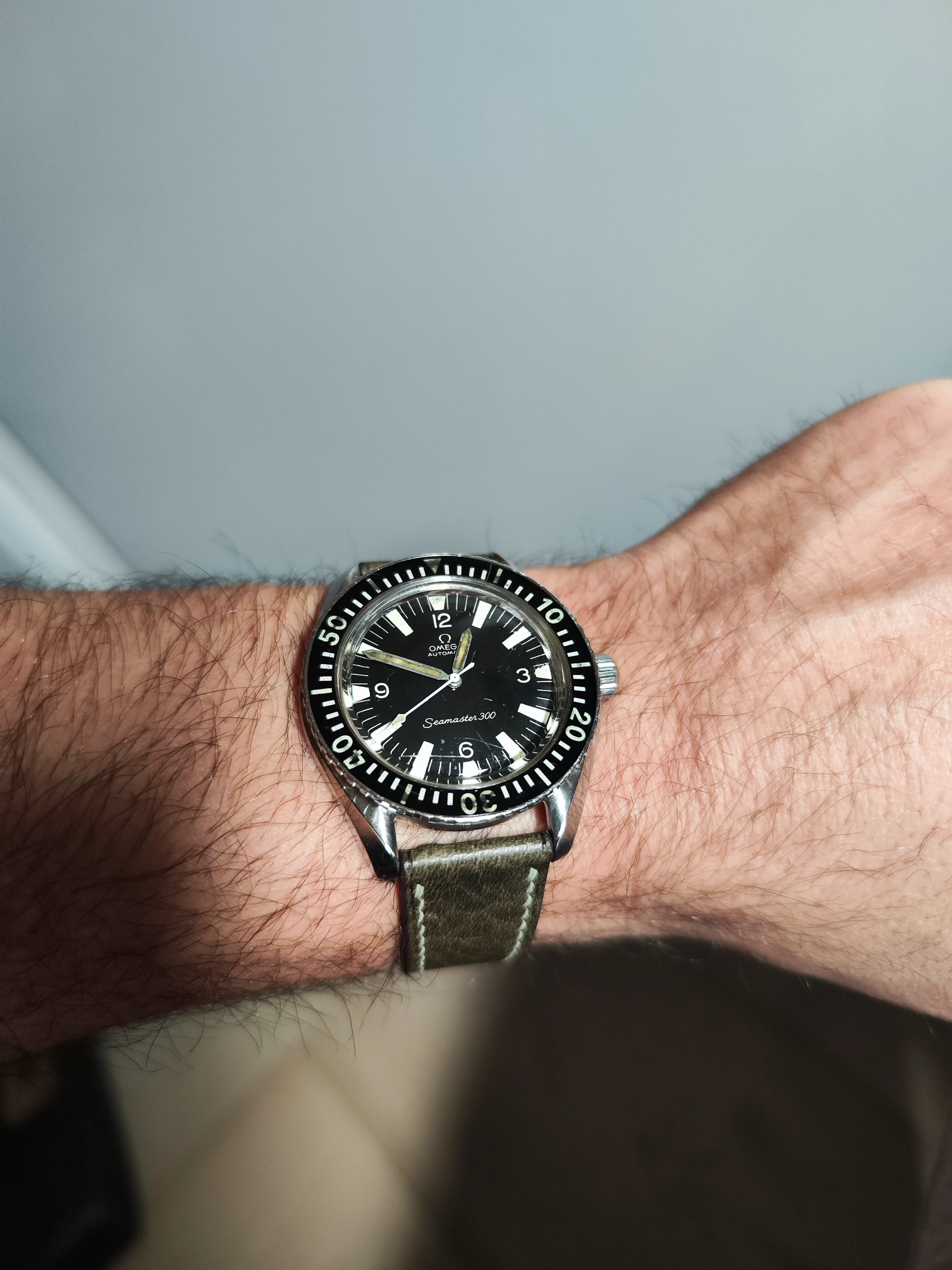

What do we think then. Worth keeping? At the right price of course?? I've thrown it on a nice strap and it's looking rather tidy now.

Hi ! You seem to have done quite a job to clean the watch ! The movement is certainly in need of a thorough service ..
I would keep the watch if you get it for the right price .. what are you going to propose to the seller ?
Good luck !

A 19 million serial is way too early for this reference.
Totally agree. My 1963 example starts with 20.xxx.xxx. What does the inside of the caseback say?

Anyway, I’d agree, make them a low but not insulting offer without showing them what you’ve don’t to it and go from there, baring in mind there’s a serial number discrepancy that might be an innocent as a bridge swap, but it means it won’t get an extract so impacts it’s value

What did you do to clean the 3:00 lume? Nice work. Your local jeweller must be quite trusting to give green light to such a cleanup!
Looks like a good opportunity to me. Good luck with the project please post results
Yes, I thought this when I first opened it up. The cal 552 was first made in 1958 I think, so I guess they either used an old one they had lying around or swapped it at a later date during service. Who knows but I don't have a problem with this.
I also wonder why it has the later screw down crown? Swapped over at a later service again I suppose.
Under a microscope, I moistened the lume plot and gently agitated it with the point of a cocktail stick. Then removed the slurry this produced with rodico.
In doing this, I've pretty much sacrificed the tritium itself, but as the underlying colour is the similar, have made it look a lot better. Perhaps I'll get that plot relumed by a pro at some point, I'll see.

wow, a very impressive cleanup job!
