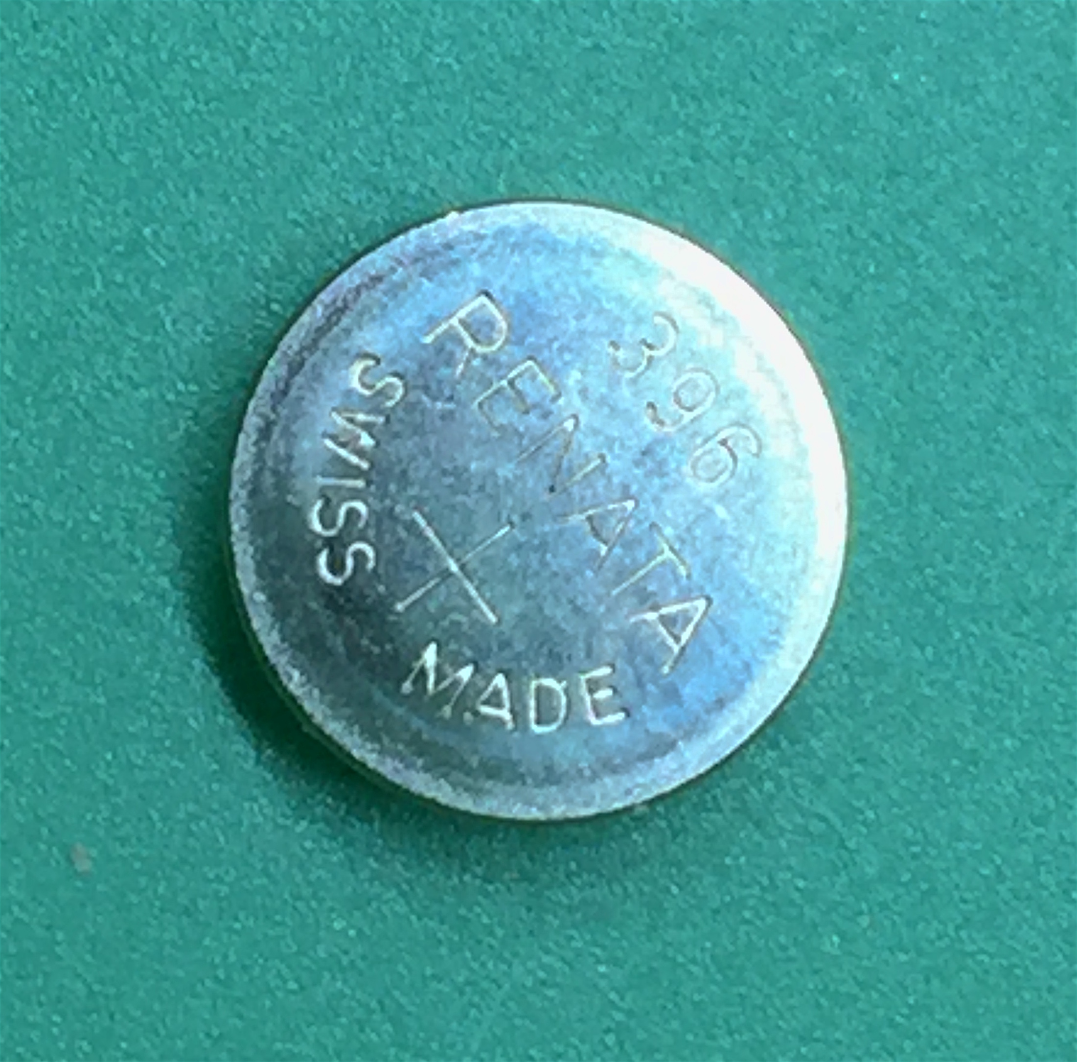

Renata batteries are Swiss made and are the brand Omega use and recommend.
Correct.
Made in Switzerland and owned by the Swatch Group.

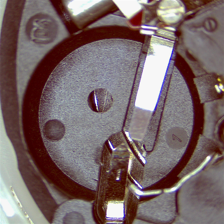

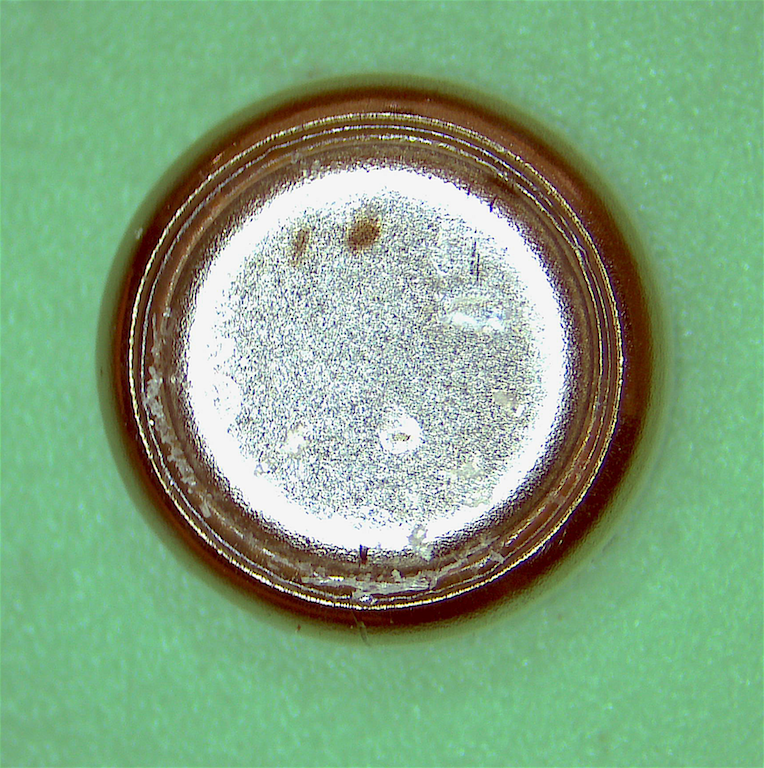

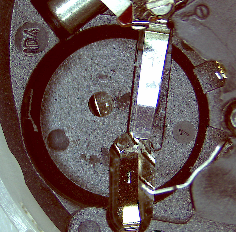

Renata are known in the watch community as being prone to leakage, at least in with the watchmakers I'm familiar with. I typically use Maxell, and have never had one leak.
This was likely due to some internal defect causing a short inside the cell itself, and not related to the use or age of the battery.
Just removed one today.
Electrolyte leaking.
The owner doesn't wear the watch and I suggested he get the battery removed.
Just got it time I think.
Now with the battery removed and the inside cleaned he can store it for as long as he wants.
