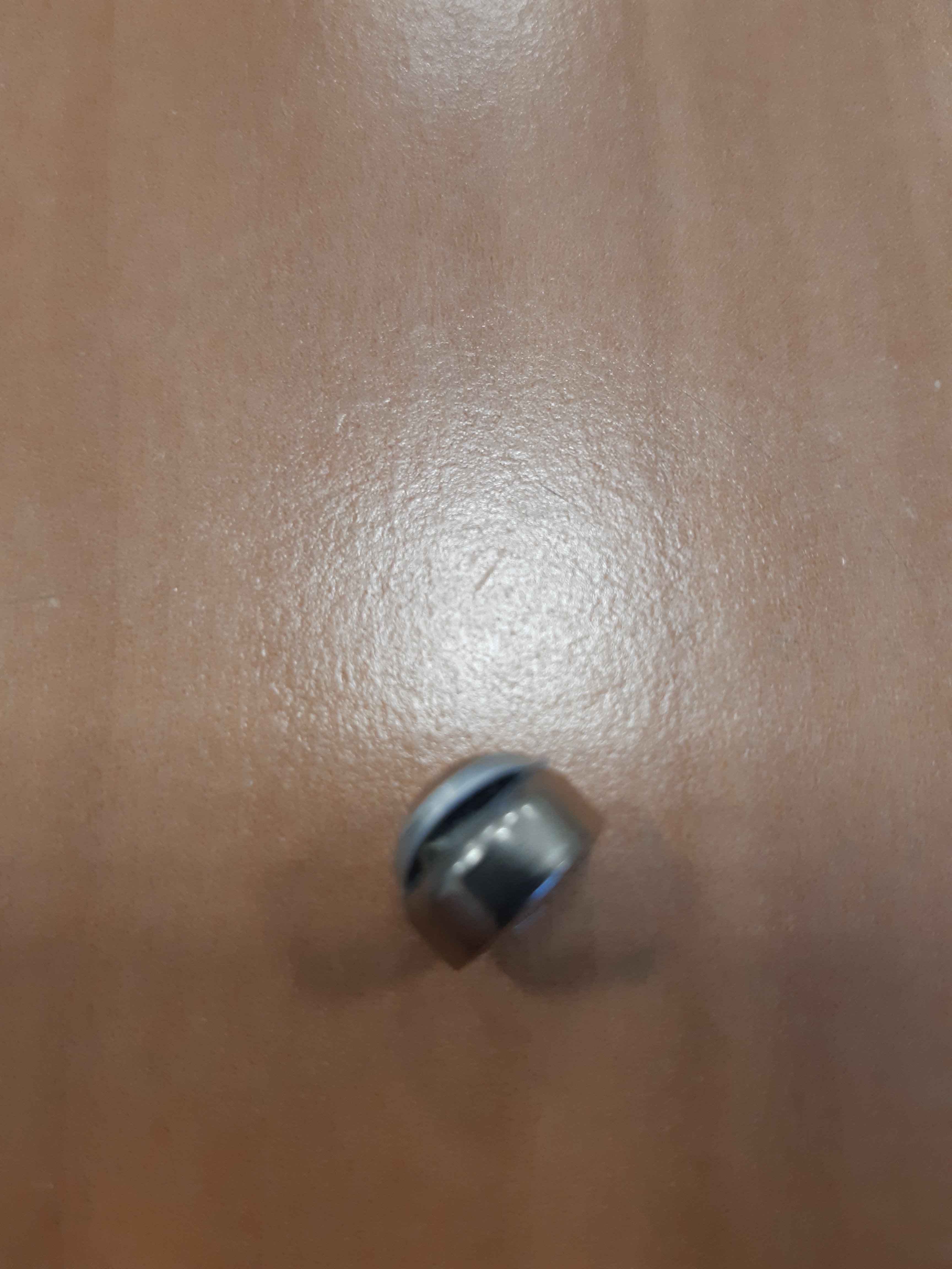

The watch battery in my Omega TC1 blew open and now the module is damaged. It still shows the seconds and all the lines are working but it doesn’t work properly. No surprises there. Any idea how common a problem an exploding battery is and what might have caused it?
Secondly does any one have an idea of repair possibility and who might be able to fix it? I am based in Romania but from the UK.

Please show a photo of this "exploded" battery.
Batteries often leak, in particular when they are low on voltage or dead, but in all my years in watch repair and servicing I've never seen one "explode"...

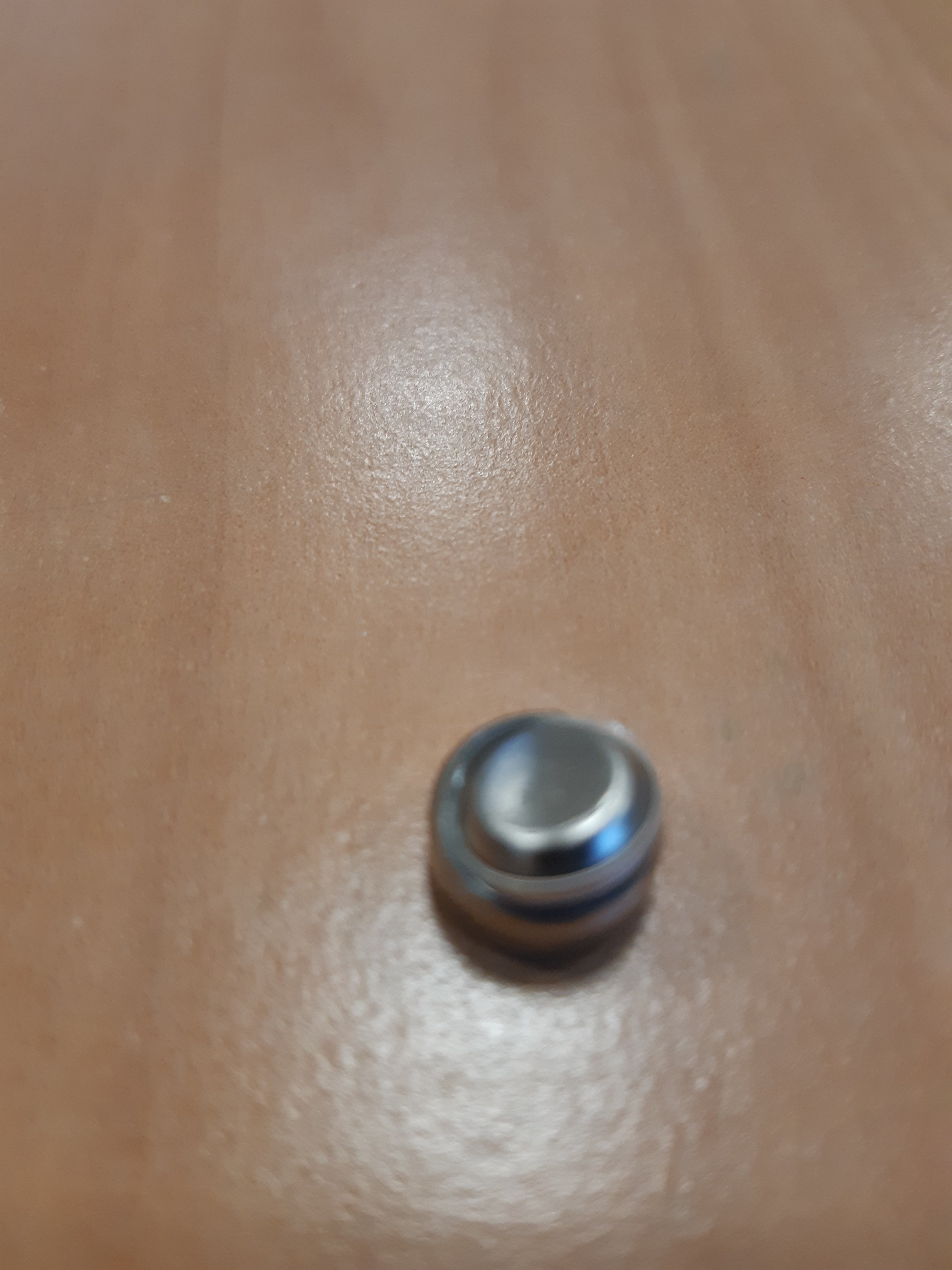

Here you go. I suppose popped is a better word than exploded, which might sound dramatic. But 30 people in staff briefing jumped simultaneously in their chairs as the pop was quite loud and quite unexpected.

Okay - quite possible this battery is shorted. Out of curiosity, what brand is it?
Definitely an unusual thing to happen inside a watch.
I'm going to give you "exploded" on this one. 😲
I don't suppose there was any water infiltration or other foreign matter inside the watch.

Whatever the cause it would be a matter of a gas being generated. I'd expect it to be caused by a chemical contamination during the manufacturing process. One in a million perhaps but these are slopped out in the hundreds of millions.
It is a renata 357 battery. I purchased them in October of this year. I have only used the watch once in rotation previous to yesterday.

Definitely not water but I can't be sure there were no small particles in there. My guess is I was just unlucky with a faulty battery. I am sure the chances are 0.0000000000000001% or less of it happening.
I sent a mail to the company, more to make them aware of the issue as opposed to them doing something. I am sure they would want to know about this issue.
