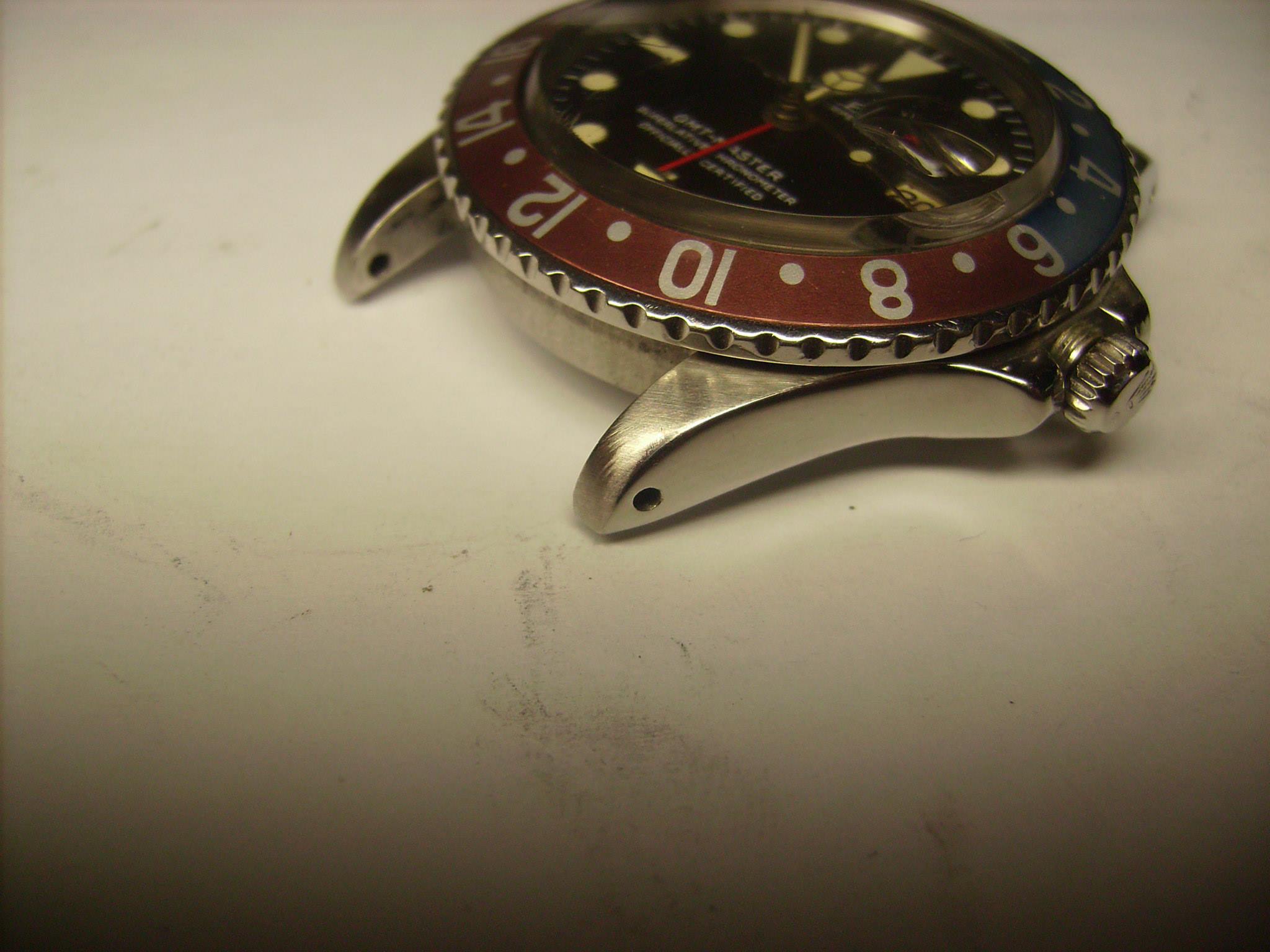

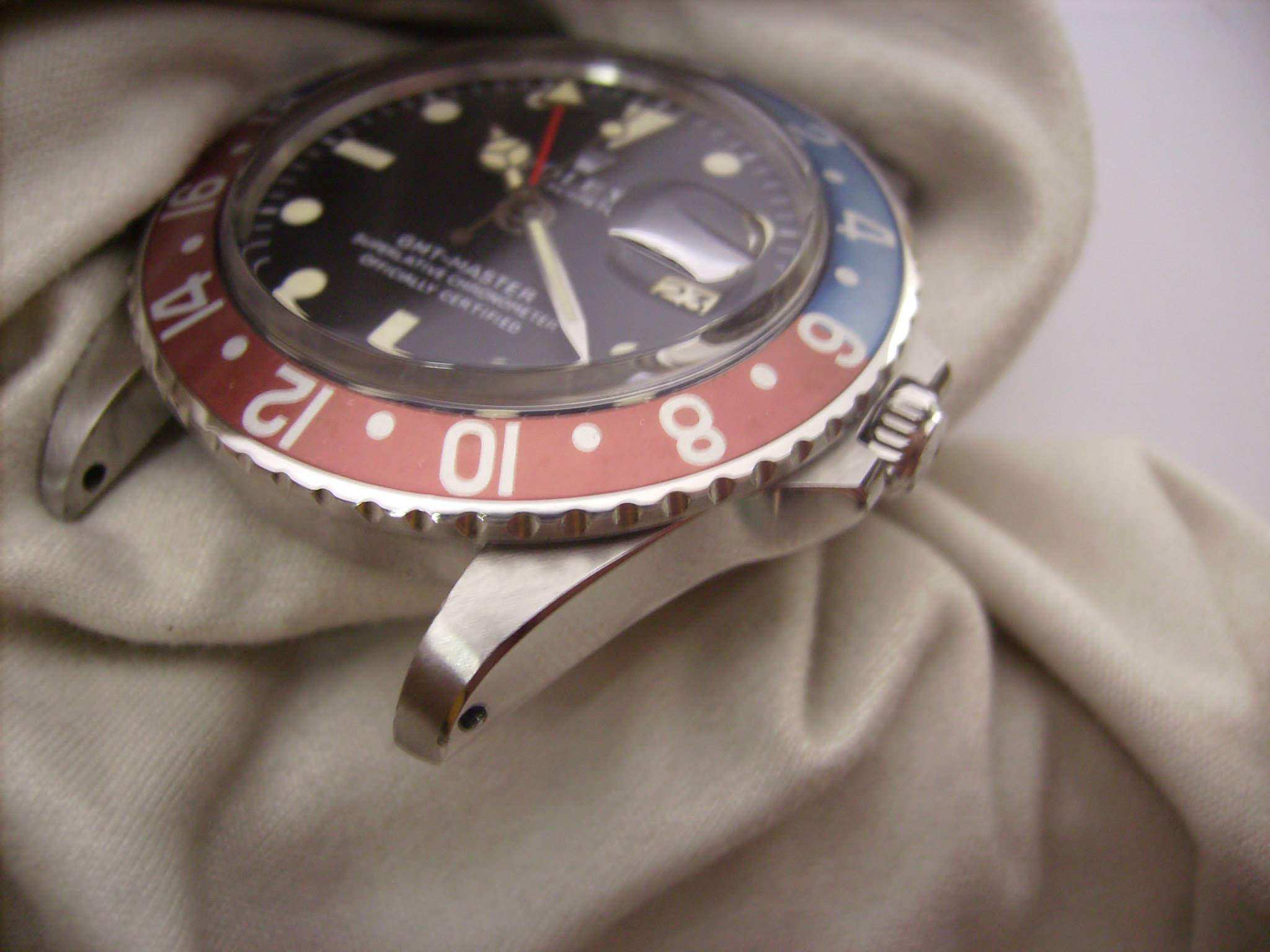

Well, does it look better before or after?
For me the crime was the terrible polish job in the 1st photo. The second photo shows the watch polished to the original factory specifications. These guys were much more respectful to the original watch design than the guys who just pushed the case against a polishing wheel.

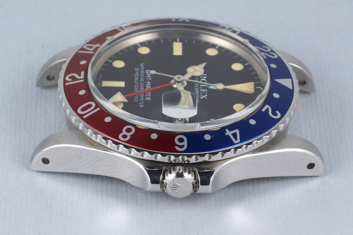

Regarding the lume, mismatching or hands with cracked lume can ruin the look of a vintage watch. Here the hands are luminova replacedments:
Here they have been colour matched to the dial:
I know which I prefer!

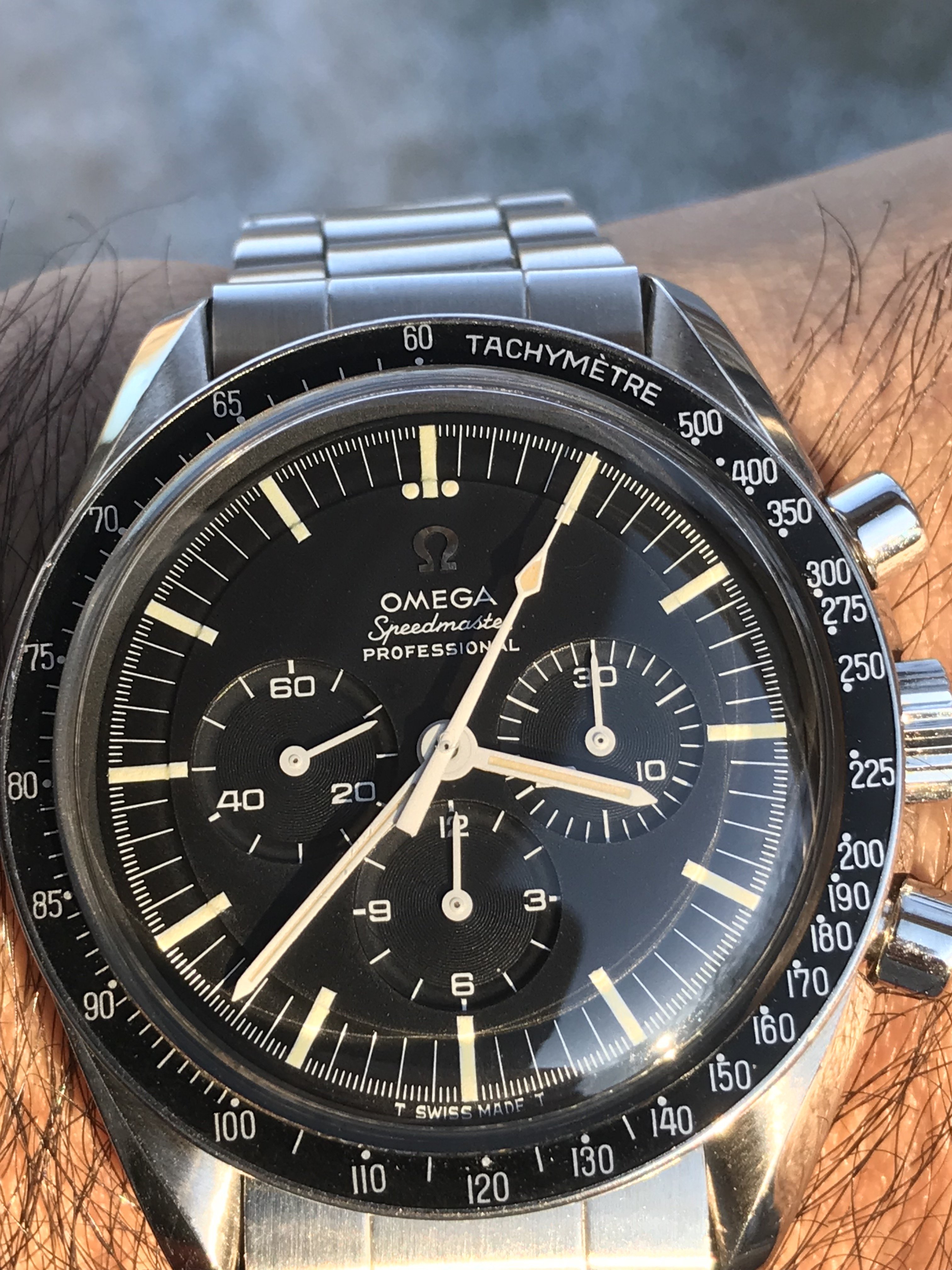

Here is my '68 Speedmaster, purchased from original owner whose father purchased it for him back in '69 as he was going to flight school to enlist in the Air Force and fly off to Vietnam. The story is about a 18 year old young man, wanting to serve his country.
This is an unaltered watch, so where is the patina? The watch sat in a drawer for 40 some odd years. Yea, beauty is in the eye of the beholder, it's not always about what hue of orange is on that dial, it's about it's purpose and the story it has to tell. Unfortunately, this hobby has become more of a "show and tell" side show lately where everyone is trying to one-up the other by the extravagance of the colors.

Here is my '68 Speedmaster...
Wow. That is a thing of beauty, and your story makes it even more so. Great share! 😎
