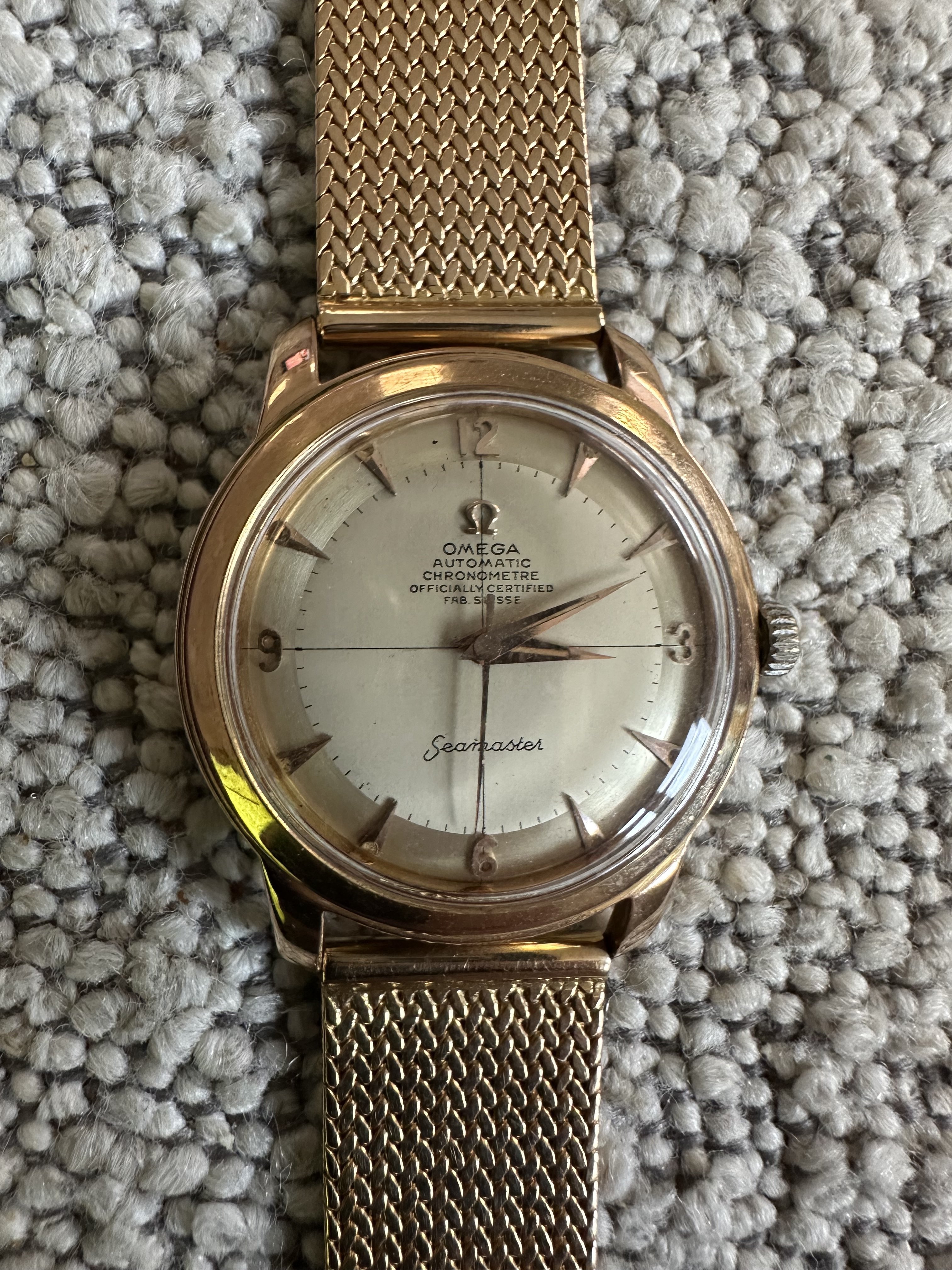

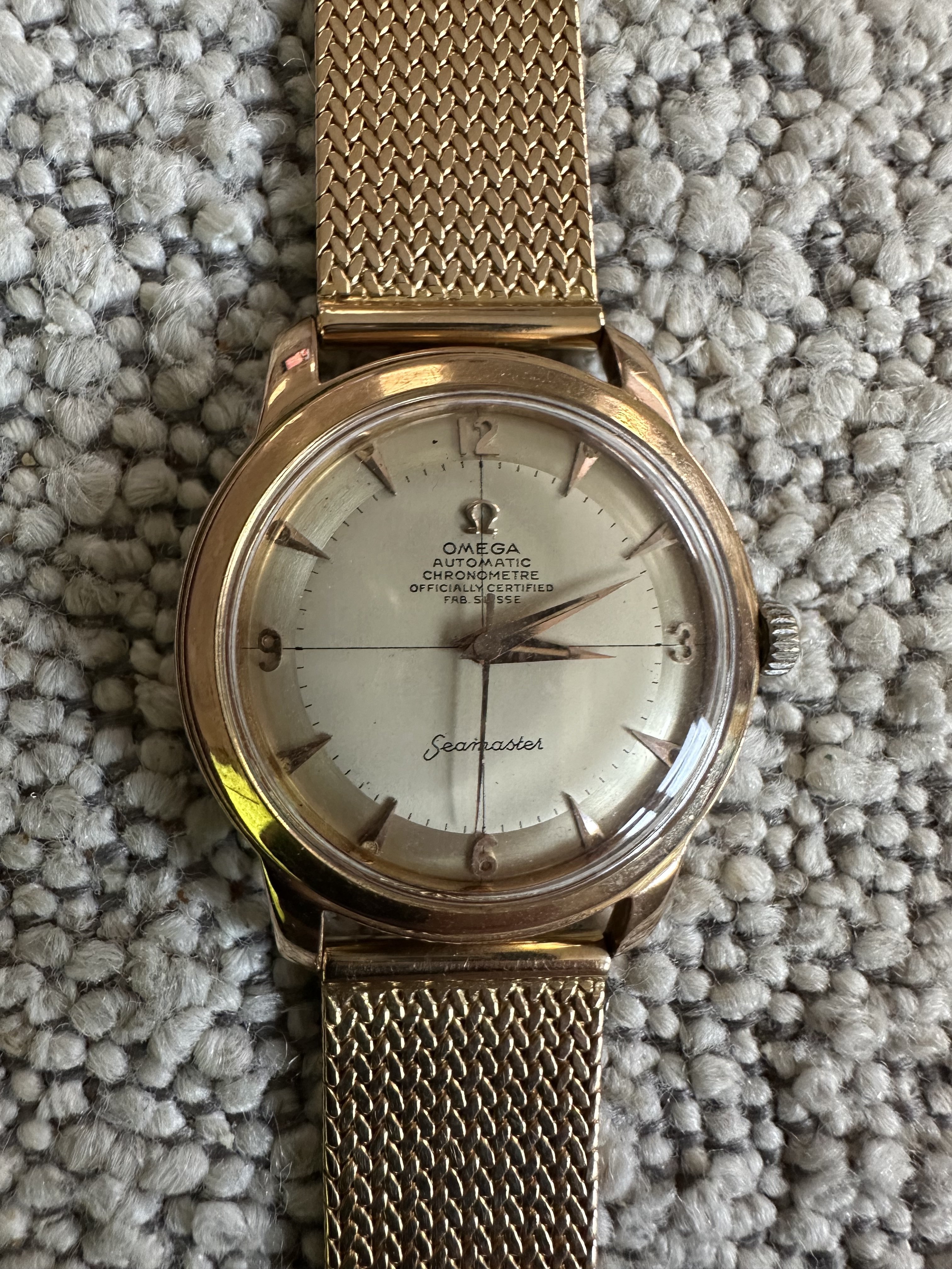

Thought I was purchasing a well-sorted piece with plenty of documentation but what showed up leaved a lot to be desired… first time posting and would love some advice, but please be nice as it is my first.
Purchased from a Frenchman in Quebec. Was told this was “full 18k gold Seamaster with original papers” apparently from the 50s or 60s.

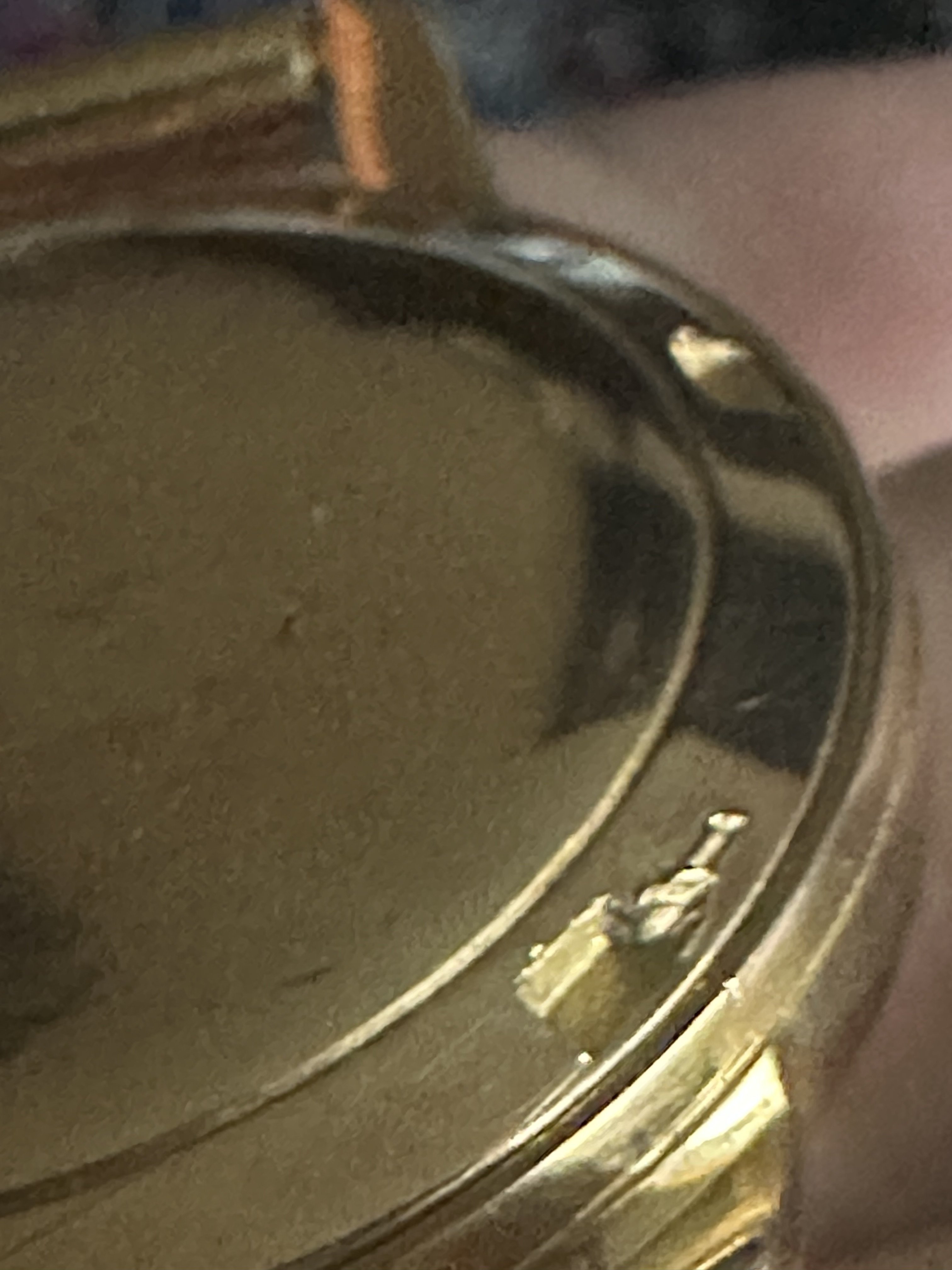

What I received was a piece with a random appraisal, what seems to be a non-Omega strap with a logo I have never seen before and a strange damaged case-back.
I am also not as familiar with Seamasters that do not say “Swiss Made” on them so hoping to get some clarity there too.
Here are some pics.

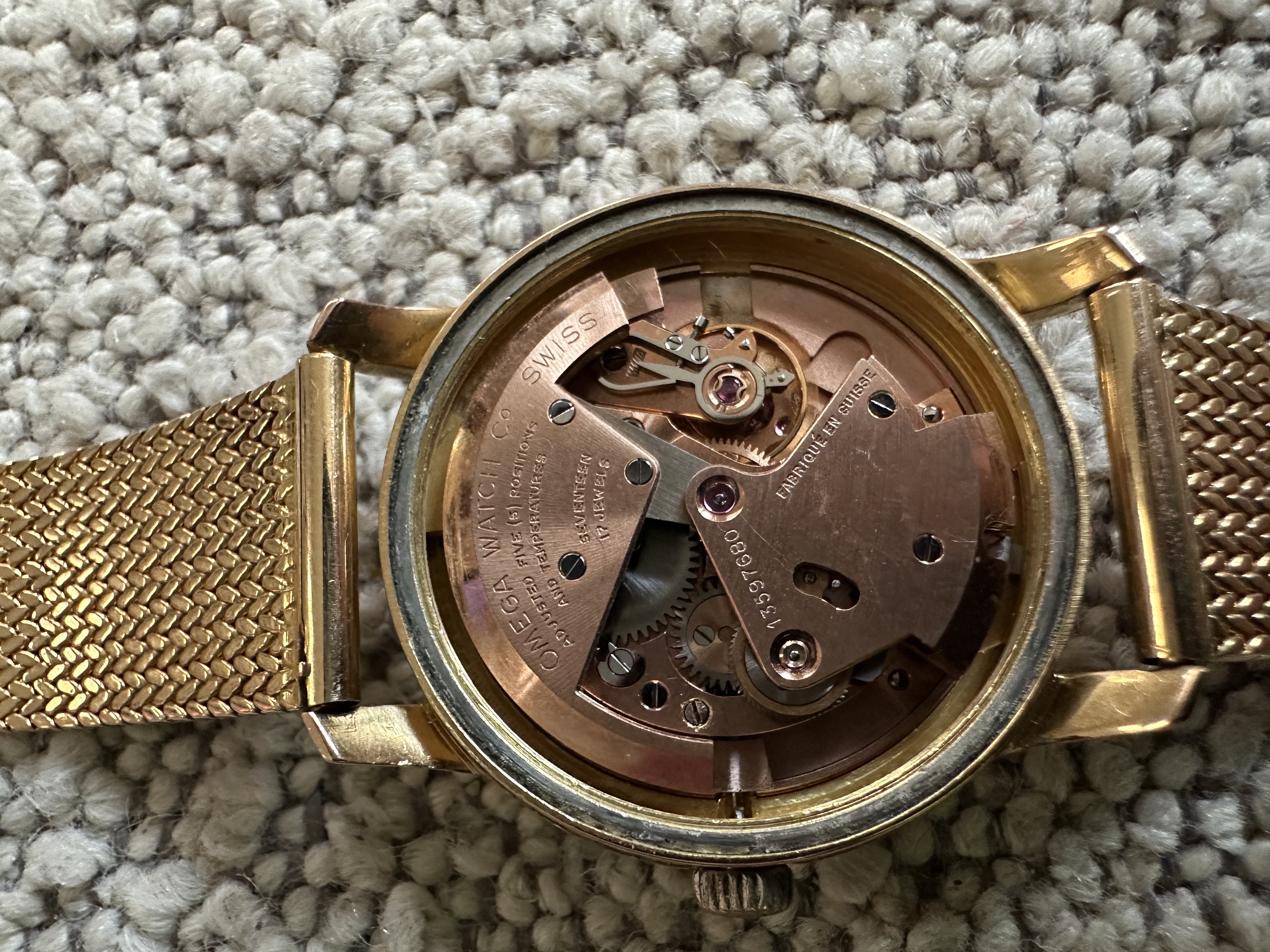

First off, it’s a cool watch - Chronometre-rated French market Seamaster from the early 1950s. Given French market, “fab suisse” rather than “Swiss made” is correct.

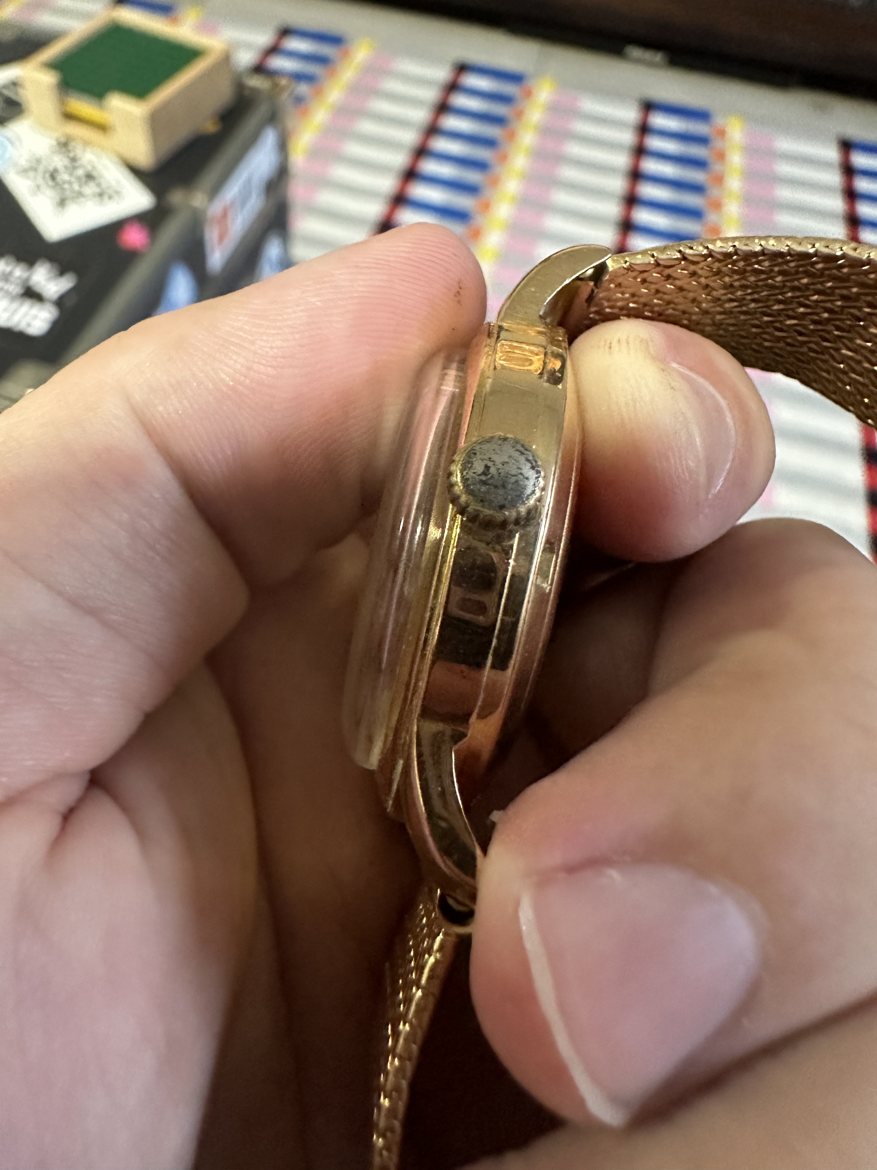

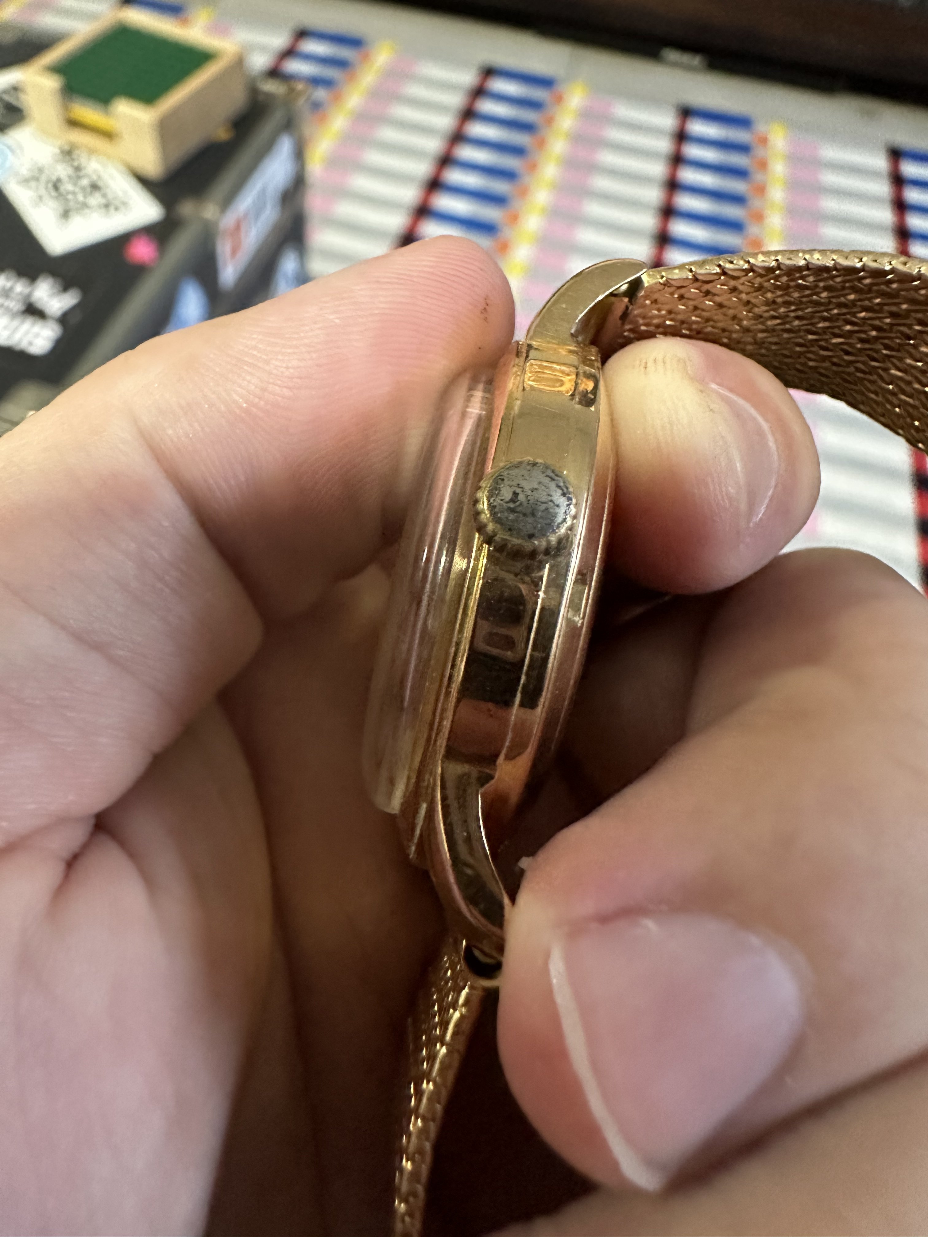

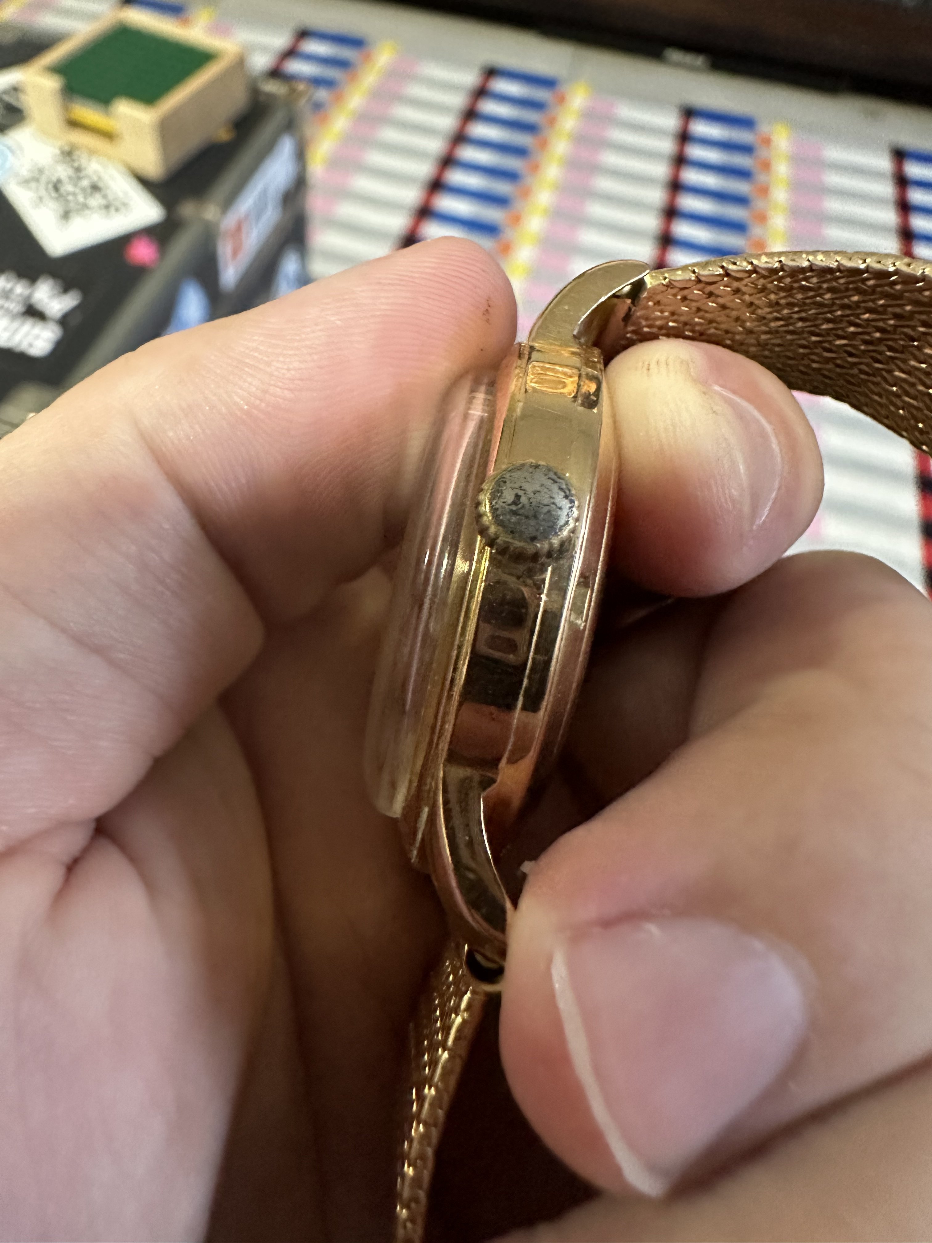

Bracelet is definitely not original (at least not from Omega), nor is the crown. Neither are a big deal.
Do you mind sharing what you paid for it?
8,881
62,898
Dial is original

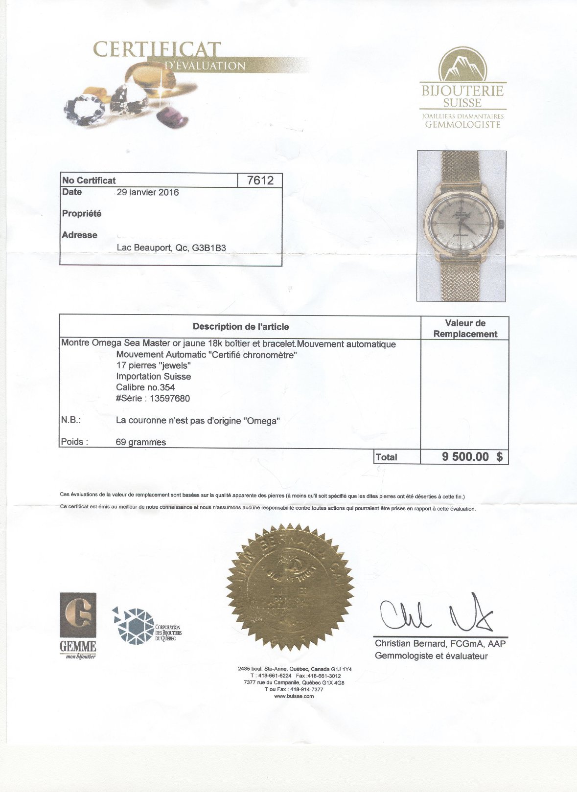

Evaluation is whatever the watch Seller wanted stated at the bottom of the "Appraisal" and is off by 3-4x, hope you didn't approach anywhere close to $9500.

Welcome.
+1 to all of both the replies above. We have plenty of related material here you might like - e.g. https://omegaforums.net/threads/fab-swiss.84726/.

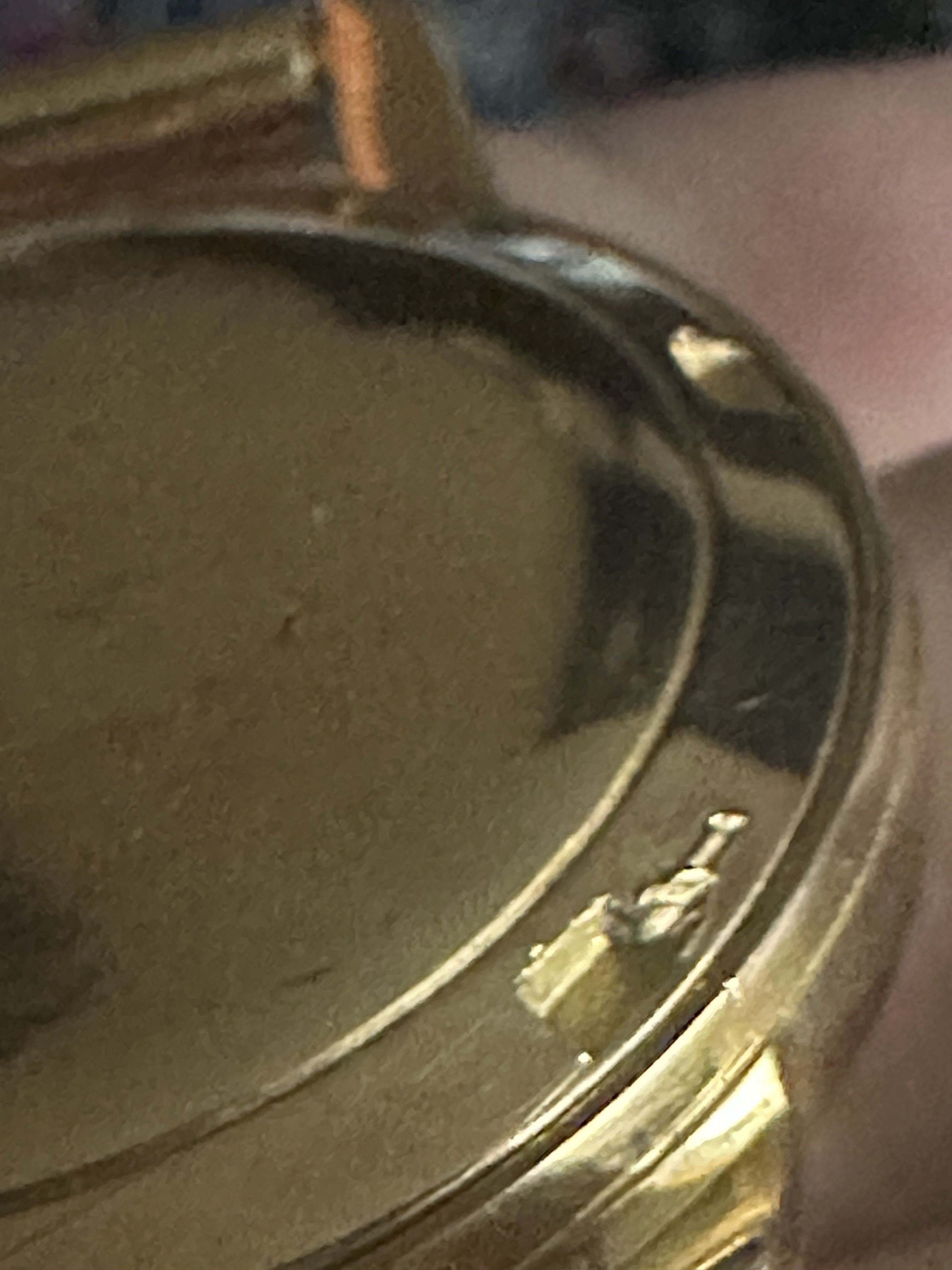

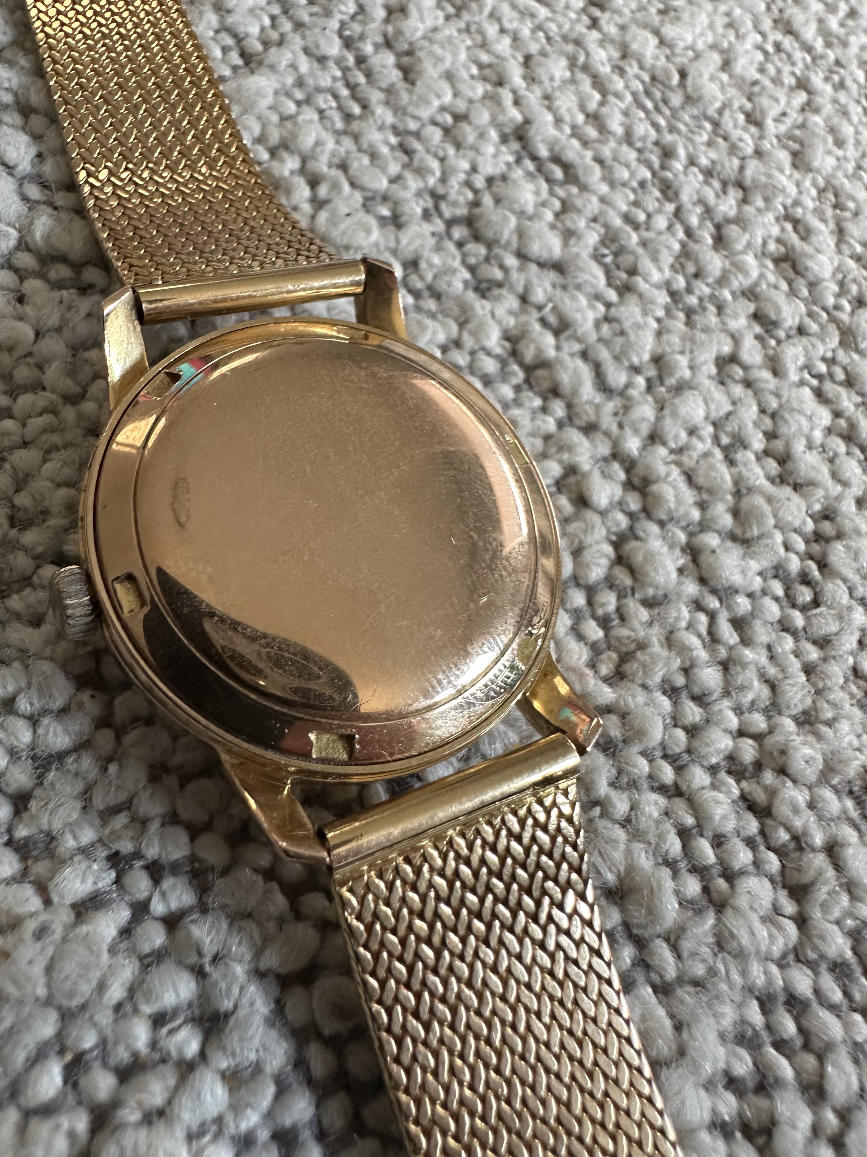

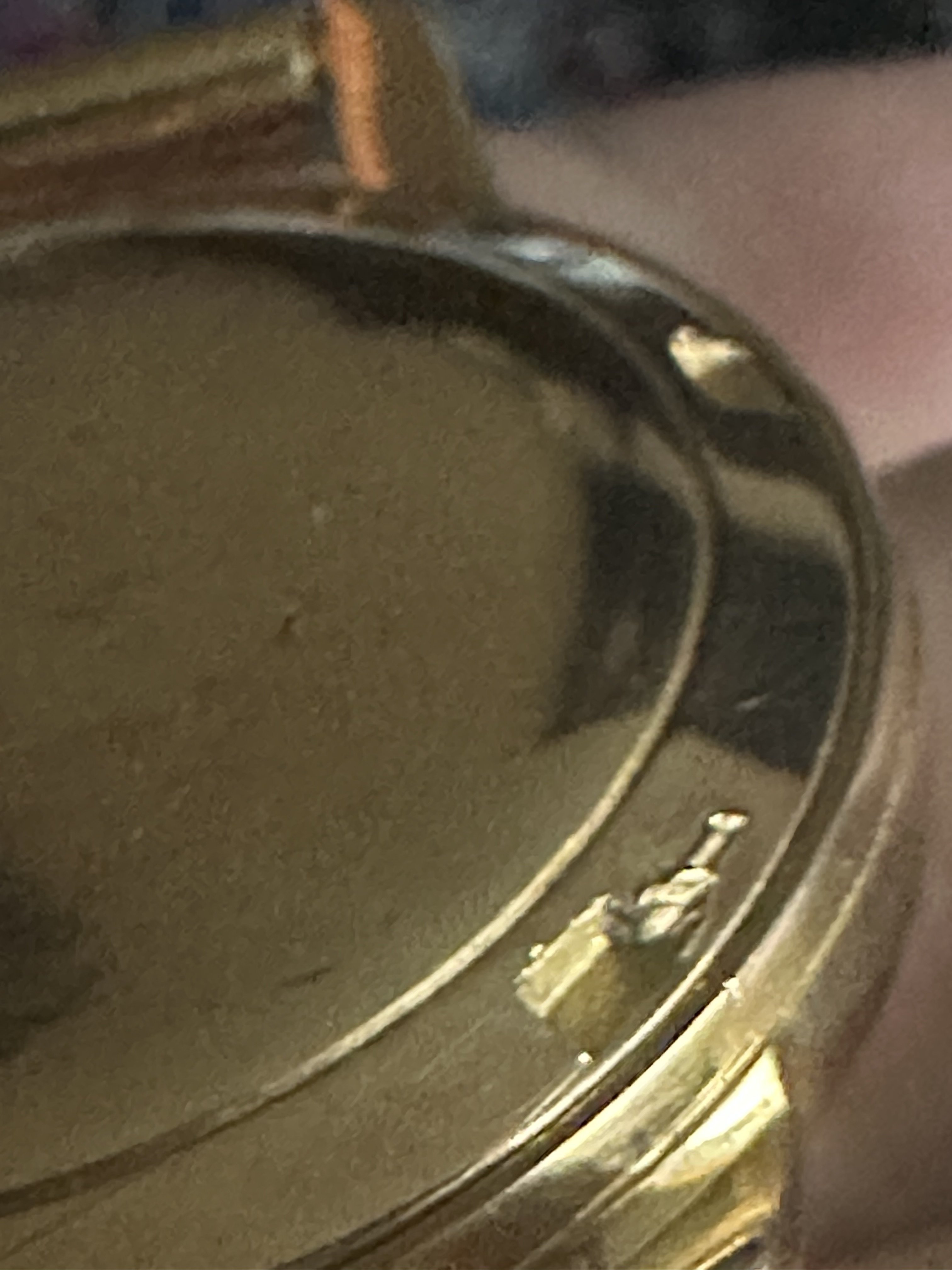

[Edit: ignore this bit "What was your concern with the caseback? The picture isn't quite sharp enough for me to tell, but might it be the French "eagle's head" hallmark for 18kt?" Now I've looked on the big screen I concur with the description "gouge".]

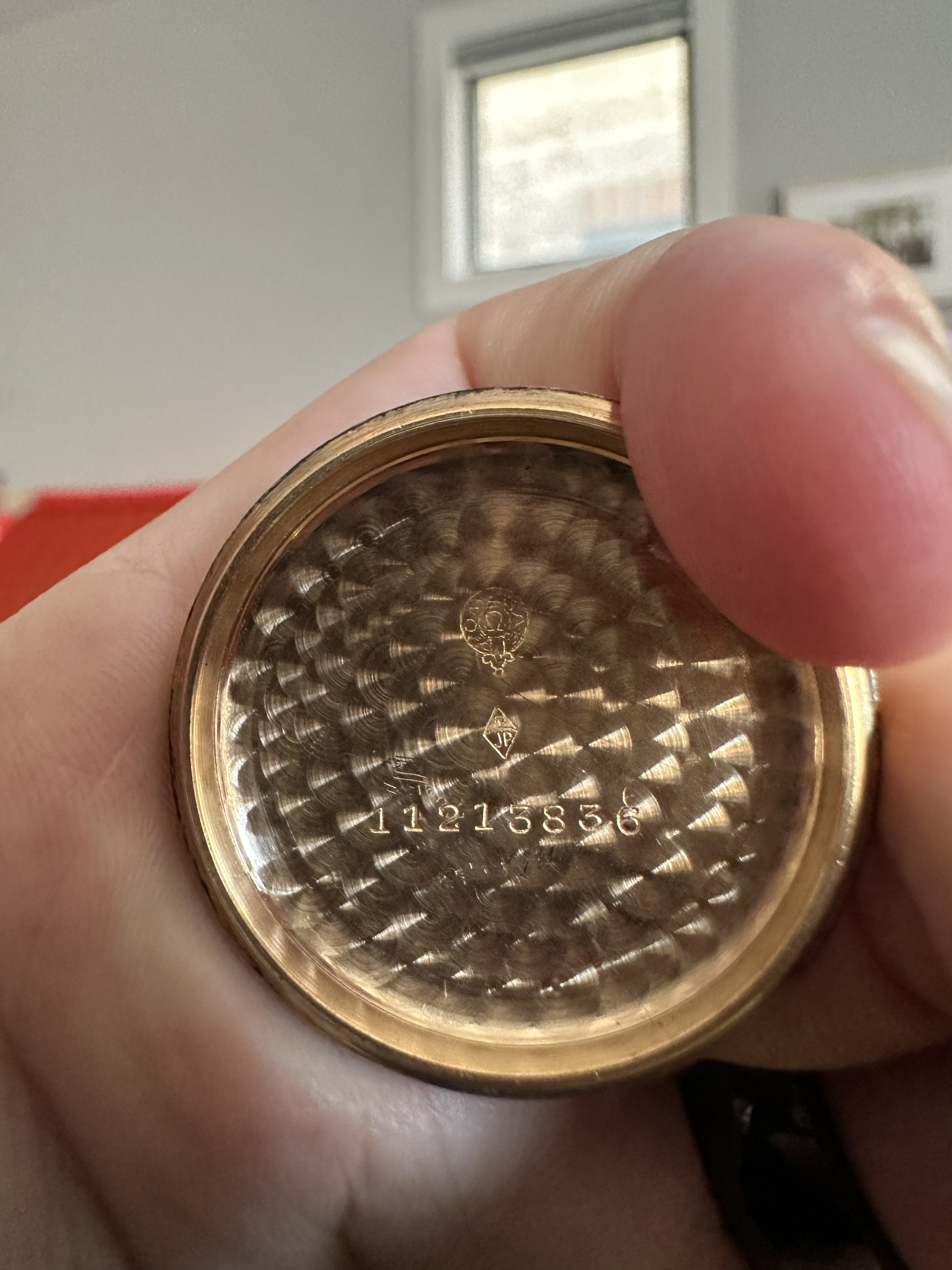

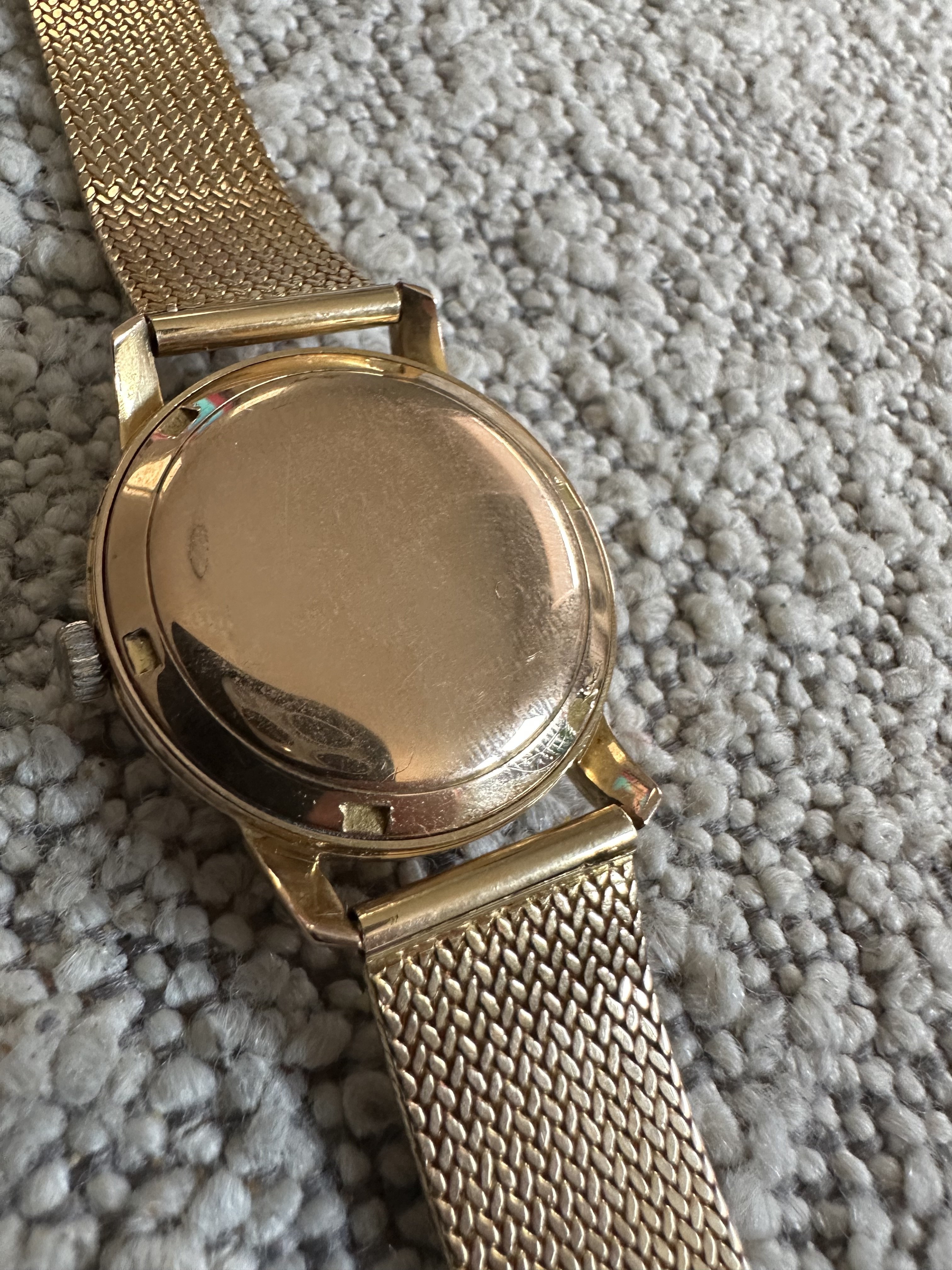

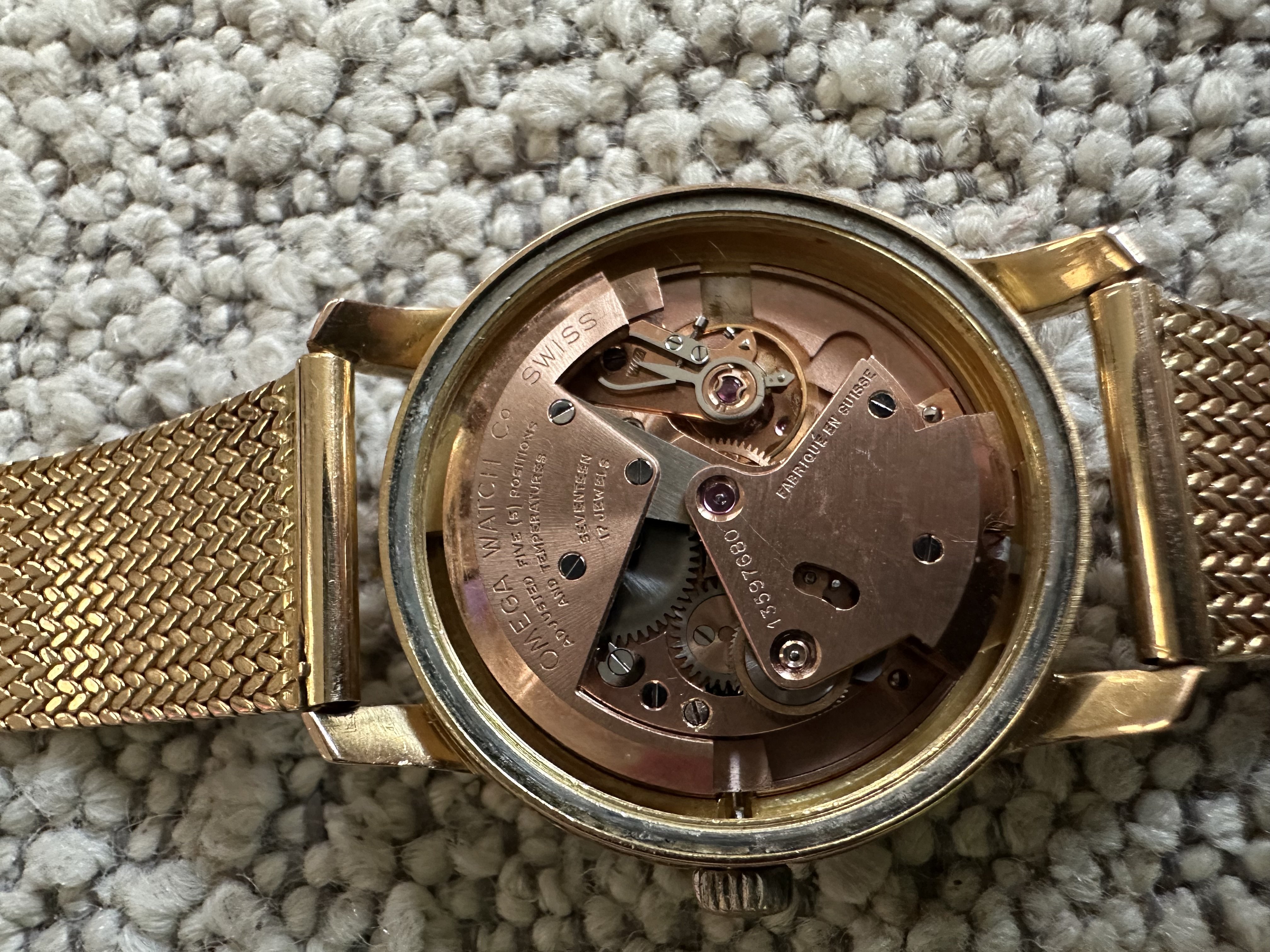

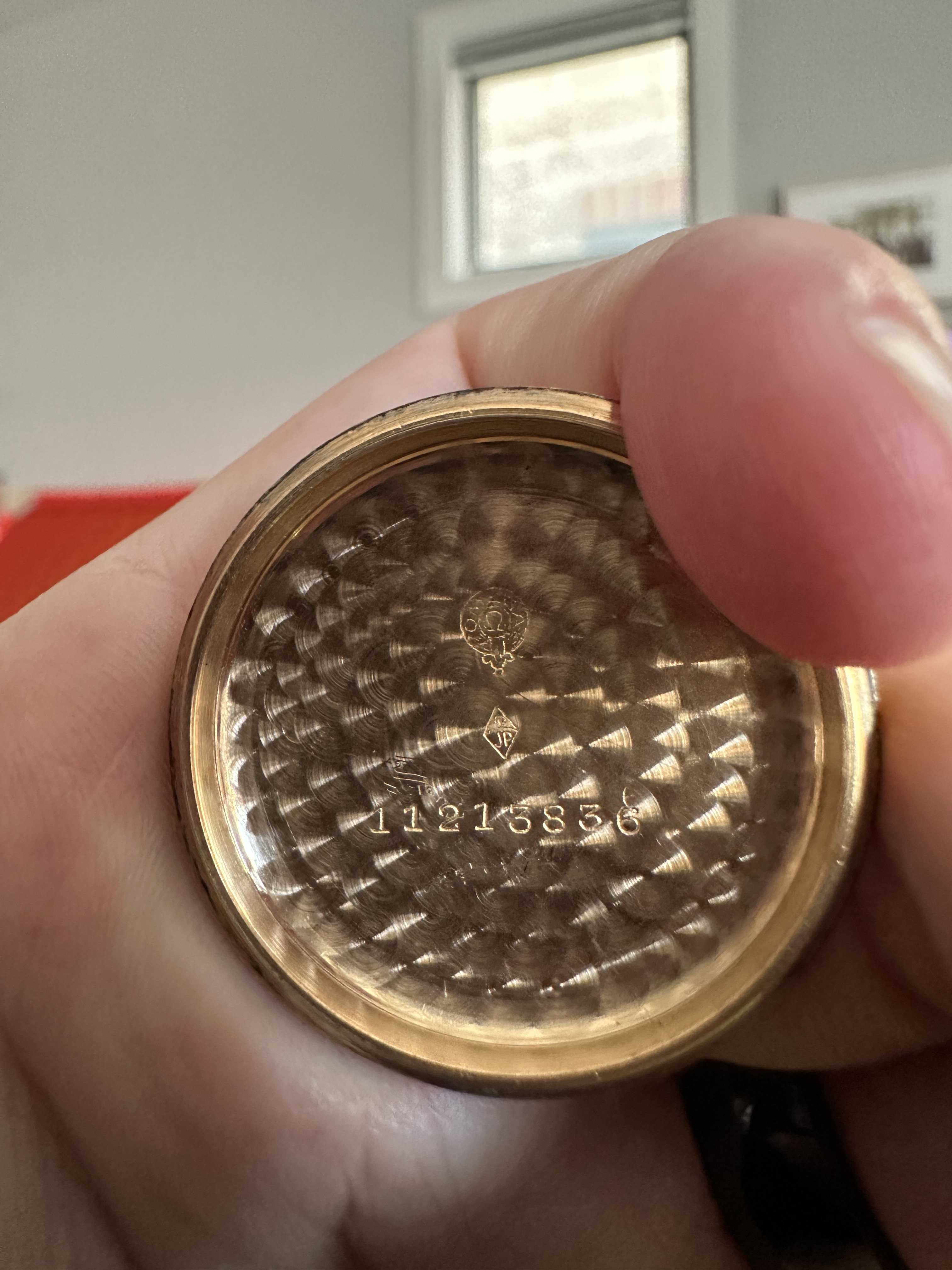

Thanks for all the replies! The massive gouge on the screw down cutout is the concern. Glad to hear the dial and (assuming) the movement are original. Not quite sure about the information on the inside of the case back, would love to know what the numbers mean.

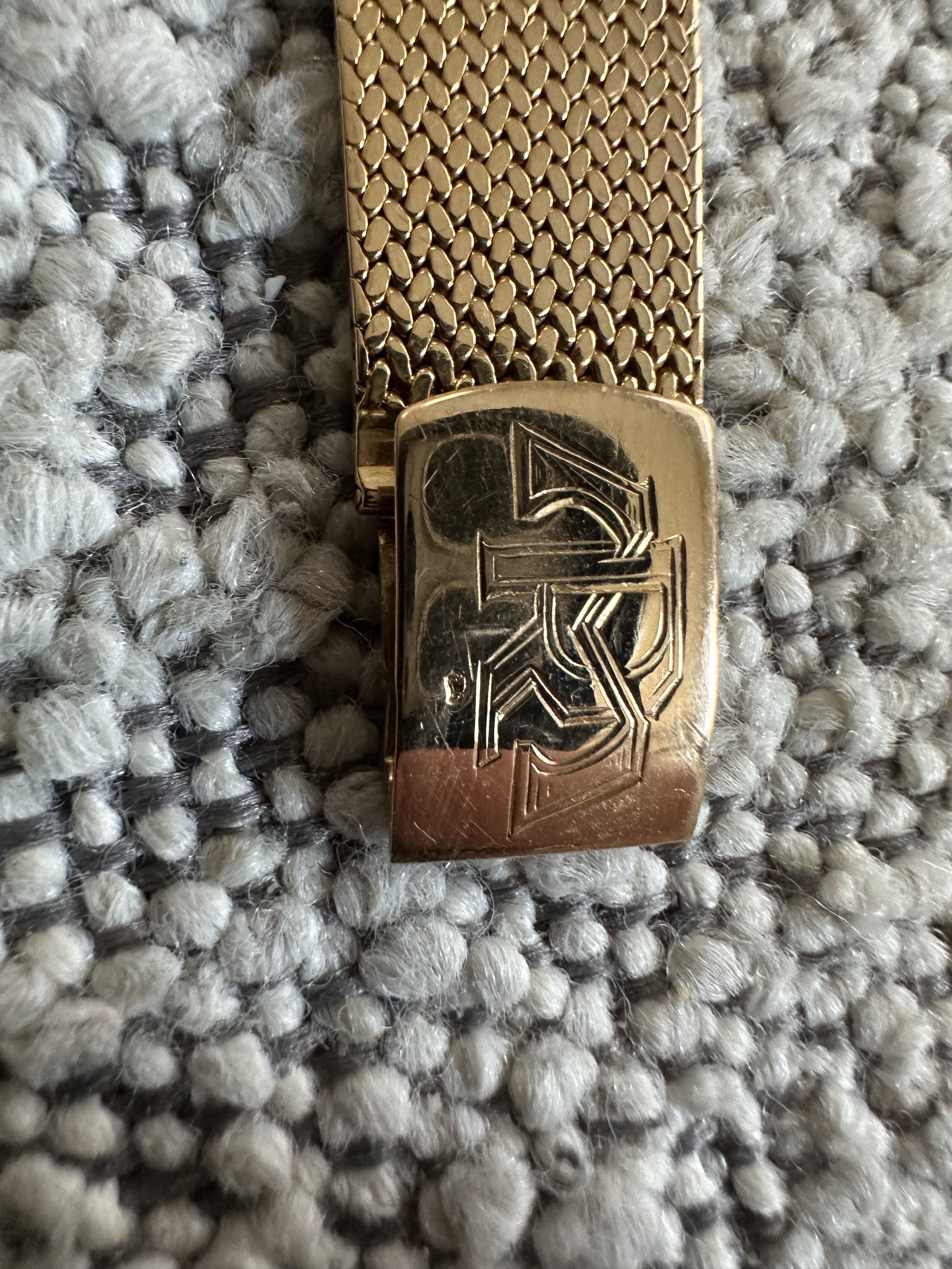

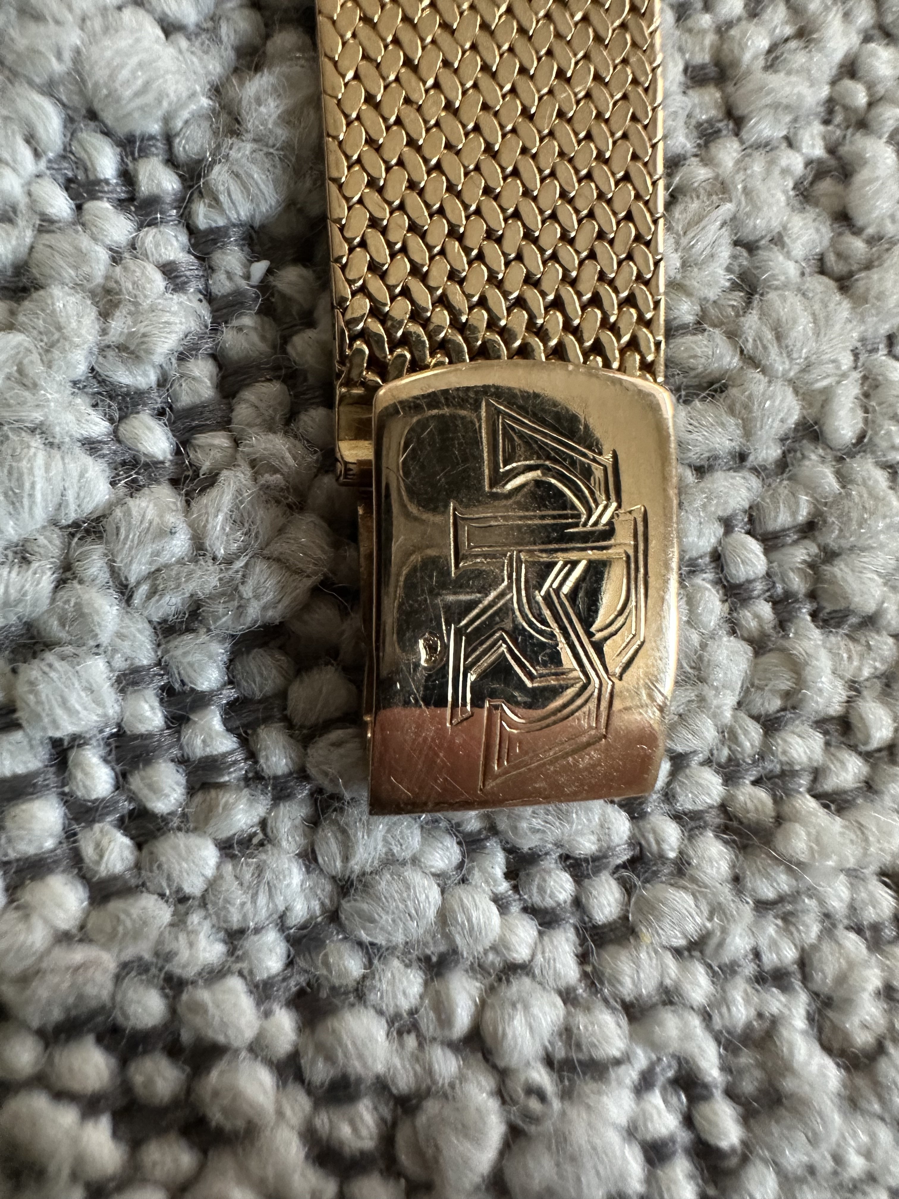

What do you all think this is worth and any idea about the logo on the clasp?
What would it take to bring the band and crown back to original? Is it even possible to find those parts?

Omega did not sell many gold bracelets back then so it was common to see aftermarket brands or custom ones. They mostly came with straps.
Your bracelet may be original to the watch.
$4500 CAD or USD?
not an unreasonable price assuming the bracelet is 18k gold as well and CAD.
Try to get an appropriate crown, may not be easy or cheap but they exist.

The bracelet is probably not worth more than scrap value in gold so lets say it weighs around 30g? Which will make it around 1400USD since todays 18k price is 47USD, so that will leave around 3000USD for the watch only and I dont think many will pay that amount.
The french case will pay less than an equivalent swiss made case with a "real reference" also I think the case design is less popular than lets say a 18k 2577. The dial is not top but fairly good and the chronometre will of course pay a premium.
In conclusion this is not a 2000+ USD watch IMO, so around 3000-3500USD with the bracelets scrap value.

I remember seeing this watch on Chrono24 and considering it. From the vague pictures it clearly looked like a French cased Seamaster. I asked the seller for additional pictures, but the quality of the pictures was just too low to get a good idea of the condition.
I agree 4.5k is high. If it's any consolation, this will still make a really nice watch. Just change the crown and put it on a nice leather strap.
