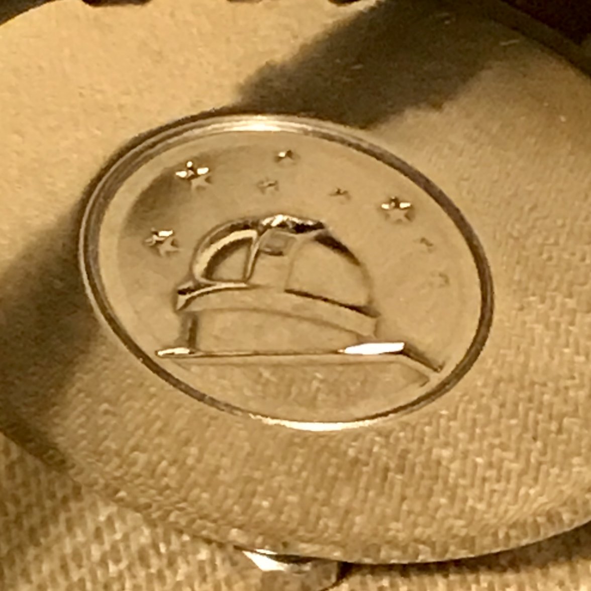

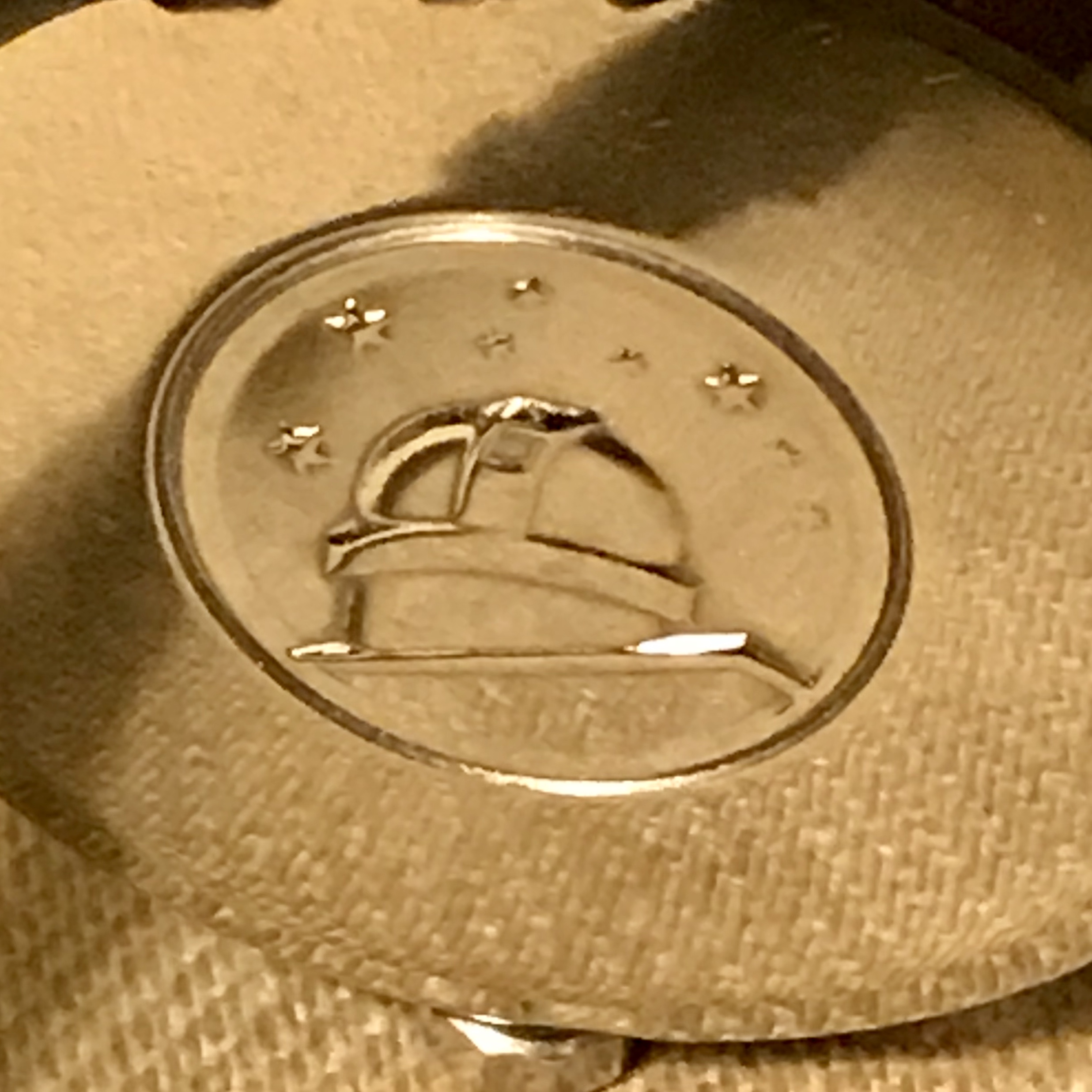

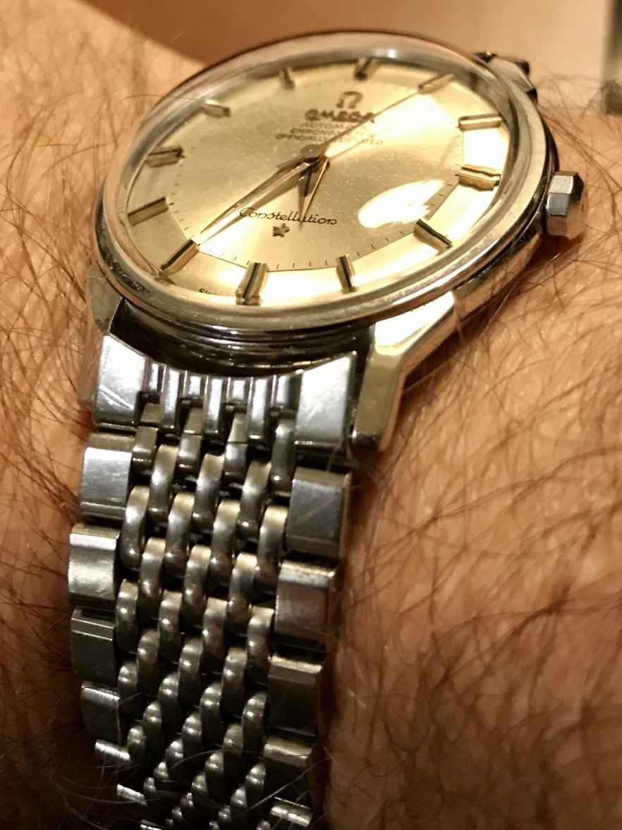

Surely this is an original dial now that I have seen a few?
10,125
57,939
Looks correct to me, but I’ll wait for the more experienced OF members to weigh in. Beads of rice bracelet. Not sure that the crown is correct (should be 10 sided?). Crystal and case both show some wear
10,125
57,939

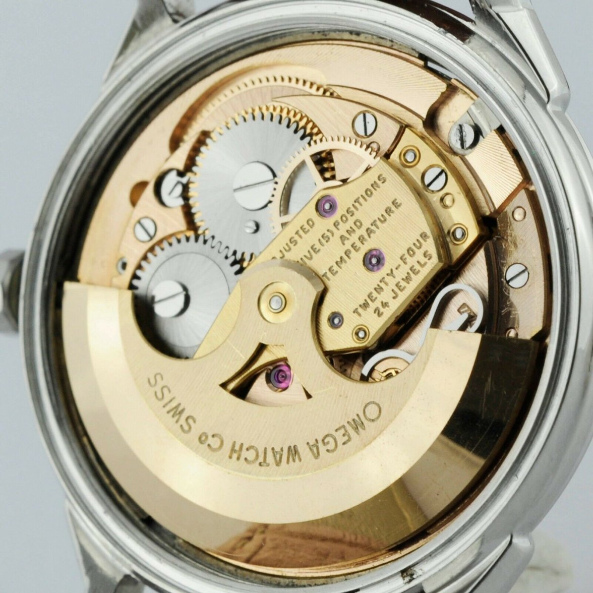

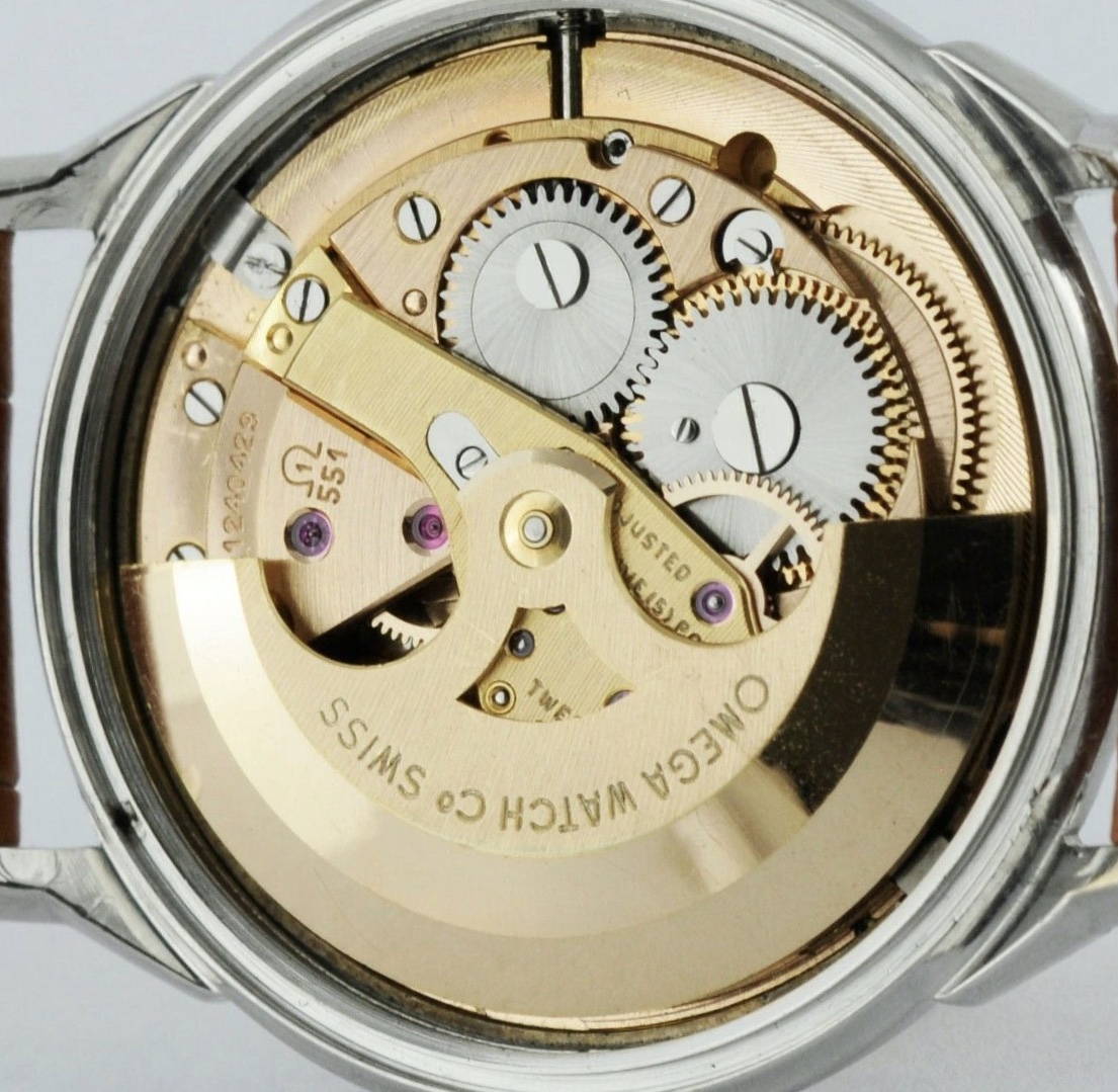

Looks like a 167.005, probably caliber 551. 1964 or so would be my best guess. Do you have a movement photo, first couple digits of the serial number?
10,125
57,939
The crown is replaceable, but I wouldn’t consider buying the watch without seeing the condition of the movement. Really need some better photos too, including the sides of the case, the lugs and the case back. Difficult to assess the condition without better photos. How much is the seller asking?
10,125
57,939
570 usd
$570 is a very good price with the BOR bracelet even factoring in a replacement crown, BUT you need to determine the condition of the movement and how much it will cost to service it. All in I wouldn’t go more than 1k, but that’s me. Others may differ.
10,125
57,939
And whatever you do, DON’T send it to Omega for service. They’ll ruin it.
10,125
57,939
Hmm its actually a seiko bracelet I'm told and the guy haven't tested it to see if it works. Hmm
Well, that might change the equation. A genuine used Omega BOR in good condition would sell for $200-$250. As I mentioned previously, the fact that you haven’t seen the movement and have no info on its condition would be a red flag for me. Add to that the need for a replacement crown and that the bracelet isn’t an Omega are additional factors to consider. But $570 is still a very good price.

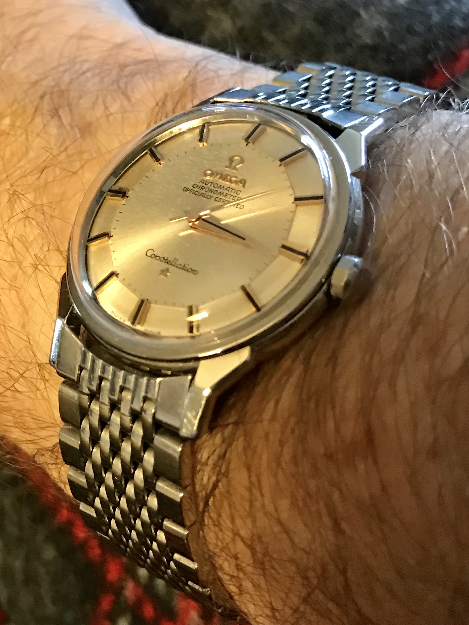

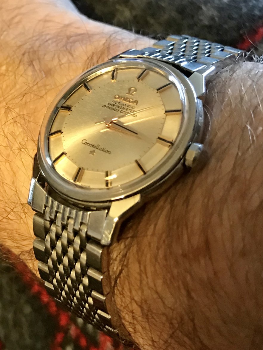

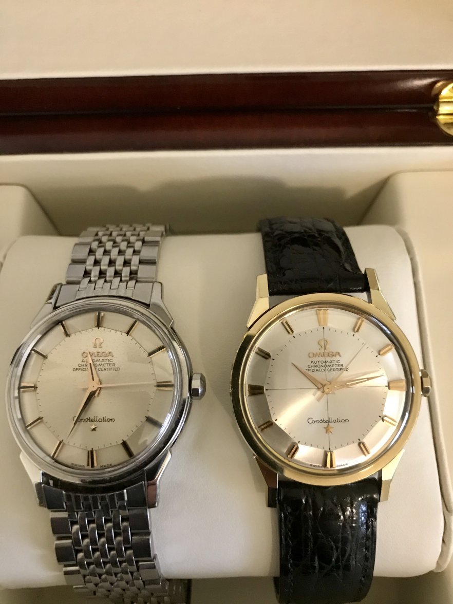

For comparison purposes, here are photos of my 1964 167.005 with its Omega BOR bracelet. I paid $1,245 total and that included a full movement service.
