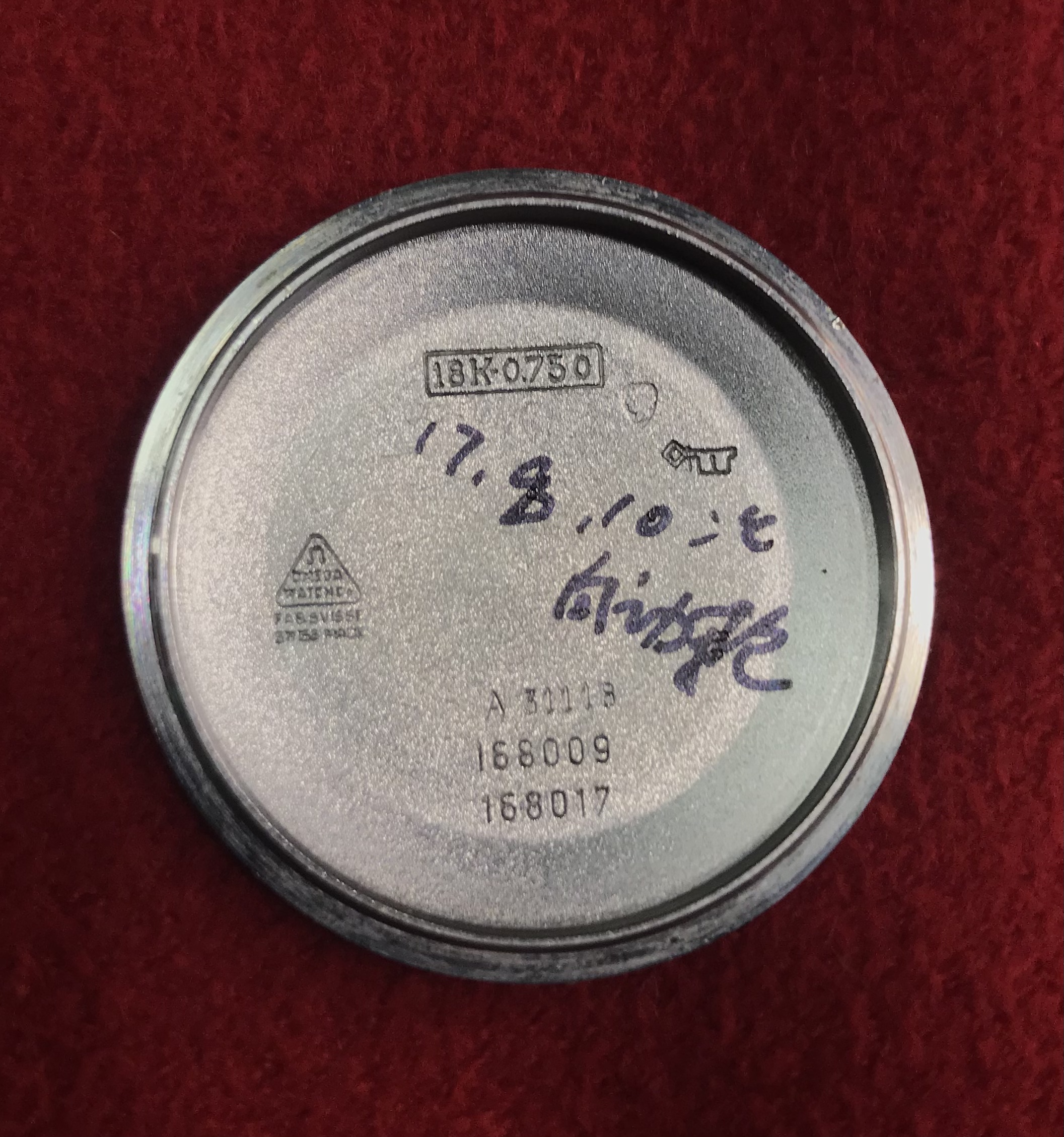

Witch hunt for saying that thing you said don't make sense? Being offered and owning a watch isn't same thing, but I will atribute that to english not being your or mine first language. So, can we see caseback of the watch in question?

@maxbliss888 if you have the watch in your possession, could you post some more pictures please.
Especially the rear of the watch and of the front and sides in better lighting.

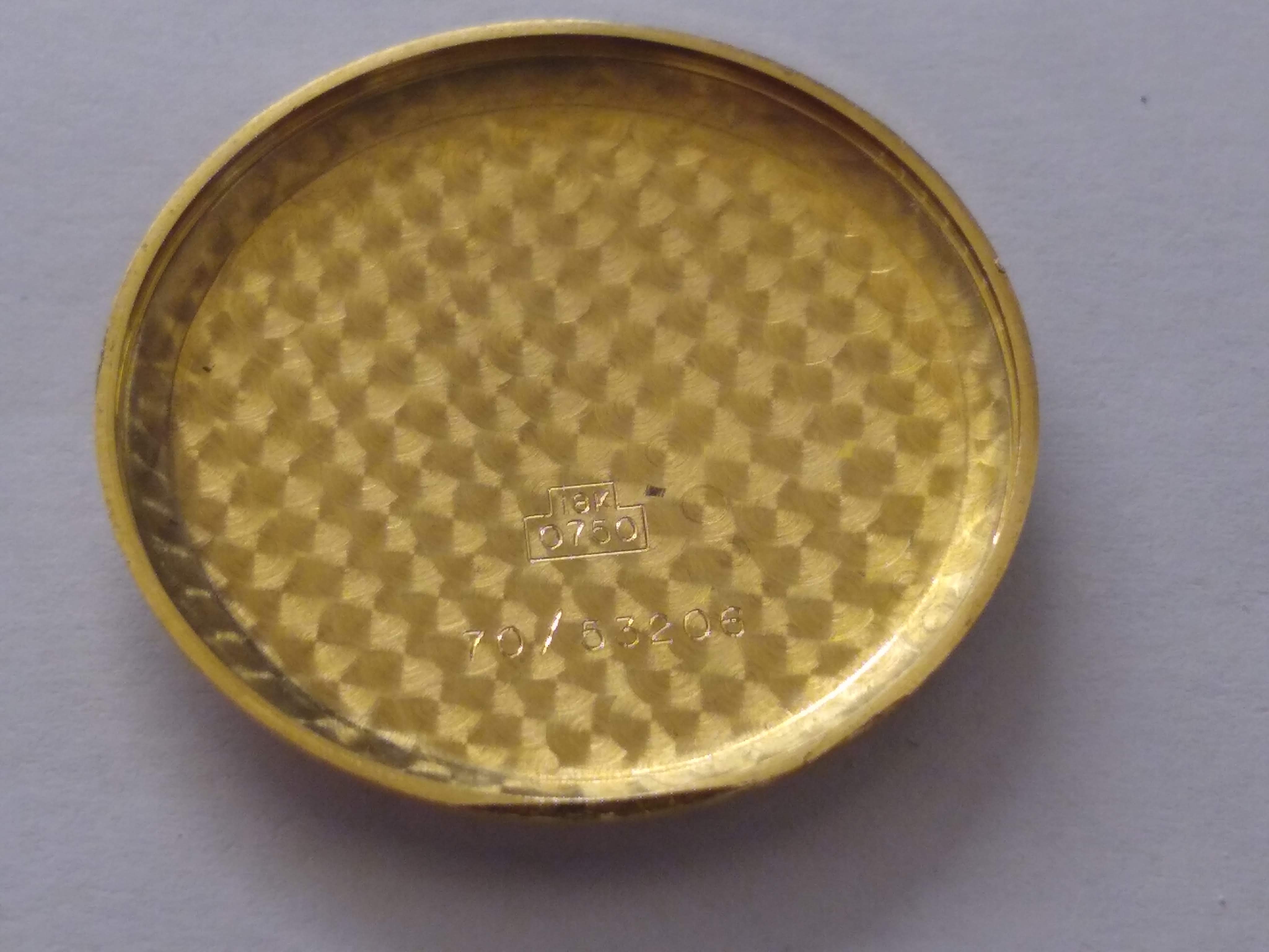

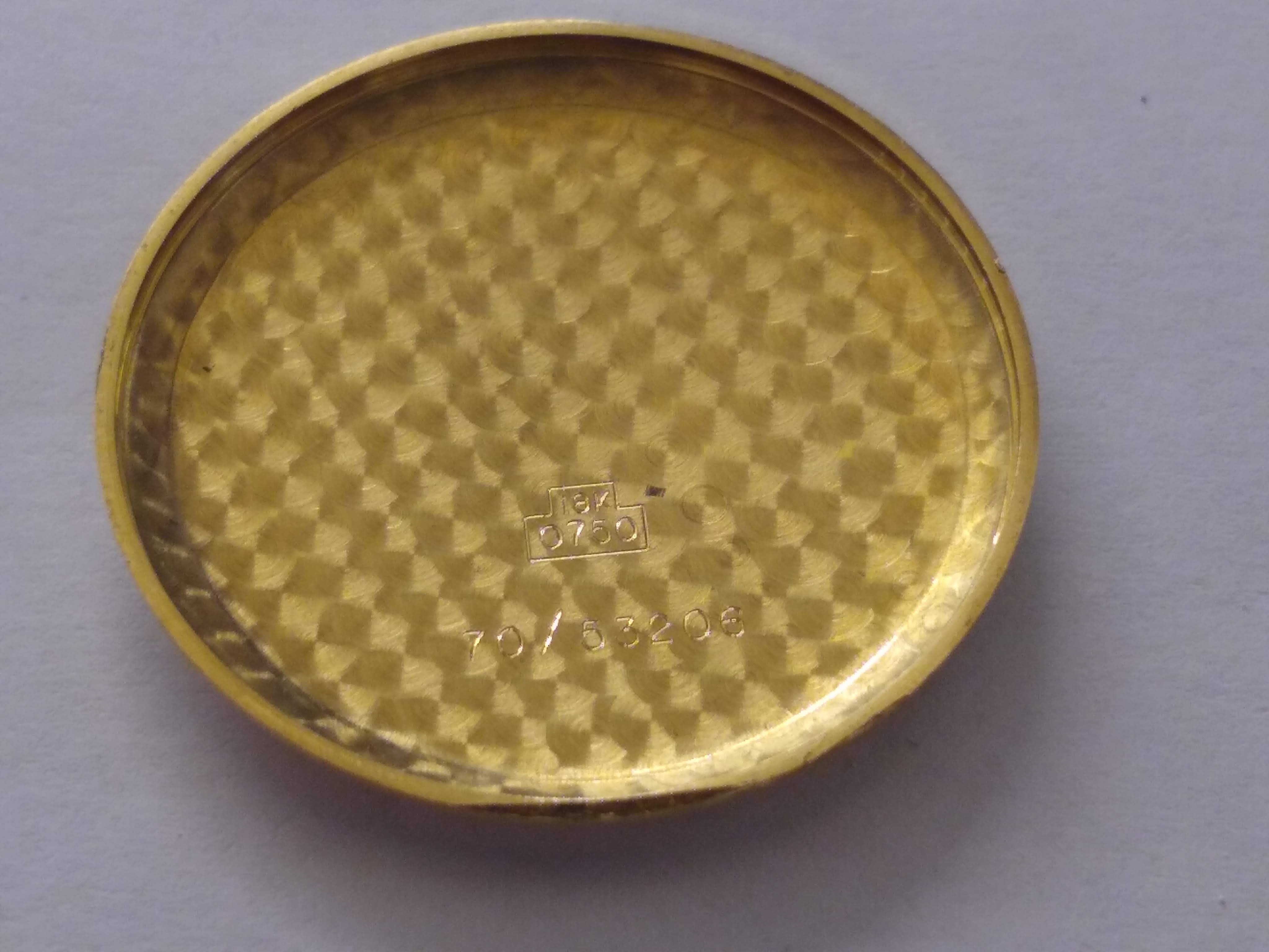

I have read your posts with great interest, as I am always interested in new discoveries. They do happen from time to time, sometimes here on Omega Forums, sometimes in other places online.
Unfortunately, in my opinion, neither of these two watches left the factory in the condition they are in today. Looking at the hallmark from the watch in your prior post, it is not from an Omega made case.
This case looks to be a snapback case. I am unaware of any “C” shaped snapback cases for Omega Constellations from this era. All I have seen are screwback cases.
I think the movements are legitimate, or unlike the cases, put together from Omega parts, most of which are still available if you know where to look. The dials may or may not be correct. There are so many really good copies coming from the Far East these days, I am very skeptical of any 50-60 year old watch dial without any patina.
This is only my opinion, and I have been wrong before. But I think these watches are frankenwatches at best and fakes at worst. Probably somewhere in the middle.

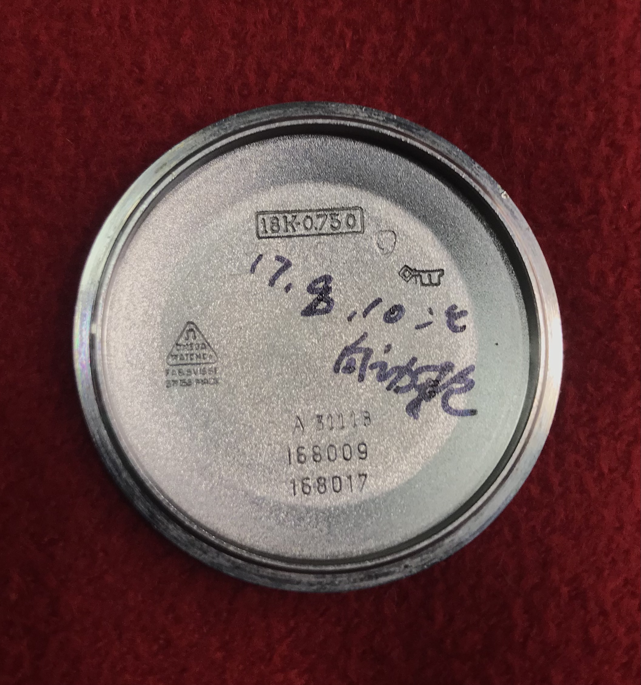

If you own it, lets go with the pictures! Side, back, inside, close ups, etc!

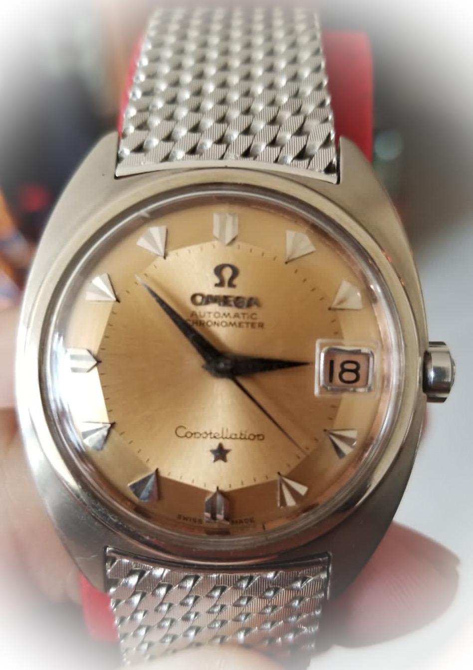

Hi. This is not my watch. I was trying to find out if Vintage Omega Constellation ever comes with a pie pan dial. When I goggle on line, I found the link below.
https://omegaforums.net/threads/need-help-on-this-constellation-pie-pan-dial.117068/
This is the watch that I was trying to get more informations
6,832
10,502

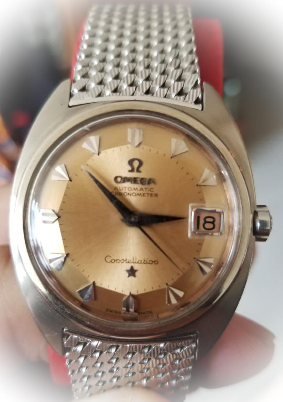

in your previous post about this watch, I offered the advice that the style of dial it has couldn't correctly appear in a c-case watch.
Both case and dial might be Omega but they have been put together by someone.
we would now like to see more pictures of the watch that is featured in this thread please, so that we can try to give you a better assessment of that watch.

Personally i think you should get your money back on those 2 watches
