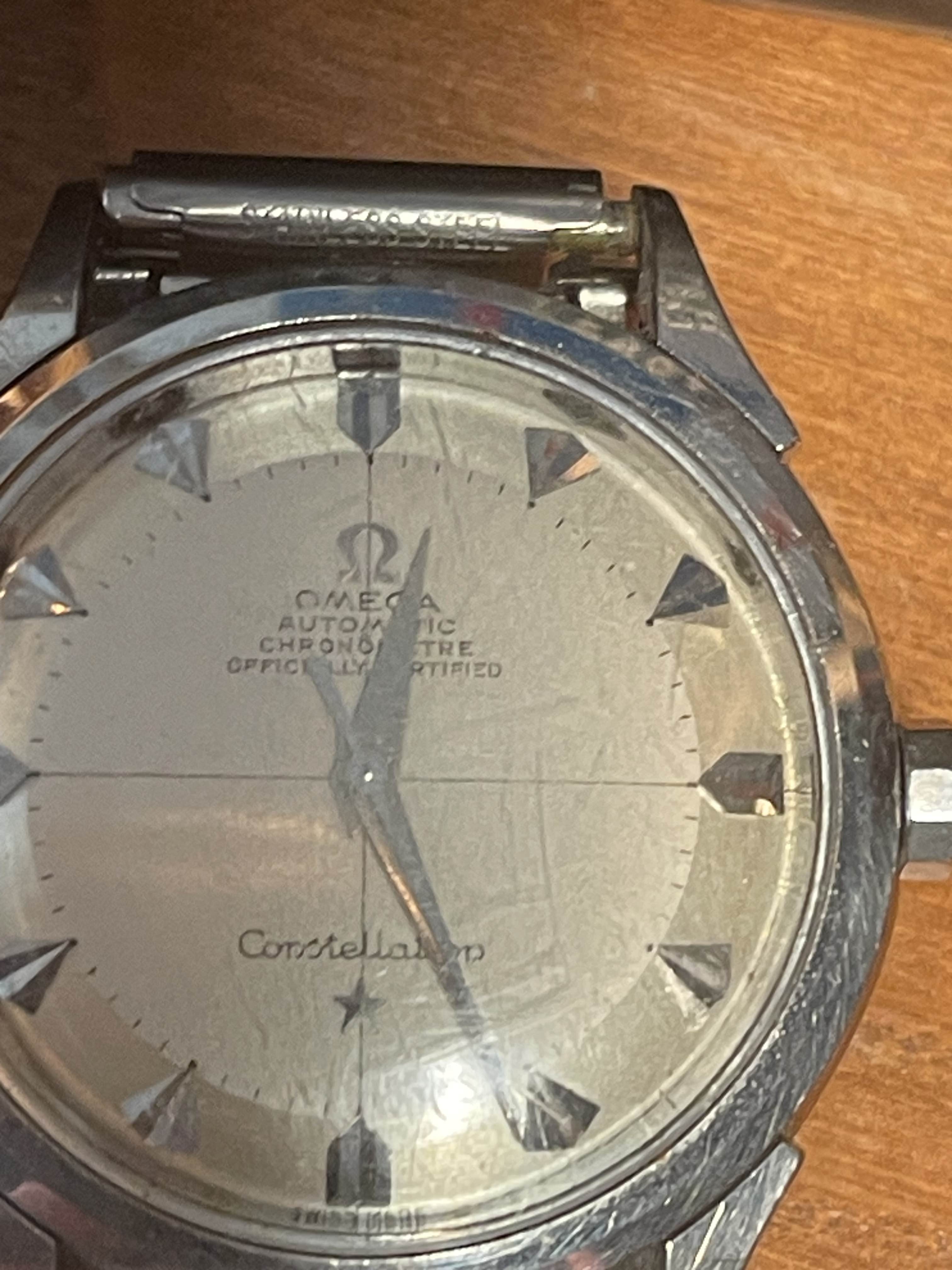

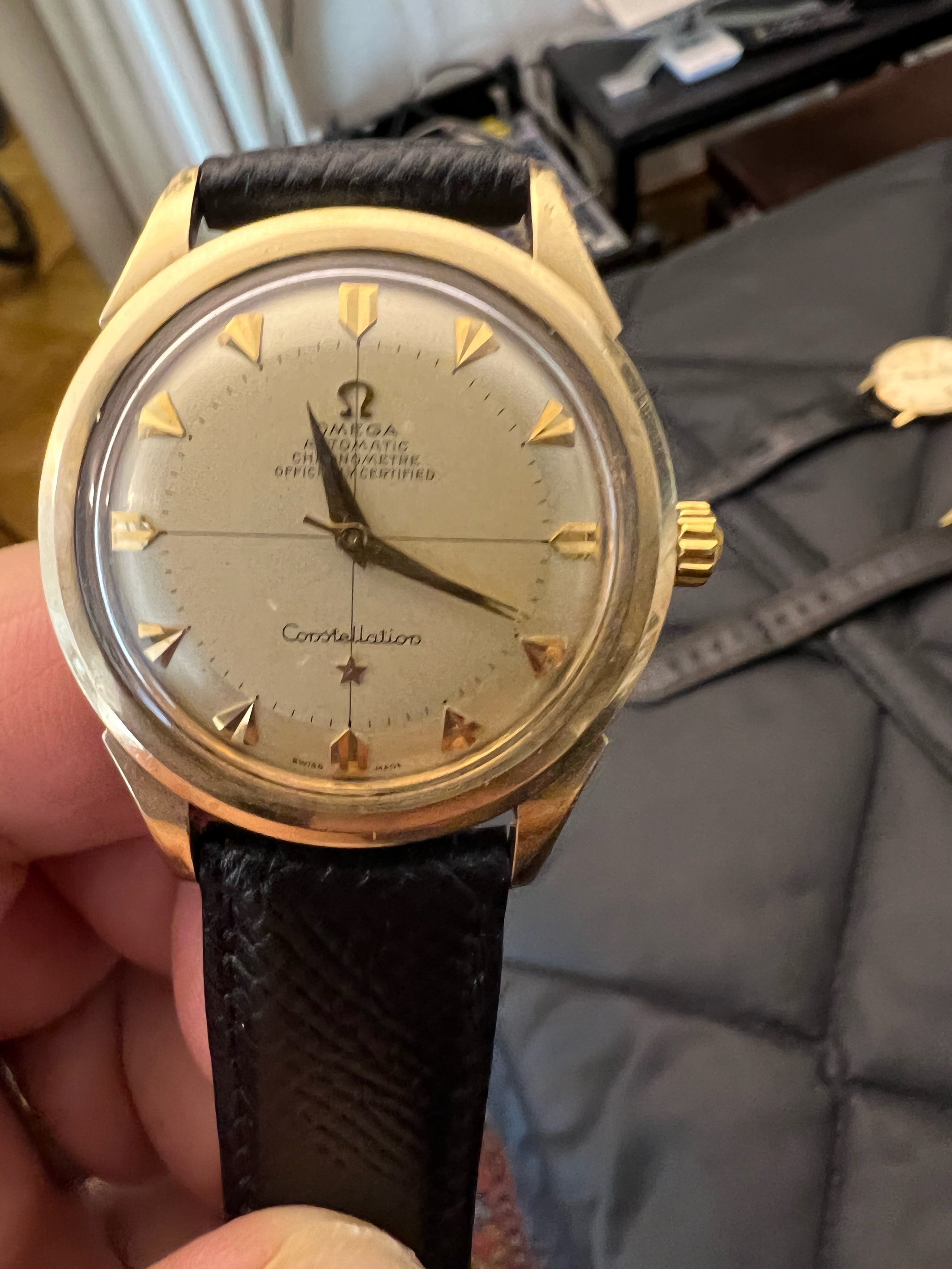

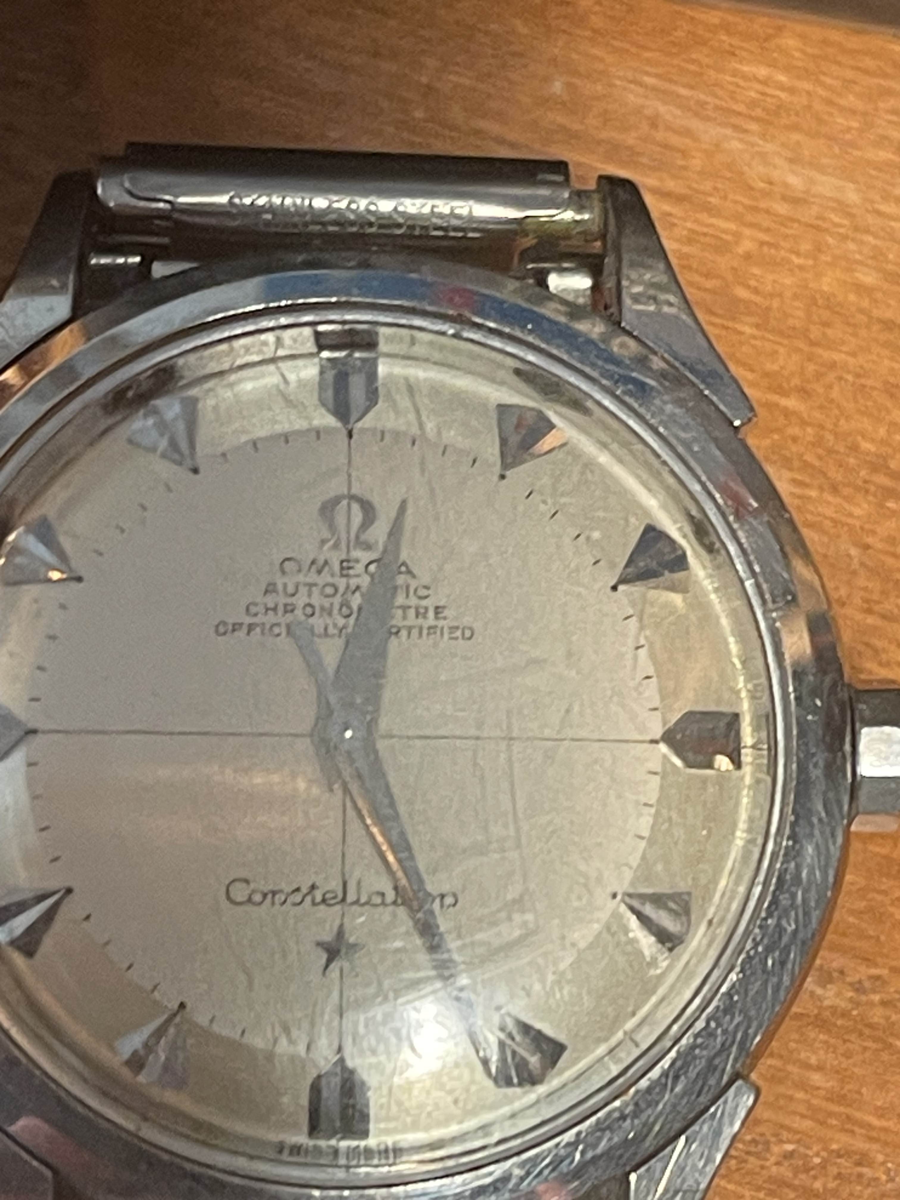

Hello all,
I need help IDing a vintage omega constellation.
It has
1. arrowhead markers
2. crosshair dial
3. i dont think the dial is pie pan either
4. all silver and white
5. case is stainless steel
There is also no date tracker.
I tried looking online myself but I can't seem to find any that don't have that pie pan dial.
4
Quick amendment here. It does have a pie pan dial however it is smooth between the hour markings. Almost exactly like the CK14381, but the dial is perfectly round instead of hexagonal between the hour markings.

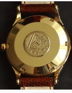

Not uncommon to have a dome dial like this. Do you have a pic of the case back? That’ll help significantly.
-re spelling of Chronometre means it’s not a 14381.

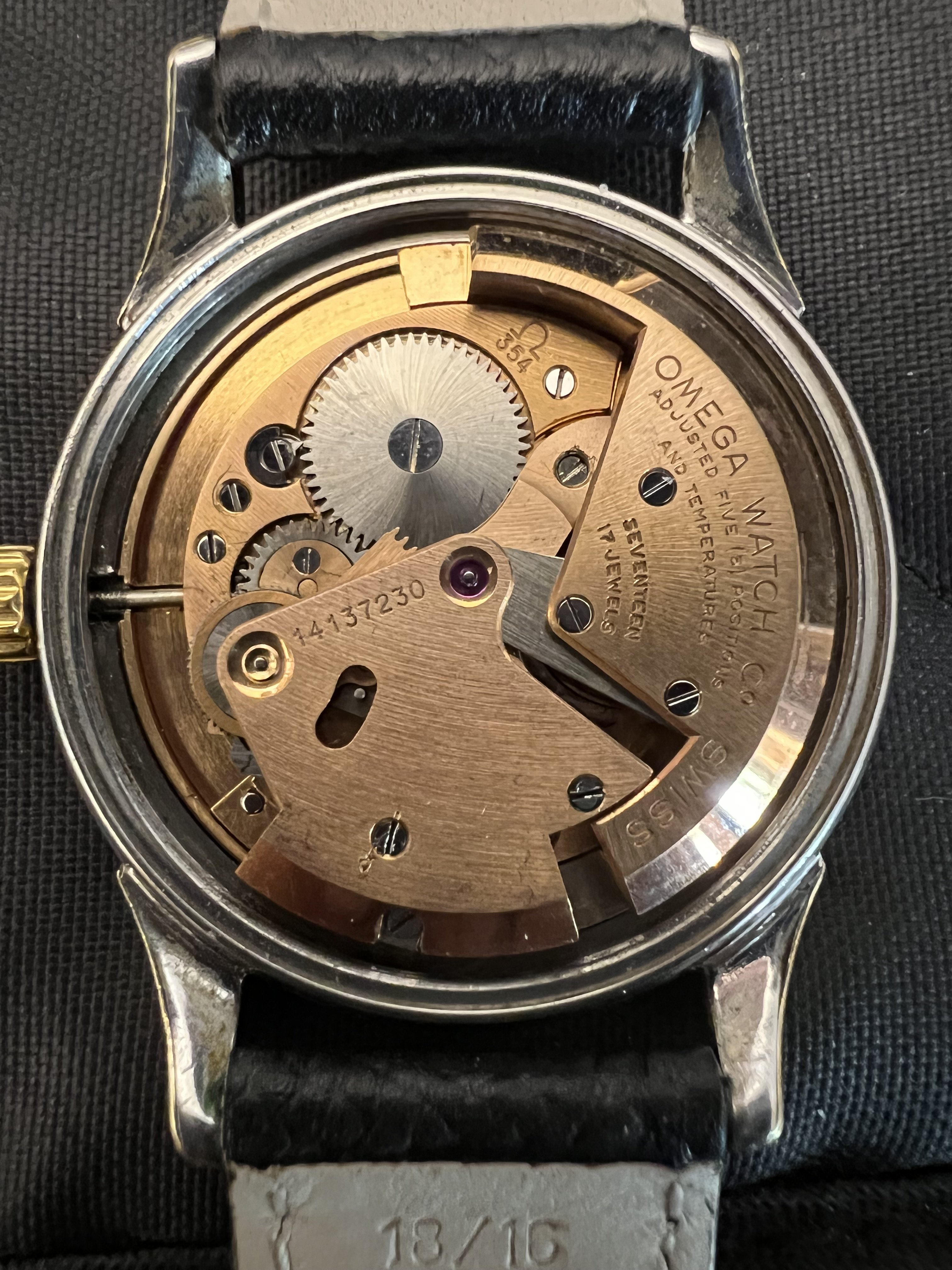

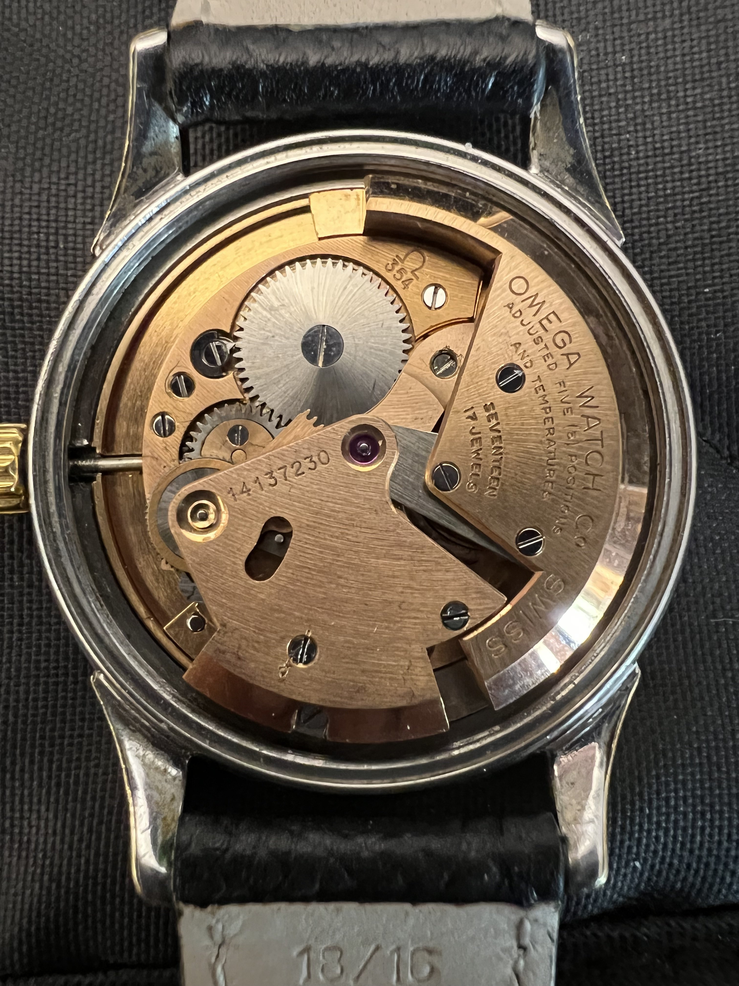

Can you feel if it’s a bumper or a full rotor movement?

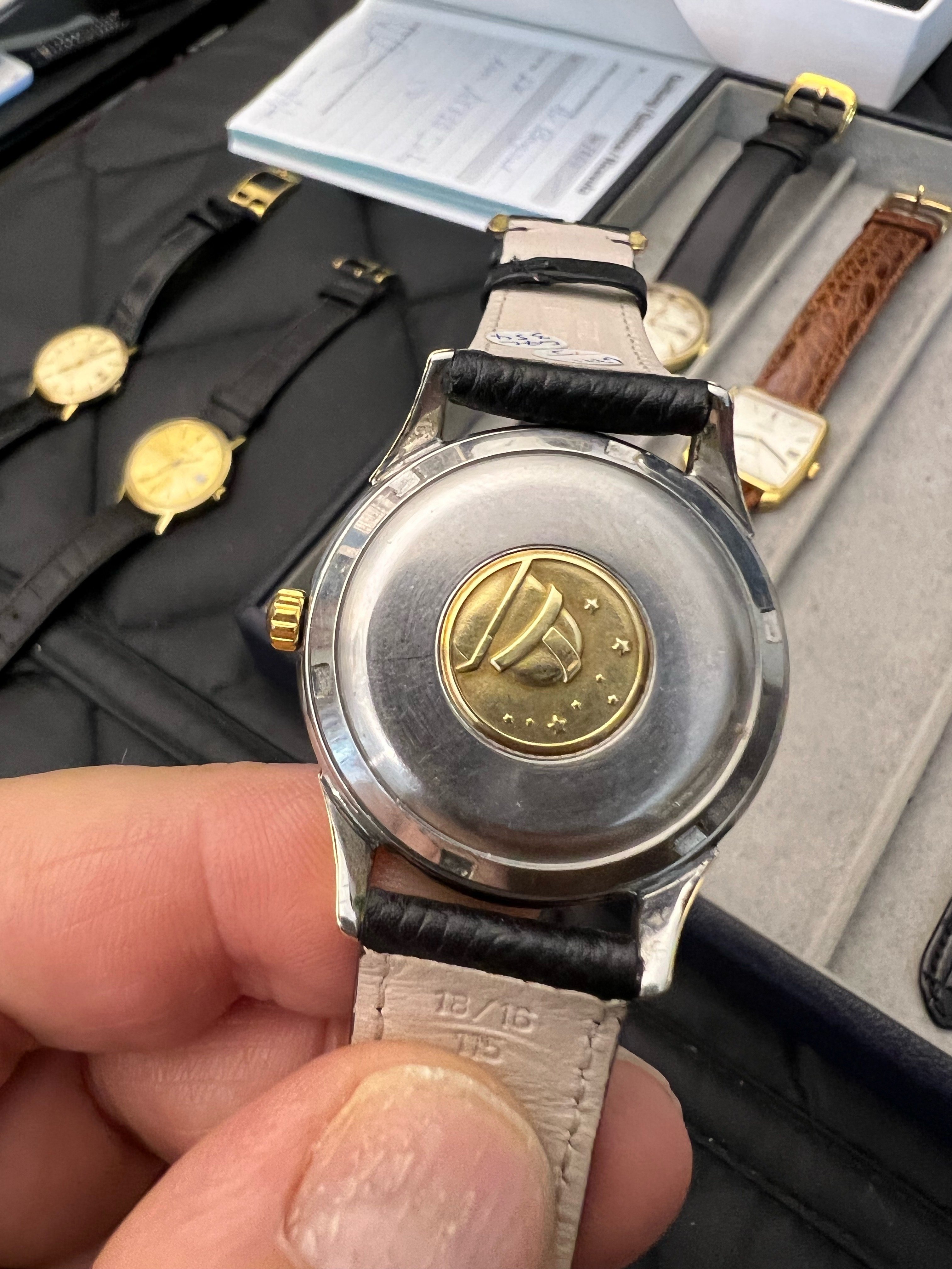

4
looks exactly like this, except the observatory piece is almost bronze while the case back matches the previous picture sent.
How would I be able to tell the difference in movement?

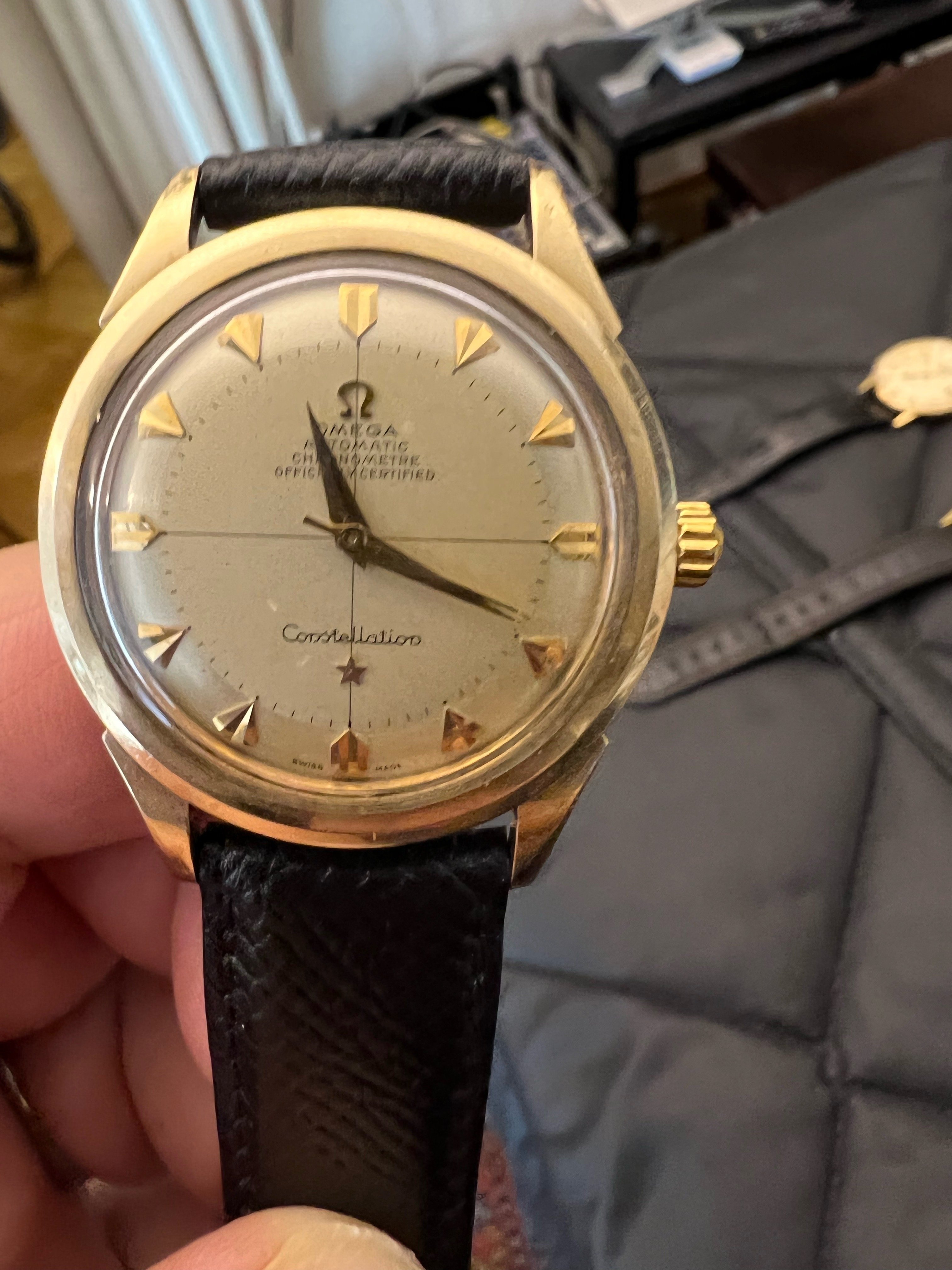

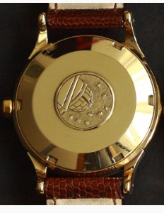

Here’s a gold cap version
When you wear a bumper movement watch you can feel a little thump or clunk periodically as the winding mechanism bounces back off the spring “bumper”. It’s quite distinctive and most people rather like it.
