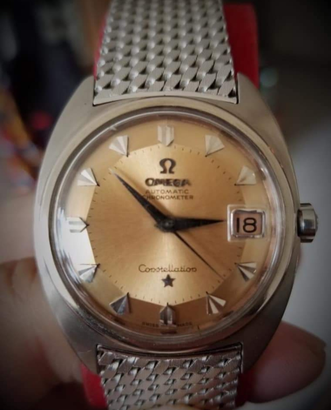

Hi! Can I check if vintage Omega Pie Pan dial With Arrow markers shouldn’t have the T Swiss Made T wording on the dial?
Thanks for your help.
6,832
10,502
Well, there’s no lume on the dial or hands, so it shouldn’t have Ts.
There are Arrow head dials with lume but I’m not sure that they were ever produced late enough for Ts on the dial.
Finally, this looks like a 168.010 case and so couldn’t have an arrowhead dial but even if is the earlier 168.004 reference, I’ve never seen one with an arrowhead dial.
As above, better pics needed to see if it is even a genuine Omega dial.
do you have any additional images?
This is a white gold version.
6,832
10,502
Do you know what reference the case is, or do you have an image of the case back?
The date of the watch is important as there are doglegs in the 62/63 range with arrowhead dials.
Black dials were special order - and if it is white gold as you say, then it could be a special order watch.
There are lots of reasons why this might not be correct but with Omega never say never.
If it is a redial, it’s nicely done but it still shouldn’t have Ts with no lume.

I agree with @Peemacgee about “T Swiss T”.
Maybe someone swap the arrowhead markers to this watch?

As I was told C sharp Constellation should come with flat dial and not Pie Pan.

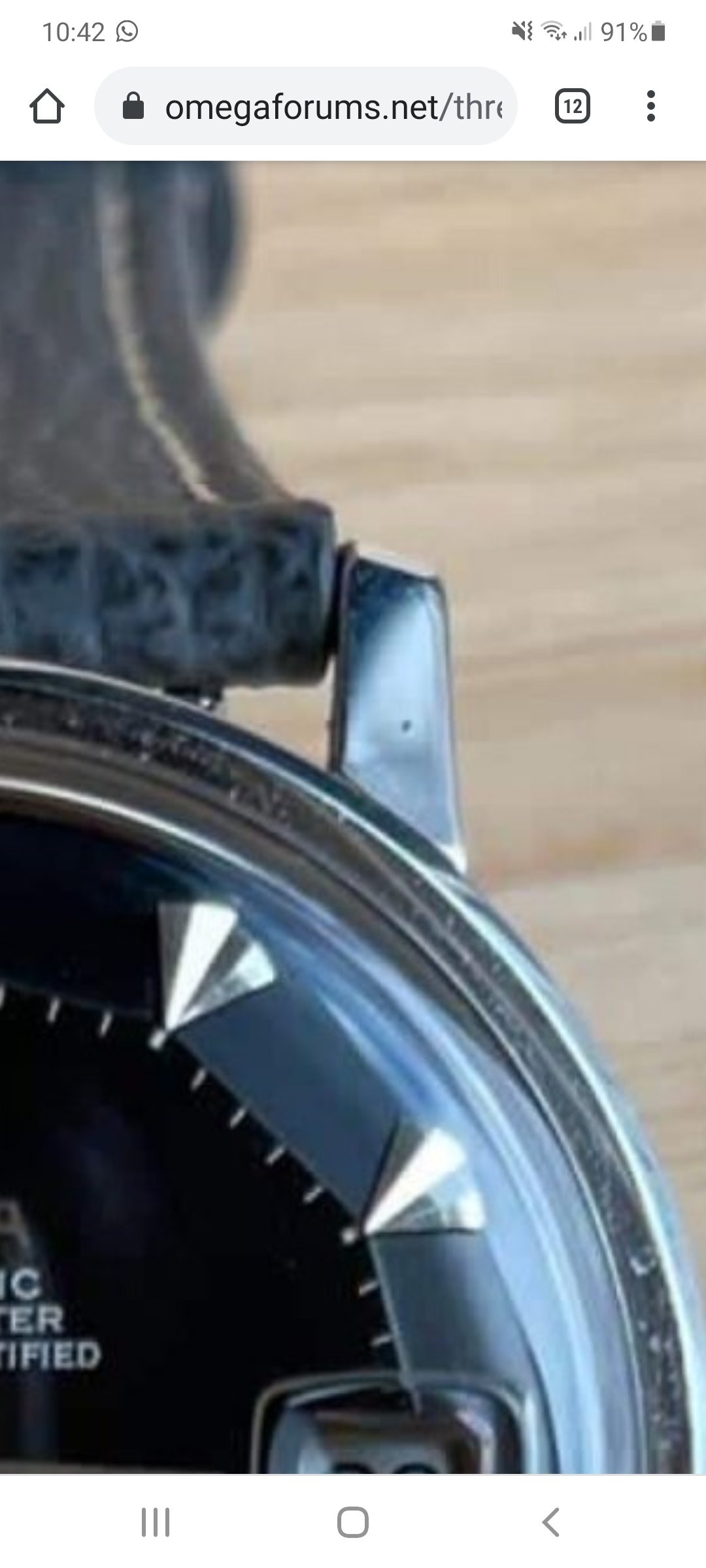

Hope this photo is better..
When I look at the (I think you call it) non faceted lugs it could'nt be a 168.010 unless it was polished to death. And they look too thick for a 168.004 lug.
9,588
27,706
I think it's a newer batch of counterfeit Constellations from the far east.
IIRC, @hoipolloi showed a gold dial version from Vietnam once that was scarily good.
5,026
18,608
I also have some strong doubts about this one. If it were me I would'nt touch it.
