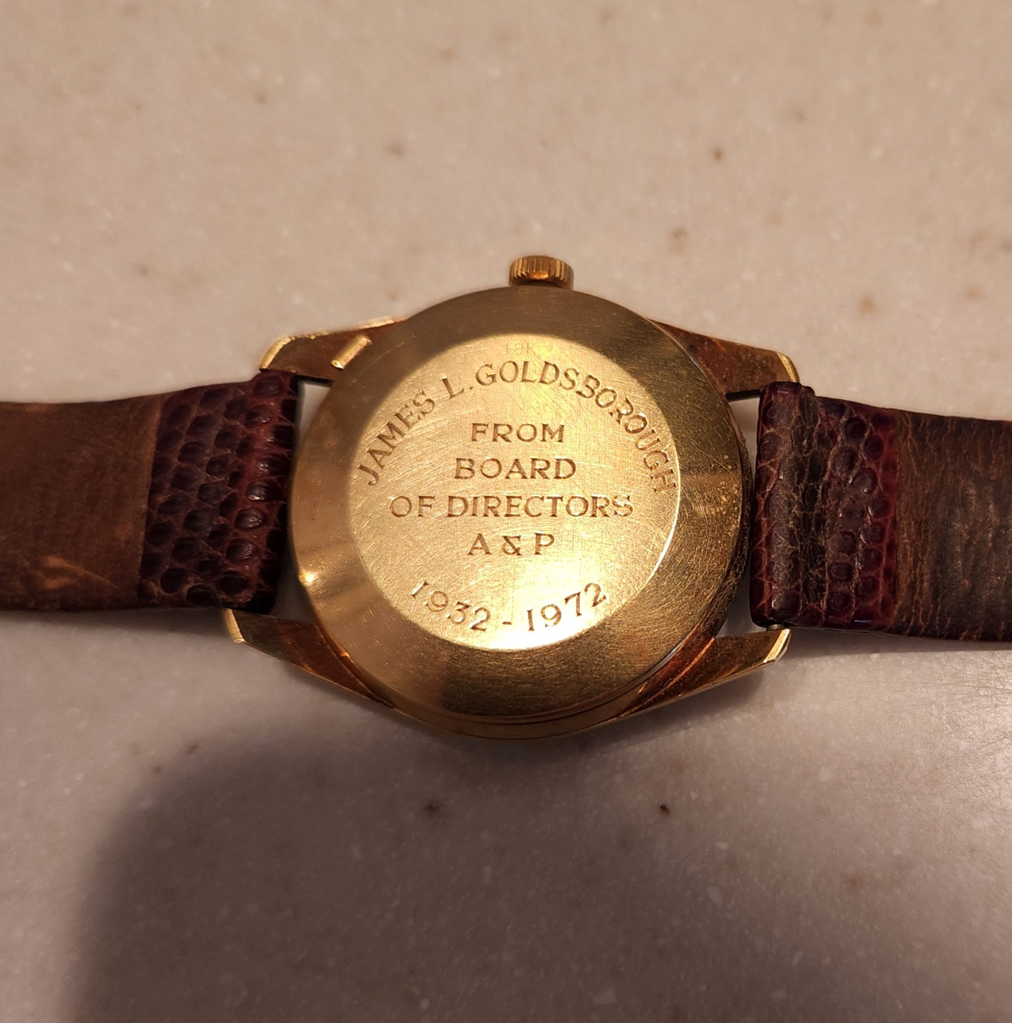

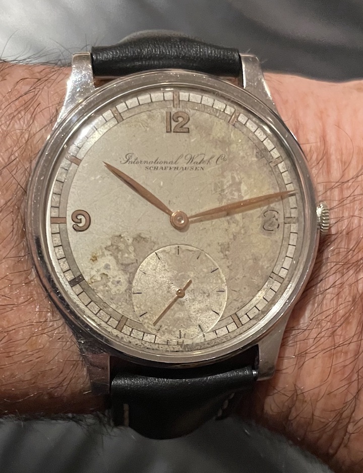

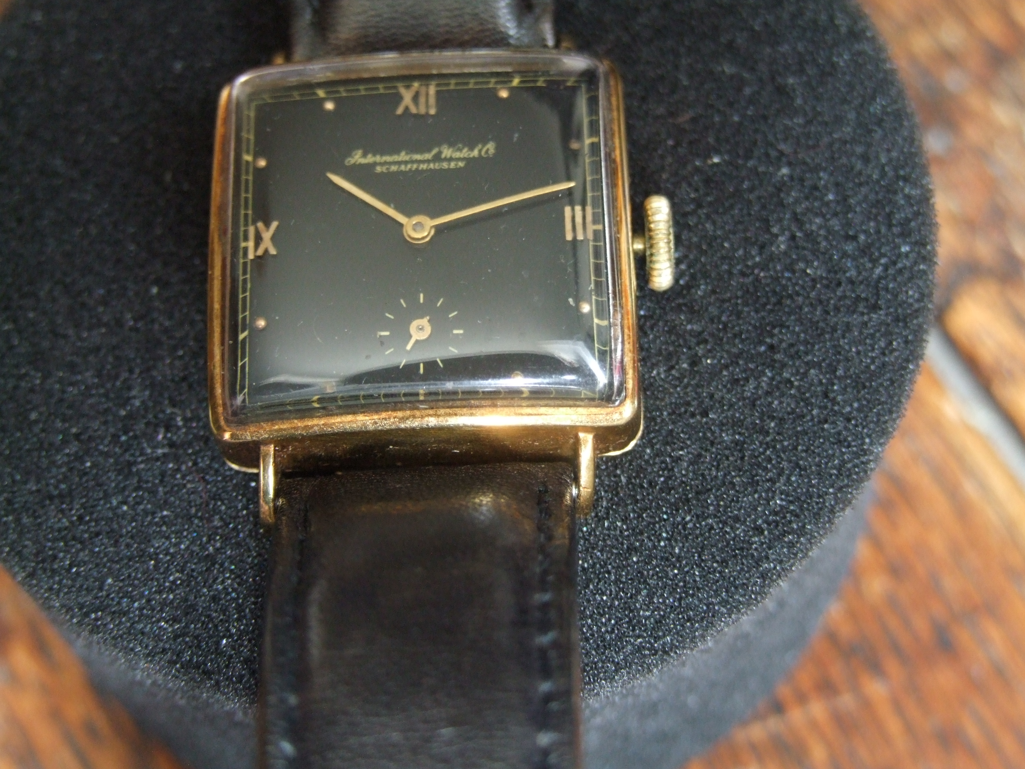

The caseback has 2 markings I've been unable to identify: a casemaker's mark "ML" and a dog/wolf’s head looking left with number 4 alongside. I assume the case was made by an external firm probably outside Switzerland. The case has fixed bars. If anyone is familiar with these markings, would appreciate any info you have.
lovely watch, the teardrop case is very appealing.
I believe the ML is a cameo type sponsor mark, to identify the case as it was present to some authority who assayed the case material as to its purity. My understanding is that the sponsor mark is applied first, then the assay mark is applied following gold content confirmation.
I was unable to find either the sponsor mark, or the wolfs head symbol with its number 4 following a quick search through a quick look of the online resources I have found. Perhaps others can help out. Consequently, I would agree with your belief that the watch was cased outside of Switzerland. The second link below shows marks cataloged from around the world, so with a fresh cup of coffee and some time, a deep dive into that link may provide the answer for you.
I believe you can get a COA from IWC for your watch. If you do, that may show you some clues as to the country the watch was delivered to, and may narrow your search.

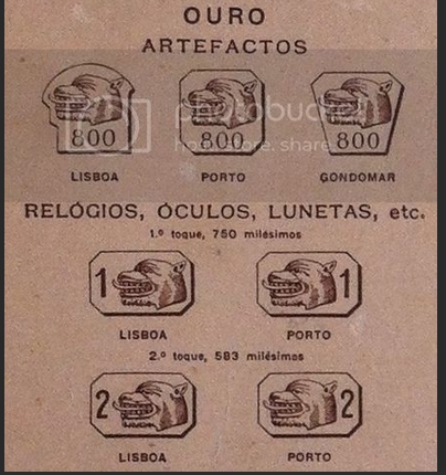

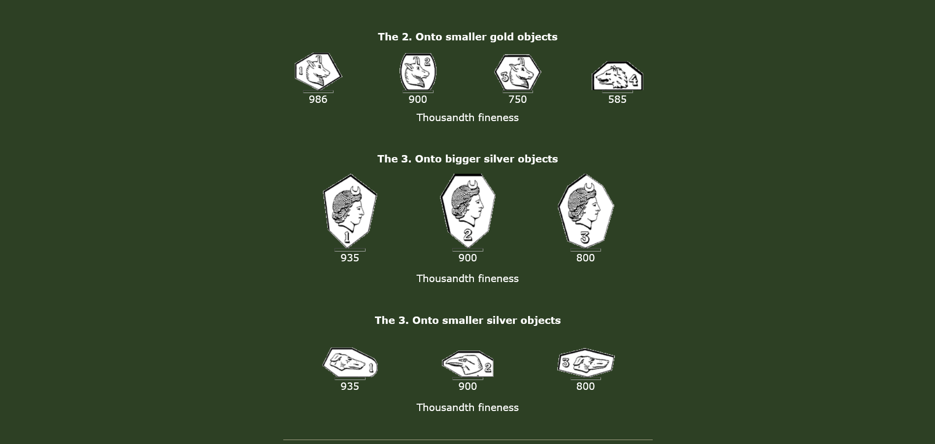

@Fallout Boy @Flatfoot Thank you both for your input. Further to my previous post, the only vague info from a few years ago I have about these marks was that someone who also has ML on their IWC caseback posted somewhere that it represents an unknown/unnamed Austrian casemaker. I've also read that the wolf/dog mark with 4 denotes a 14k gold case (and below graphic seems to confirm that). Hungary had marks with wolves but so do the Portuguese, as FalloutBoy mentions, so in all likelihood it comes from some place between the Atlantic and the Danube.
From (http://magyarermebolt.hu/catalog/hallmarks.php) ->

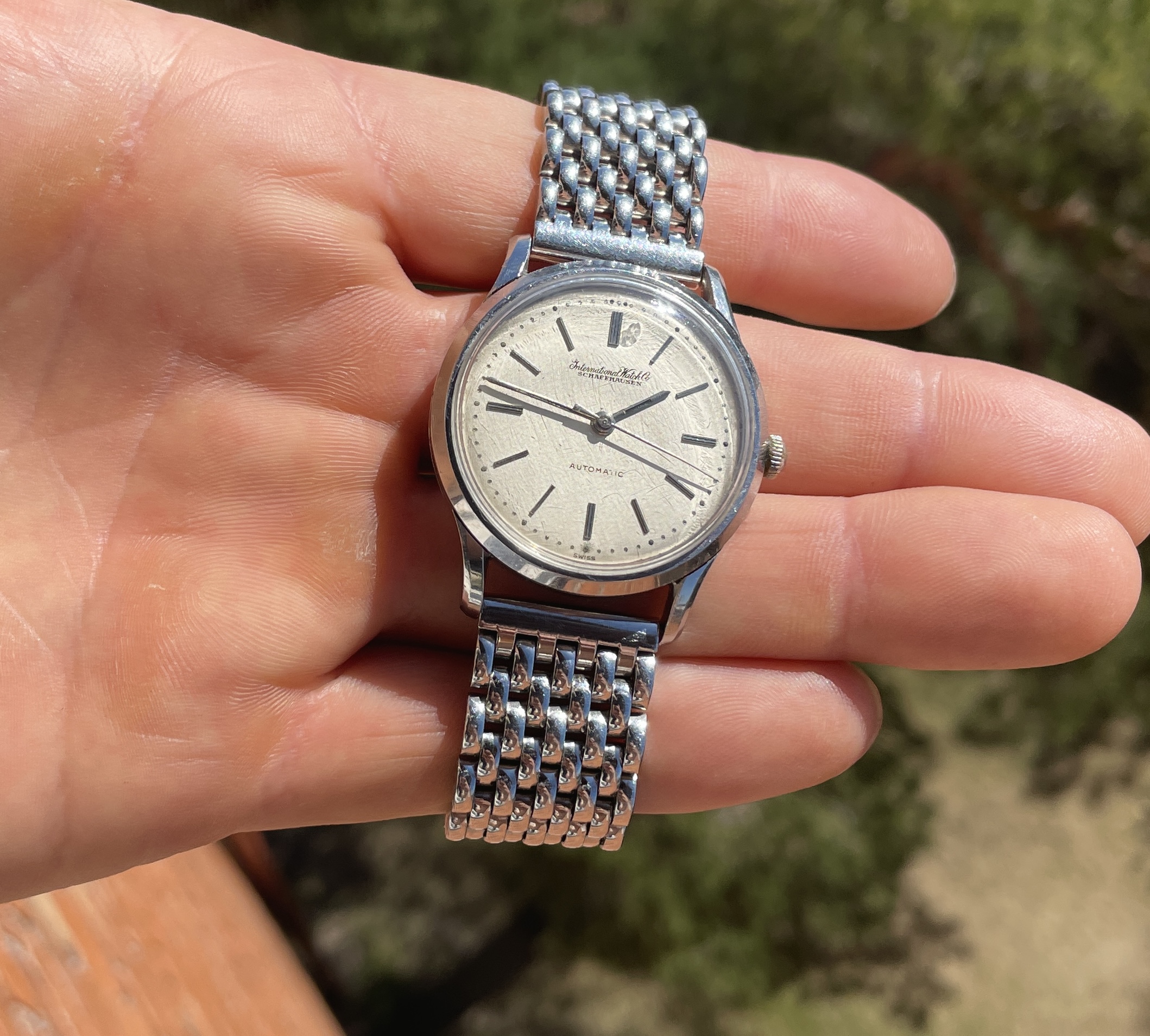

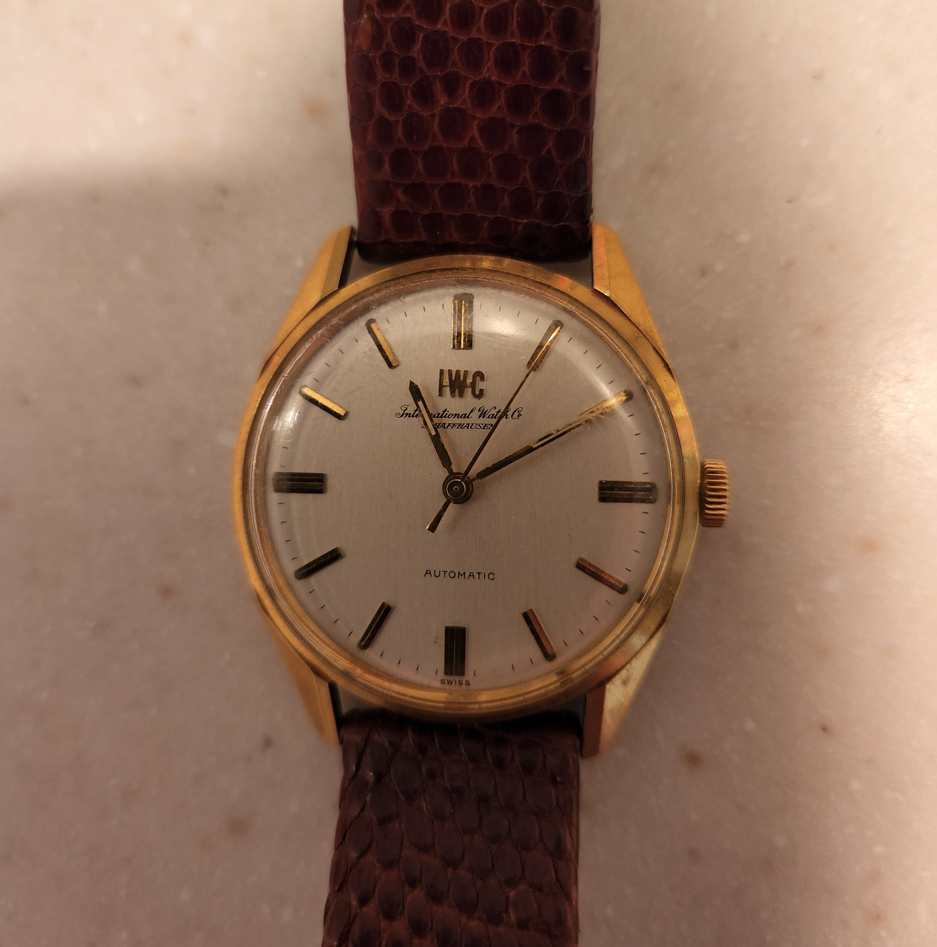

Can anyone help me with this one.Only I know about it ,is bought new 1970.I think it is some 1963.model.
Now I know it has no original straps,crown.glass and hands,all other is in perfect working konditions and all ove, watch is in very good condition for its ages , IT is 18k 750 solid gold model 36mm .
Anyone knows more or maybe some fair selling price?
Thank you in advance

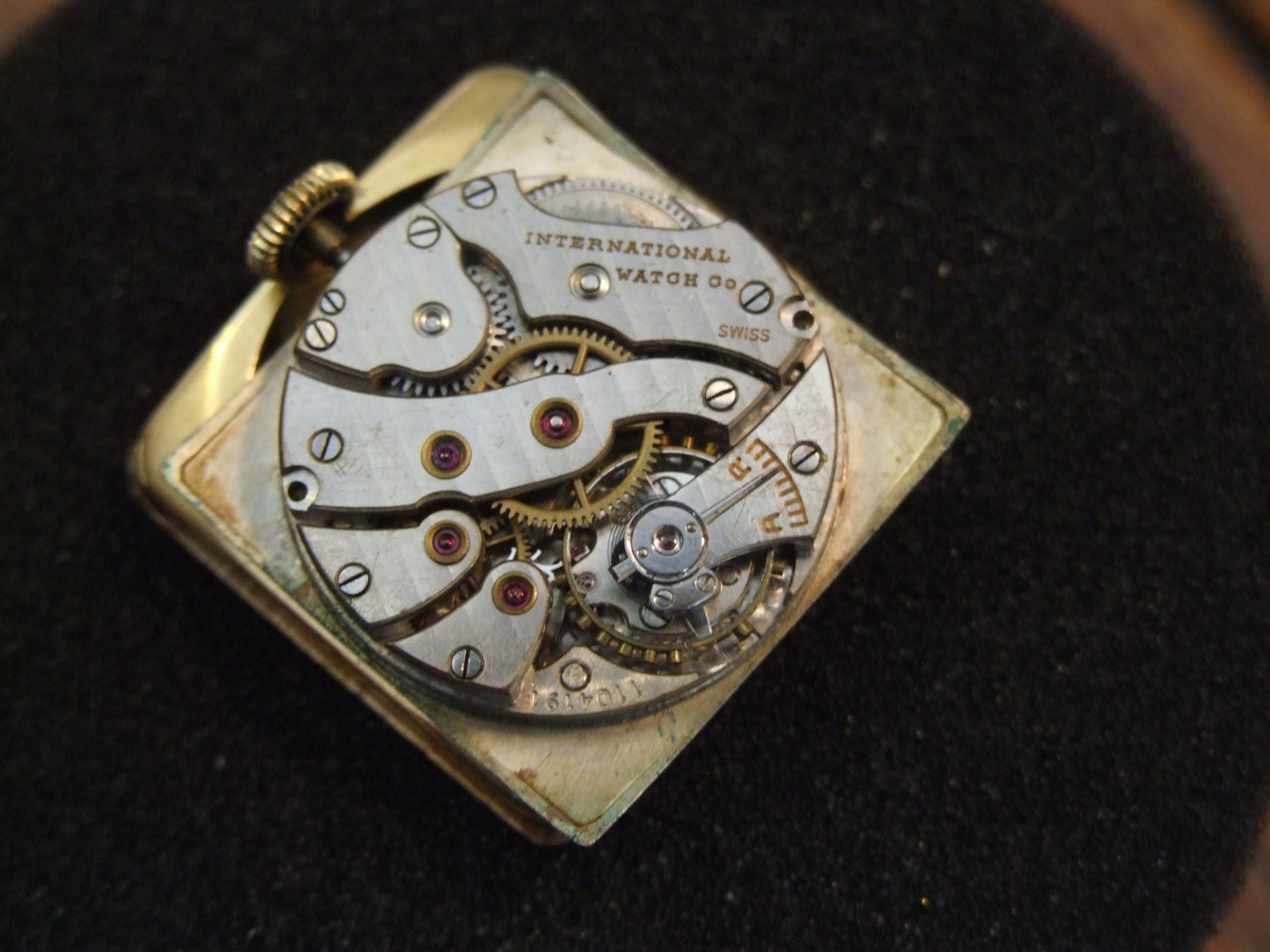

it was sold to me as a 60s watch but looking at the serial no 1104191 it coud be 40s/50s any other info greatly received

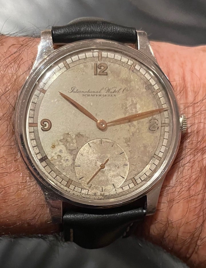

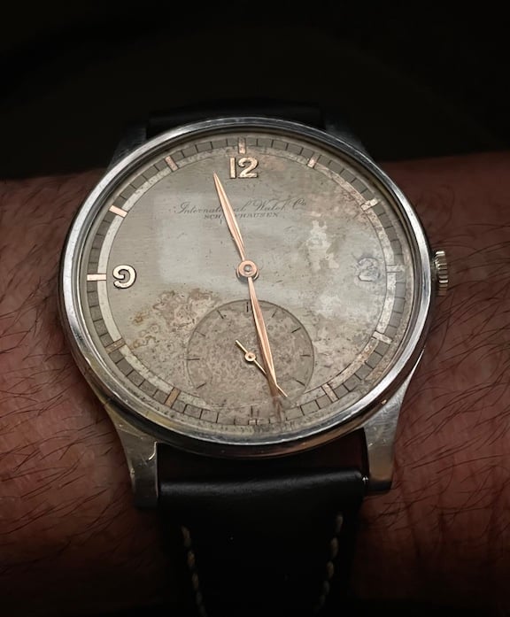

Just wanted to share one of my IWC collection, a Portugieser reference 325
It carries the reminders of time and humidity, but the dial markings still shimmer at an angle.
This watch is almost identical to the original 1940 dial selected by Michael Friedberg in this article:
https://www.iwc.com/en/forum/five-great-portugiesers.html (one must configure/allow cookies&location for IWC site)
At wrist-to-eye distance the aging/flaws on the dial are much less obvious. 😀

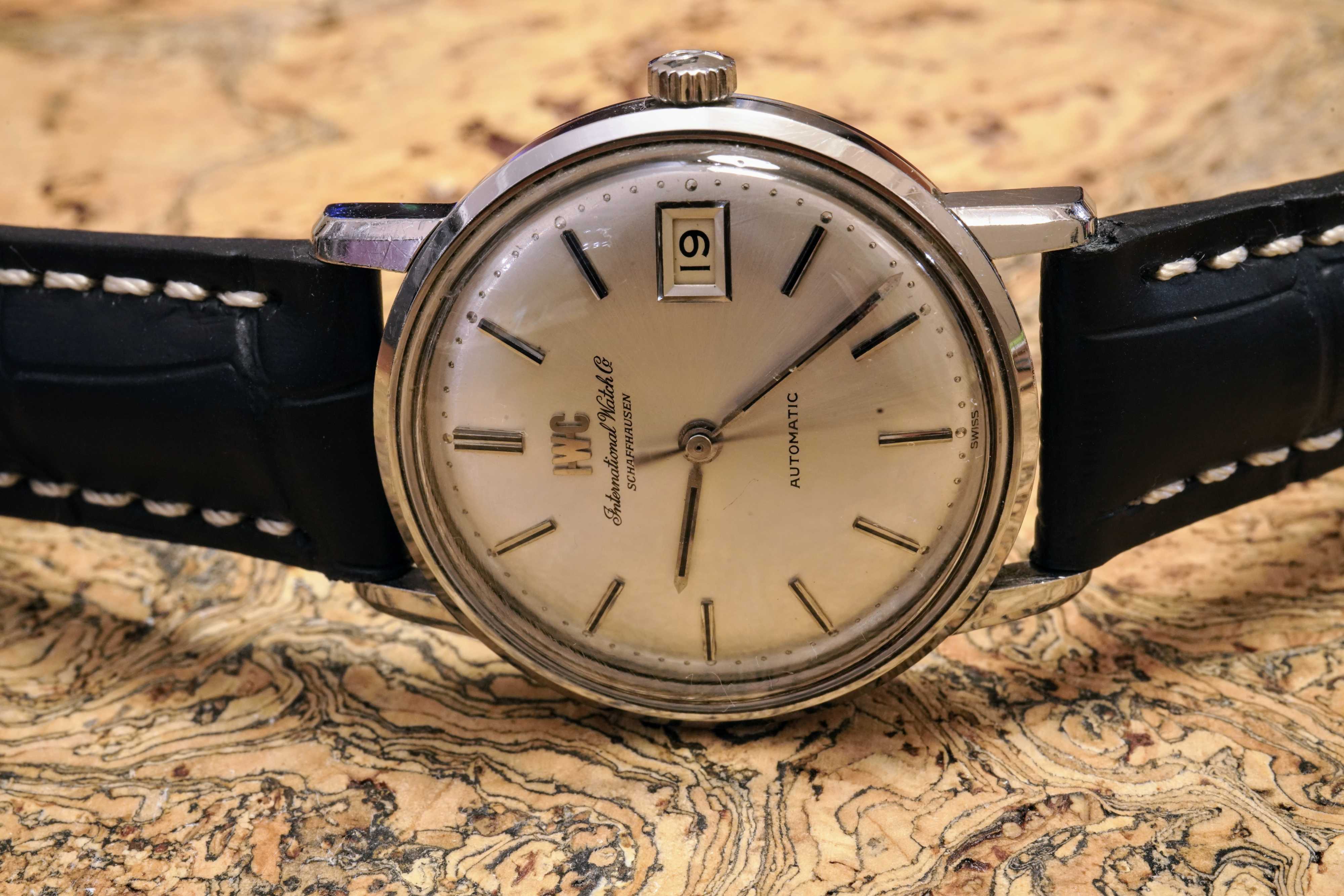

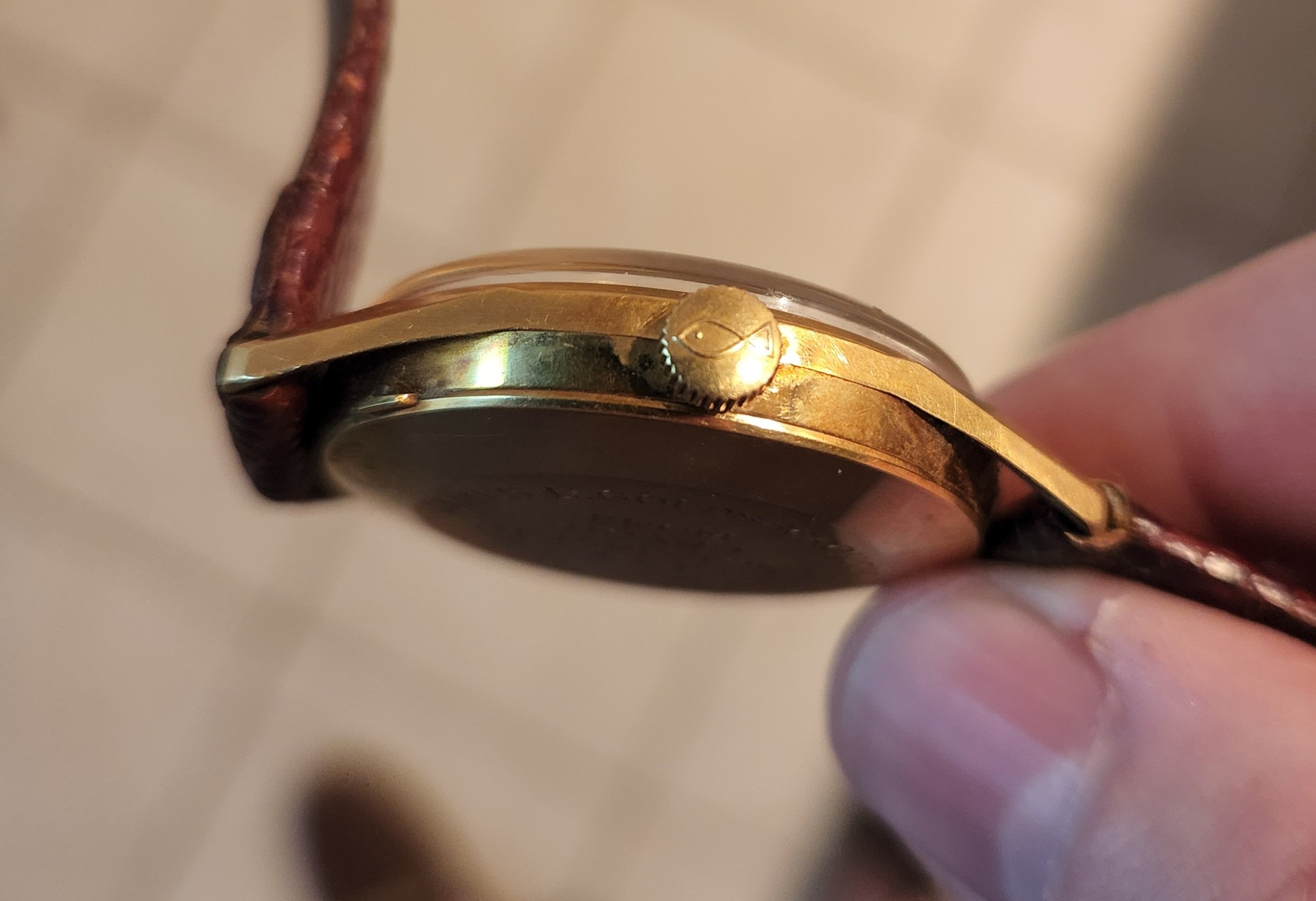

This is an area where I'm almost completely ignorant, and I'd appreciate any advice, suggestions, or comments.
I've attached a few photos of a vintage IWC. The watch belonged to my wife's grandfather. Her grandmother passed away a few months ago at the age of 98, and my mother-in-law found this among her mother's possessions. My wife has fond memories from her childhood of her grandfather wearing this watch on Sundays and special occasions. As the engraving on the caseback signifies, the watch was a retirement gift to her grandfather, who spent four decades as a butcher in an A&P supermarket. My mother-in-law has gifted it to me, and to my knowledge it was never serviced.
From what I can see, the watch was appreciated and treated with care. The dial seems good, as well as the hands, and I'm guessing that the crown is original and something that should stay. My intention is to get the movement serviced, the case tidied up (but not polished), and the strap replaced with an OEM strap and buckle. Anything else? Other suggestions are very welcome.

It’s good that you know the origin of the watch. Great heirloom. You have a sound plan but do make sure you take it to a competent watch maker.

I think this is IWC's model Ref. 810 A from the early 1970s. If you look at the third image/page in this scanned cataologue from 1970 you can see one that looks very like yours in gold, with a date feature (Ref. 810 AD). Without the date feature it is Ref. 810 A.
http://nakahiro.parfait.ne.jp/catarog1970/moji/iwc1970.html

This is very helpful. I appreciate it.
