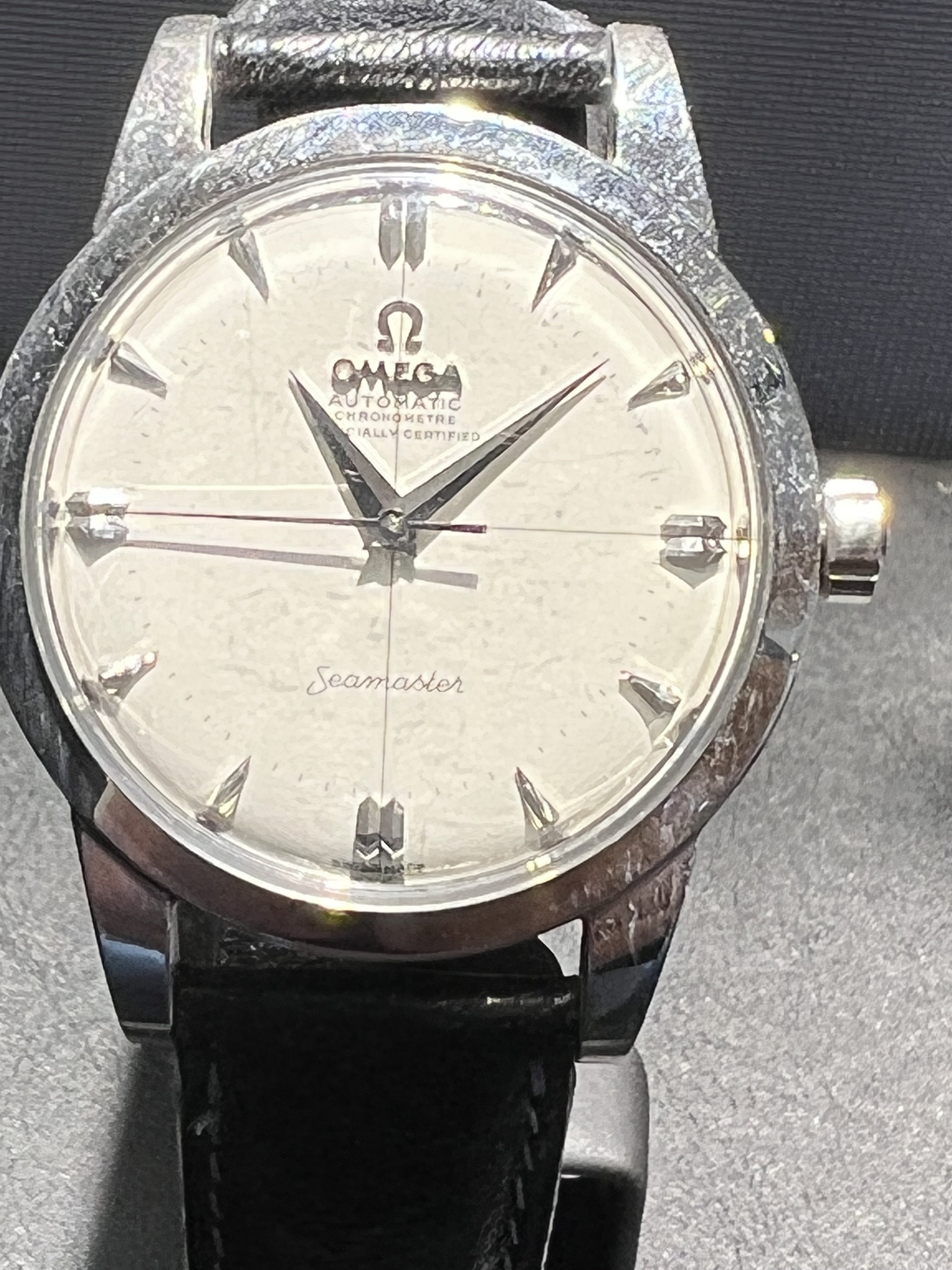

Let’s compare fonts:
OP watch:
cs-jpg.1824753
A Seamaster from the same time period:
https://omegaforums.net/threads/let...waffle-and-hobnail.173187/page-4#post-2384634
Close enough for me. I think they are both original.

If that's a redial, it's a damn good one. The crosshair lines on a redial are usually a dead giveaway. These look exactly as they should.

Exactly my thoughts. Looks genuine

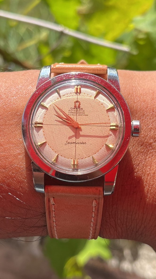

I took this photo at Omega Museum in Bienne couple years ago. Just noticed the font very similar to OP example. Little blurry taken through the glass case but can make out font
Looks quite similar to me!

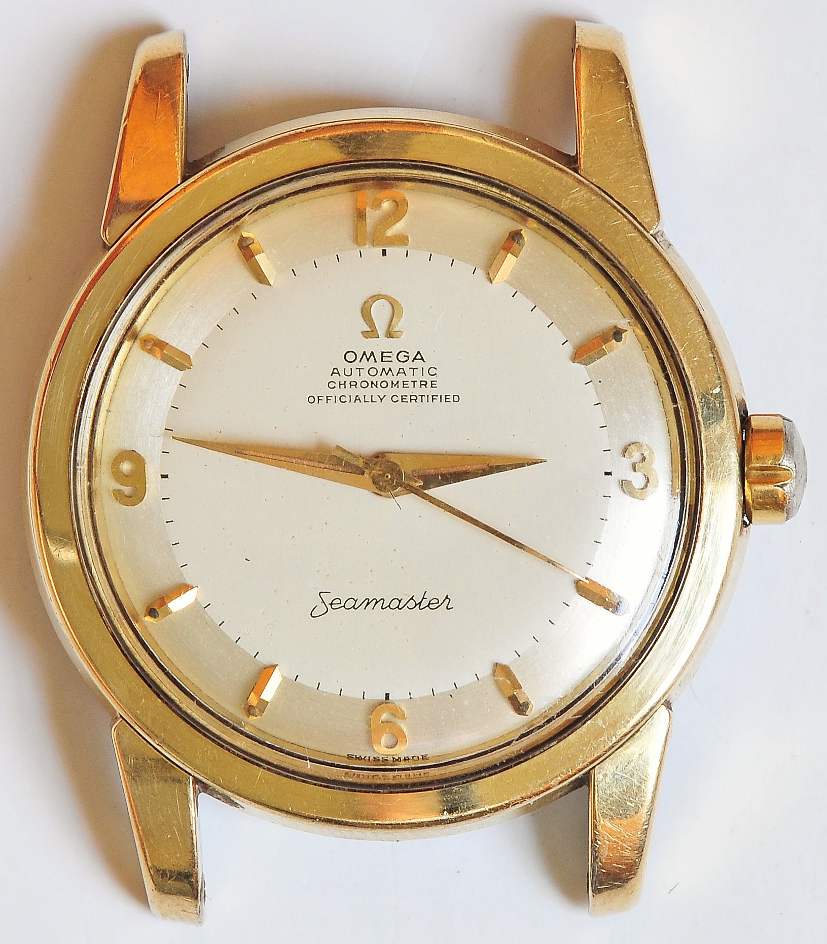

Not necessarily. I have watches in my collection that are 65+ years old with original unrefinished dials that look new. Here’s an example:
