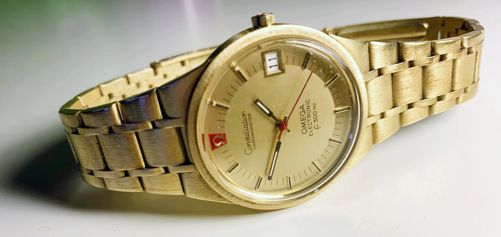

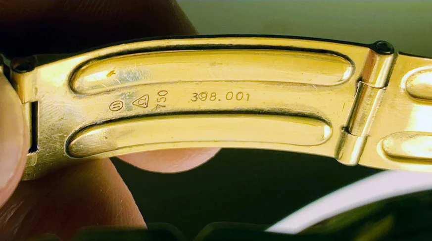

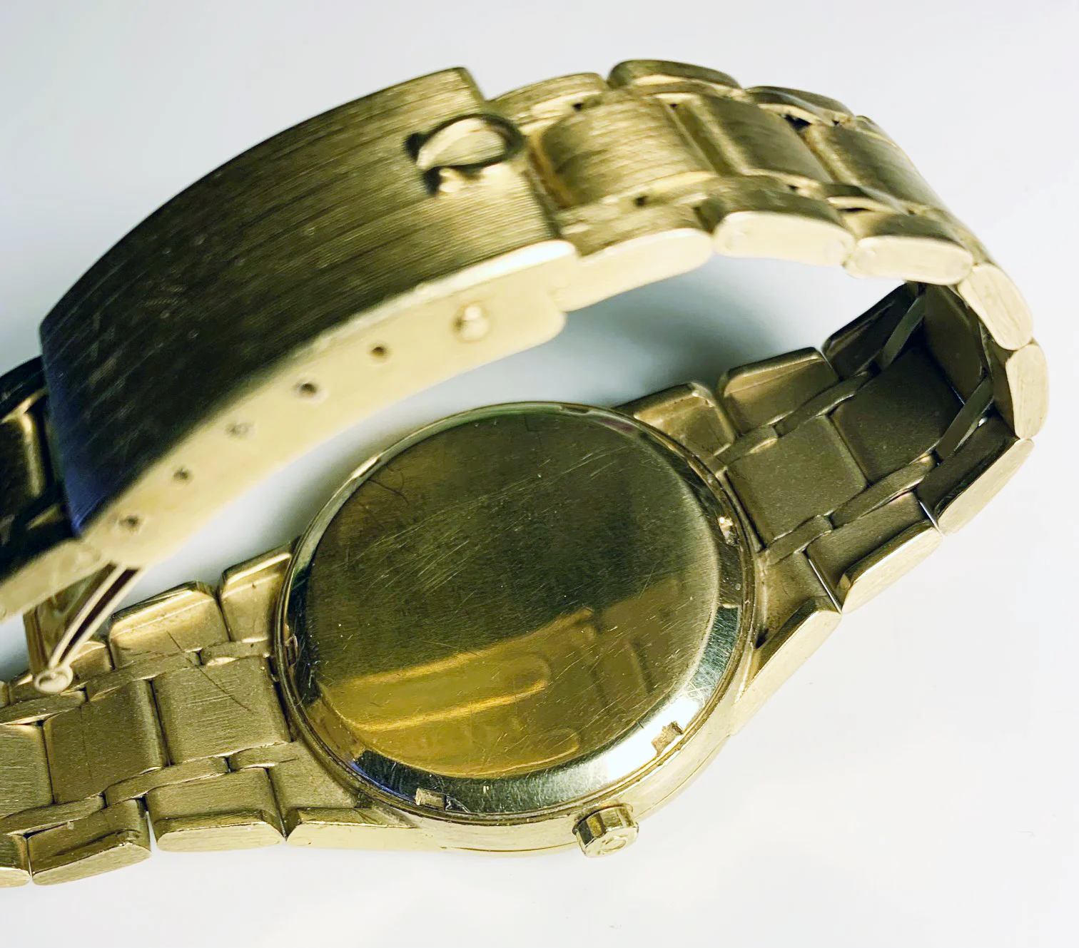

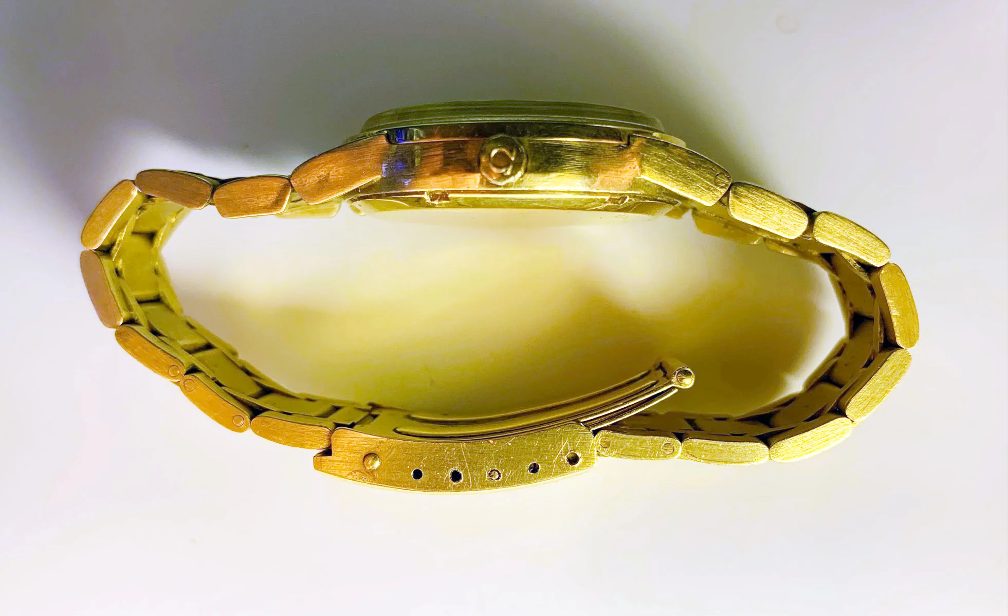

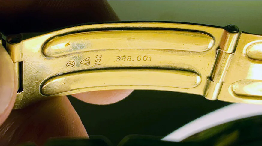

Hi there. About a decade ago, my grandfather passed away and I received this watch. It has been sitting in my safe ever since, but I have not been able to find much information on it. Red and gold logo. On the face it shows it is an Omega Constellation. Electronic 300Hz. In very tiny print at the lowest end of the face, I believe it reads "OM Swiss Made OM". Omega symbol on the outside of the clasp and stamped inside as well. The other stamps are "11" encircled, "750" & "398.001" (I think). I assumed the 398.001 was the model, but I really could find nothing about it, if so. Can anyone give me a good idea of what this watch actually is. I was told that grandpa got it as a retirement gift from the U.S. Army. I am uncertain if that is true. Thank you for any help you can give! I appreciate everyone's time.

I think you have inherited an uncommon, interesting, and special watch. This is from a transitional era between purely mechanical watches and quartz watches when Omega produced "tuning fork" electronic models for a relatively short period of time (early 1970s). This a specialized niche for collectors, and finding someone who can service / repair the movements can be challenging. I'm far from an expert in these models, but I suspect this particular watch was the top of the line, or close to it. And, the whole darn thing is 18k gold, including the dial (not the movement obviously)!

OM on the dial indicates that it is also solid gold.
OM = Or Massif

The F300 movement I believe is a calibre ETA 9162 which was not made by Omega. That movement was used in numerous other watch brands as well. Eterna used it, as did Titoni, and I am certain there were many other brands that used the calibre. I have two Omegas and an Eterna that have that movement. Your grandfather had great taste, and he obviously really looked after his Constellation.

It dates to around 1970-1973. Does that tally with when grandpa left the army?
