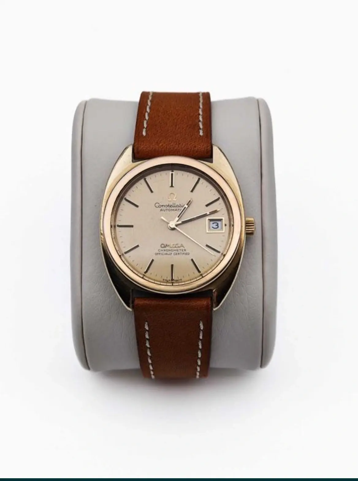

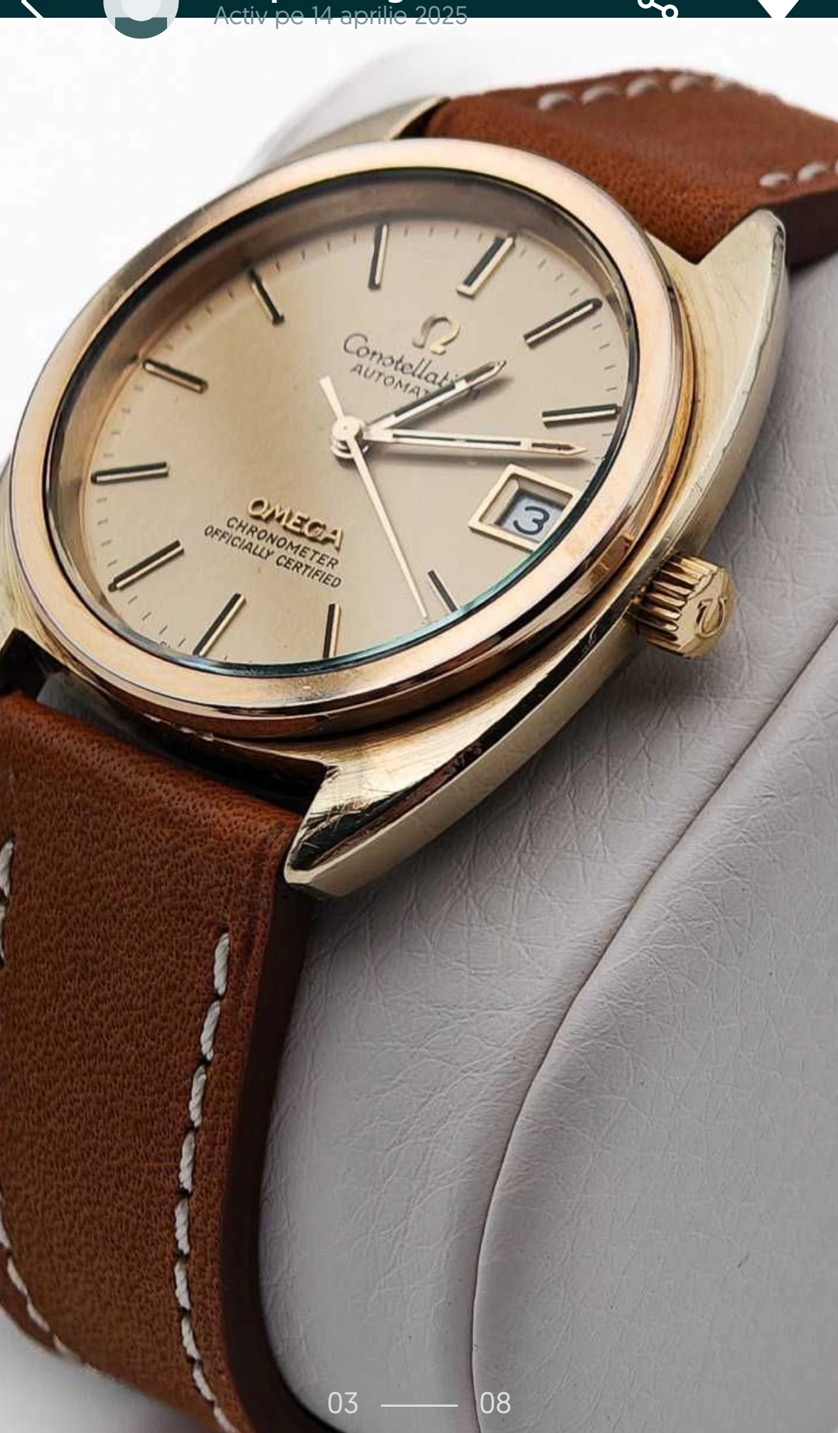

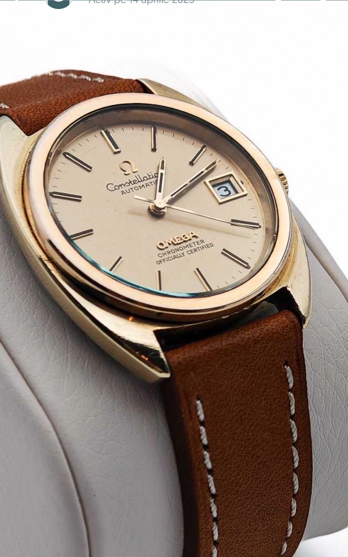

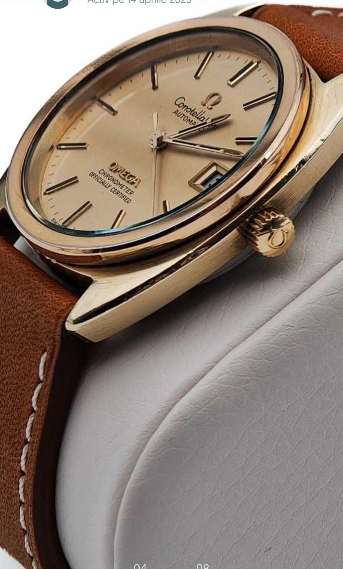

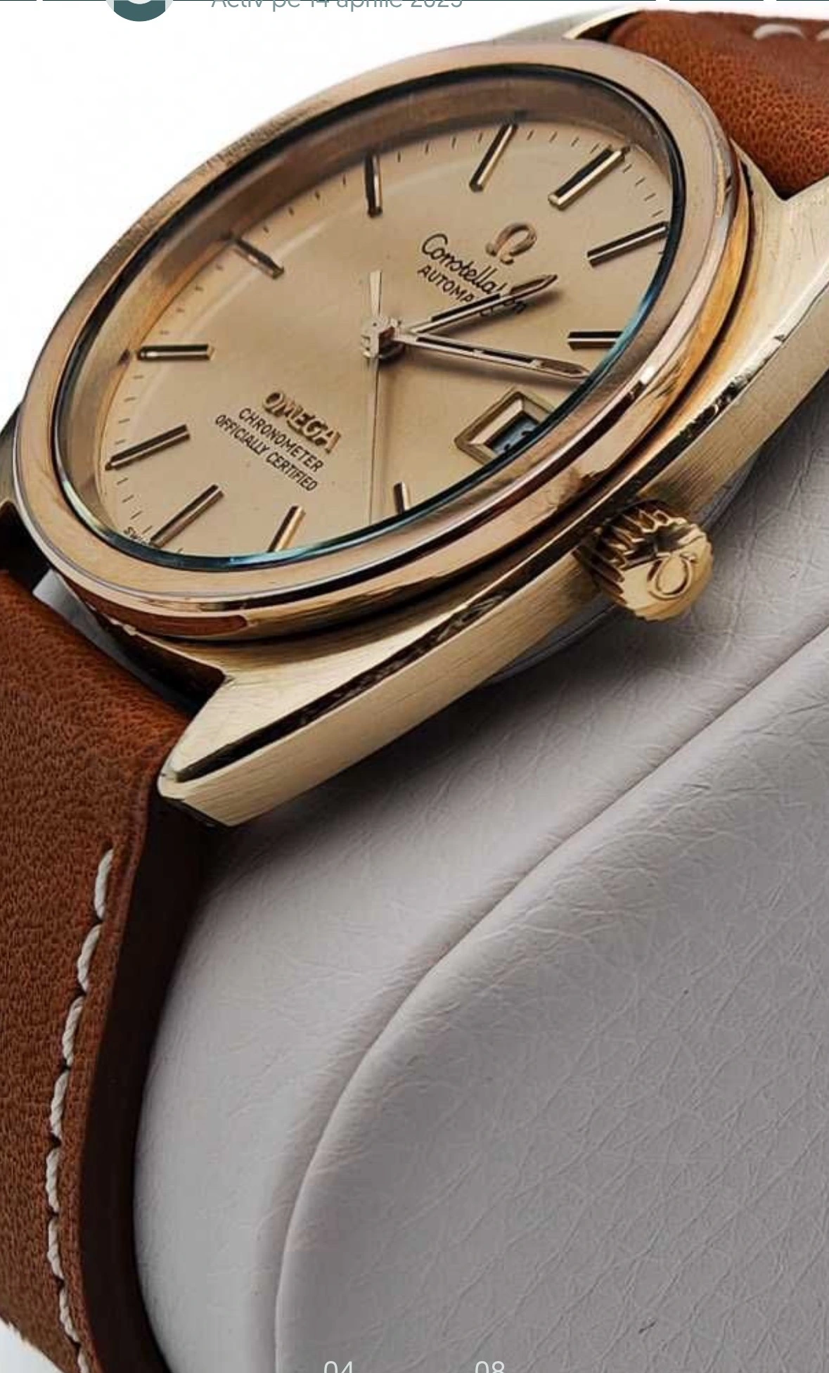

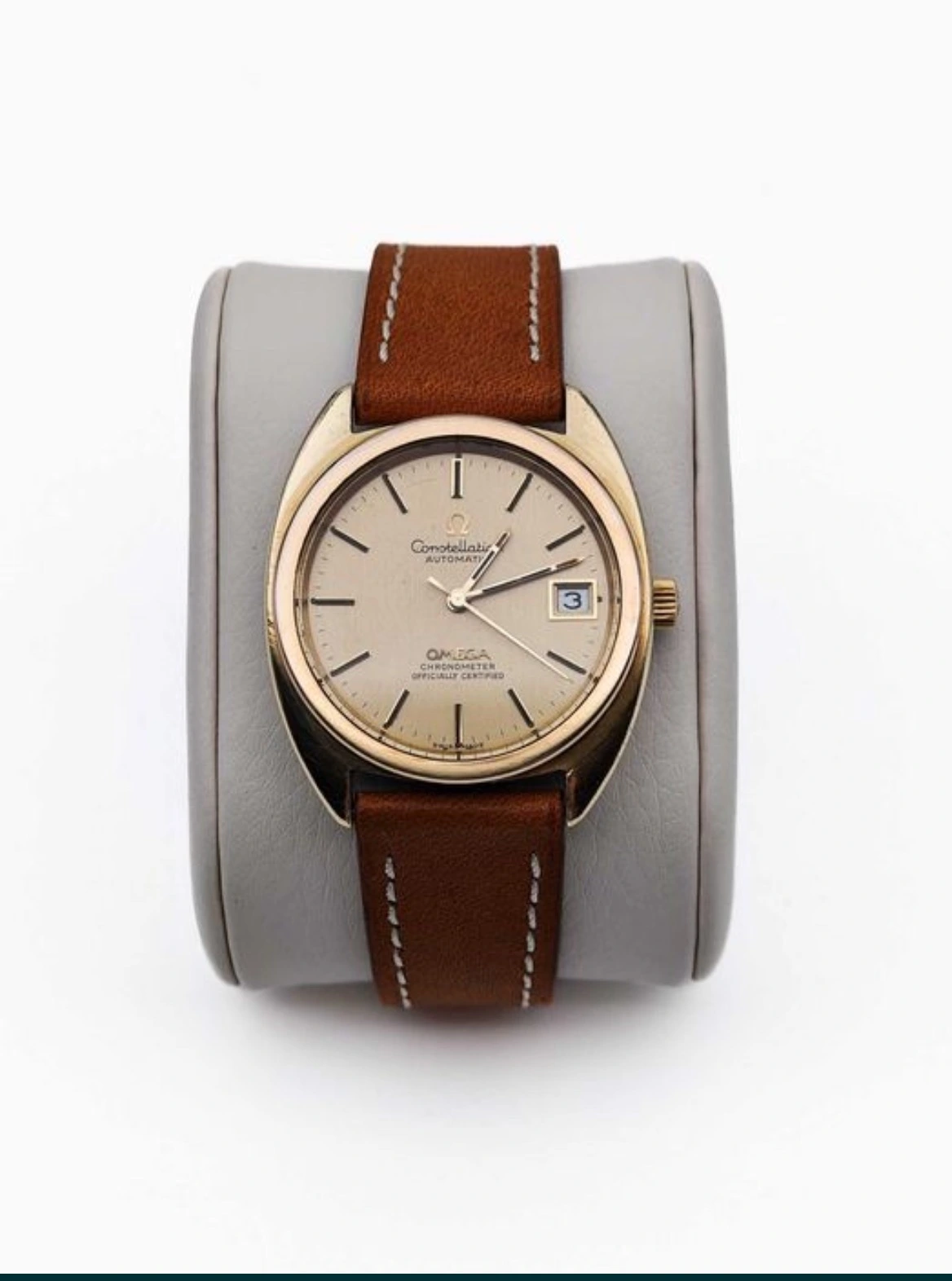

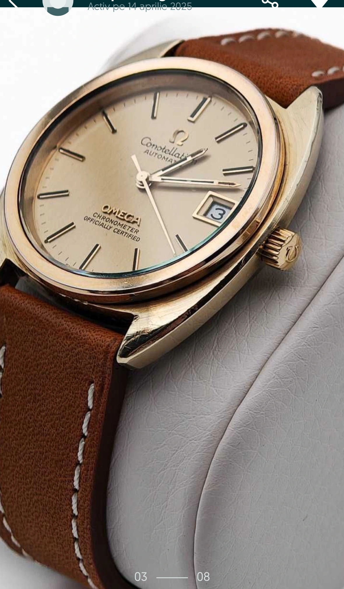

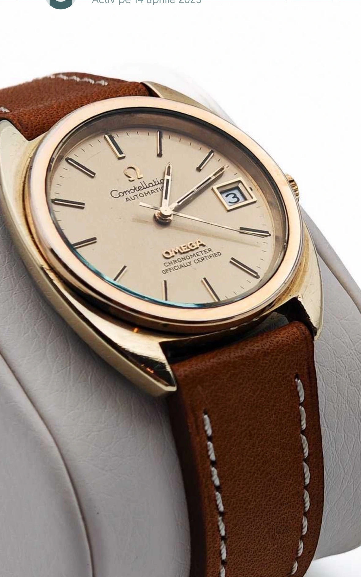

Came across this and i was wondering if it looks ok to you knowledgable folks... i am especially interested if those scratches on the case could be buffed out given the fold plating. price is 900 euros. Thank you

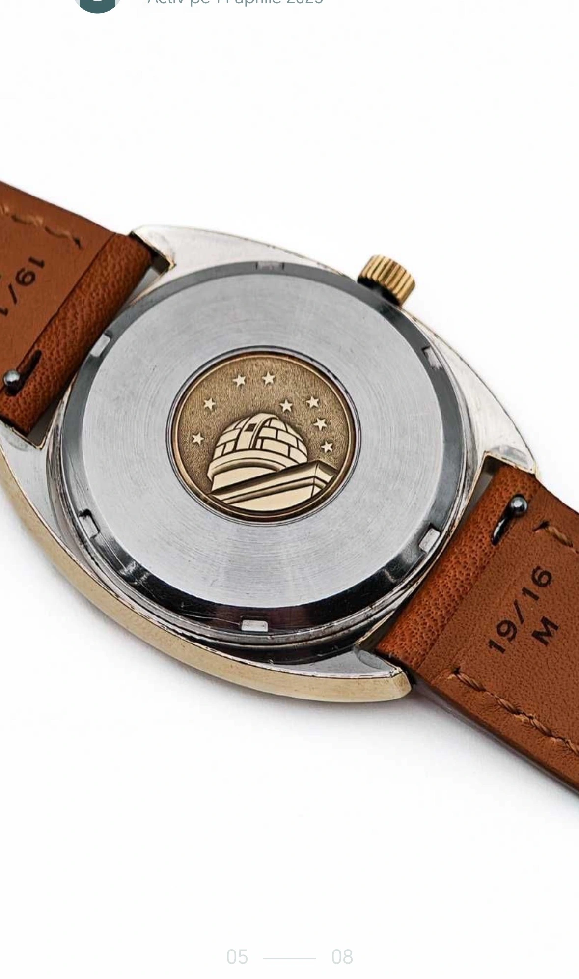

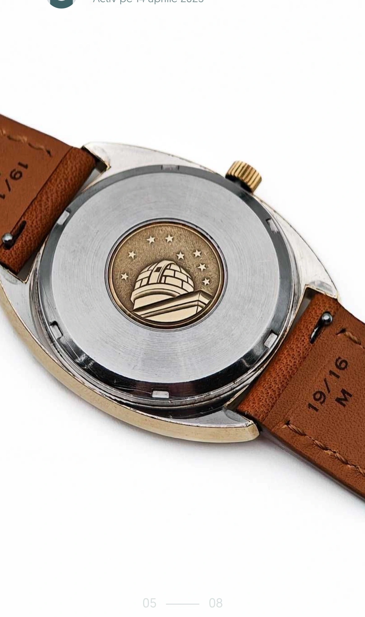

Did you check e.g. C24? And: don´t buy w/o a picture of the movement and inside caseback.

no pictures of the movement but a 60 day waranty issued, so ample time to take it to a watch shop

Ok, but still, don't buy without pics from the inside.
Returning a watch is always a pain in the ass.

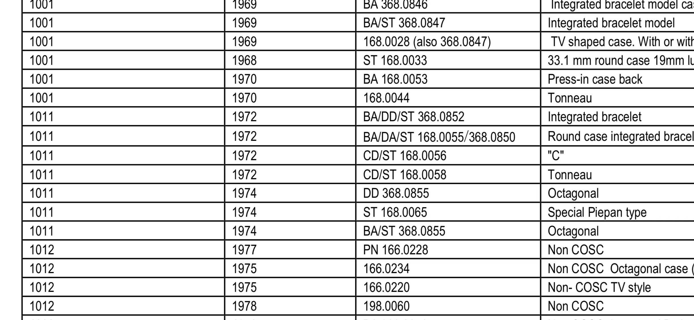

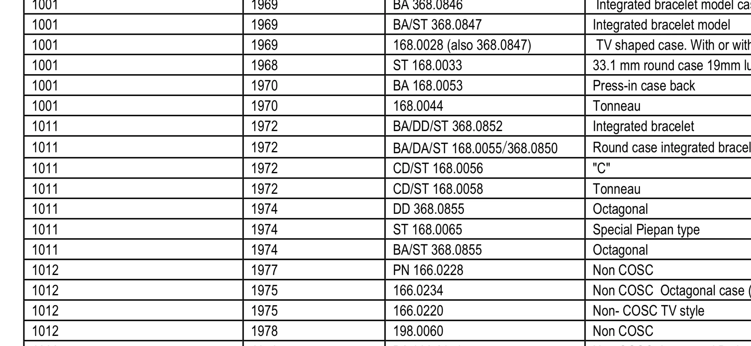

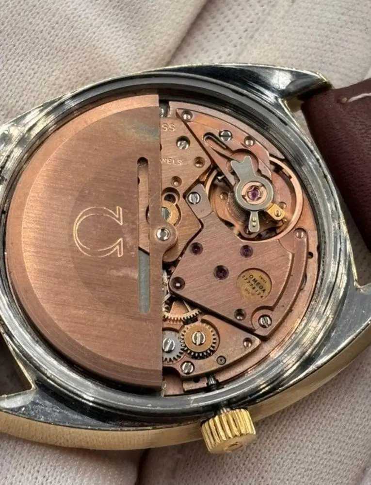

ah and it is advertised a 168. 0056 that has a 1012 calibre and found some reference towards the fact that a choreographer should have a 1011 ?
You are correct that a 168.0056 should have a chronometer rated 1011.
However, it could be a simple mistake by the seller.
To settle the confusion - The only way to be sure would be to ask for a picture of the movt.

Someone can correct me if I'm wrong, but I believe that case is supposed to have a circularly brush top surface, which is in pretty poor condition. So you would not want to have it polished.

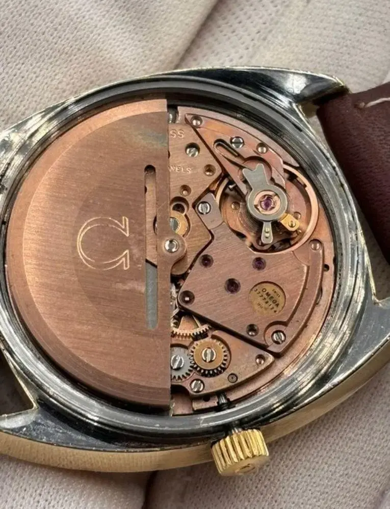

ok, got an answer and picture. the answer is that it is indeed and 1012 movement and that the 2 are identical. here is the pic
Unfortunately, they are not identical.
One is chronometer rated and the other isn't.
The 1012s appeared in later non-chronometer rated Constellations.
Link to a previous thread:

Frankenwatch. Run away.
