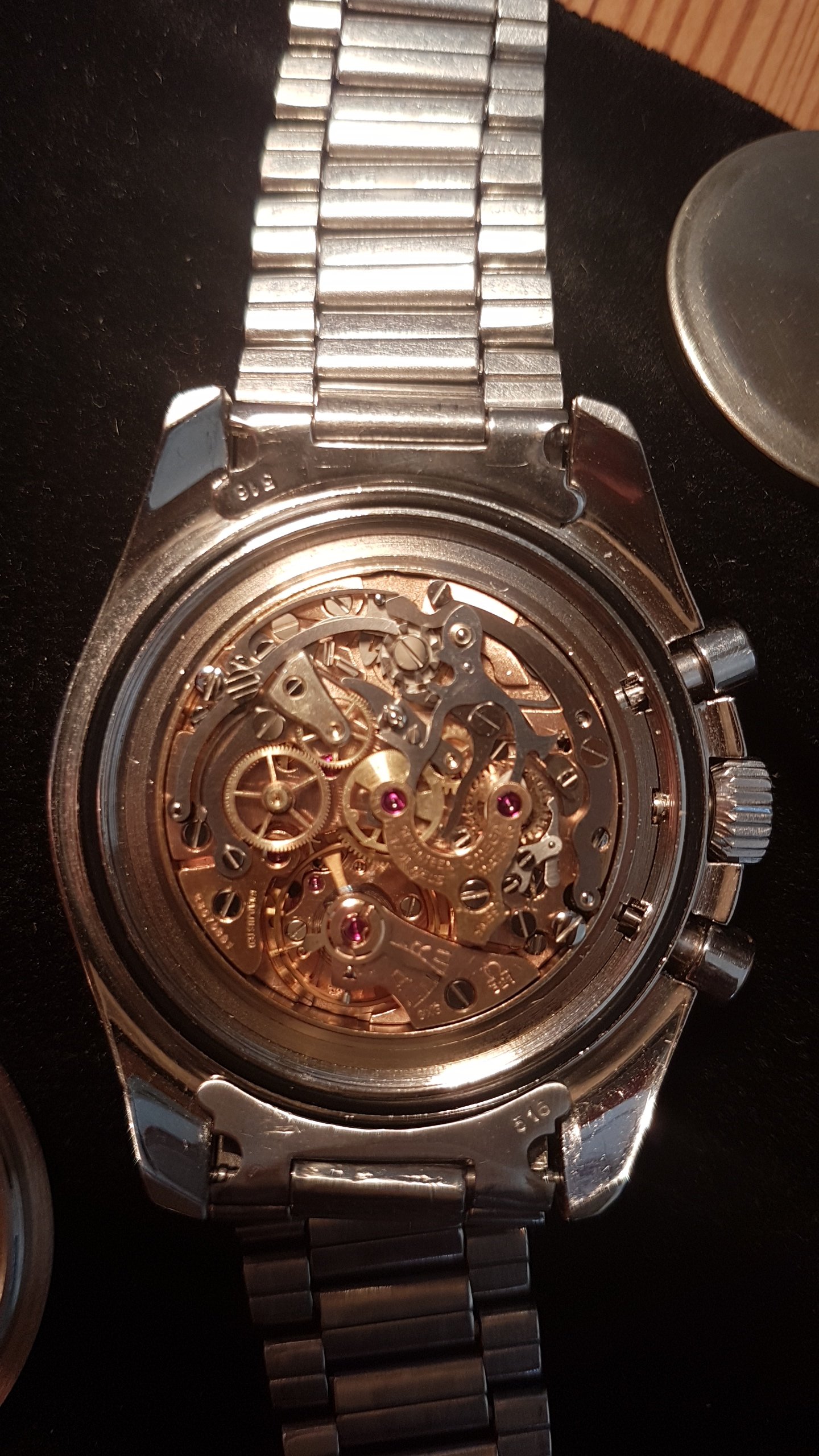

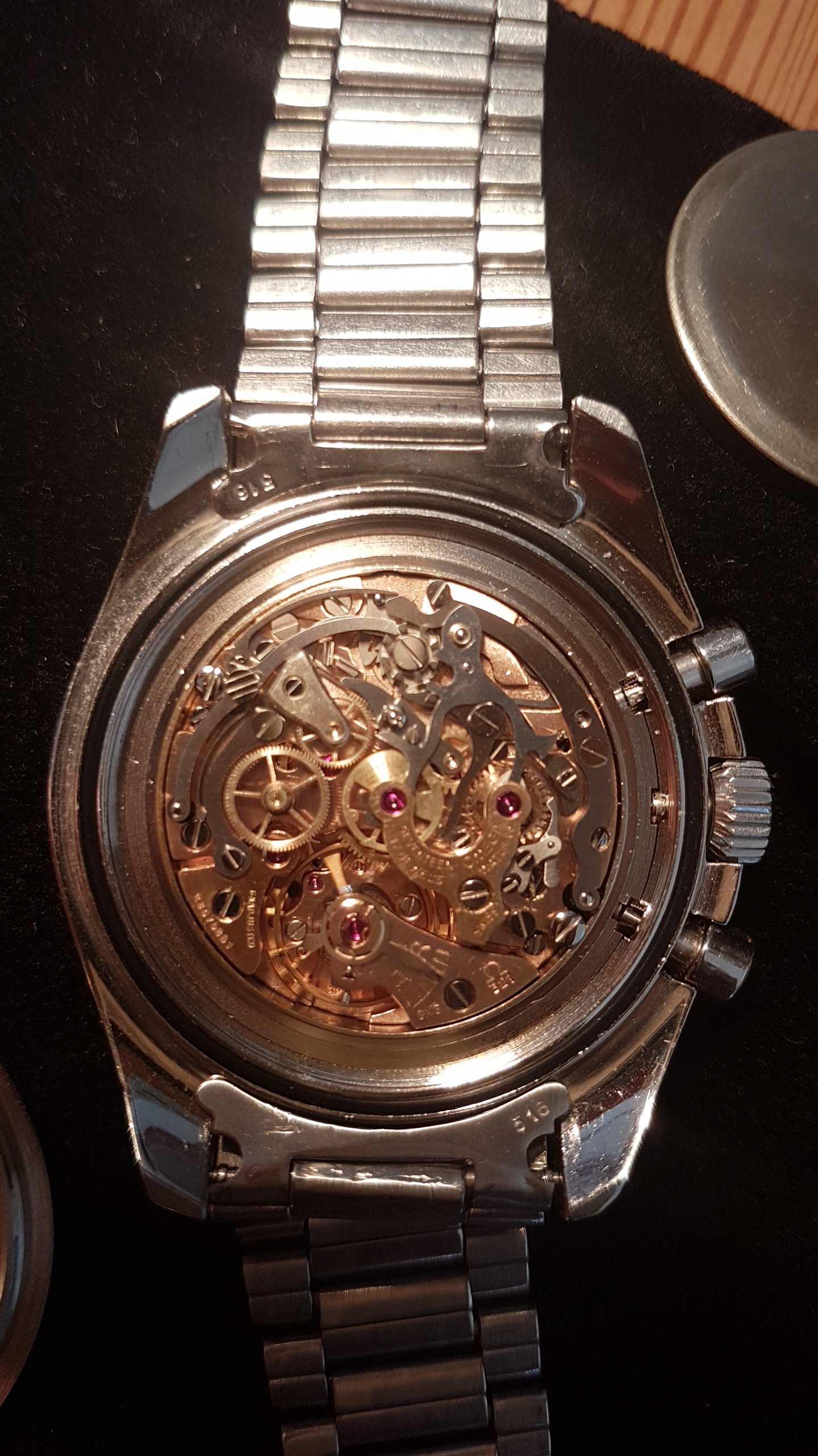

What really irritates me is the caseband. Looking at the caseback the lugtips appear to be typical for a CB case. And the lower left lug seems to have traces left of a CB caseline.
Thanks for your input. I've seen a few 105.012-65s with these case bands, but I guess they could have been wrong? Maybe someone can chip in who knows more. EDIT: Thanks Eugene, for chipping in! By the way there's no trace of a CB case line on the lug.
I now know and have pictures to prove (thanks Bjarven82!) that this watch was in this same condition since the first owner owned it and that it had lain in a safe for 10 years before Bjarven82 bought it. The only possible time that the case band could have been swapped would have been during the early years of ownership of the first owner, but this seems highly unlikely. I think the 105.012-65s came from the factory with either type of case bands but wouldn't mind hearing further opinions on this.

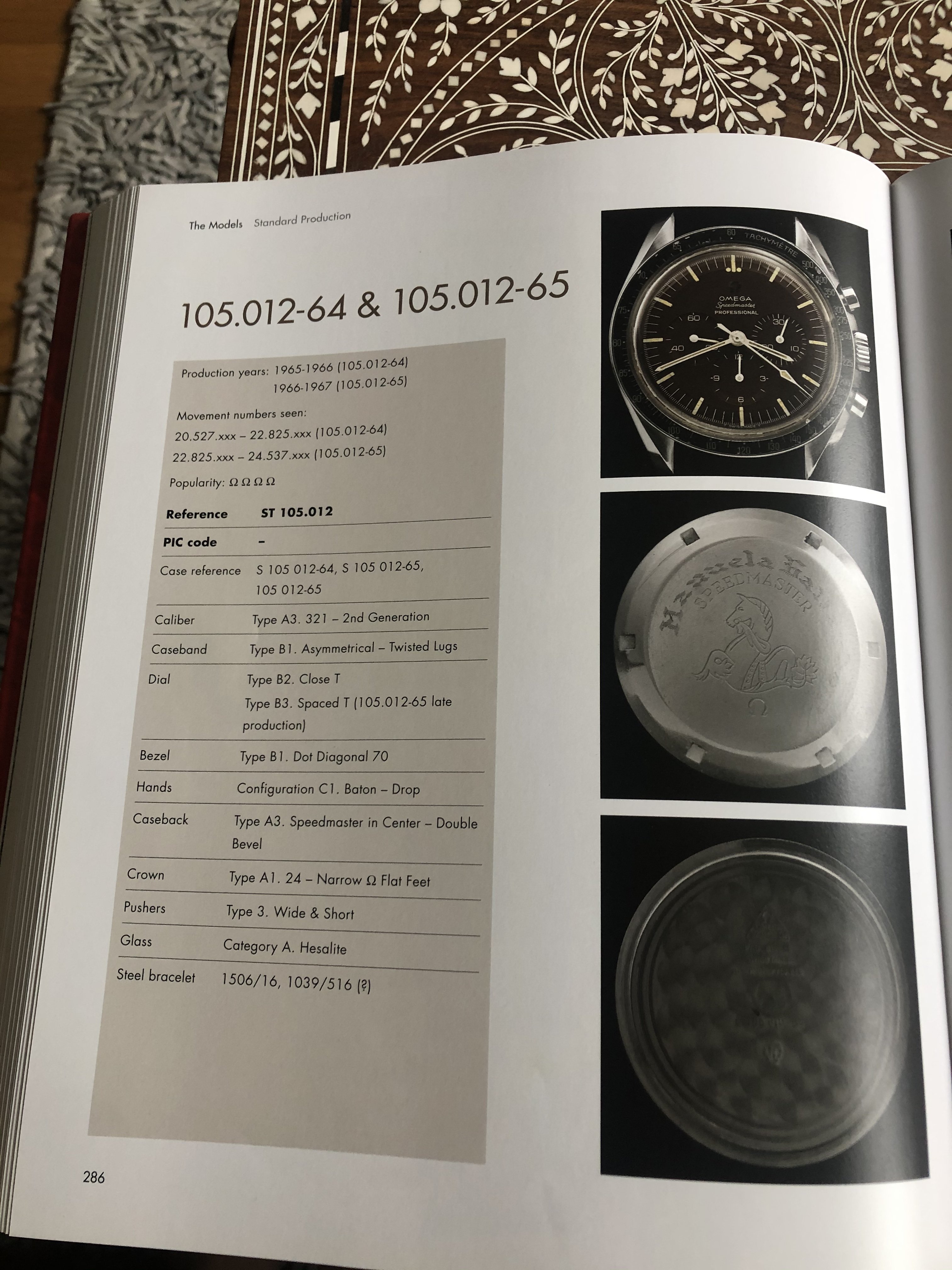

The caseback i the right one
Yes, but the "upgraded" case back I considered was also correct for the reference i.e. marked 105.012-65 inside, just not original to the watch...

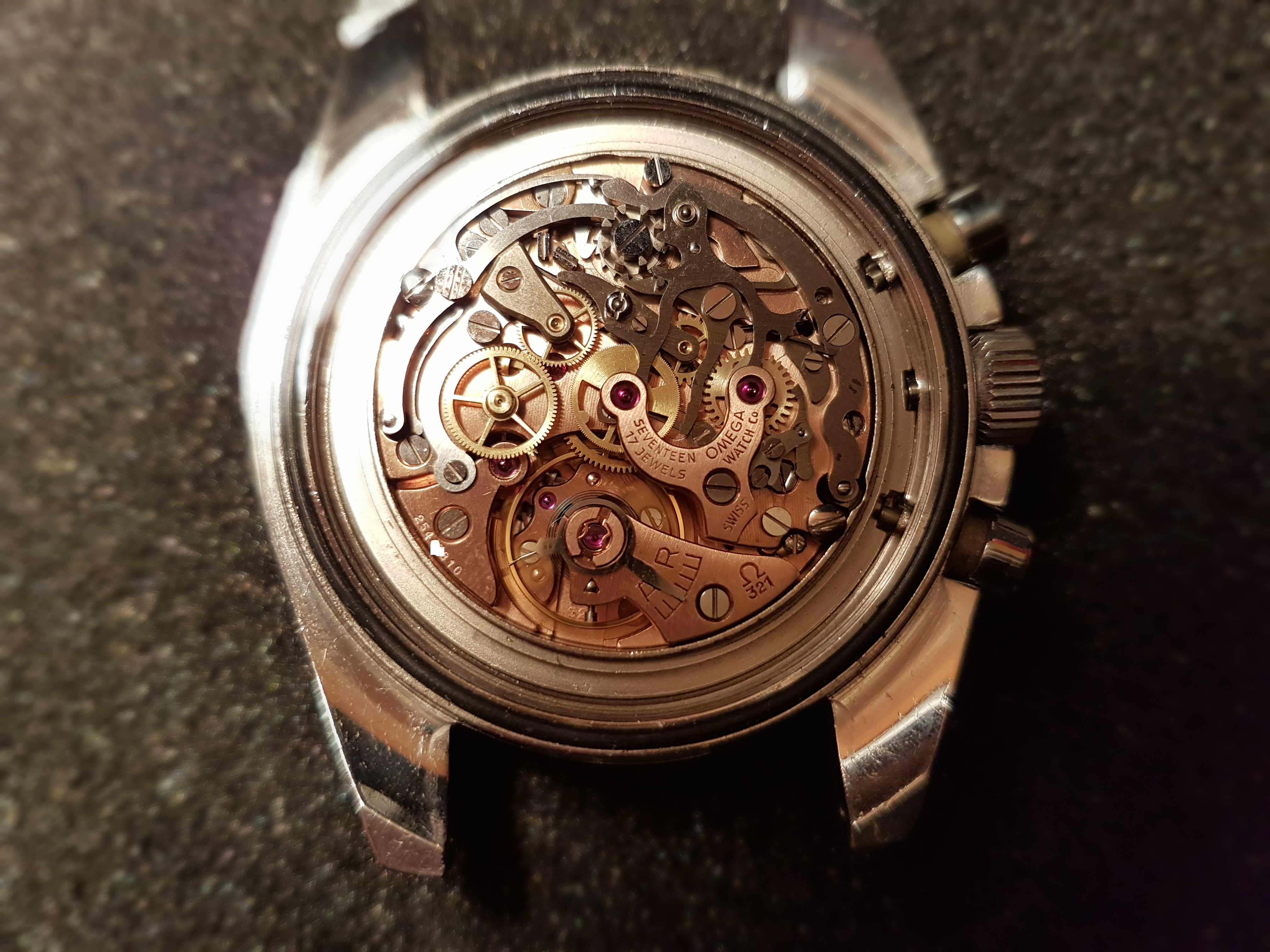

Well I'm happy to share the following:

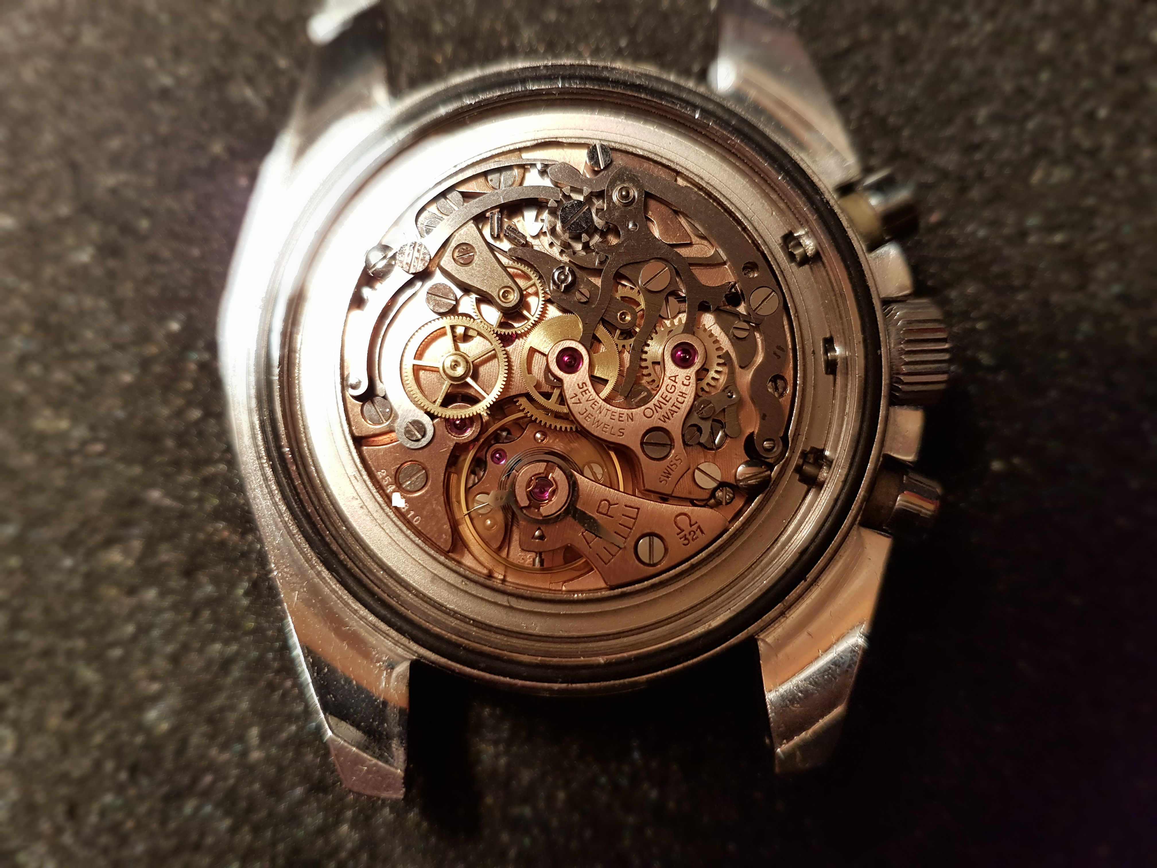

The first owner was John Johansson from Sweden who wore the watch every day, unfortunately passing away unexpectedly 13-14 years ago after which the watch was in a safe for 10 years before the sister of the John sold it to Bjarven82, who provided me with pics from that time. Bjarven82 sold it in 2019 to Janne2000 who sold it to Bille who sold it to Ryanbk who sold it to me. So I'm the 6th owner (7 if you count the sister of John) but it wasn't serviced or altered in any way by anyone since the first owner---Well I changed the crown and almost the case back, but that you know!---Here are pics which Bjarven82 sent to me today from when he got it and you can see the case back was already worn:

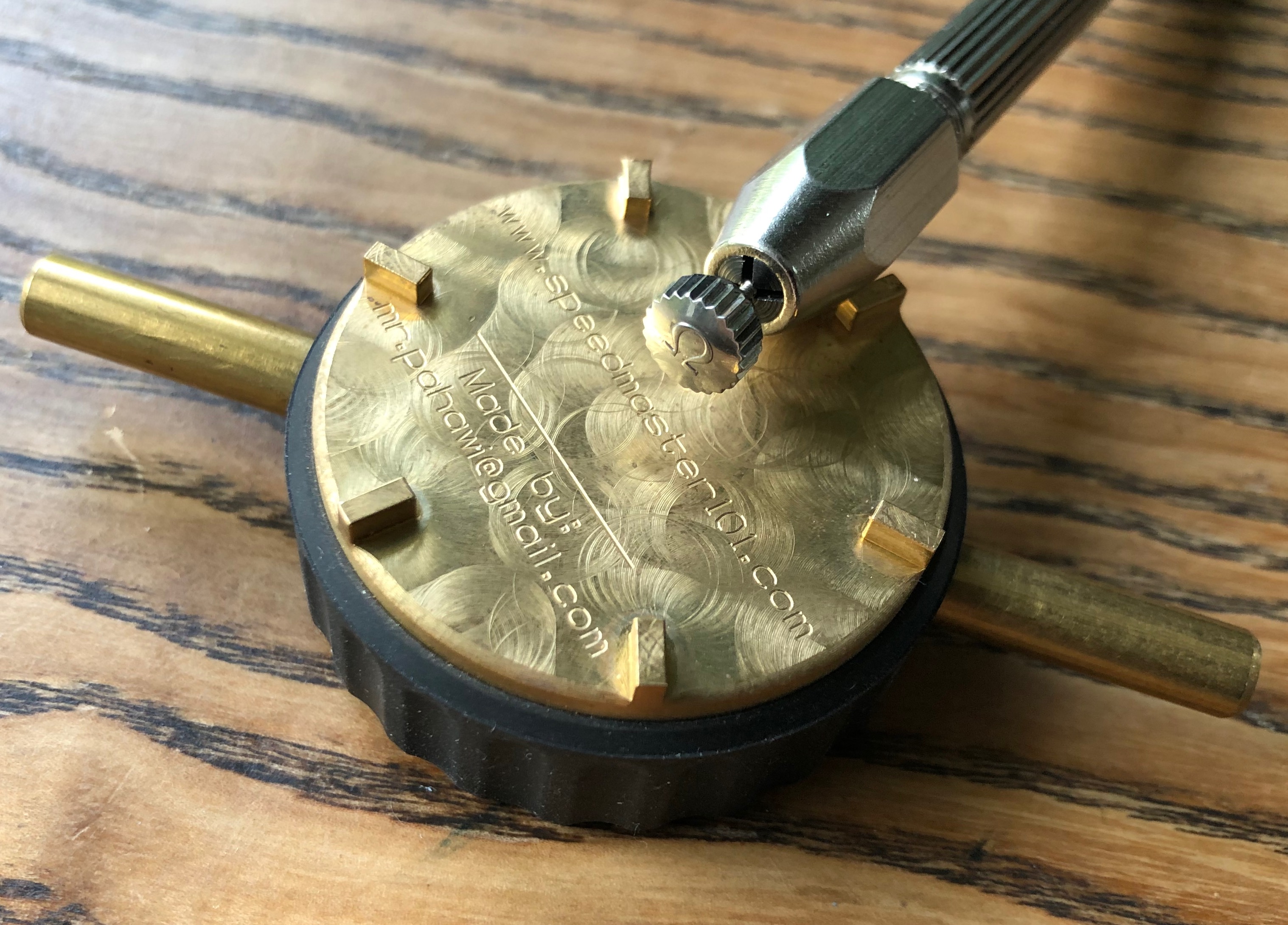

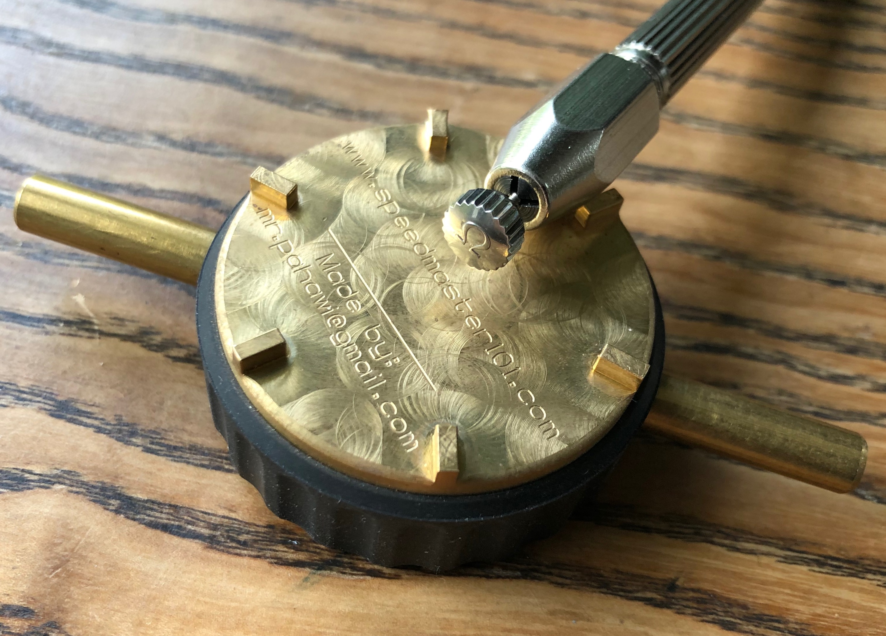

I'd just like to add here that I've learnt a lot from the speedmaster101 website and also where to get this Pahawi case opener. Without it I would've added unnecessarily to the patina with my case back and crown swapping experiments. 👍
I also noticed one interesting difference between the 2 case backs. The "upgrade" is stamped 105.012-65 whereas the original was stamped s105.012-65. I believe this is because I have a very early 105.012-65 and all 105.012-64 case backs I've seen are also stamped with an s before the reference. Later 105.012s didn't have the s anymore.
