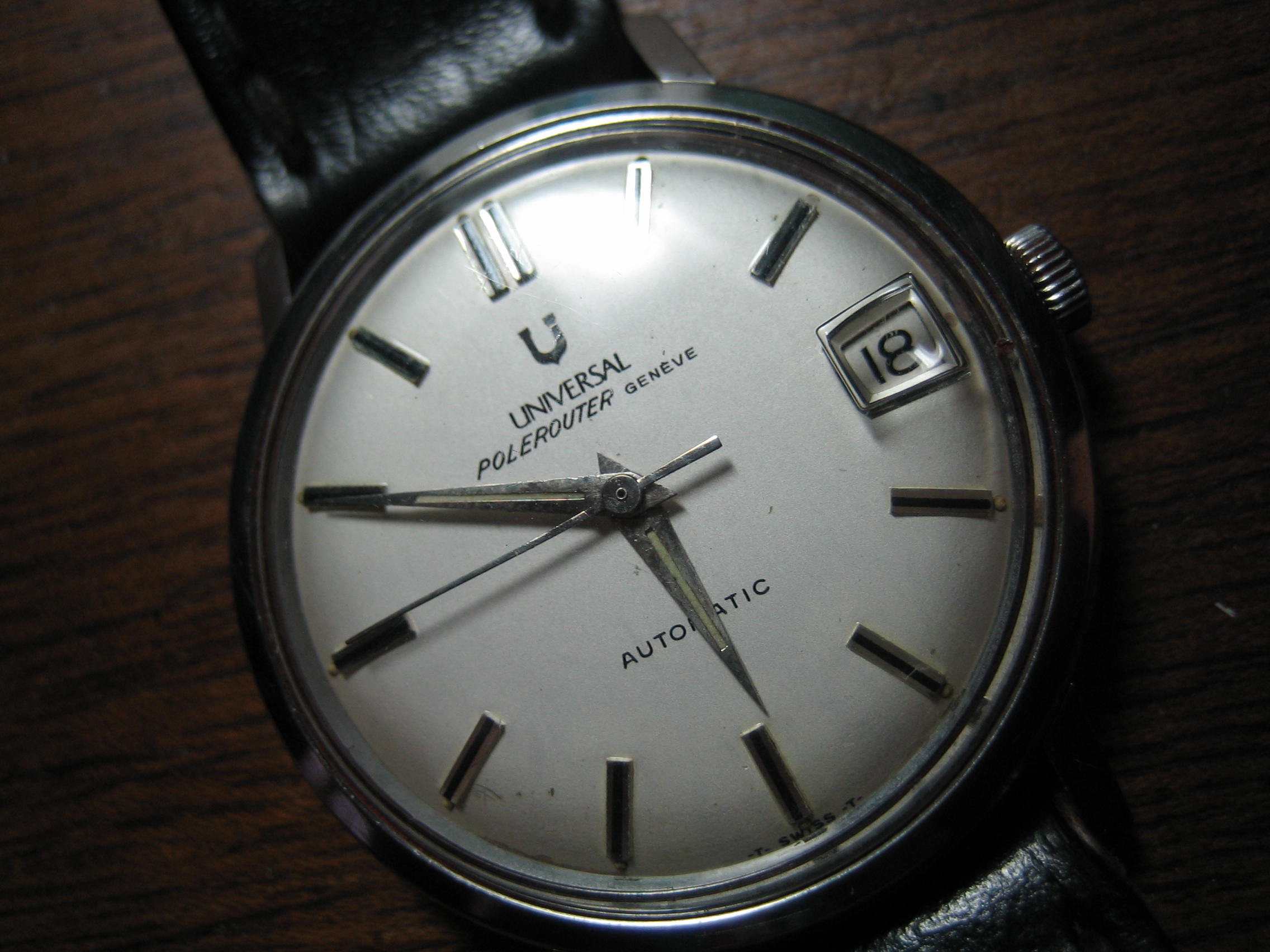

IMHO not a redial. I have an almost identical one in steel with a reference of 869101/10 and a serial of 2409XXX which places it in the mid sixties not the 70's. Hands look dubious (should be dauphine but I am not really that sure. I suppose it probably sat in a shop for a while ...
Pity it's a Kojak (no reference or serial can be seen) apart from that, it is pukka ...
Here is my ref 869101/10. Numbers are just visible. If I breathe on it, the few atoms that make them readable are likely to disperse in the ether; easily lost as they are kissed on !

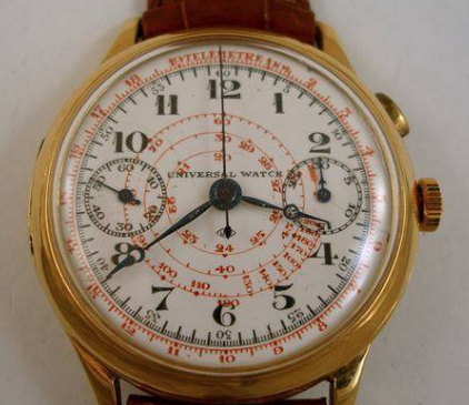

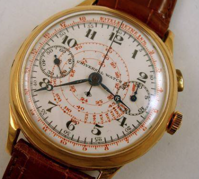

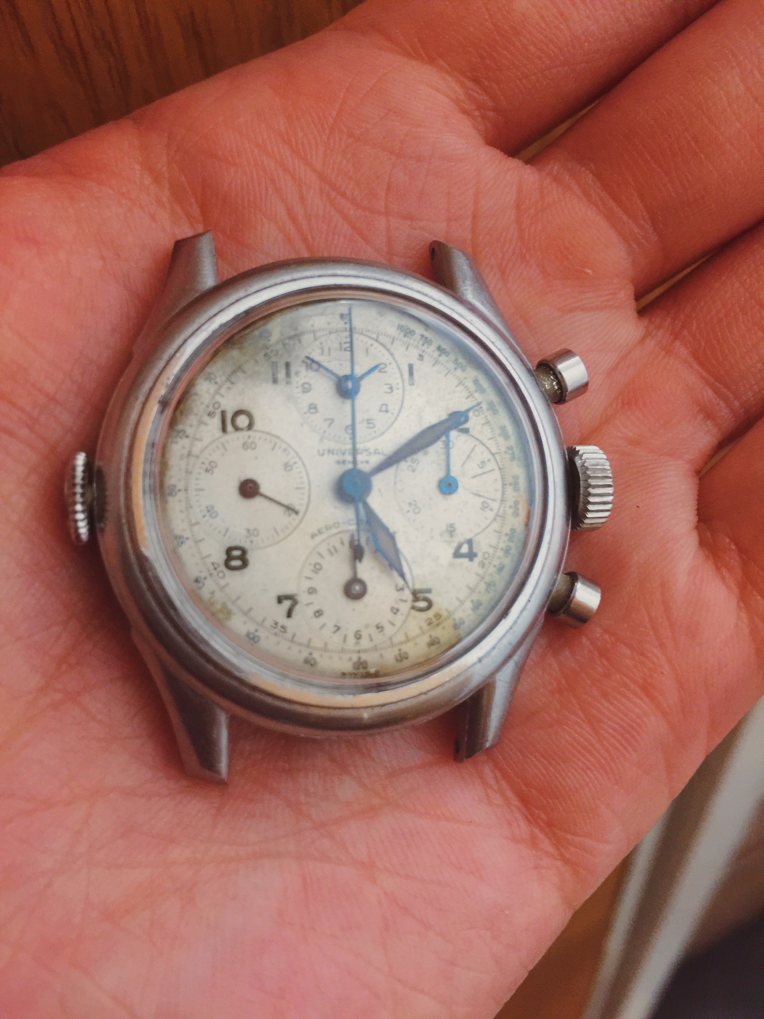

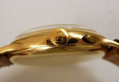

Anyone familiar with this Universal Watch single button chronograph? I'm guessing the crown is not original.
468
1,171
Hi Jonathan, forget about the crown, you can find these easily, they aren't labeled, if the rest of the watch is ok and for a fair price, buy it, don't hesitate !
1,931
22,761
Wrong pushers but price is not out of the ordinary. Great aeros, love them.

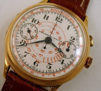

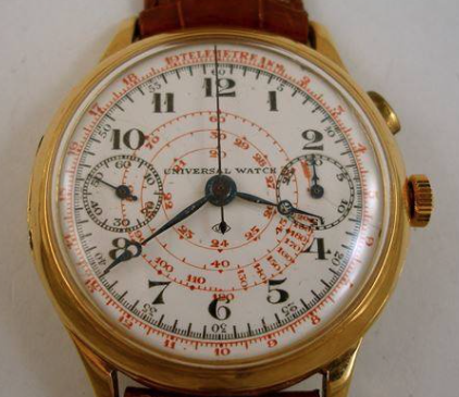

Can please you comment on these pushers?
1,536
3,177
I believe the model you are showing is in the same date range (mid to late 40's) as the above.

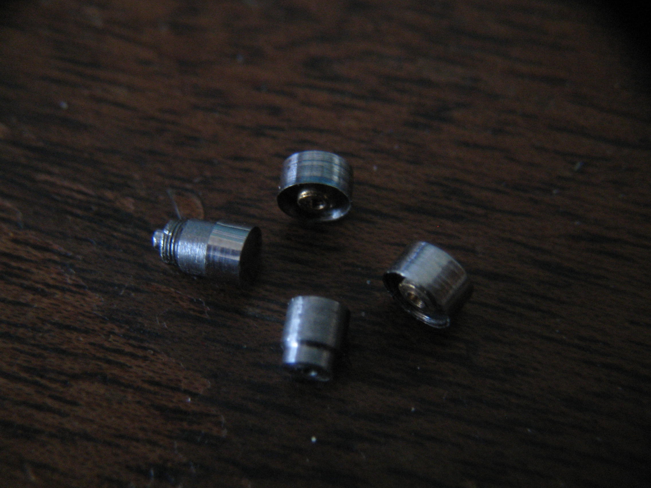

Pushers should be the large mushroom type pushers. The ones that you show are much later. Unfortunately, they are impossible to find and not a great design so once they break, you either fix them or replace them. That is a problem in its own right as thread diameter is larger than standard 2.75mm and tube is 4.5mm so there are really very few choices you are left with! I have had some success making these, but process is long and 100% accuracy is paramount ... Here are some failures !
