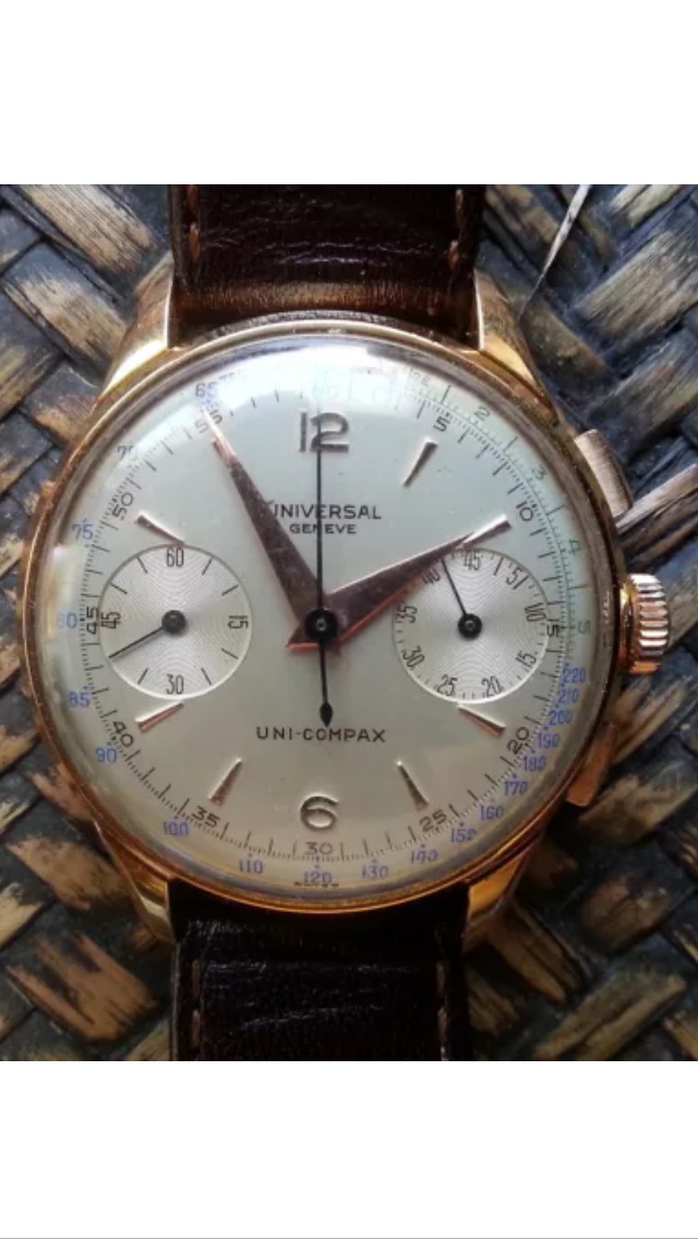

Mostly just that it's gold plated. Also, not a lot of vintage watches coming out of Morocco. Not clear what the maintenance is like there.

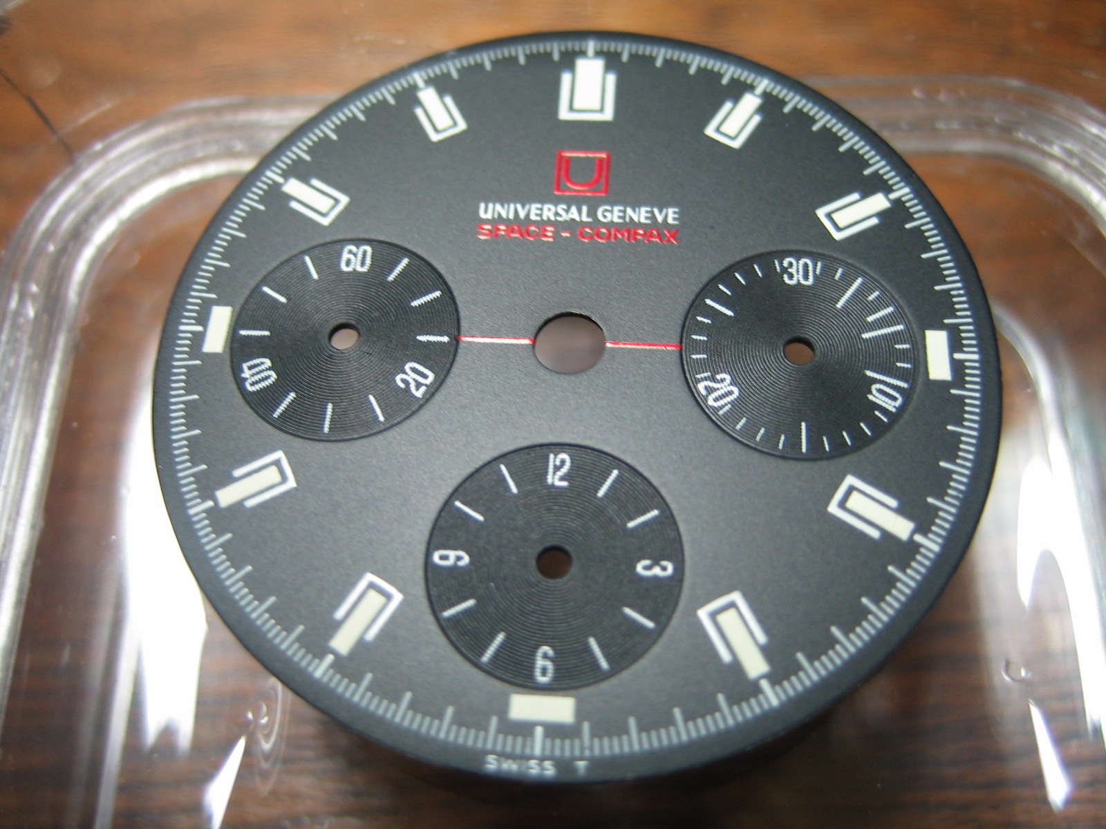

I had to get myself one these. Excellent quality but a close inspection reveals inconsistencies when compared to original.
Any chance you could share some inconsistencies? (or PM might work better)
1,536
3,177
No Lume
Second Ring - Seems to have thicker indices to original
Registers - Some bleed. Thicker numerals not as sharp as original
Logo - As above and embossed / glossy ink is different to original

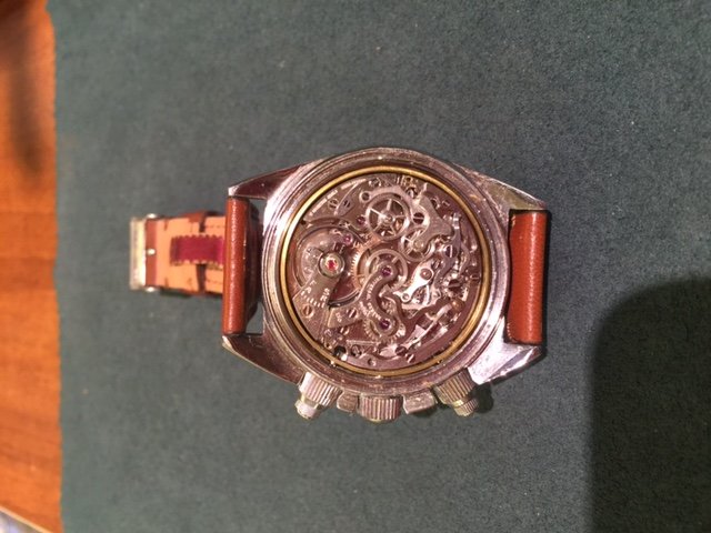

I conclude that it must be printed using the original plate and very high quality ink. It is a real stunning repro which could easily be mistaken for an original. I spotted this one in milan, clearly a space made with a repro dial ...
Wrong register hands and lots more. Amazingly, it fits the UG caliber 130 movement (although original, far too early a V72 movement variation to be used on a 70's space compax) ...

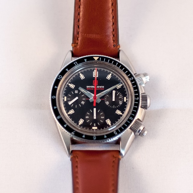

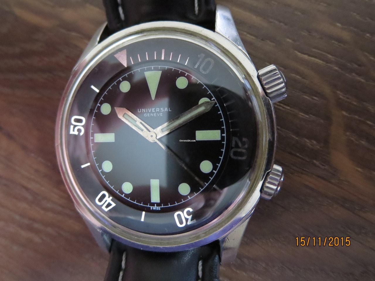

re: posting I found on Chrono24:
I'm no expert, but the characterization of this sub as "all original" defies my (admittedly limited) experience. The certificate from UG further confuses .
369
438
Somehow, I think the English translation and grammar on a UG "certificate" would be better than that letter suggests it is.

Good
Nice dial
Nice hands
Nice movement
Bad
Wrong crystal
wrong crown
polished case has lost its sharp edges
Wrong bezel
It looks like the case has been modified for new crown (tube replaced). If you are after a daily beater, are happy with the case and you are not really after a collectible sub, then it could be the one for you. It has lots of issues but can be put right. However, parts are hard to come by. For me it would be a no-goer ...
