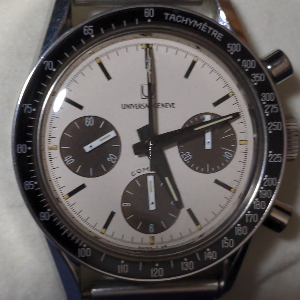

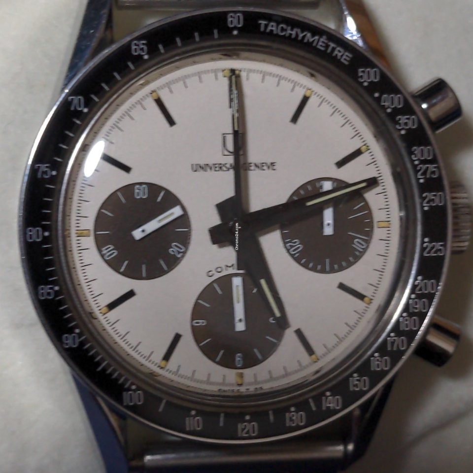

Could you tell what bothers you?
Imho other things are more "confusing".
Yea it’s an odd duck. The shape and height of the pushers are bugging me. I have a collection of gold cased UG chronographs so my eye went there first. Crown is a later one. HM hands are aesthetically jarring.
Most probably, the pushers are NOS and mounted recently.
Imho they are correct, this shape can be found quite often. Imho, it's just a later dial in an earlier 1940ies watch.
I almost went there but the 6 is open not closed.
