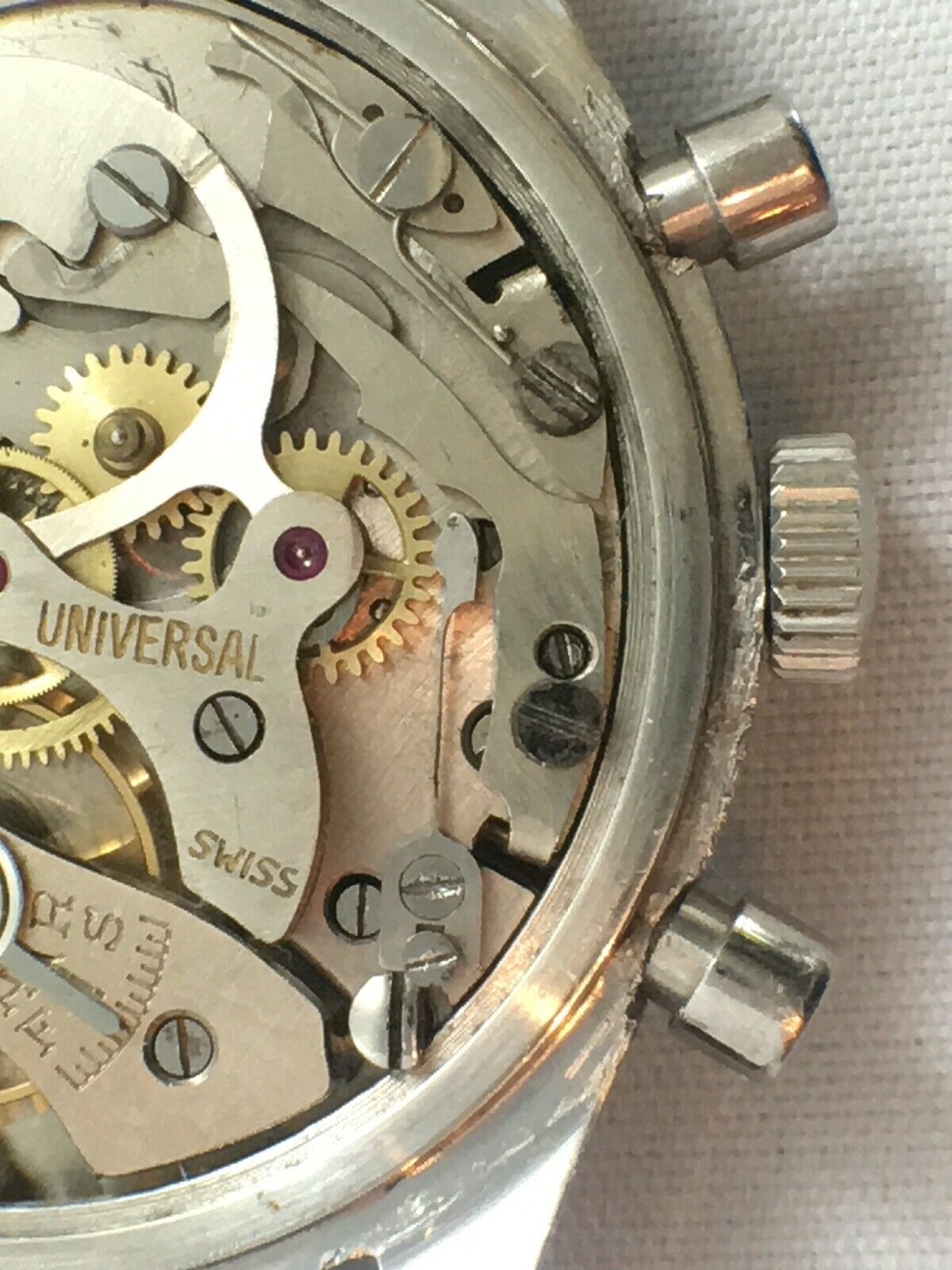

Round 3s generally not good on the subdials. Wrong minute counter hand and chrono sweep. Weird number inside caseback, what is that? Would be curious to see external caseback. Import code is X'd out on the movement?
Imho, all hands are wrong.
the other additional wrong hands were already pointed out, it was a cumulative team effort 馃槈

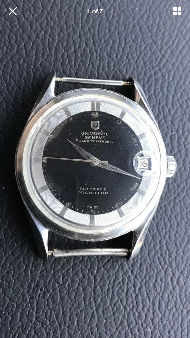

Only a couple hours left, seems to me that the movement is possibly missing a case screw. Beautiful watch.
These only use 2x case clamps, and the stem/crown to keep them in place.
Looks to me like both case clamps/screws there.

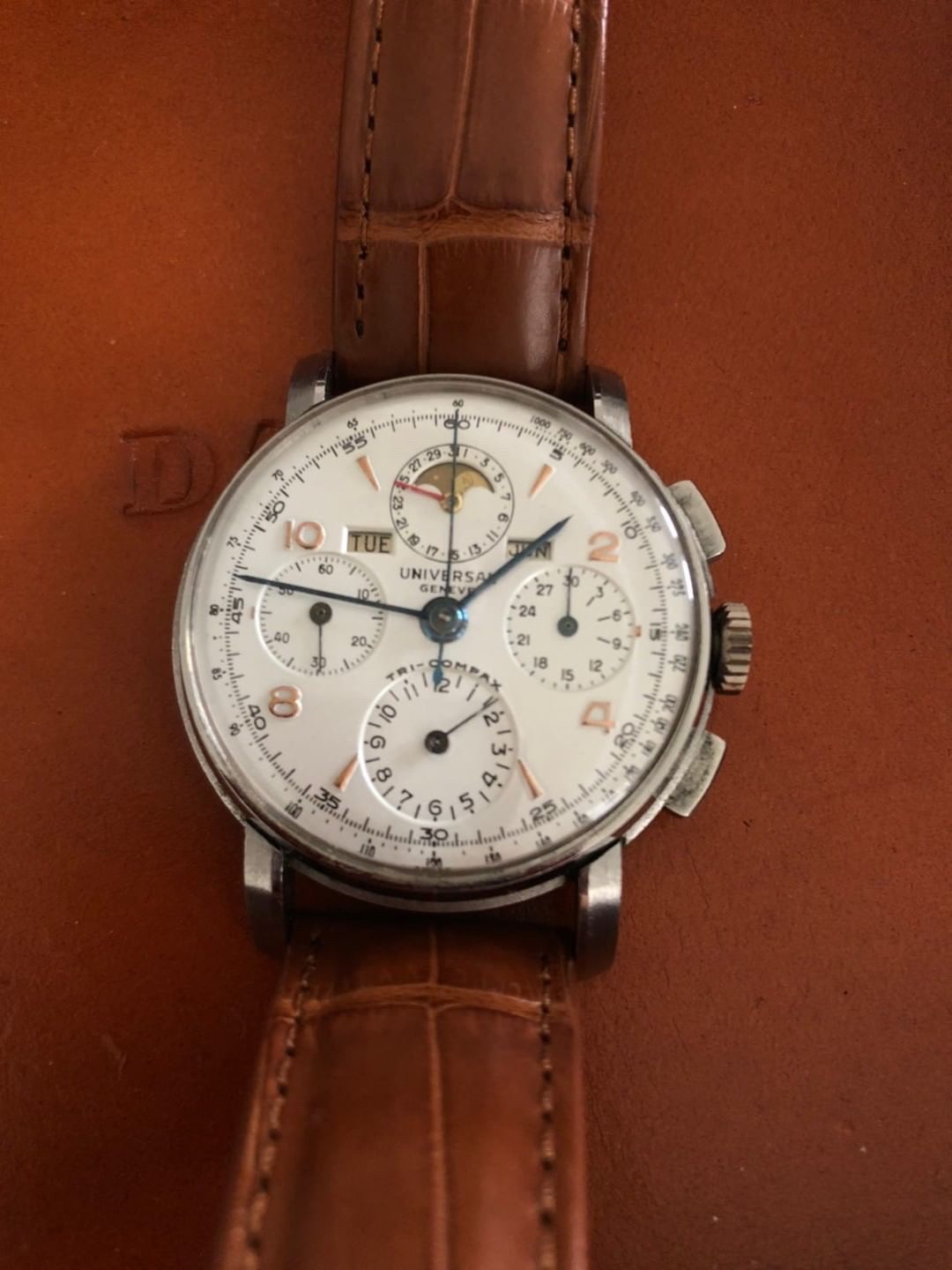

no but i was checking this dial
dial looks original to me. Hour hand is wrong. Minute hand maybe OK, seems a touch short? Chrono reset not right.
You'll have to forgive my scepticism. You've posted about numerous eBay items on this forum and they always have the same seller.

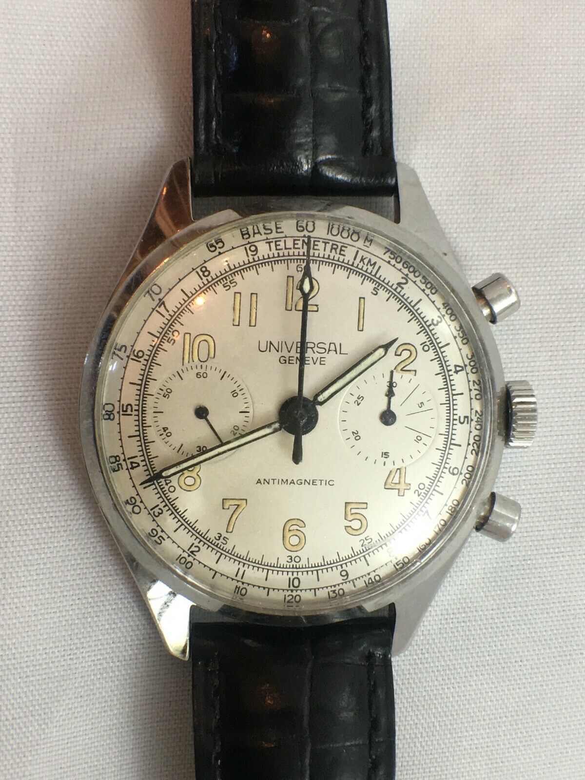

Hour and minute hands should be sword hands and lumed. If that is not a lumed dial, hands are wrong anyway... Dial is fine. Obviously needs servicing.
