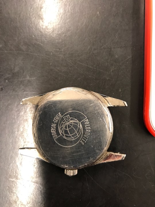

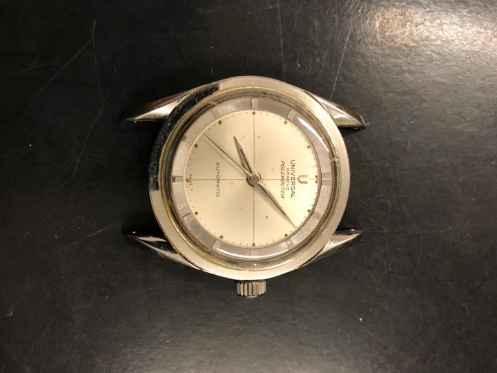

HI guys,
I found this piece at a local shop. What do you think about it? Does this look correct?

IT LOOKS NICE . Buy it ! What's the price for it ?

Thank you.
800 €, service history is unknown, so I guess it still needs a cleaning.

For what's to see, it looks like some "artist" has manually rewritten the tachymetre on the left side...

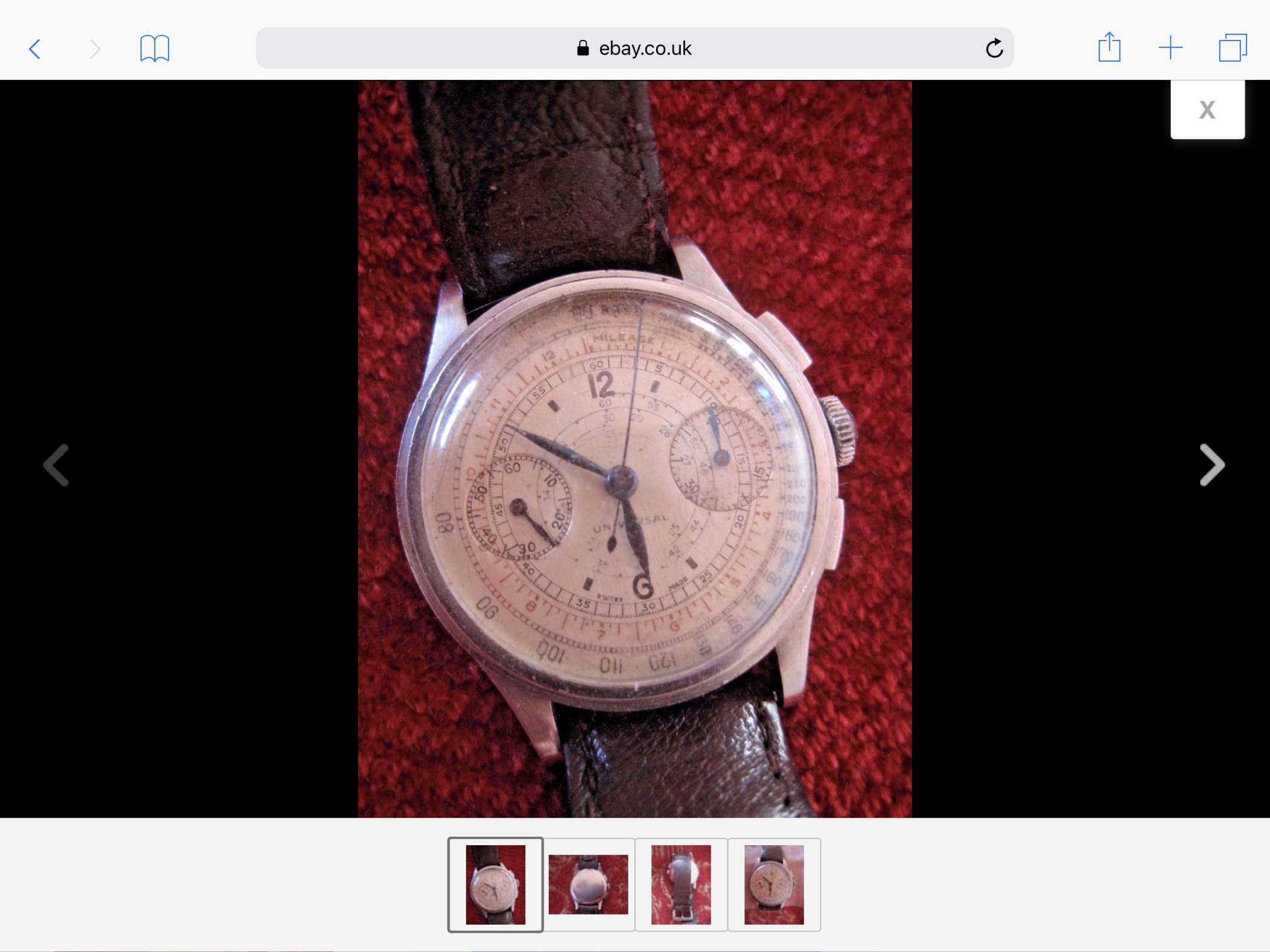

For those of you interested in ranging Tri-Compax prices, here's an early one in straight auction which ends tomorrow. The dial is somewhat grotty condition but the case and movement are in good shape, and it is a 37mm watch - slightly larger than average (note the enlarged movement footprint). It appears to me to be complete and original.
http://www.ebay.com/itm/281057971118?ssPageName=STRK:MEWAX:IT&_trksid=p3984.m1423.l2649
Stunning

That's a fair price for a watch in this condition. Get it!

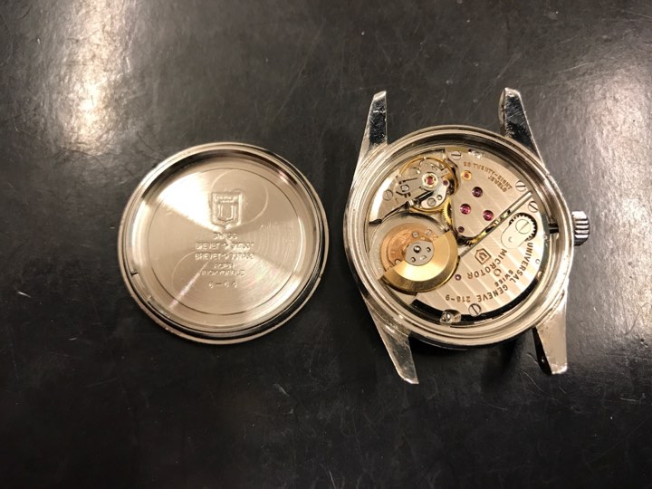

That’s a nice watch. There are signs of the rotor rubbing on the case back, you might want to ask the watchmaker to see if that can be addressed (unfortunately I think the only fix is replacing the rotor post).
Thank you, you are right. I talked to my watchmaker, he said the same and another scenario: the missing/old sealing which could cause the same problem, a new one could lift the back a little and could prevent this from happening.
