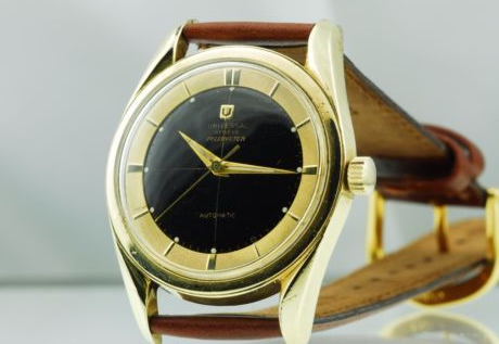

This gold Polerouter caught my eye on eBay--thought I'd run it by you guys. My observations so far:
- the dial is spotty, which could make it original. Or am I missing something here? In any case, per @Severin's great work here, the round opaque U on the dial matches the 138ss caliber. The dial matches #16 of dial variations in the same post (incredible work by @Severin): full crosshair (to chapter ring), tick & dot markers, 1 dot at 12.
- the case seems to be in good condition
- the crown worries me: not very visible, but there doesn't seem to be a UG logo on it.
What are your thoughts?

@jaspers - Replacement generic crown. I'd take the "serviced" description with a bit of salt as a couple of parts still have corrosion/dirt on them, and the gasket groove and gasket aren't clean/new. The lume plots and hands have been redone, yet two of the lume plots are missing.
The AUTOMATIC looks slightly off in my eyes, as it's not 100% straight (particularly the Ts.)
EDIT - After looking at @Severin's analysis I believe that this is a redial. The U badge is slightly crooked; the crosshair does not go through the E in 'UNIVERSAL' but before it, and bisects N in 'GENEVE' instead of being in between N and E. It also goes through the middle of the 'R' in 'POLEROUTER' rather than being in between 'R' and 'O' or just slightly going through the edge of R. The crosshair also goes through 'O' in 'AUTOMATIC' instead of being in between 'O' and 'M' or just touching the 'O.' The top lume plot looks badly redone as it's not a full circle, and that 'AUTOMATIC' lettering is pretty unconvincing in my eyes now. It's also missing the 'SWISS' word down at the bottom, though that could either be due to photo angles or (more likely) missing as part of the redial.
The case has probably seen a light polish, given the seller contemplated doing the caseback too (a big no no for collectors but a big yes yes for people who like shiny things.)

Thanks @GuiltyBoomerang, really helpful. I'm just amazed how generous and helpful you and other folks on this forum are. It can be frustrating for a newcomer like myself that so much that's available on the market is unoriginal--despite descriptions stating otherwise. For now, I'm just happy to be able to educate myself though. Thanks again!
