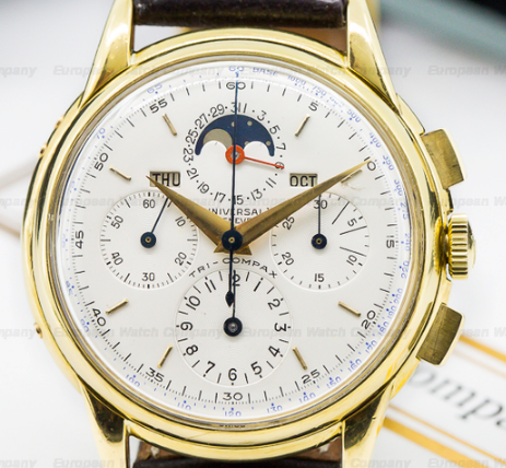

I'll much rather get from OF. However the first example u showed, doesn't entice me as much. I prefer the 2nd example but with a black tone/face.

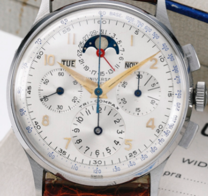

Correct as far as I can see apart from moonphase disk and possibly crown . It is the oversize which mounts the larger desirable 287 movement. There are some marks which may be corrosion. Seems to be good overall but will probably need a once over by the watchmaker.

are you sure? what about these points?
- "30" of the seconds scale is in the subdial
- "21" of the day scale is in the day window.
- no circle around the day scale
- 31 not red

Yes , I am ...
-31 is not always red
-21 and 11 is acceptable (remember there are imperfections on some of these dials)
-no circle is also a feature of later printed dials
-30 in subdial concerns me a little but not enough to make it a redial
What is the size of the dial ?
probably a factory furnished 60s dial in line with the model but with subtle differences

I agree with points 1 and 3. But in that case why do you think that the moon disc is wrong? Shouldn't a faceless moon be correct then?!
Concerning the date scale, my impression is that it is quite big in comparison to your examples.

good points,
serial number of case points to an early tri compax ...
Regarding the size of font, this is an oversize ...

She's an early model with a service dial and service moon dial. Protruding quickset pushers which as I understand were meant not to require a set tool. Crown might be OK ...Regardless I'd budget $1- 2k for service and case work. Salvageable but the current price reflects condition. I'd not pay more than $2800 for this watch. Don't have the bible with me.

Personally, I think that the dial is partly restored (tachy scale).

See that...Regardless she's had a hard life. Dial damage, restoration work?

The has been some damage (possibly water or other) in that area of the dial. However, i do not see any signs of a botched up restoration on scale. It all looks pretty consistent. What you see may well be aberration or distortion caused by watch glass which looks like it could do with replacing ...
