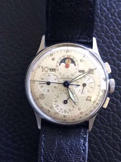

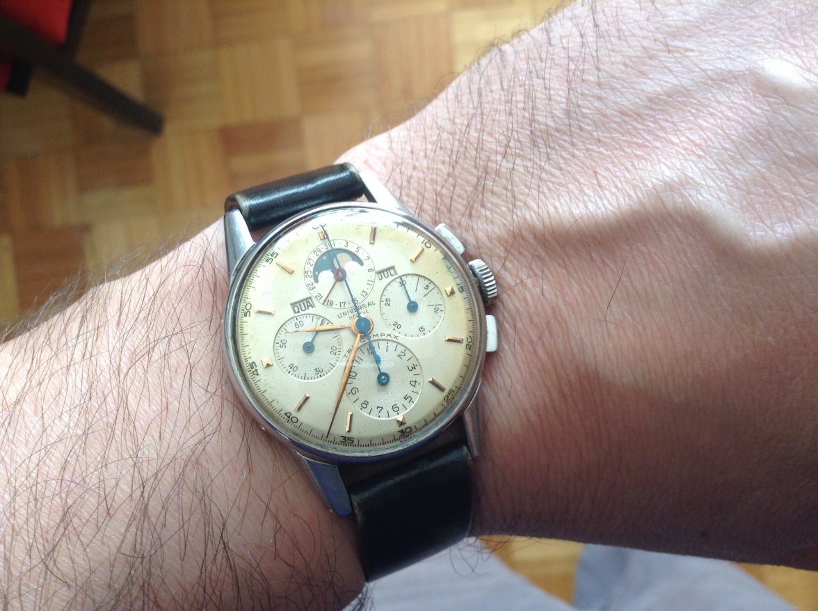

Wrong chrono graph second hand and chronograph Minute hand. Also not Sure if minute and hour hand are original, not really a good redial as well.
Trying to learn... Did chronograph seconds hand only come as black? This is gold so shouldn't the minute be gold? Is it subdial at 6 you're referring to?
4,643
31,246
That ring at the bottom of the chrono second hand isn't a UG thing. As for the dial, the north and south subdial numerals jumped out at me as imperfect.

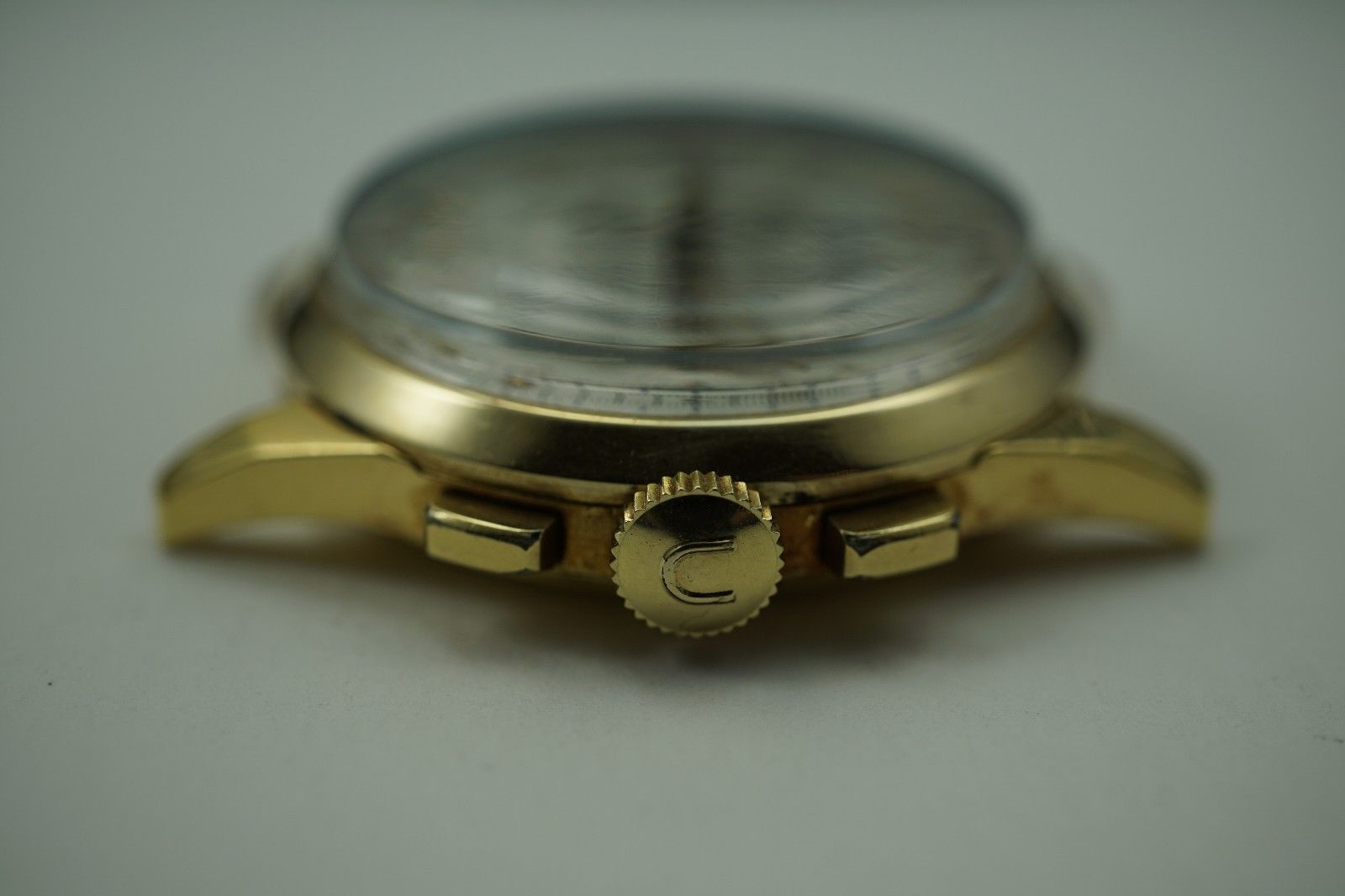

Is this legit? Are all UG crown supposed to be signed in the 1940-50's? 18k gold 37,5mm & original dial or very good redial? Price range?
4,643
31,246
It really should say Universal Geneve somewhere in that dial. And those hour markers obscuring the minute numbers... not good. It looks like a legitimate dial that's been brutally mucked with.

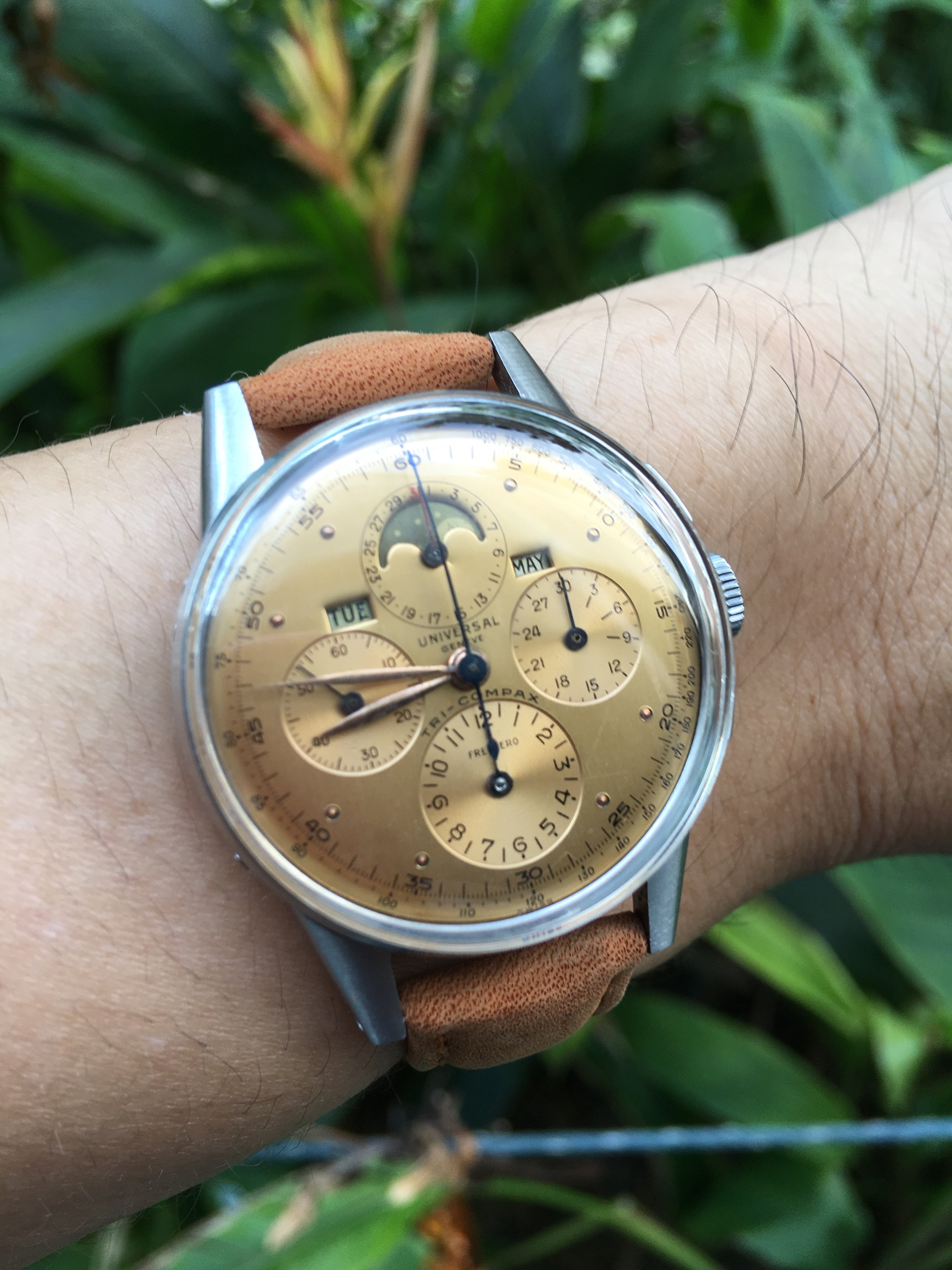

My 22258:
My 22279:

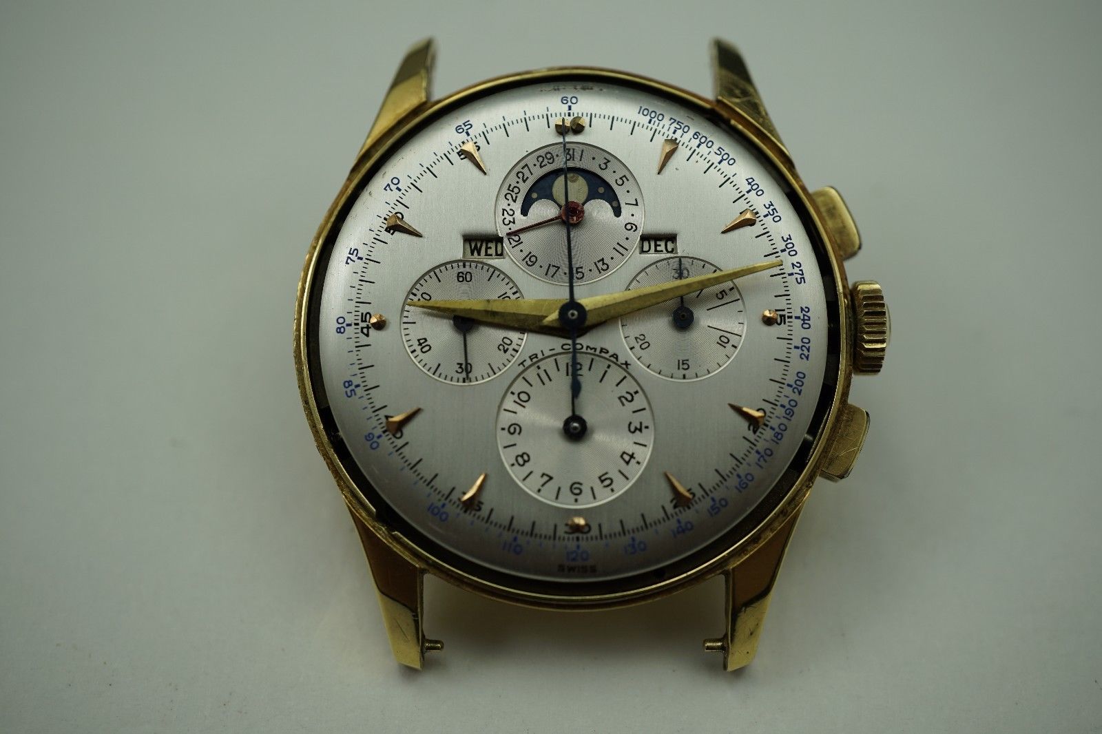

Not at all impossible... but it was a lot easier to find a Tri-Compax with original dial and furniture a few years ago. Here's one from the 40's, showing its age:

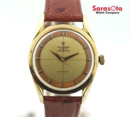

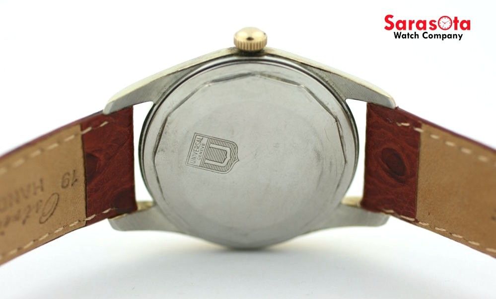

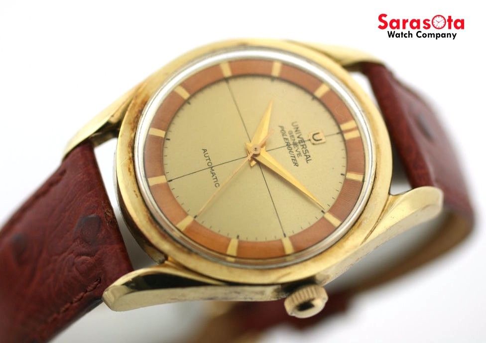

New Polerouter just come up on ebay.
Unusual orange/ brown colour of the chapter ring/ inner bezel, I've never seen this before...
Any thoughts on it?
Few things I've noticed is the minute markers dont meet up inline with the chapter/bezel.
No serial number on the case back.
font and crosshairs look a bit thick and fresh.
http://www.ebay.co.uk/itm/Vintage-U...443838?hash=item1c711768be:g:d98AAOSwzaJX7Ah9
Any thoughts on it?
