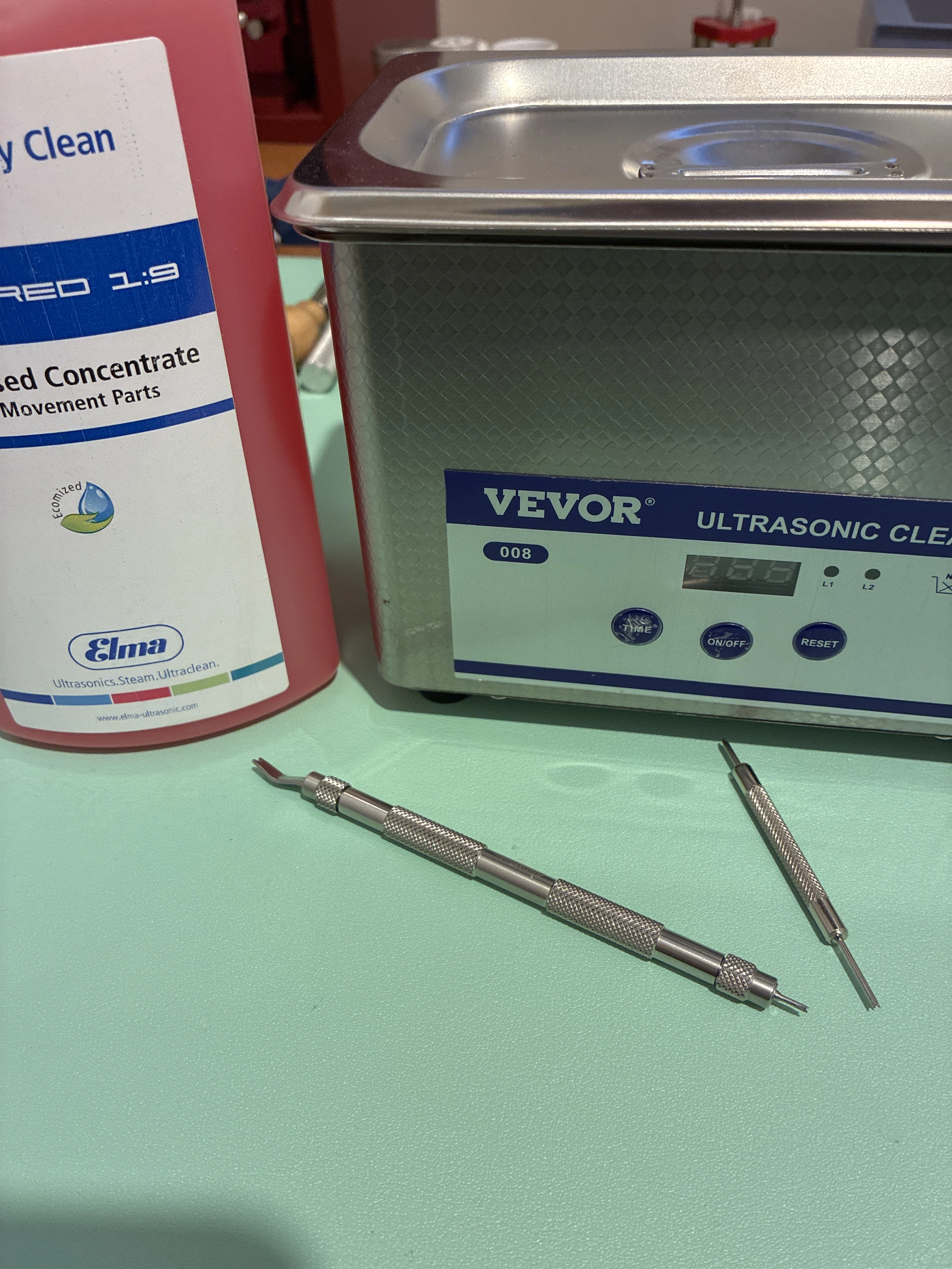

I have a Vevor (Chinese) ultrasonic that is also ok and does a good job on cleaning bracelets, it’s a relatively cheap unit, cost me€32. I use Elma red 1:9 cleaning solution and rinse thoroughly and dry after. I personally wouldn’t risk having the watch on a stand, I would remove the bracelet.

I see the Vevor ultrasonic cleaners are available on Amazon. Don't see the GT Sonic models available. The Vevor in 1.3 or 2 L should work fine, correct?

A 1.3L should be enough, mine is 0.8 L and while it works it could be a little bit bigger. I imagine the same tool will be good for both bracelets, I have a couple of modern omegas and they are fine but I do not have a Rolex. I have thought a few times about a pincher type but as I have a few single types I’ll stick with them.

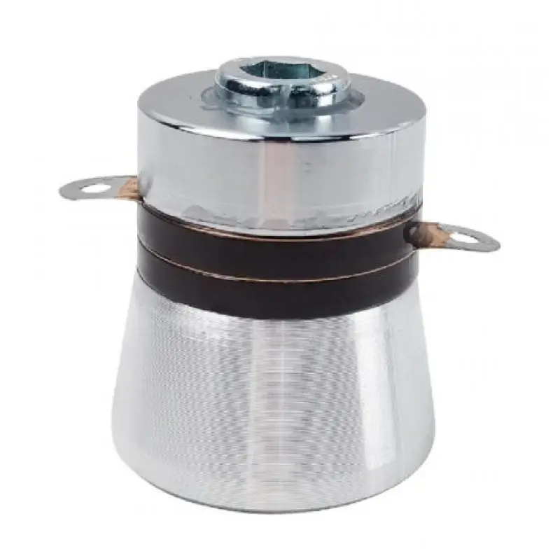

Here's the secret on ultrasonic cleaners: they are ALL (and I mean ALL of them from commerical ones to cheap Harbor Freight ones) using the exact same transducers(within a dozen models, but cleaners are almost exclusively the same ones even in that) from more or less the same factories. I did a deep dive on it earlier this year.
They are all one or more of these glued to the bottom of a metal pan. IF it doesn't have a metal tub though, it isn't an ultrasonic cleaner. Those just don't do the same thing. The Vevor one that @BAJJ shows there is relabeled by a million different brands.
The driver boards, there are only 2-3 designs, and no real advantage or way of telling which is which.
IMO, buy an inexpensive one that has a metal pan (and plenty of room for the transducer below it!), and you'll be happy.

The only way to change power is to add transducers. You can do different frequencies by changing the transducers with different ones, but I'd doubt many machines do.
The plastic tray ones are just a vibrating motor (like the one in your PlayStation controllers) with an offset weight at the end, so are just "sonic" cleaners.
But rule of thumb is if they use a metal tray, they are probably using the same $10 transducer as everyone else and the same $20 driver boards and are basically equal.

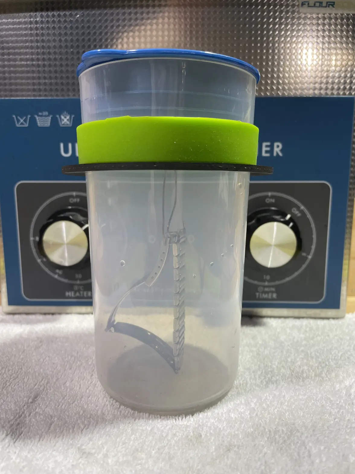

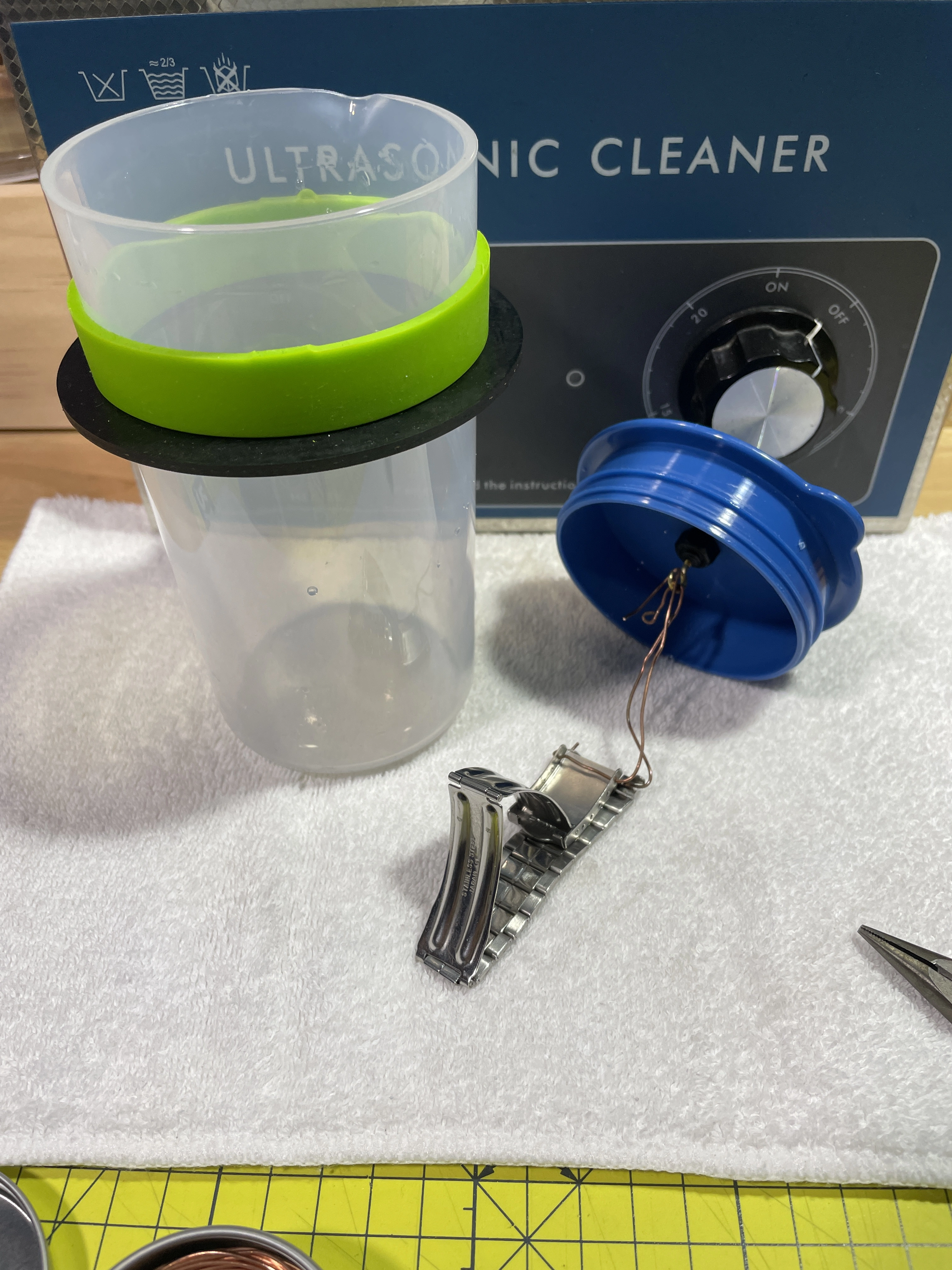

I see that some of the cleaners come with a watch stand, so only the bracelet is in the solution. Is that setup acceptable,
No, U/S vibrations will travel through the whole watch and although attenuated, are not desirable.

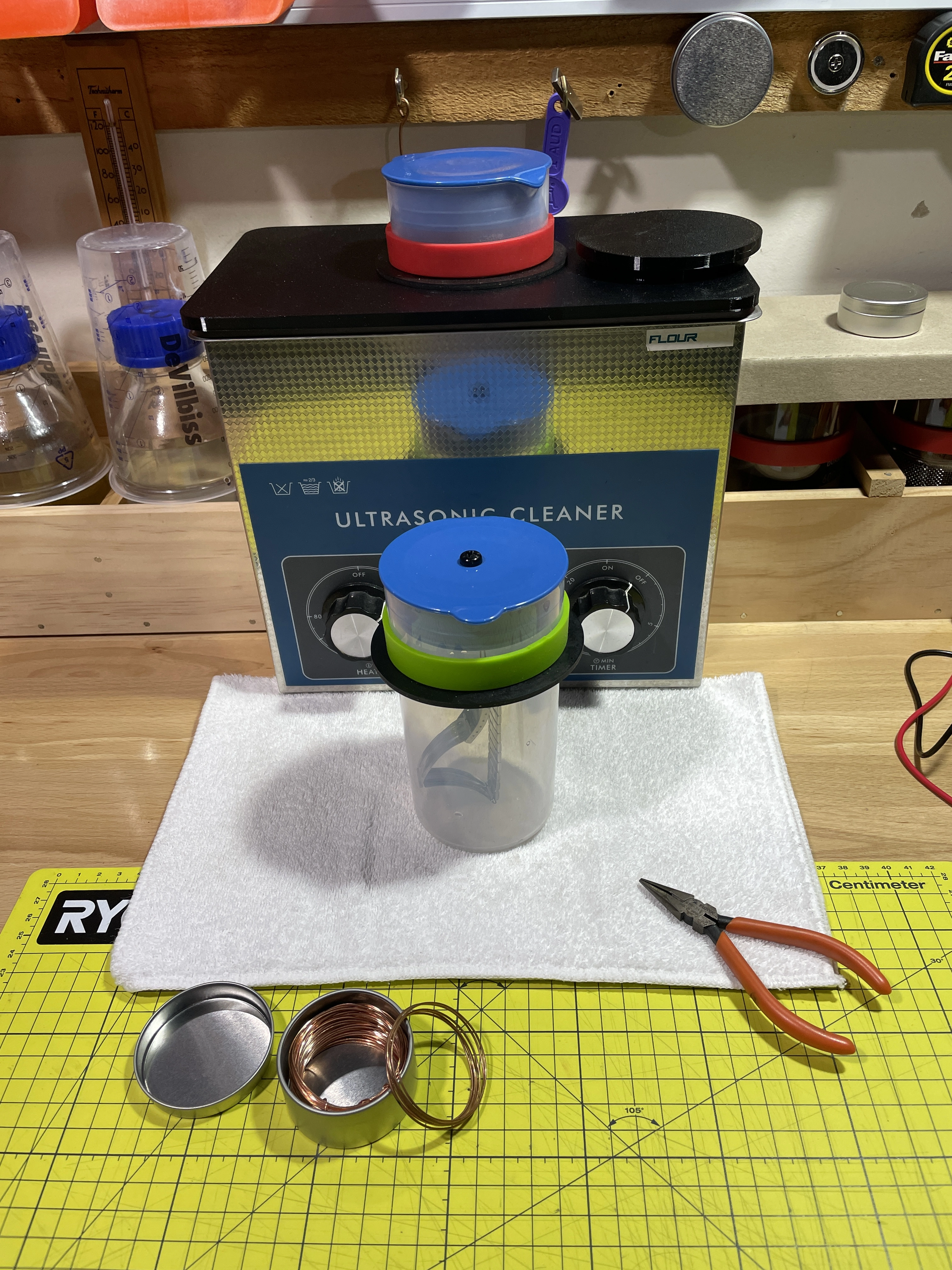

Plenty of good advice above, my set-up for most things.
Bracelet example.
