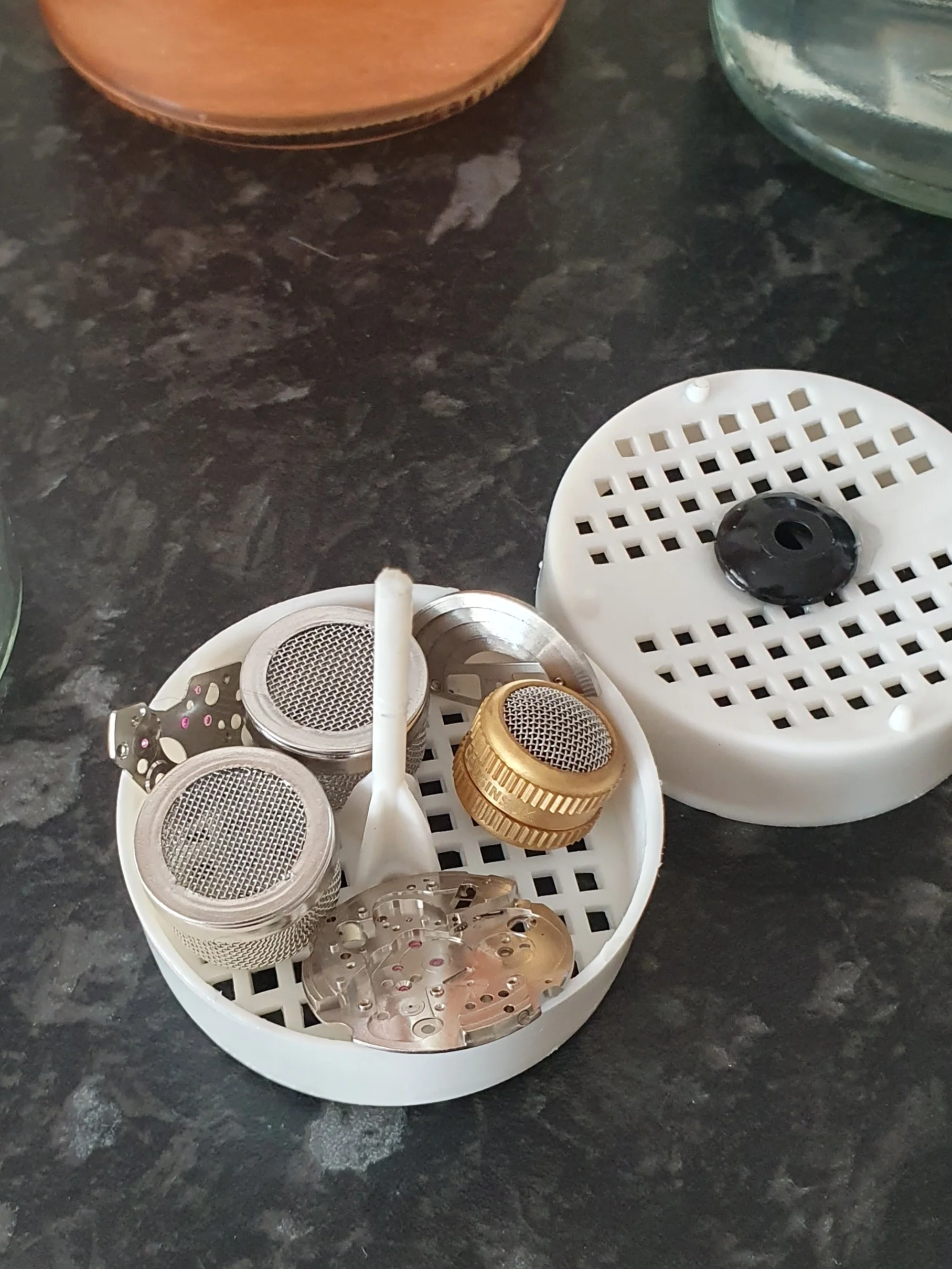

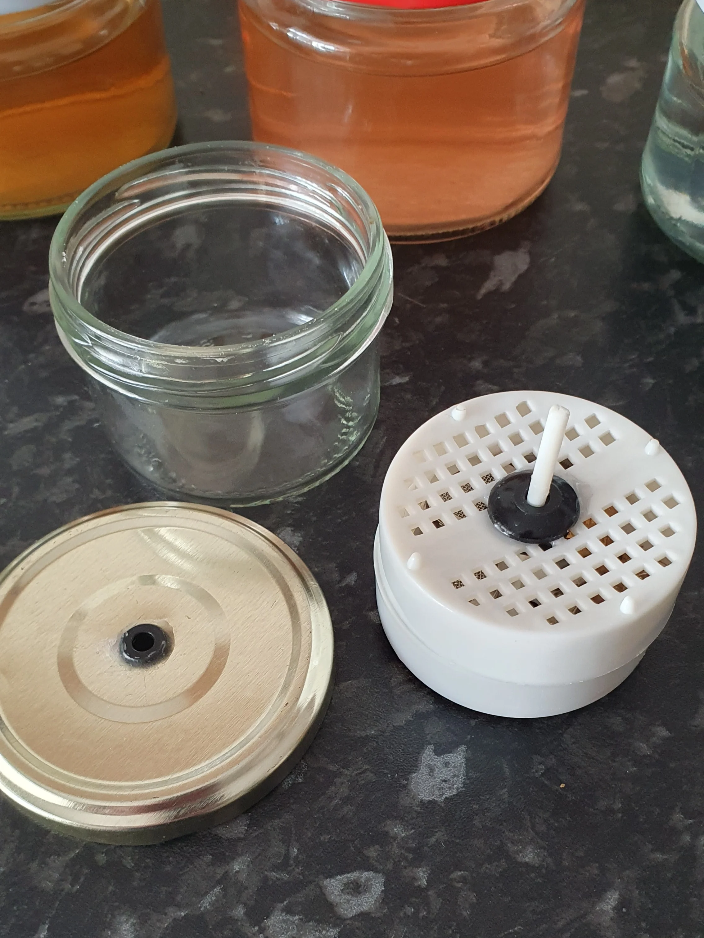

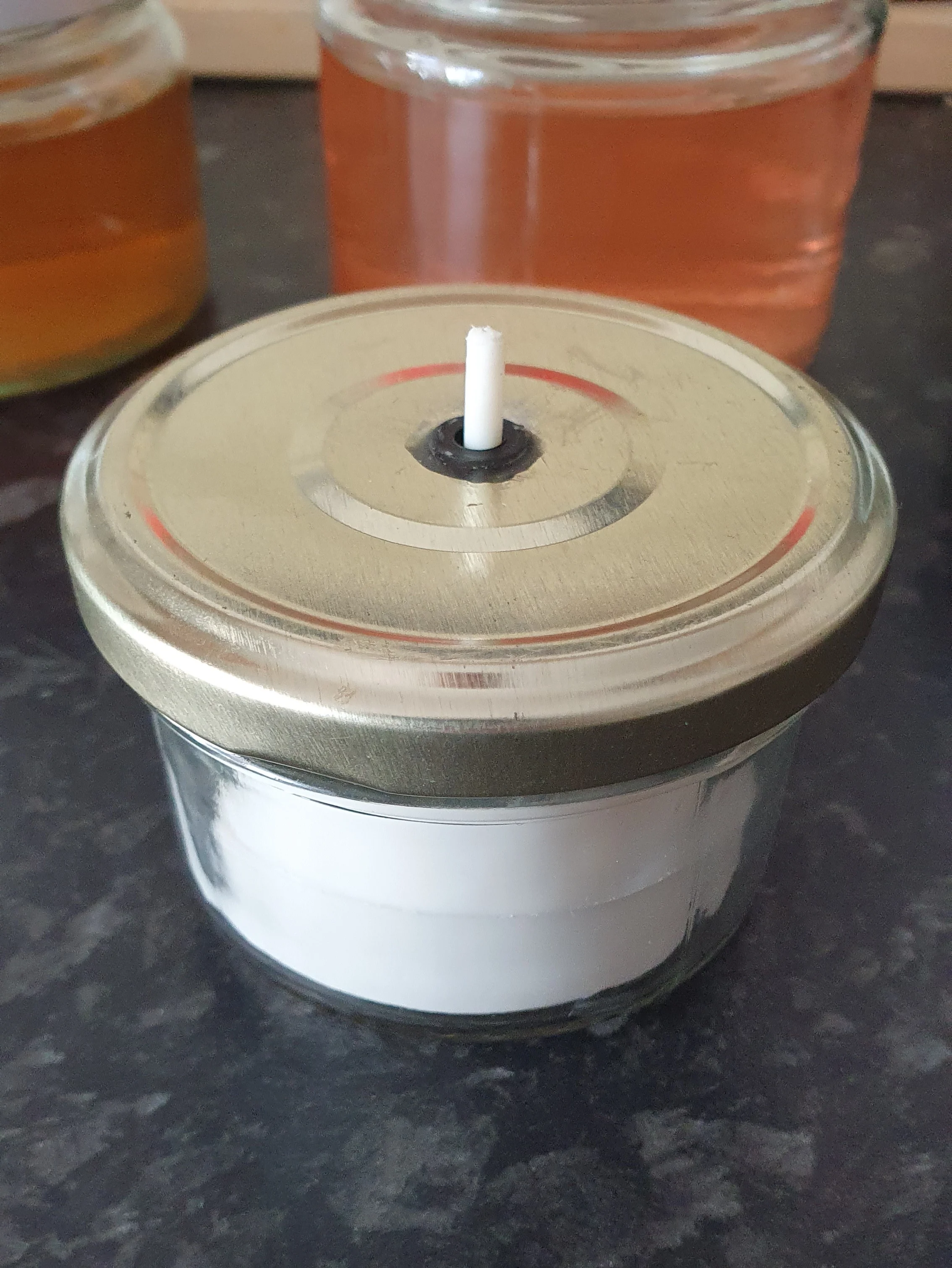

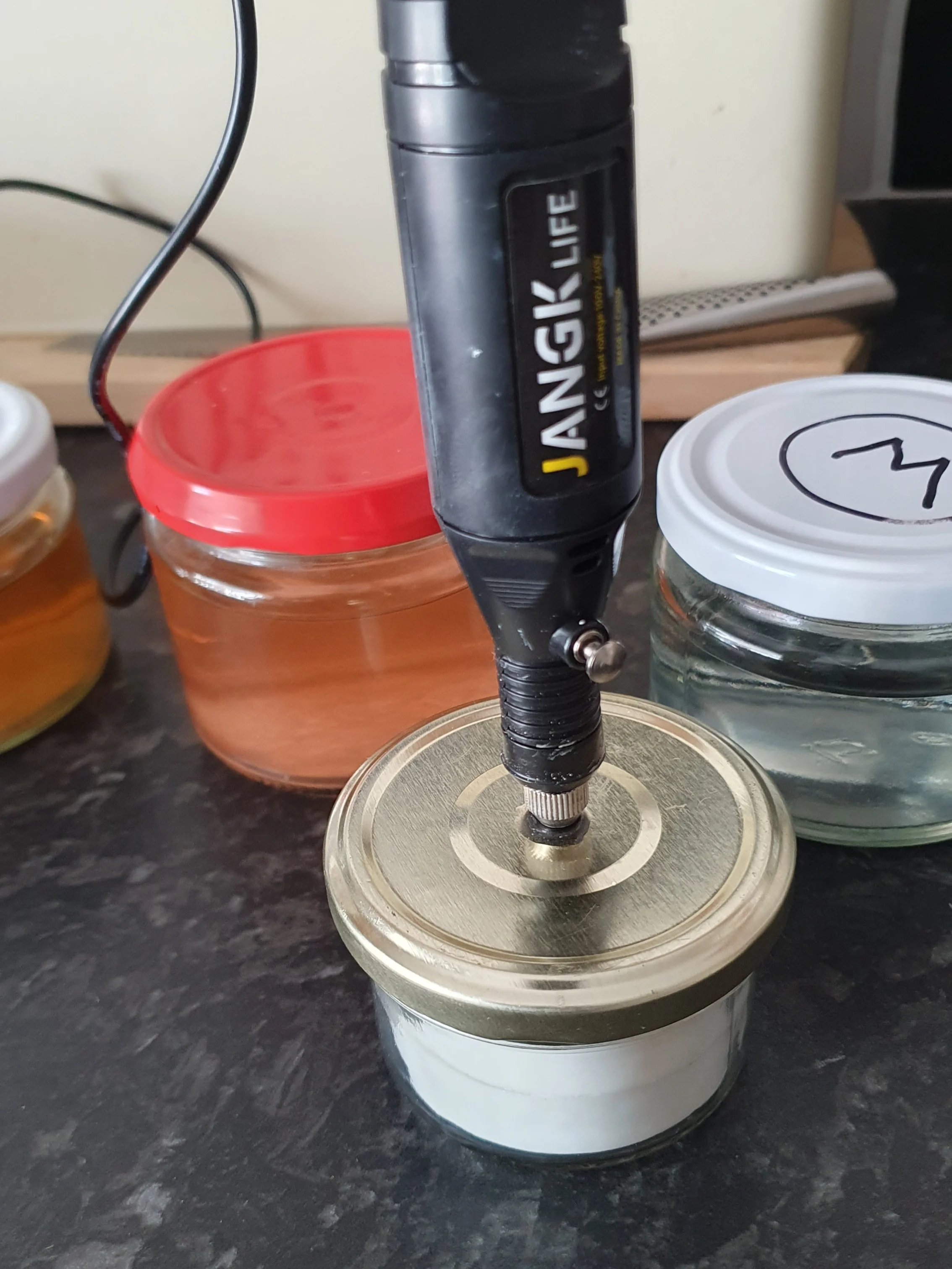

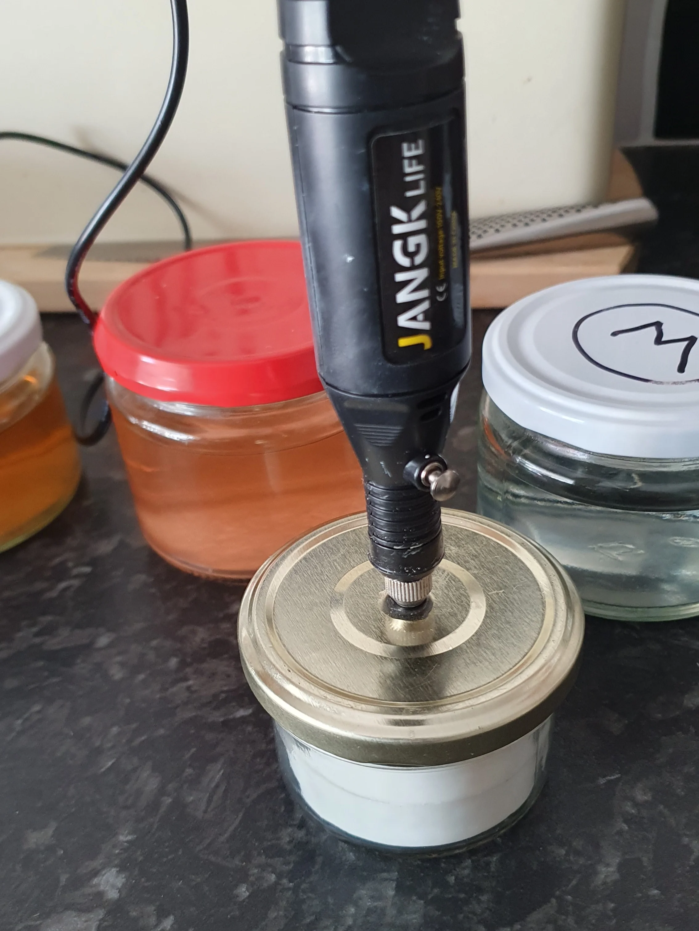

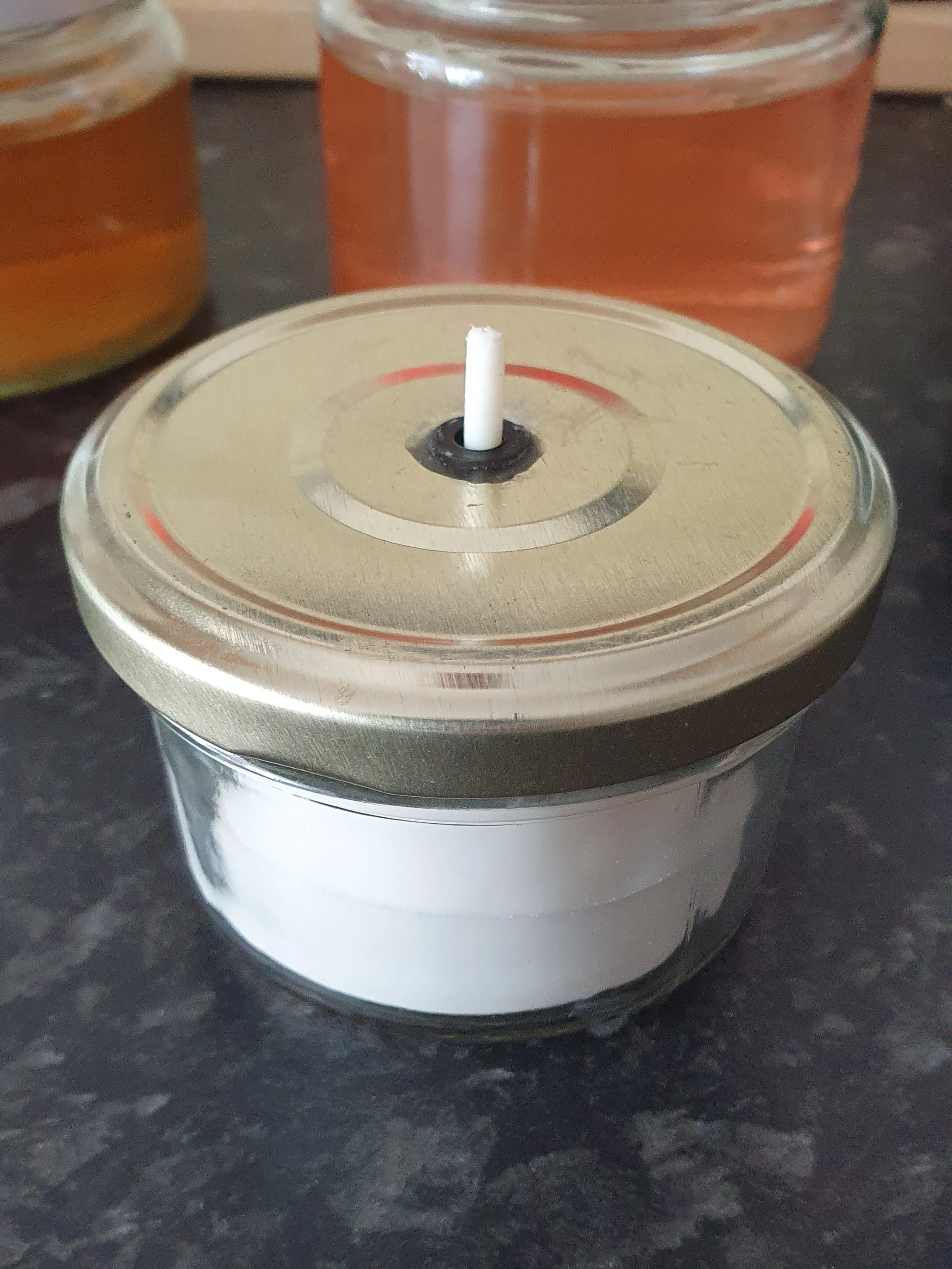

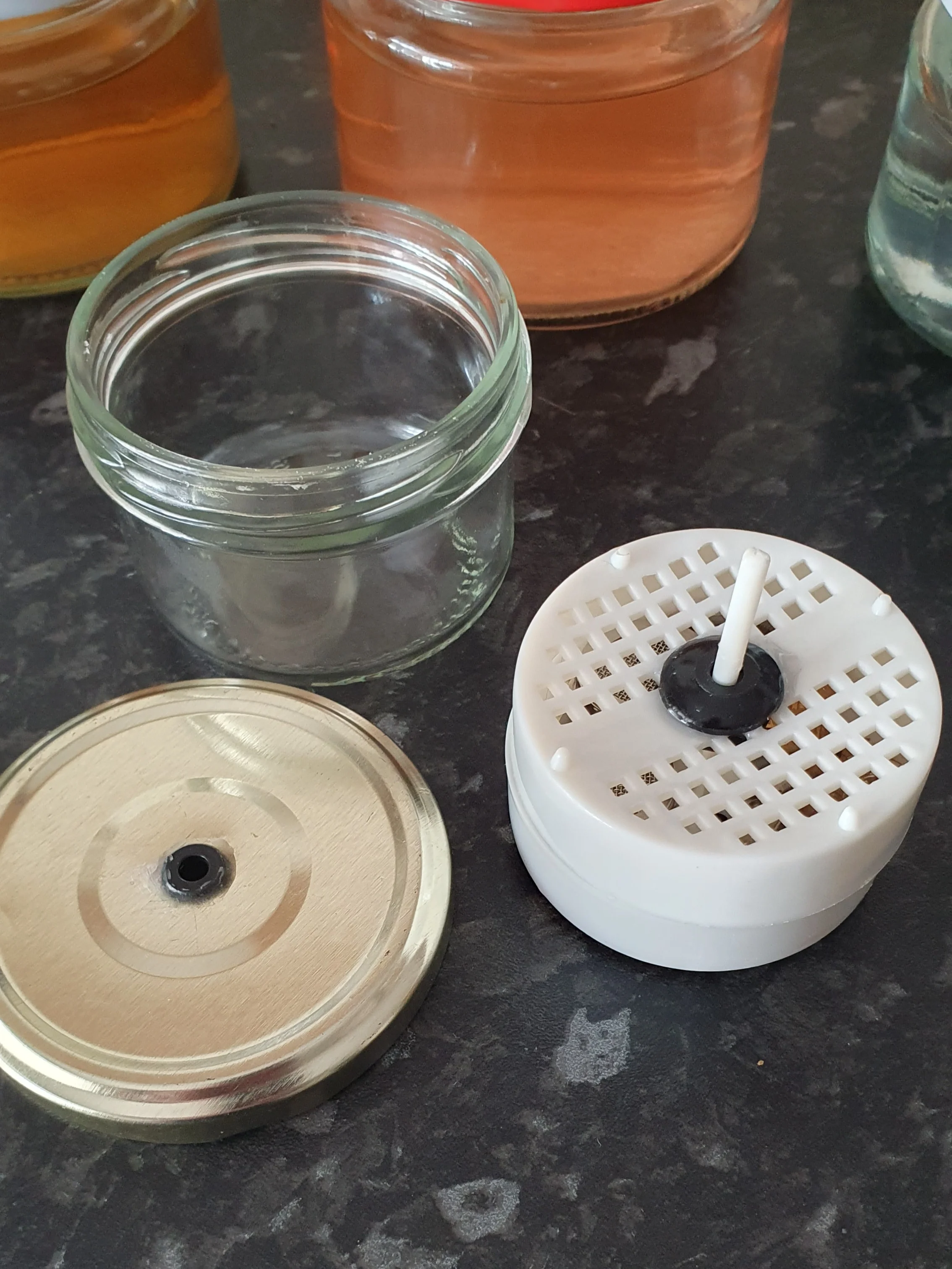

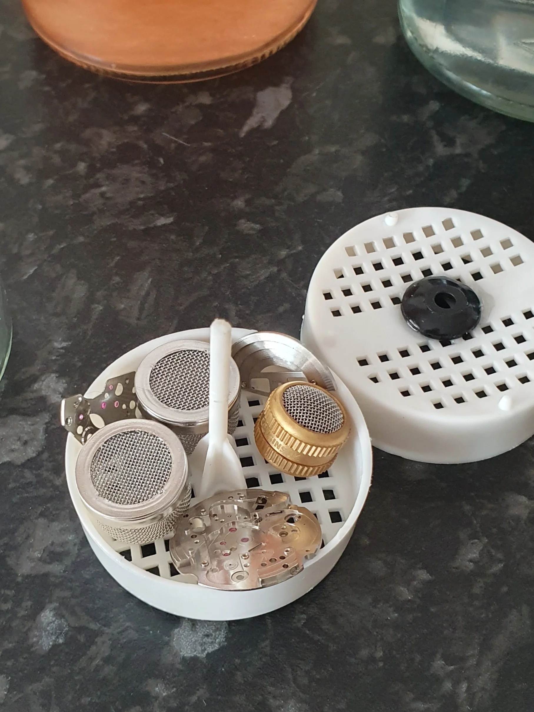

This is my cheapskate DIY spin dryer 😬
Probably not recommended but it suffices my 1 a month cheapo Seiko rebuild. A de-ionised rinse (or two) does help remove stains and a pre-wash is handy on particularly stinky movements, I've now got 6 jars in my cleaning routine which is a bit overkill but it passes the day 😀 That kiwiprinter is very interesting, if I ever increase production it's definitely one to keep an eye on.

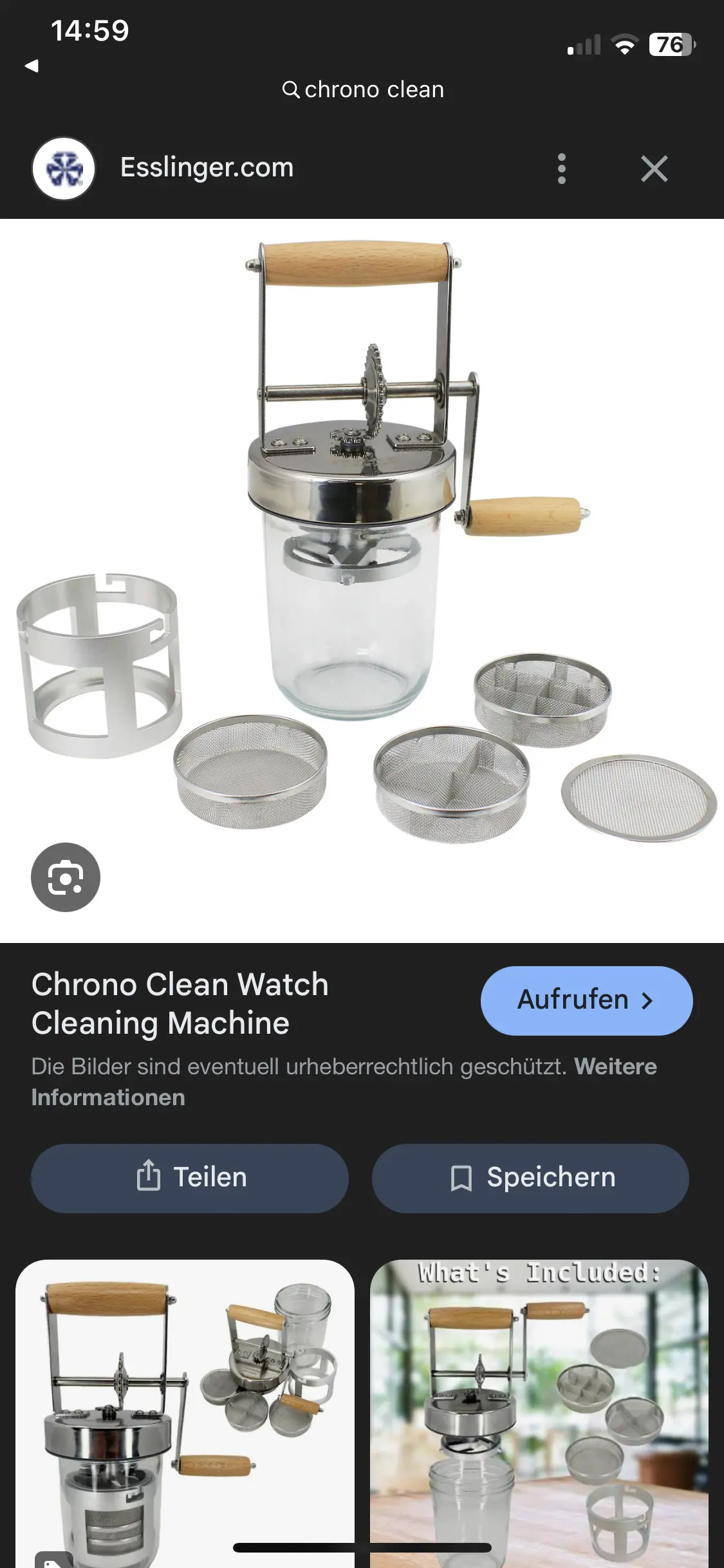

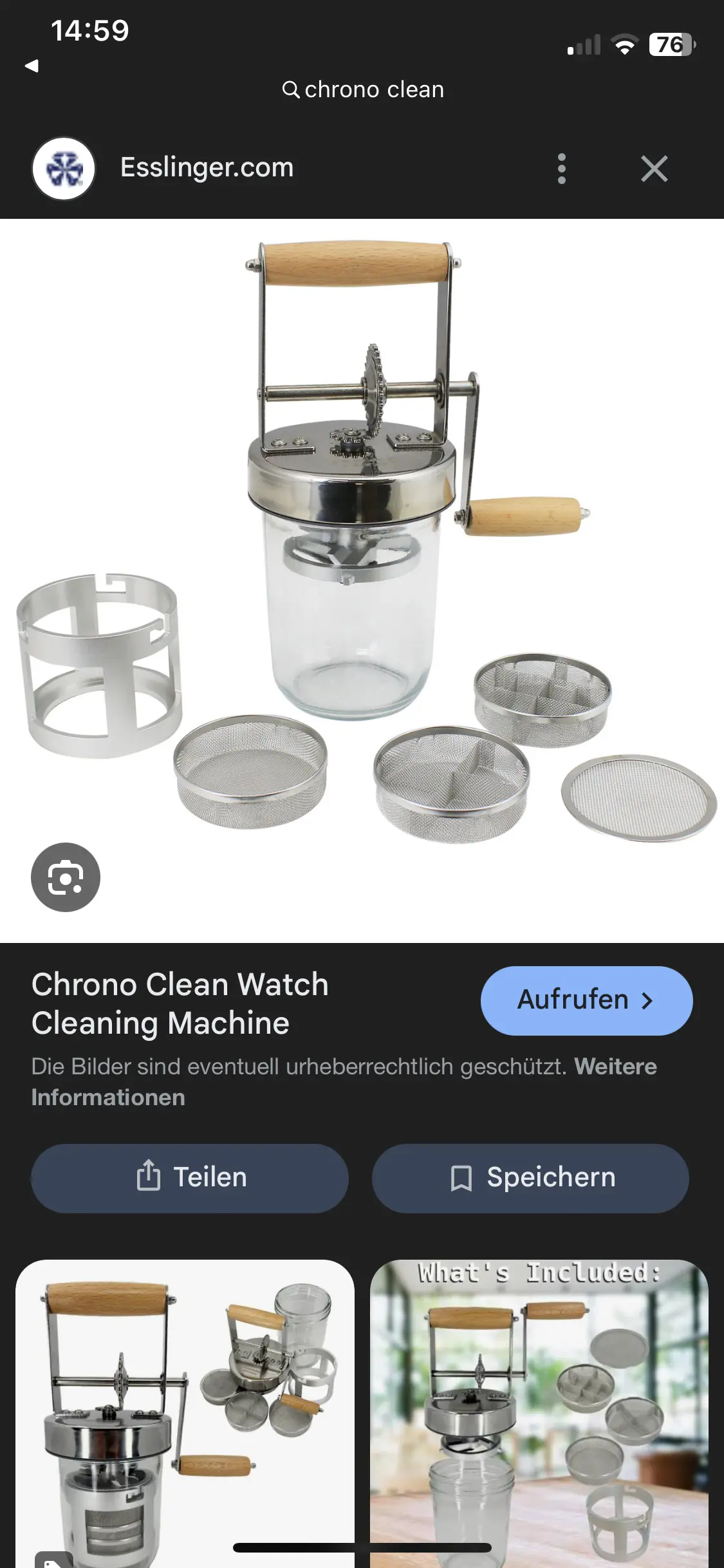

Im thinking about Building myself something Like this
That is the one non-full-machine version I heard anything positive about. Note it doesn't do heated dry/have a way to do that easily though.
