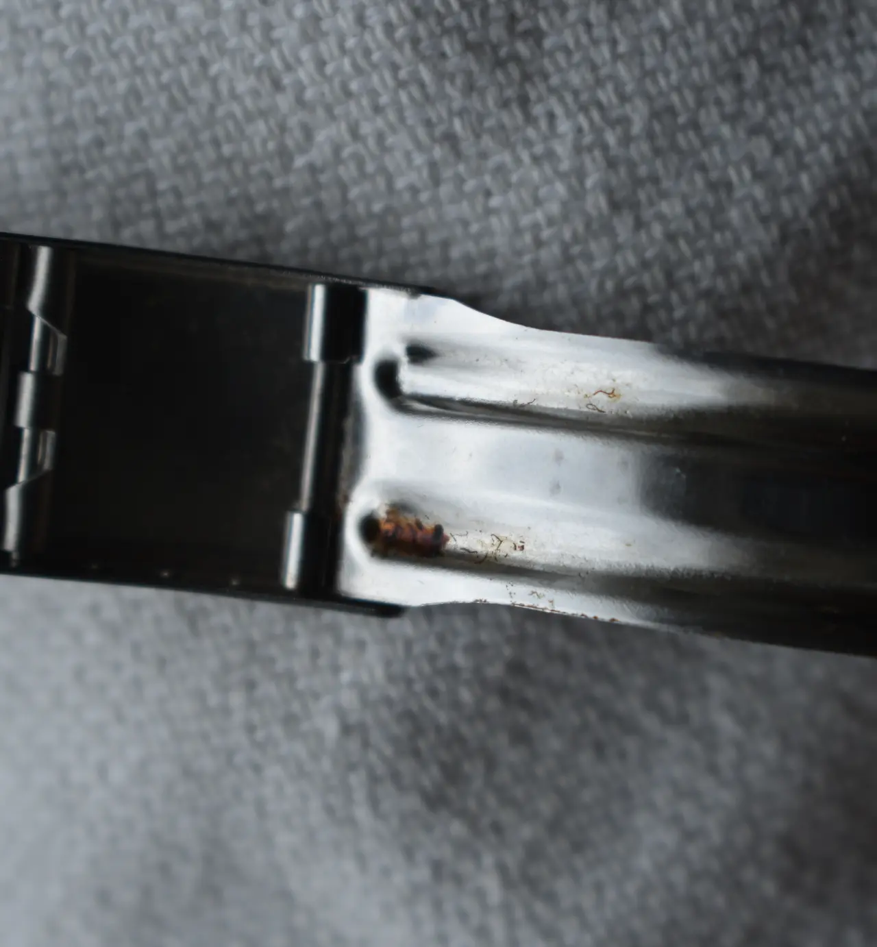

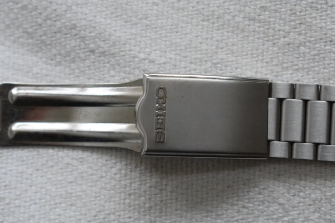

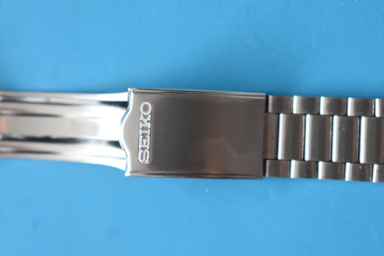

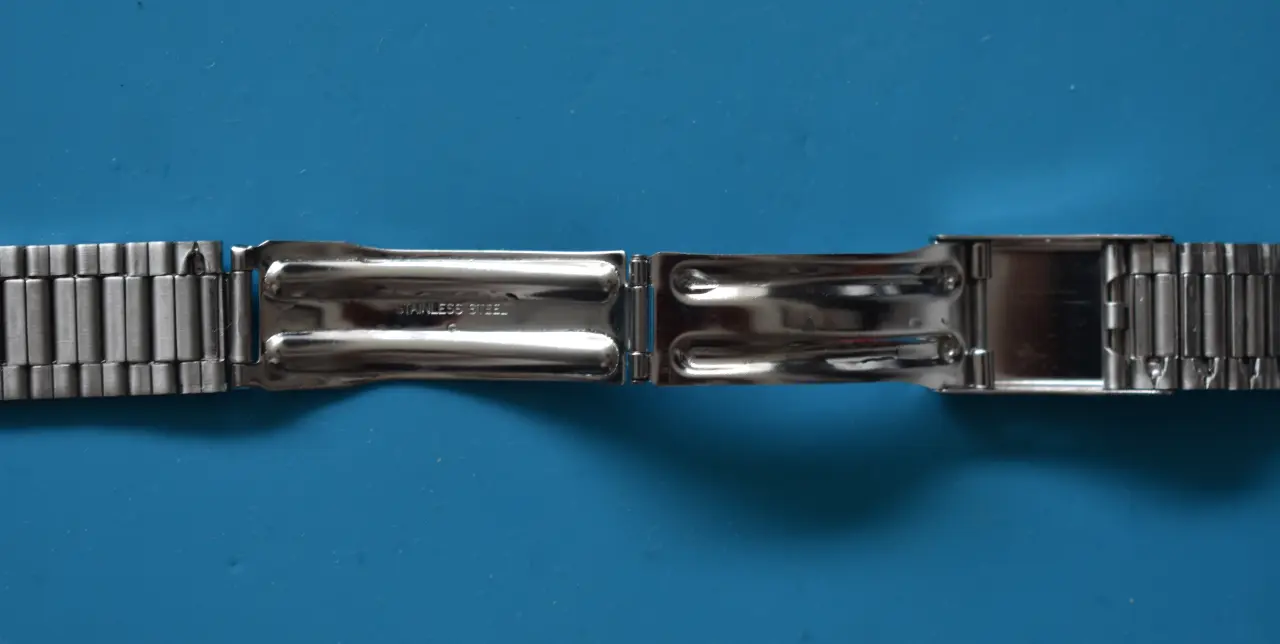

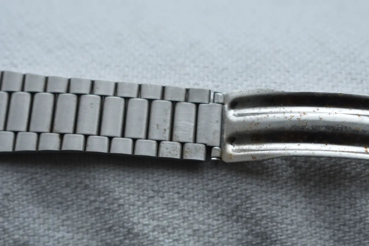

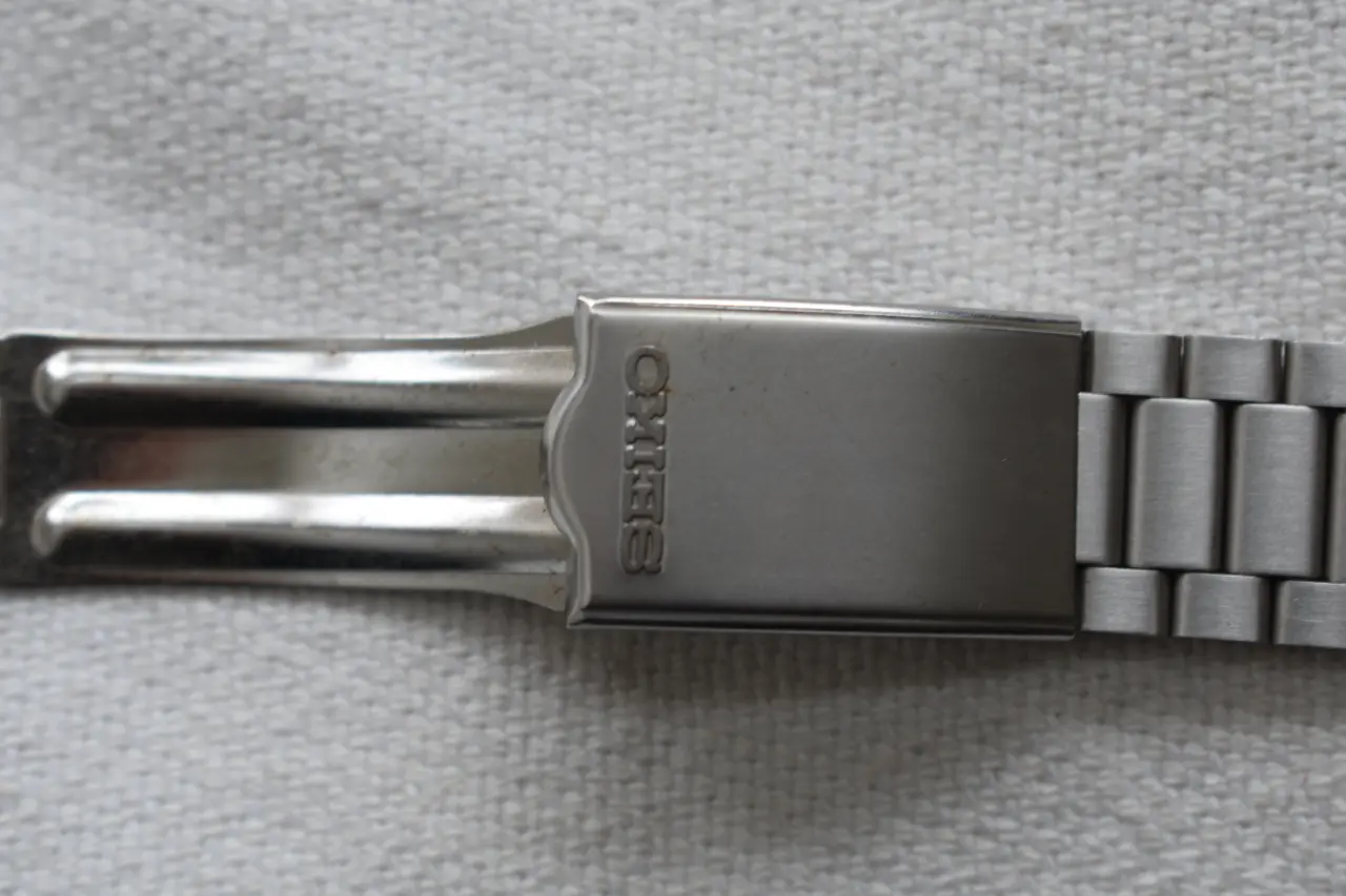

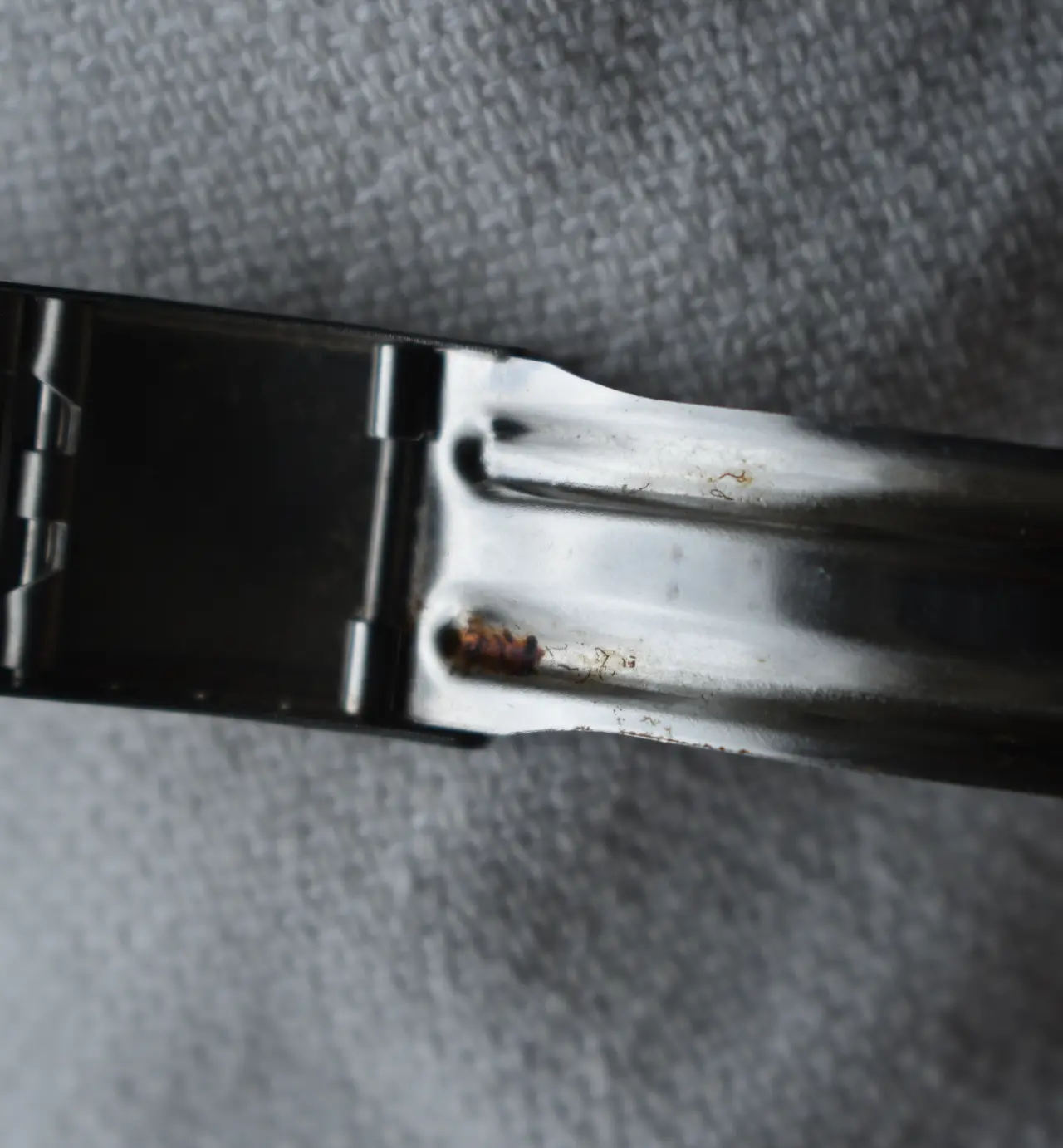

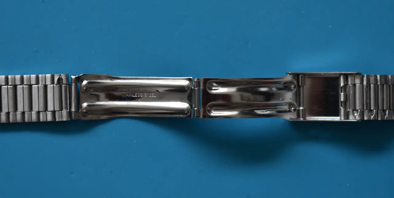

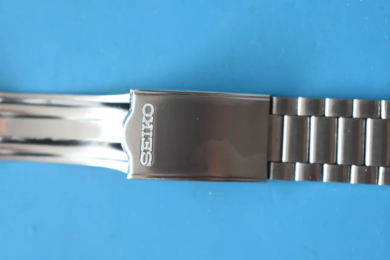

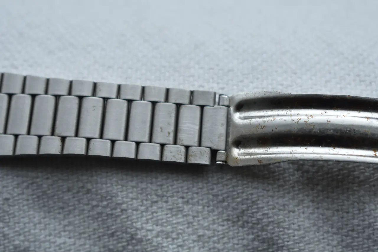

Here's before/after of a 40-year old NOS Seiko bracelet I put in the ultrasonic.
Thought it was rust and would not be removed, but 180 seconds in a cheap ultrasonic with some dish soap made it look brand new.
2,781
4,696
Yeah they are great at decrudifing stuff!
