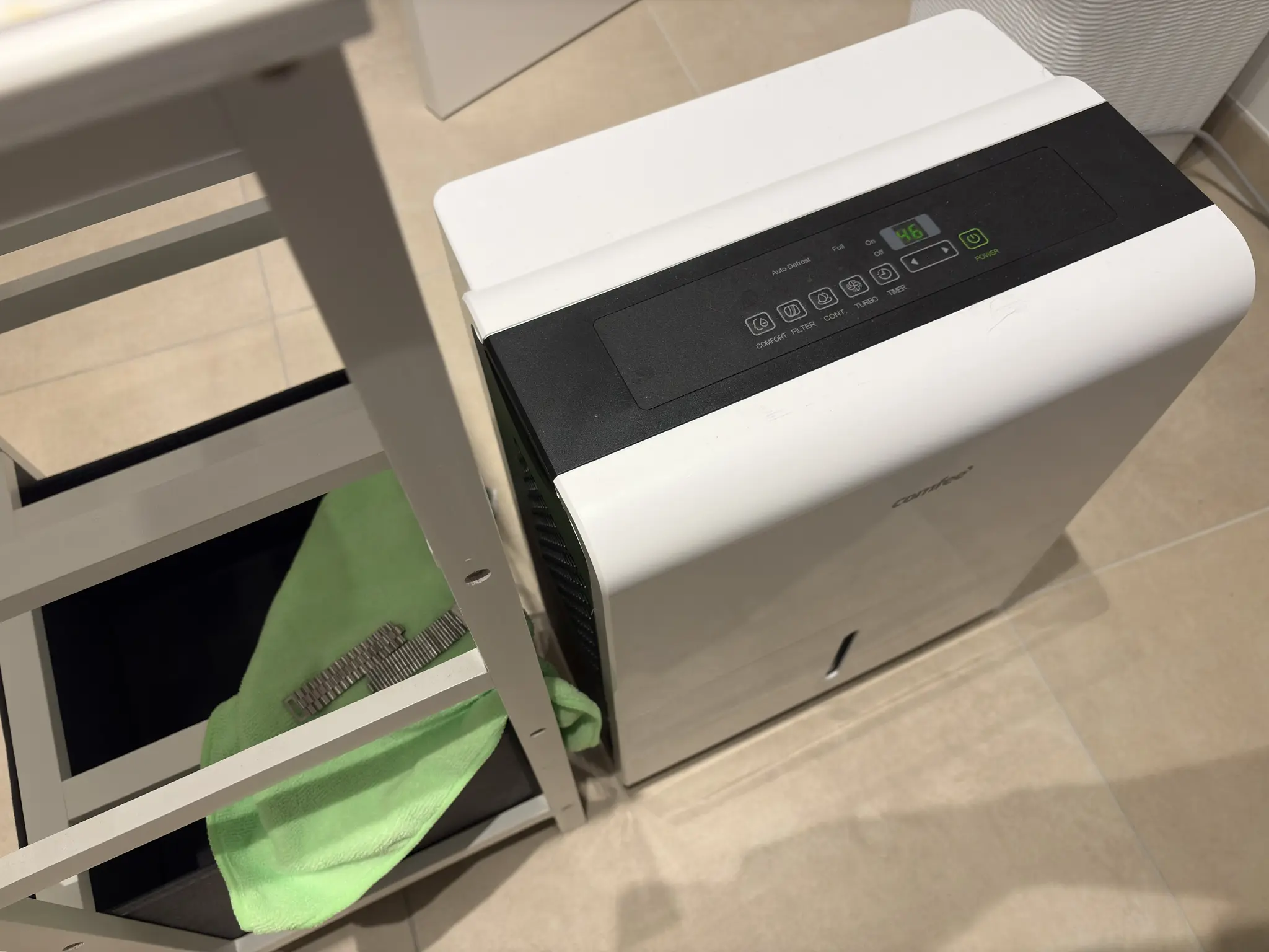

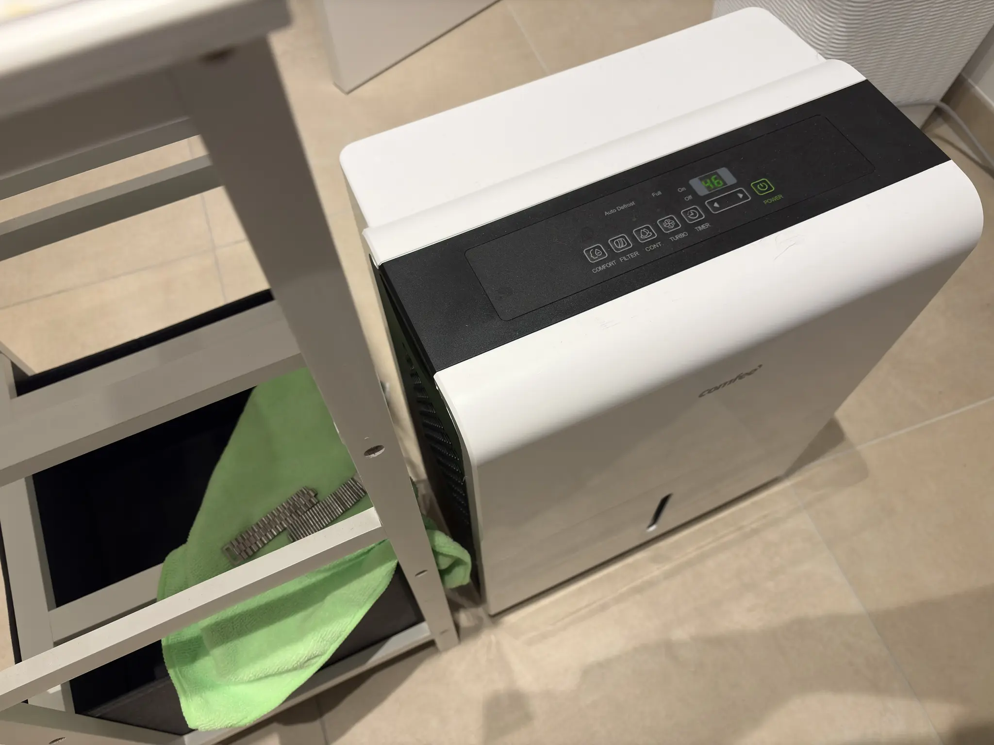

143
1,085
We have an air dryer that I run in a bathroom (small space) with its exhaust pointed towards the bracelet (the air outputted is both warm and dry). And wipe them with a cloth before placing there.
