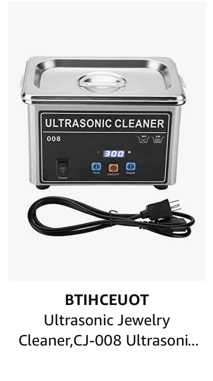

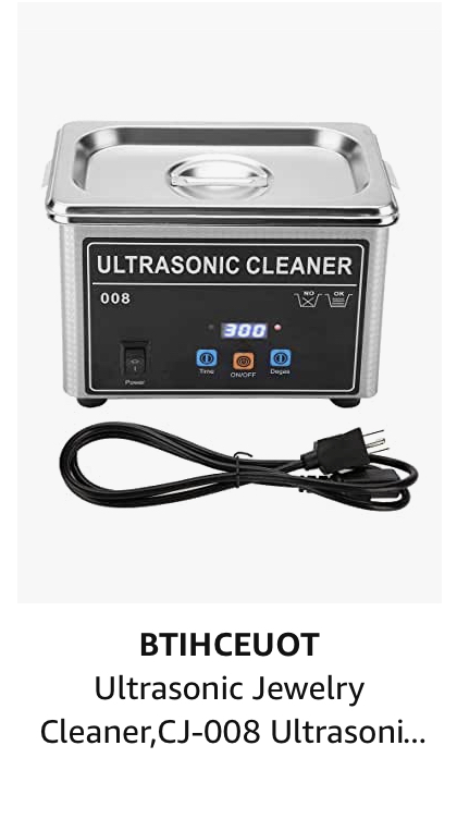

I had a reasonable amount of success cleaning crud of bracelets with this affordable unit - but as @Canuck mentions it’s nottremendously powerful
I’m considering an upgrade and haven’t had this particular unit for long, so you can tell how I feel about it.😉
Ultrasonic Jewelry Cleaner,CJ-008 Ultrasonic Cleaning Machine for Jewelry Watch Glasses False Teeth (US Plug) https://www.amazon.com/dp/B082J43YH7/ref=cm_sw_r_cp_api_i_m6M0EbQ75QT7B

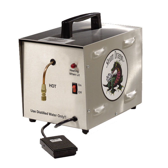

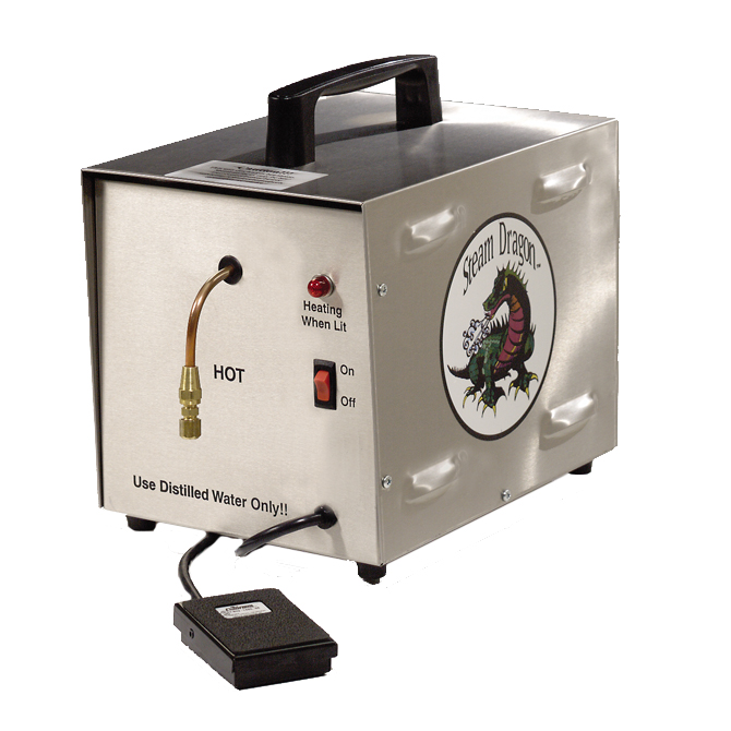

Yes. You can get a lot out with ultrasonic cleaning and brushing, but there will still be dirt inside. If you want to go one step further, the common additional item used by professionals is a steam cleaner.

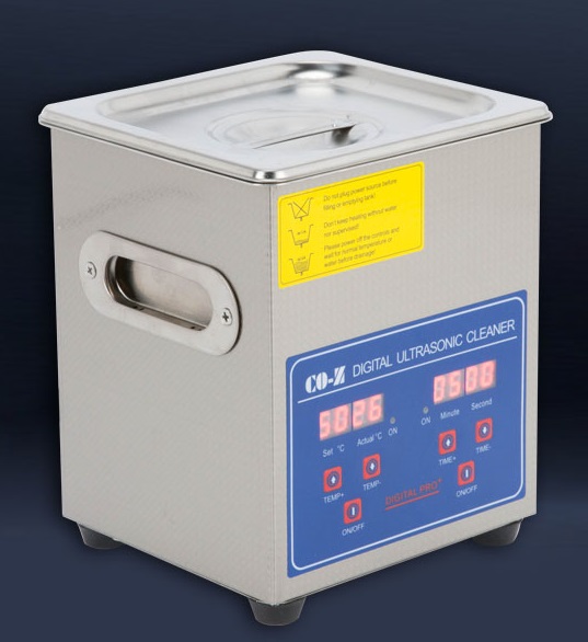

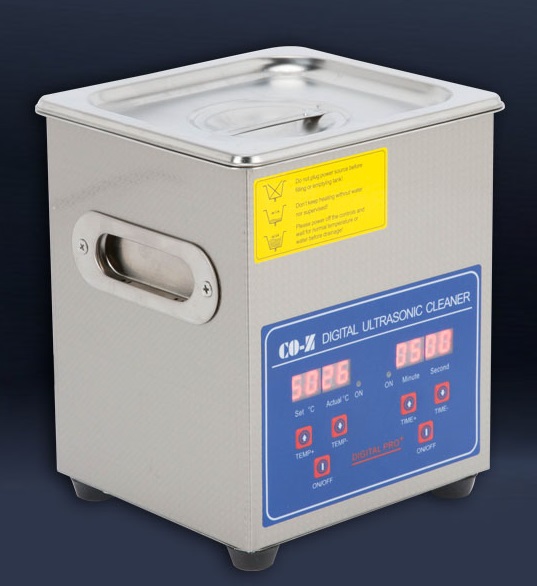

I find 15 minutes with 50C water and a dash of "Dawn", maybe a quarter teaspoon is adequate. In the UK it's called "Fairy Liquid". My ultrasonic isn't commercial but far better than the plastic things sold at jewelry and hardware stores. It's supposedly rated at 60 w on the driver and another 50 w on the heater. I find it not as noisy as my Watchmaster but then the container is much larger.
I've taken a couple tube and pin joints apart to check my work. I think it's far cleaner than I could have gotten with a toothbrush as the toothbrush doesn't get into the spaces between pin, tube and link. I'm sure there are applications where a brush would do better, for instance the underside of a bezel that I had to leave in the ultrasonic for a full hour to get clean. It also cleaned the filling out of the number engravings.
Or the milk froth wand from a coffee machine if your in a pinch.
Use this for the odd thing 😁
