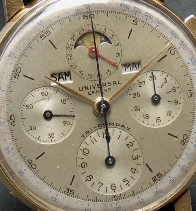

Hello everyone.
What do people here think of this watch?
The case looks wrong but the dial itself, seems genuine or not really?
Thanks

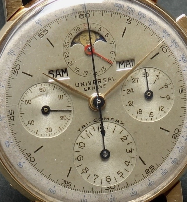

Hello everyone.
Thanks
We need to see the case, the reference and SN, back and inside of the caseback. Yes the dial is real as is the moon disc. Decent shape too. It should be a late 1930’s / early mid 1940’s case SN.

Hello everyone.
Thanks
you should start a separate thread for this watch. Given the french day/month discs it could be a locally cased (non swiss UG) case, the one lug we can see certainly does not look like a UG case that I'm familiar with.

I'll try to get some better photos, can I ask, what do you mean by locally cased?
Why wouldn't they just use UG cases?
Certain countries like france, UK and US had tariffs on Gold.
I have a 1961 with french day date. Not necessarily indicator of a french case. Then again this is a watch from a different era.
