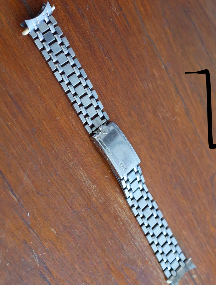

Yes, that's a KonTiki bracelet combined with an anonymous GF clasp. I hope you did not pay anywhere near the $2600 ask.
6,904
10,766
Thanks! No I paid a fraction of that price.

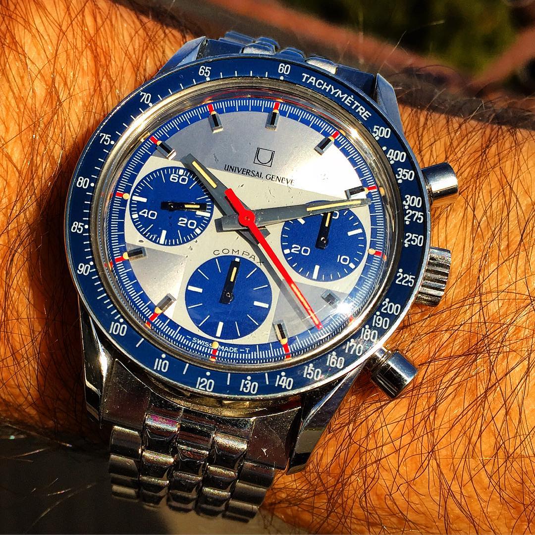

i know this is an old thread. . but i am looking on definitive information on the following:
-What end links originally came with the Nina/Evil Nina?
-I have seen (in this thread) information that UP end links should fit the Nina. However, the Nina is 19mm and I have a pair of end links I believe are correct that do not fit--they are very close to 20mm
-Can anyone tell me what end links came on the Big Eye Unicompax ?
Any information greatly appreciated
And separately. . I am looking for a pair of UW end links which seems like a hopeless quest but if anyone knows of a pair. . .
Thank you
38
186

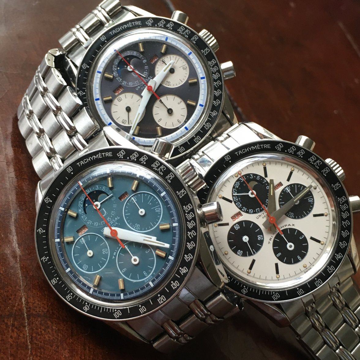

UW ends are original correct ends for Evil and Nina. And for the sister Tri-Compax Models from this era.
UP ends require minor filing in order to work as they are to wide. But profit is very close and they work well with some modification.
No idea on Big eye but others here will know.
UW ends are very hard to find. But they are out there. keep the faith
Jamey
Thank you
38
186
Should be as same case. But I do not know which bracelets these "exotics" came with-if they came with them at all. UW fit these guys though....

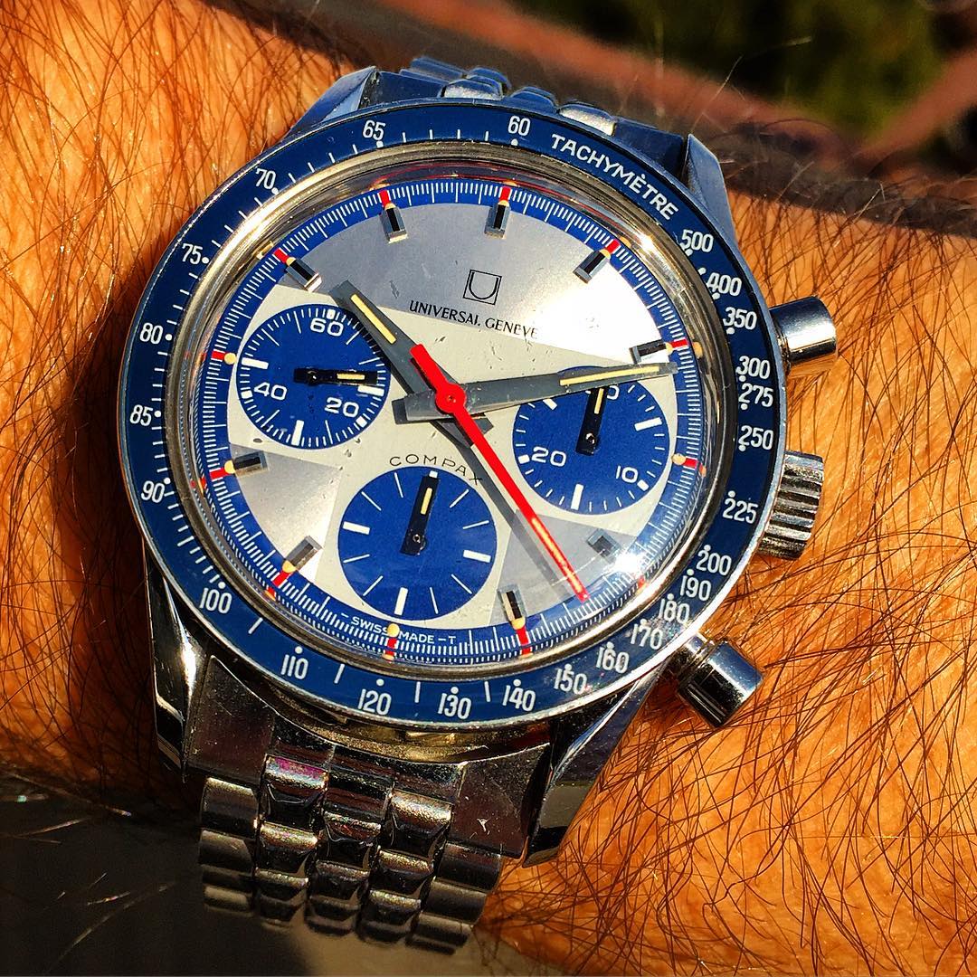

i tried the UP on a big eye-. . 20 but will need to be slightly shaved to fit. anyone know what the UP were originally made for ?

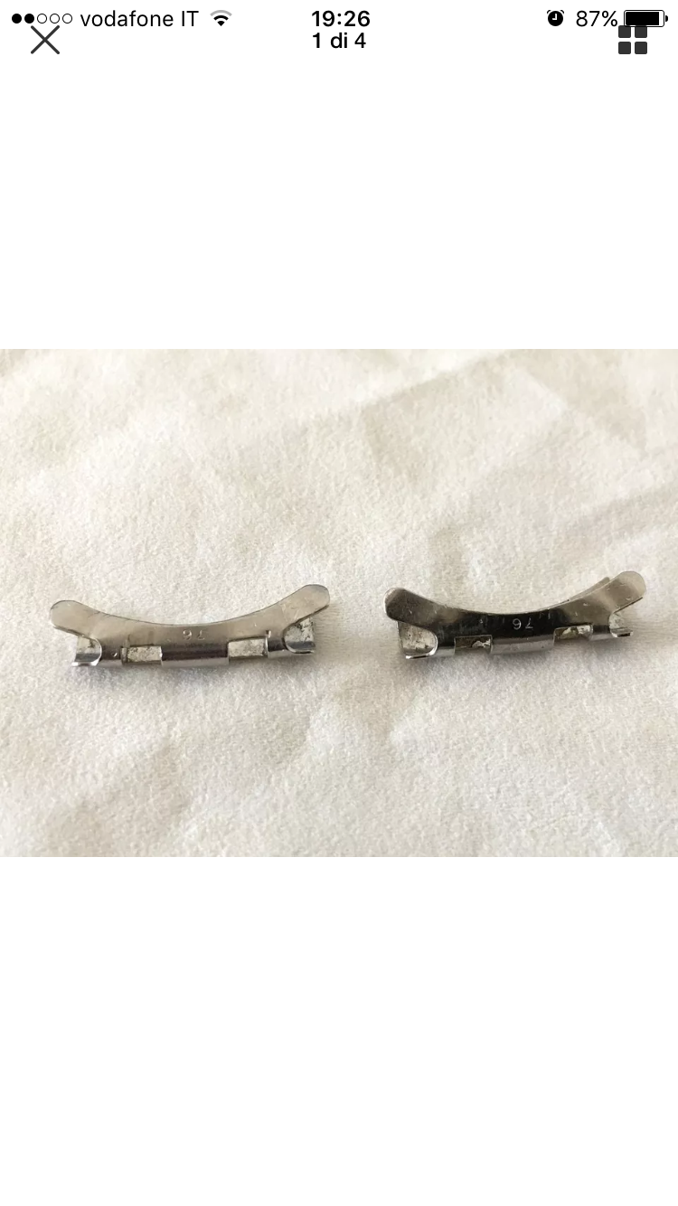

I have these same "76" endlinks on a 19mm JB Champion bracelet. They do not fit the Evil Nina Compax well. They are not as long / tall as the correct UG endlinks and as a result there is a big gap between the endlinks and the case. The width of the endlinks and the fit between the lugs is fine

come on does no one know what the UP were originally made for ? or what came on the big eye unicompax (20mm) ?
thx
1,931
22,761
Polerouter Super
1,294
2,303
well i can confirm that the UP do actually big the big eye unicompax. . without shaving. they did NOT fit a nina which is 19mm not 20mm

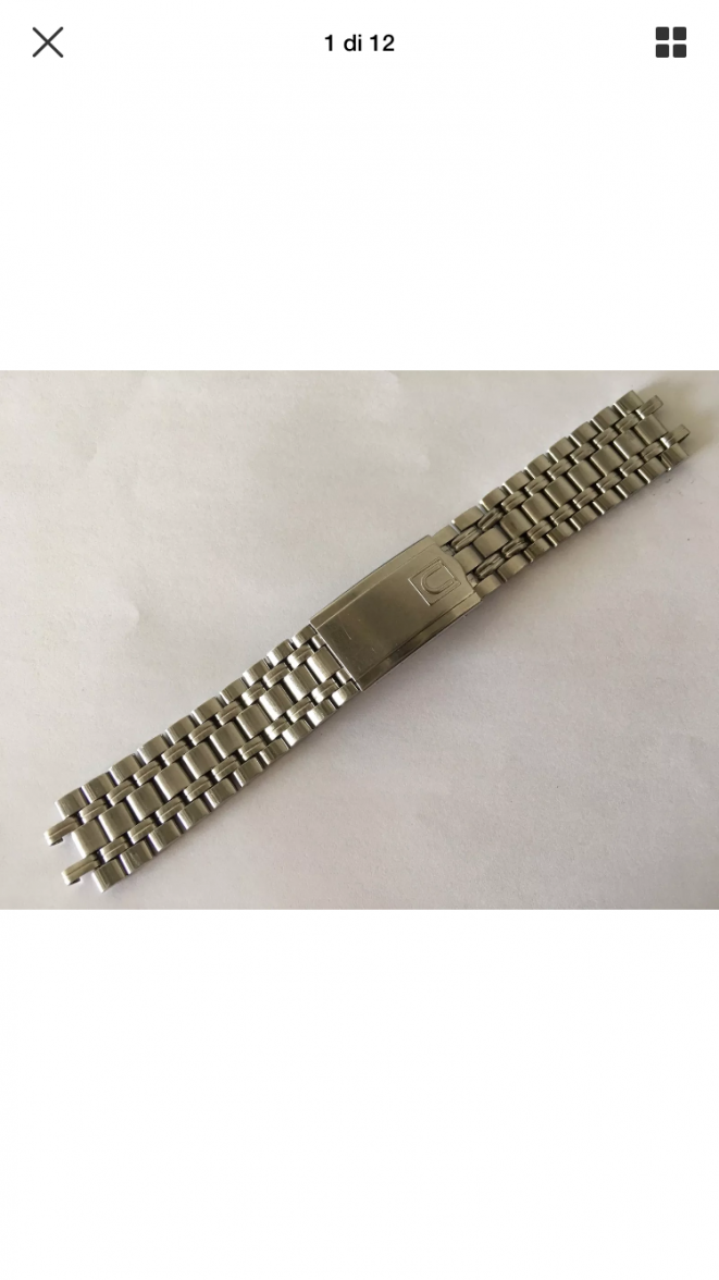

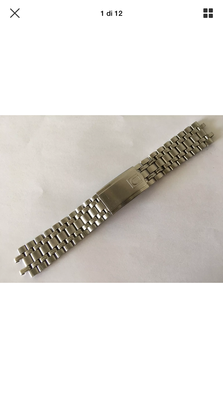

Hi everybody! I have a Polerouter fron 60' on a GF bracelet and i can read the letter "C" on the endlinks 👎? Possible? I read all this thread and never find something about this one? Thanks in advance. 😀
1,211
3,071
Do you have a photo?
437
898
Its an endlink for a Certina, they had similar bracelets.
2,671
24,911
Certina???
Certina is a watch brand. They also use gay Freres bracelet that looks very similar to UG GF bracelet.
Photo from lifted from eBay showing a certina GF bracelet. The styling of the bracelet is the same just that the clasp has different brand on it
