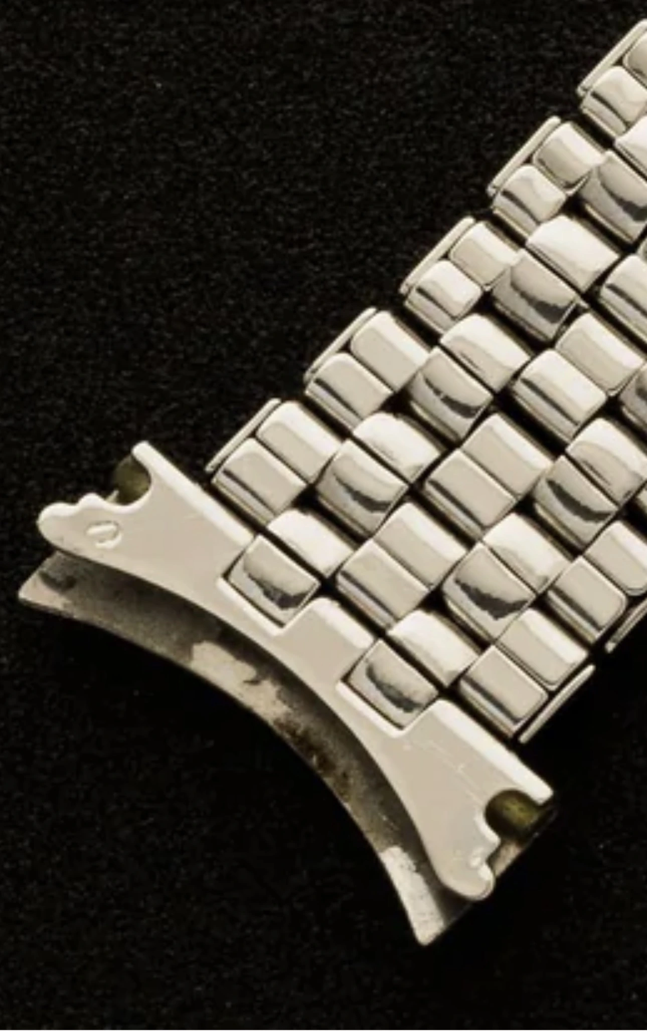

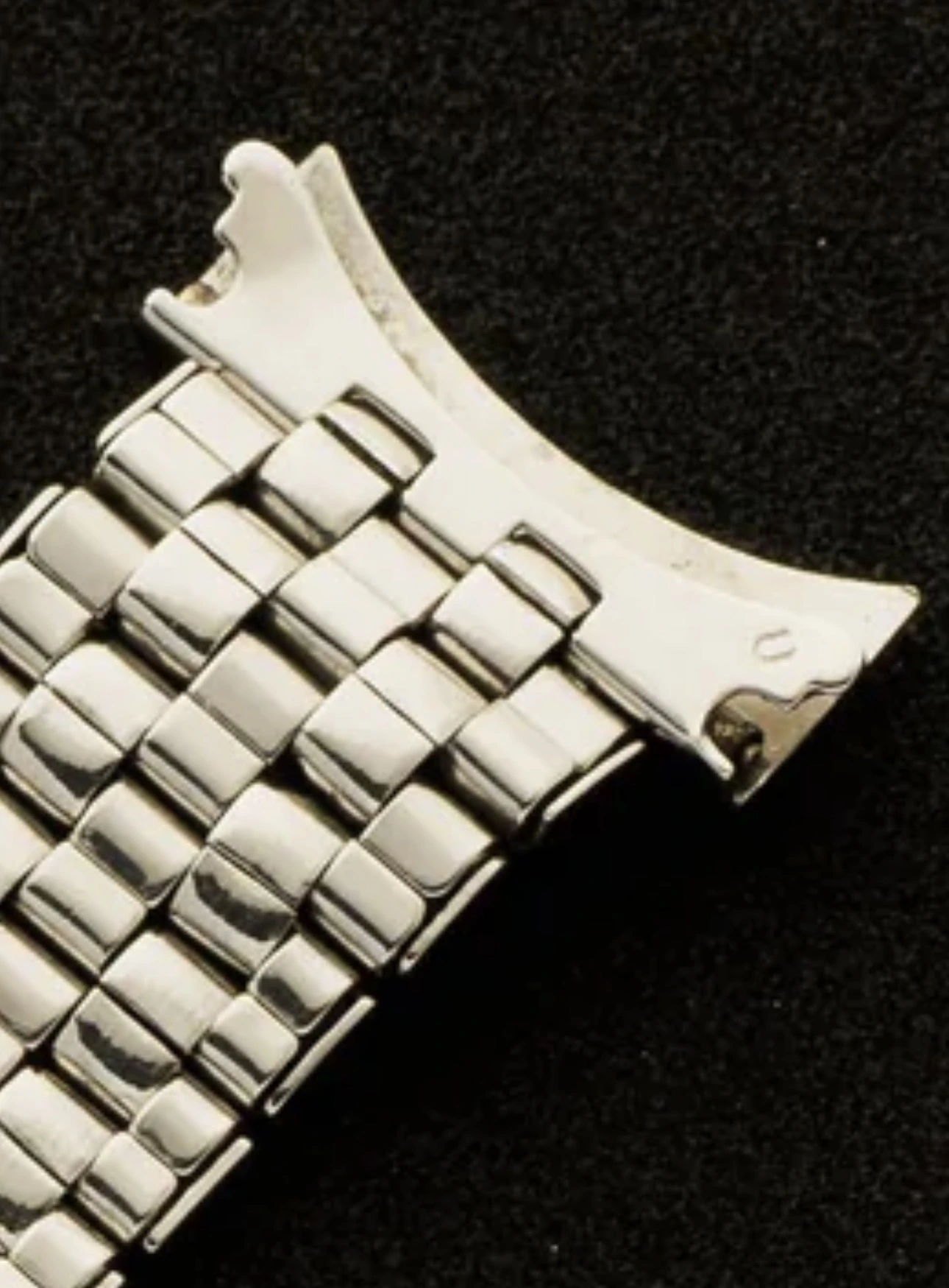

I have two sets of UL and two sets of UC as well as a set of 76 (20 mm) end links for champion bracelets. I have been looking for a UP end link (I already have one). They are just impossible to find ! I am surprised someone has not started making pattern end link for UG like they do for other brands.parts ...

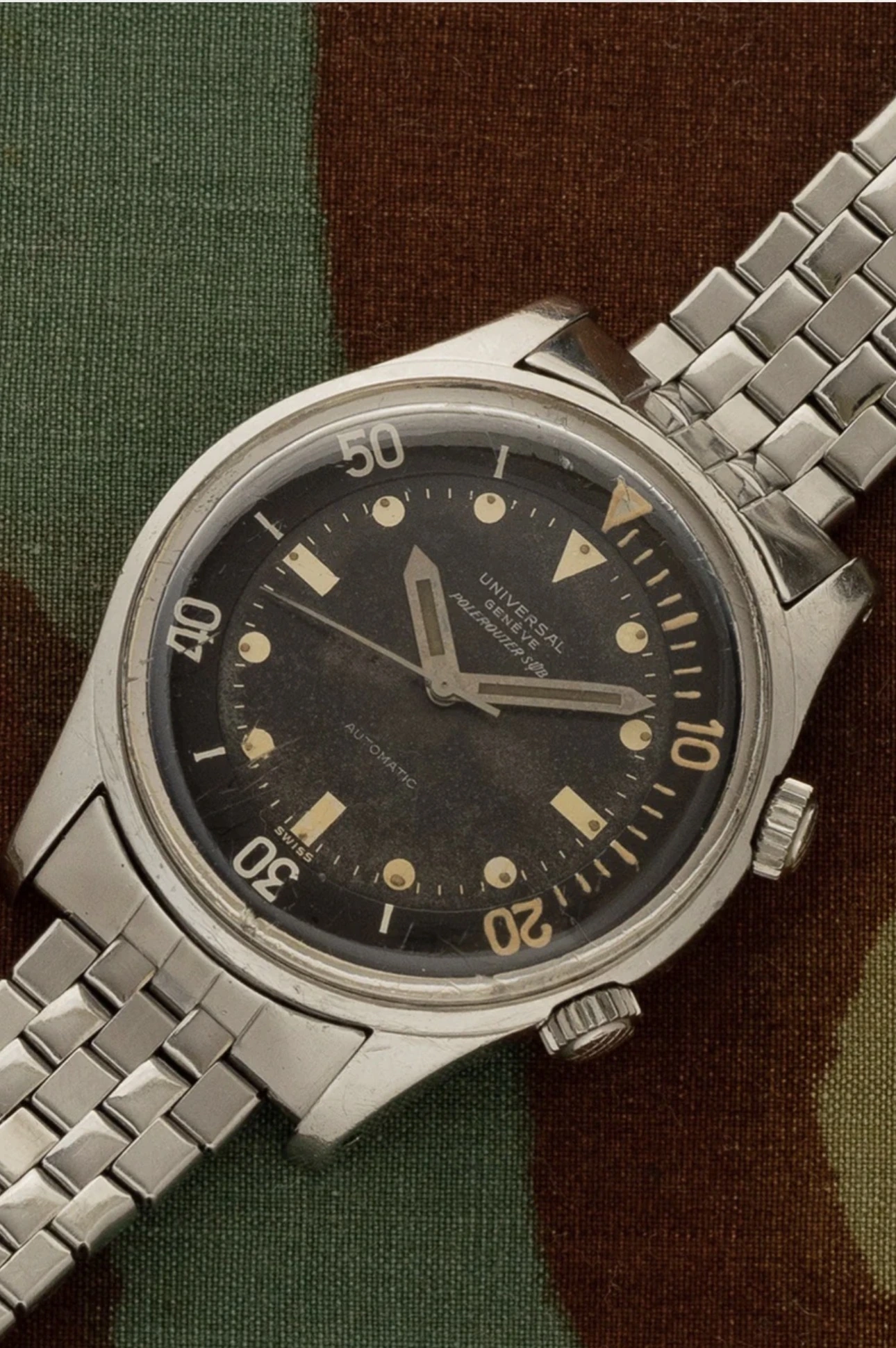

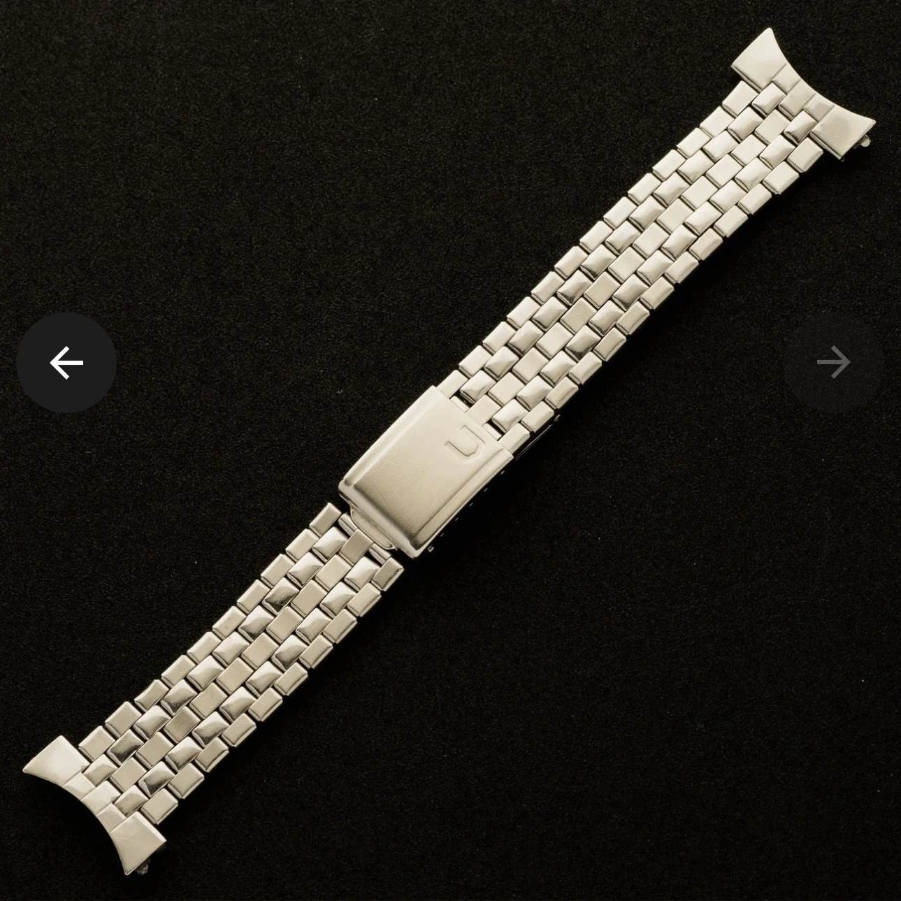

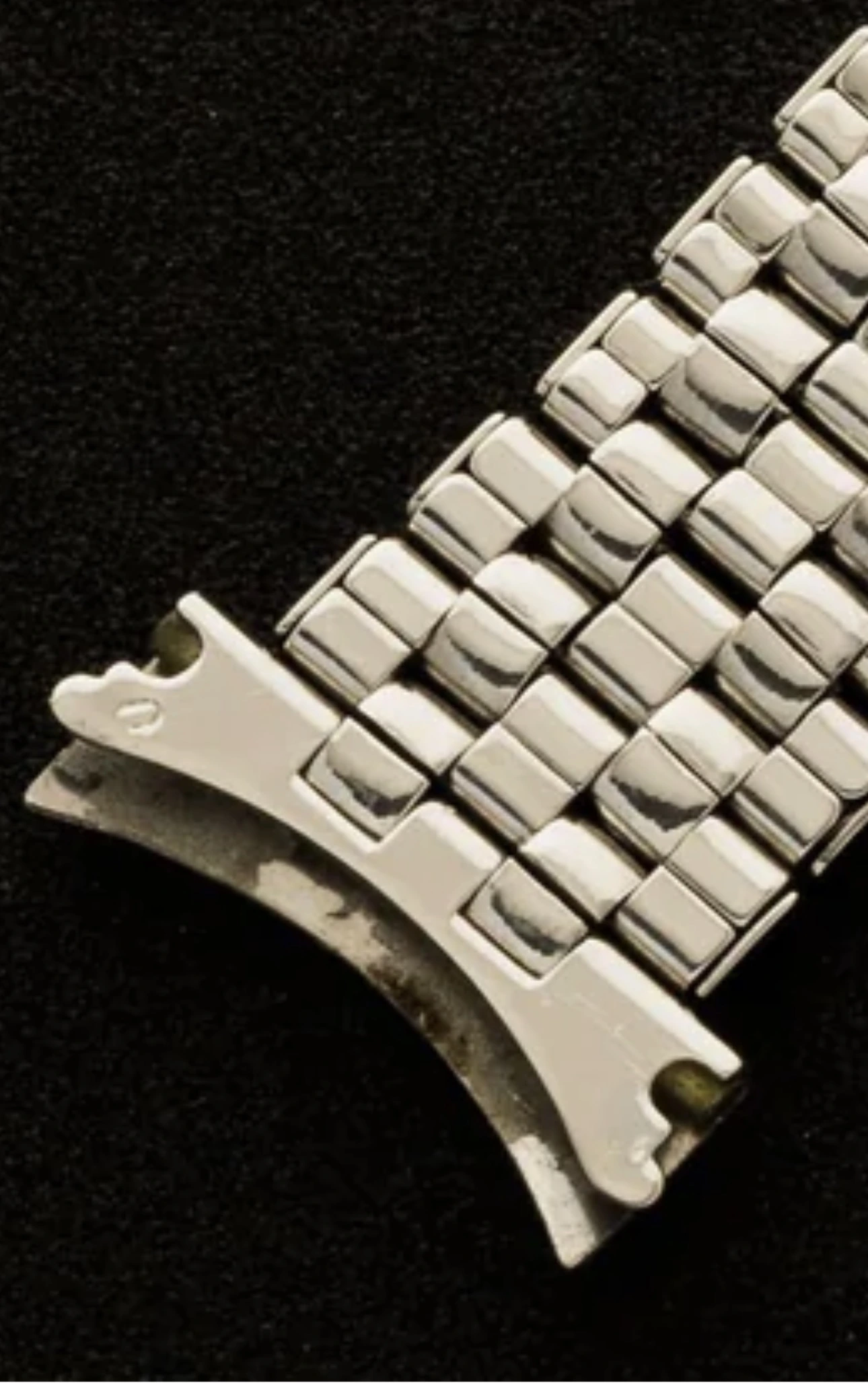

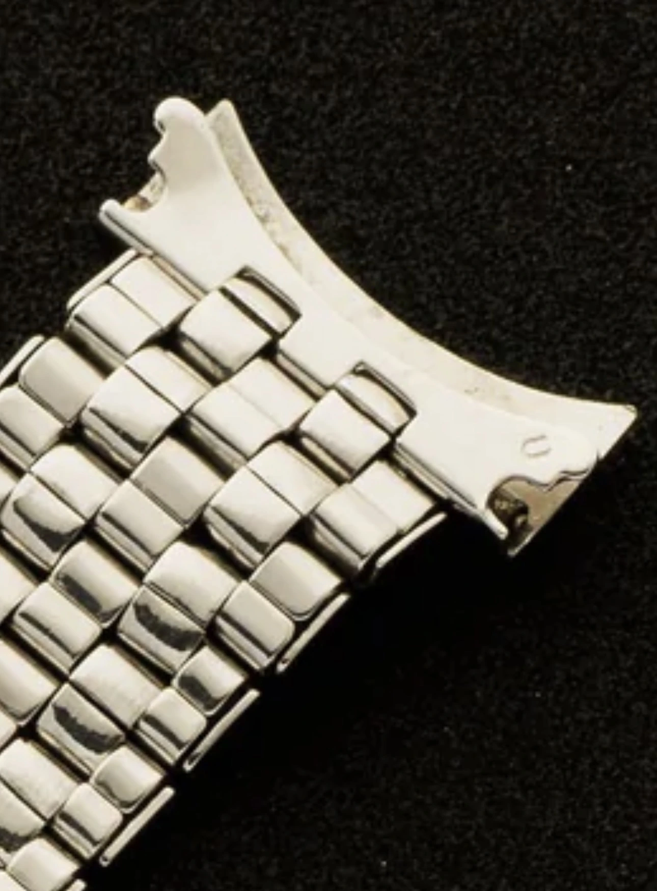

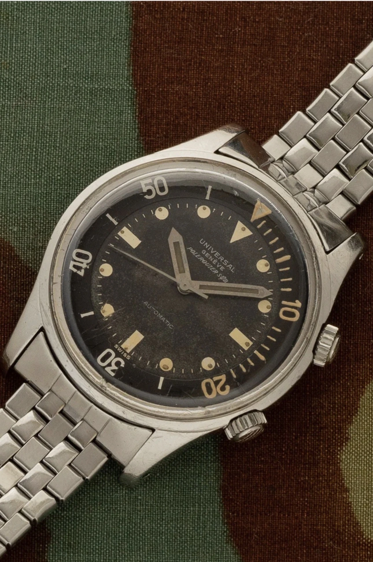

The earliest advertisement I can find featuring a UG watch on a bracelet is the Polerouter Sub, circa 1961:

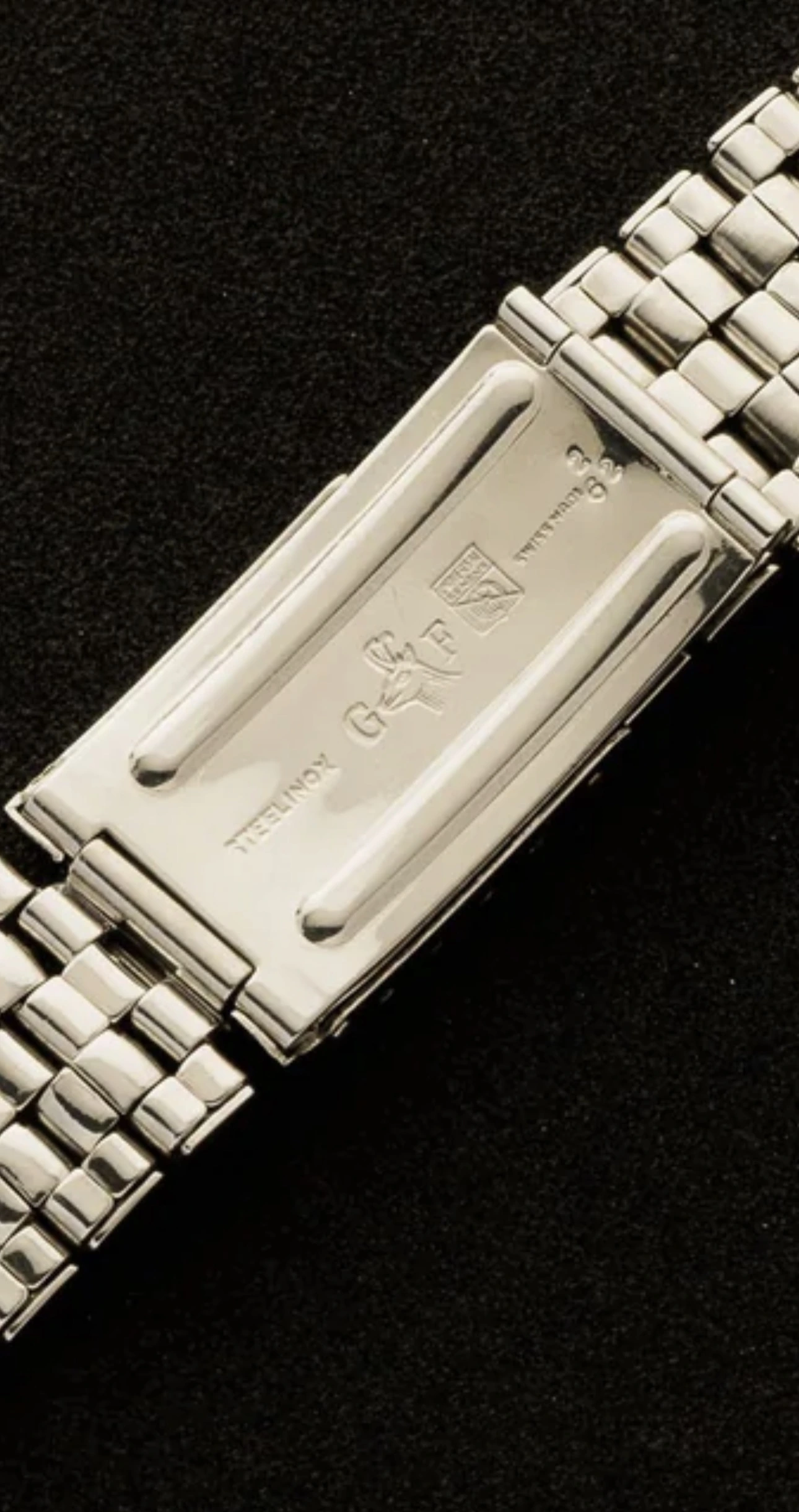

Here is a Polerouter Sub reference 20369/1 on a GF bracelet from the second quarter of 1962. As we might have guessed, these 22 mm end links, the earliest GF end links made for UG, were stamped with a simple “U.” (At the time, there were no other UG end links to distinguish them from.)
411
1,076
Thats not quite correct - e.g. the 20357 was available on the same bracelet with different stamped endlinks and was made before the 20369 reference. There are also U endlinks in 20mm for the 204615 Sub which was made after the 20369...

I only know of one other person that has a set of U end links ...
222
147
Assuming you don't want to wait forever or spend a fortune, you could find yourself some UP 20mm Polerouter Super end links and shave them to fit
Is the bracelet the same size ie, if you have a up end link 20mm and use that for years until you come across some UW will it be interchangeable on the bracelet
