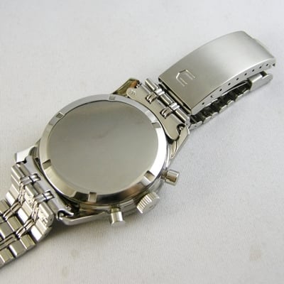

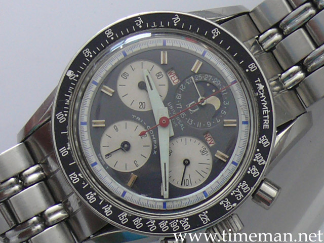

    I've got
    UM on my 20mm Space Compax
    UW on my late model (19mm) Tri-Compaxes
    Just an observation that "will fit" and "was made for" are not necessarily synonymous. "UP" will fit Tri-Compaxes, but not as well at "UW"

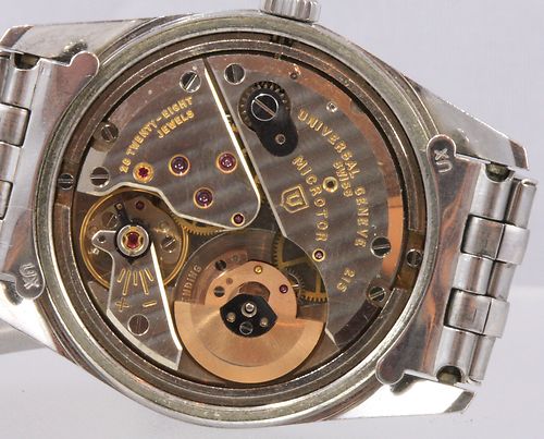

  9. LouS Mrs Nataf's Other Son Staff Member Nov 10, 2015
    6,971
    18,406
    Add "UX" for Polerouter
    $T2eC16N,!ysE9sy0hYiYBRbDl2SGYg~~60_12.JPG $T2eC16h,!yUE9s6NGYQ(BRbDmmfHig~~60_12.JPG
    Keep 'em coming guys. Pictures are even better. The Zenith version of this thread is a great reference. This one will be too.

    Thanks for clarifying that there's a difference between "UP" and "UW" Lou
    What is the width of "UX"?
    filmir likes this.
  11. LouS Mrs Nataf's Other Son Staff Member Nov 10, 2015
    6,971
    18,406
    19mm. Mind you, it's not the standard pattern UG bracelet, but a stretchy version - the connecting links may be different.

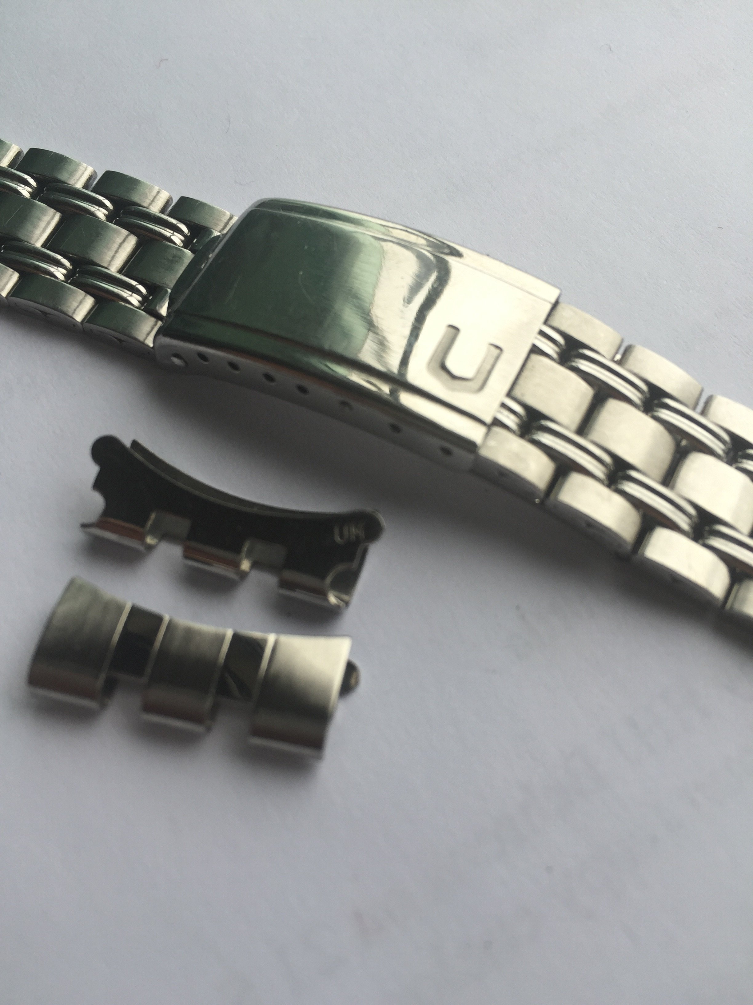

  13. HeuerLoon Nov 11, 2015
    194
    440
    22mm "UB" on an Aero Compax

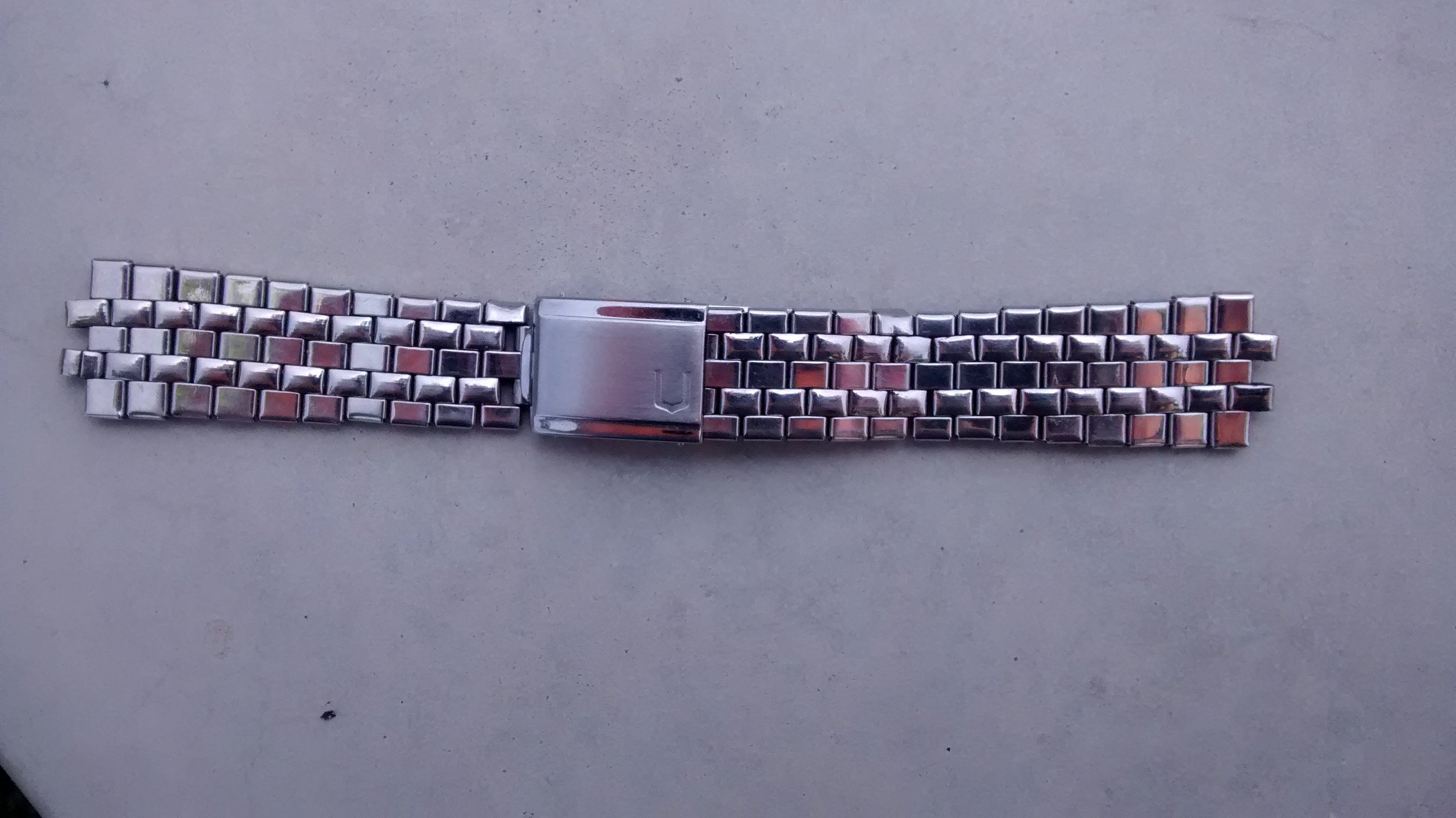

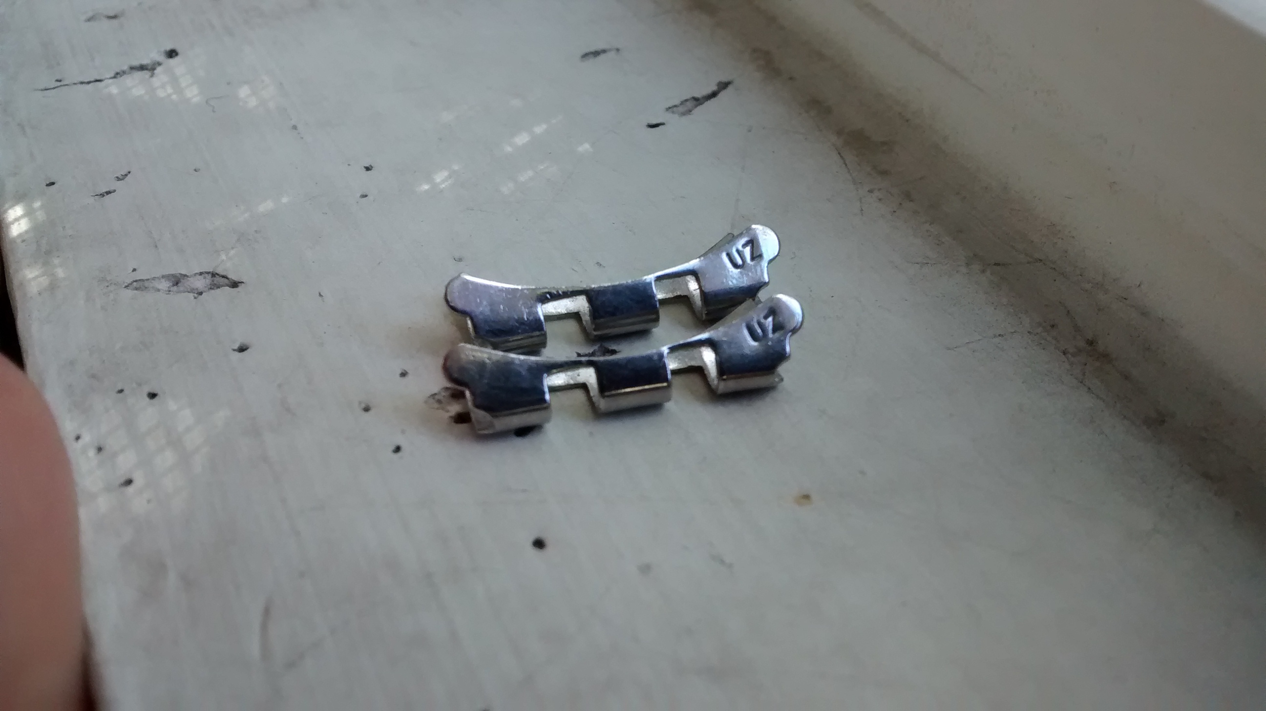

  17. Modest_Proposal Trying too hard to be one of the cool kids Nov 11, 2015
    2,630
    5,155

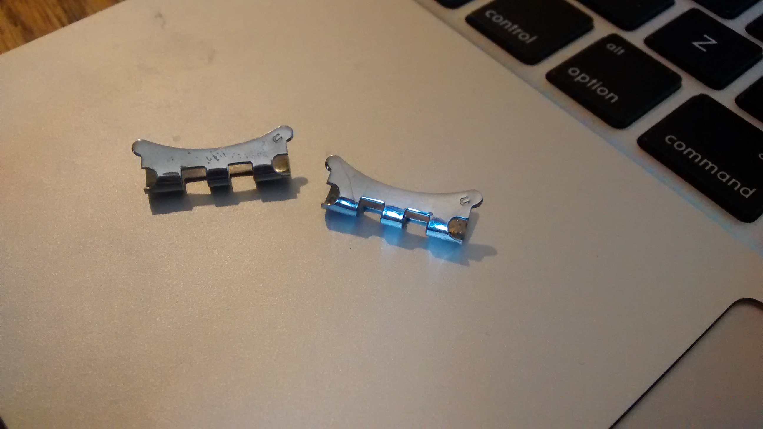

    I found a nearly one year old photo of a UG bracelet I once owned. It's only marked "U". I believe it was attached to another non-Genta Polerouter. I don't have the size specs.

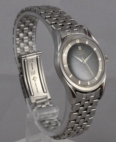

  18. papaebetu Nov 11, 2015
    427
    865
    ...elastic on Super Compressor
    GIGI
  19. HeuerLoon Nov 12, 2015
    194
    440
    Very nice Gigi. What size are the lugs on the case? Are they end pieces marked ?
