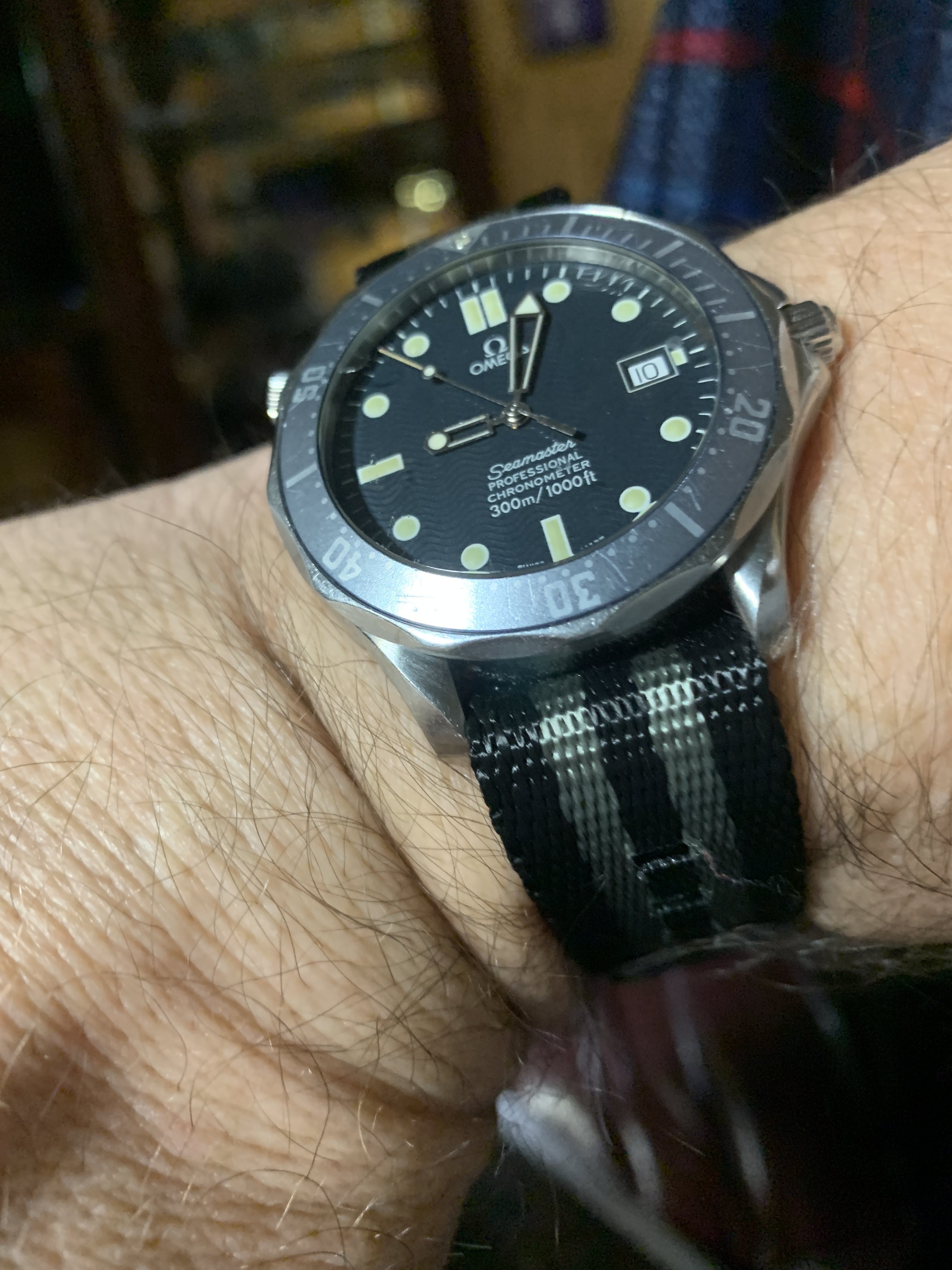

Trigger warning: ignored and abused Seamaster
129
163

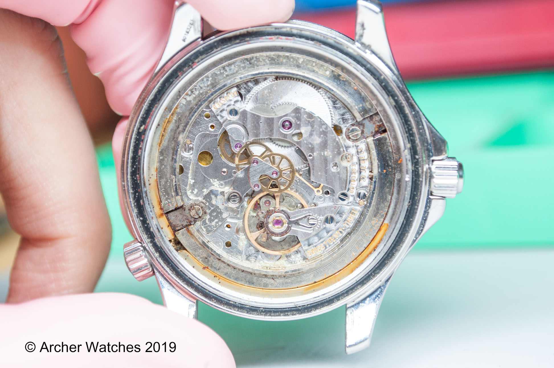

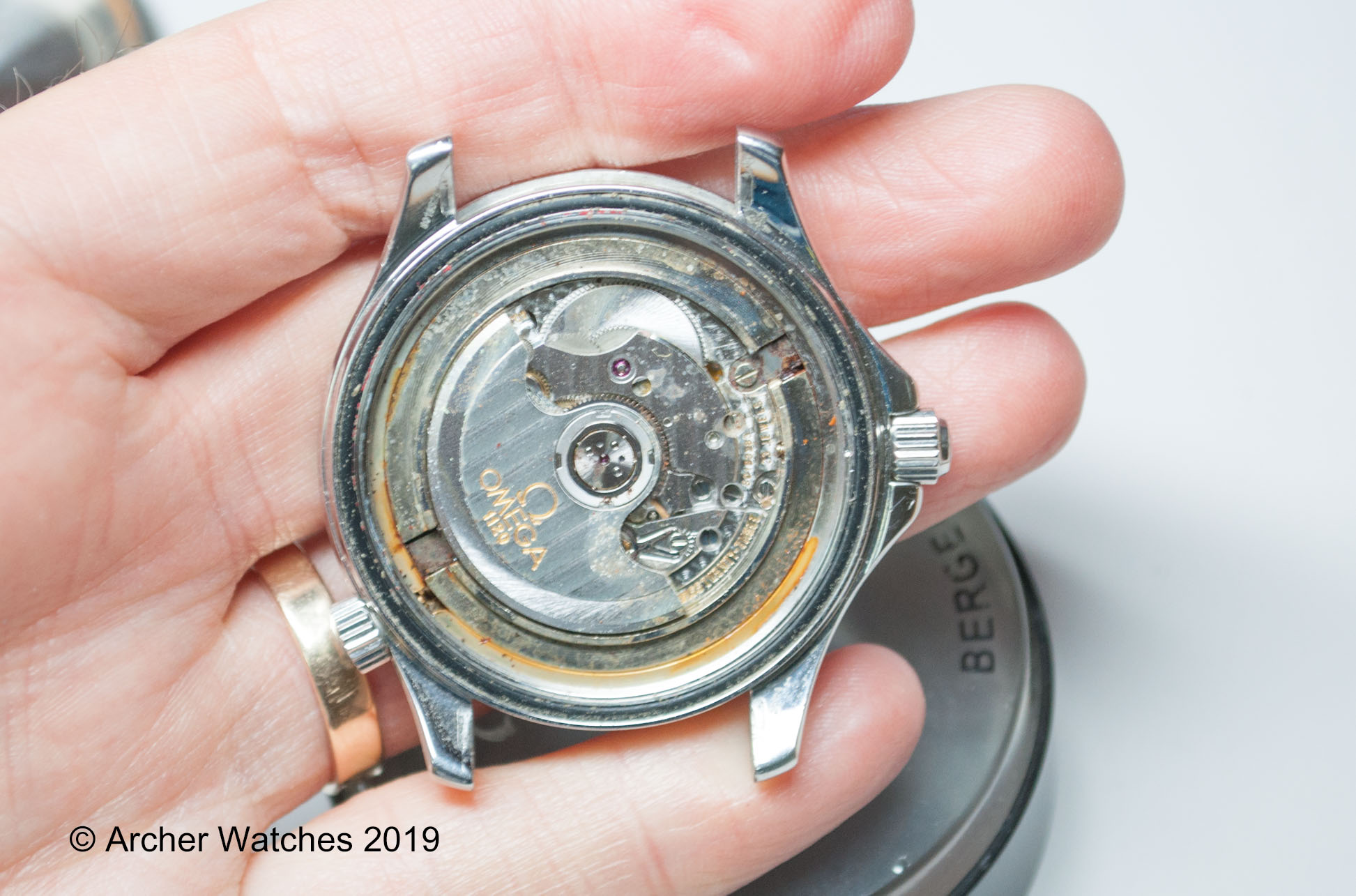

I guess there was a bit of rust in there. Archer hard at work.
He says appears that the stem seal failed. Neato.
Thanks for sharing these; was looking forward to seeing Archer's photos.

Watch is back with the owner now for a couple of weeks. Leak was through the crown:
Some parts required of course...some for obvious rust, like the pallet fork (no amount of cleaning is going to fix this):
And some were just pain worn out, in addition to being rusted:

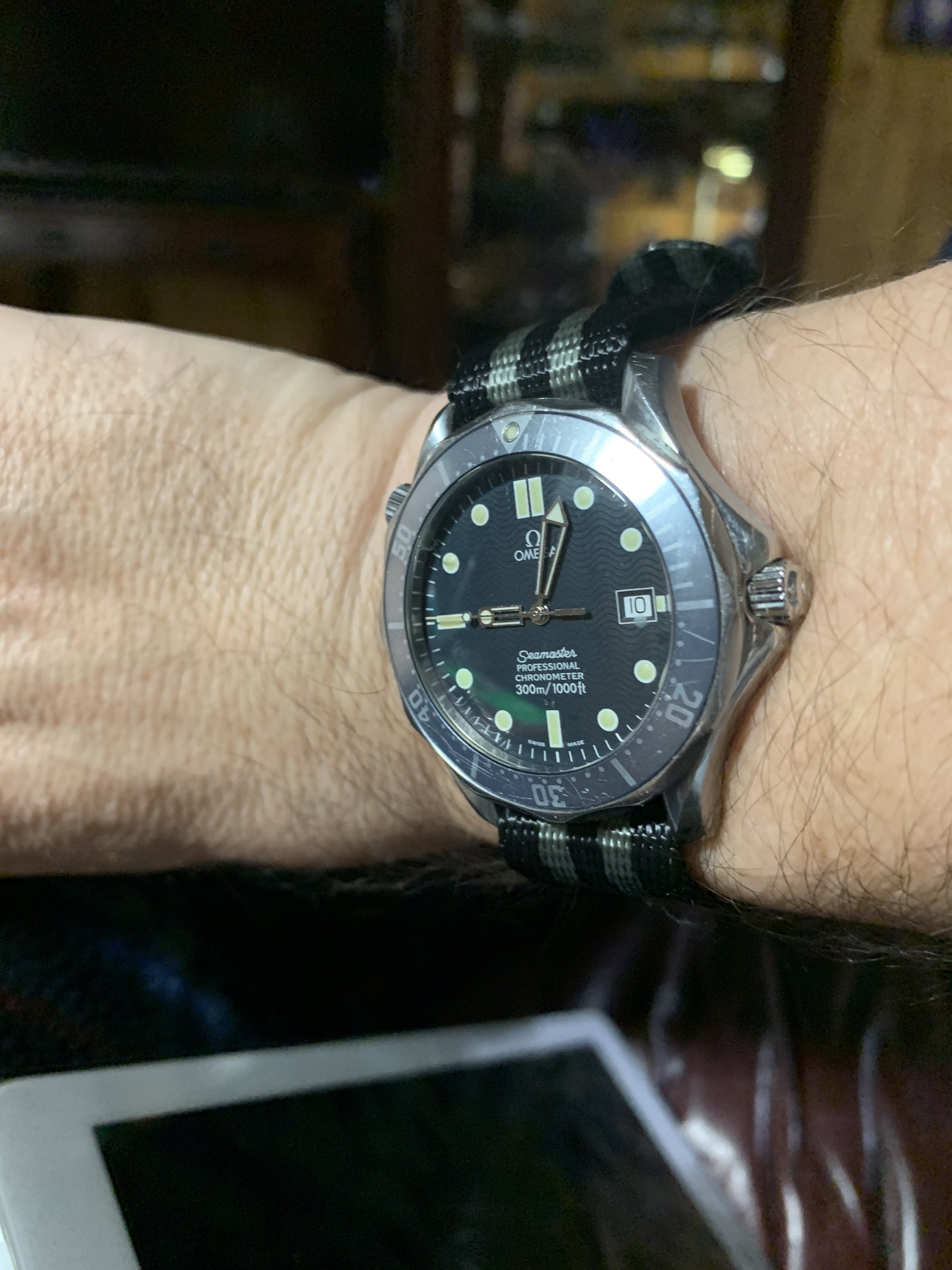

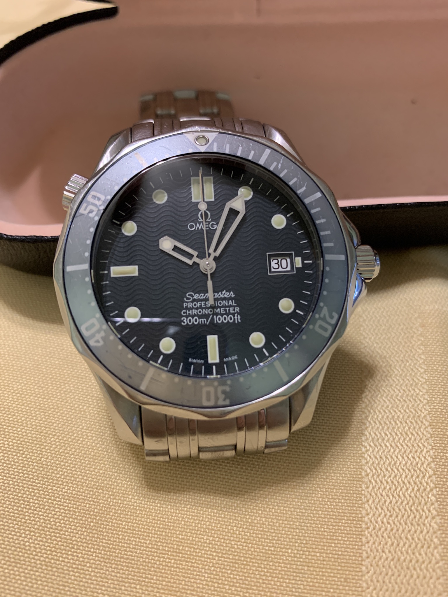

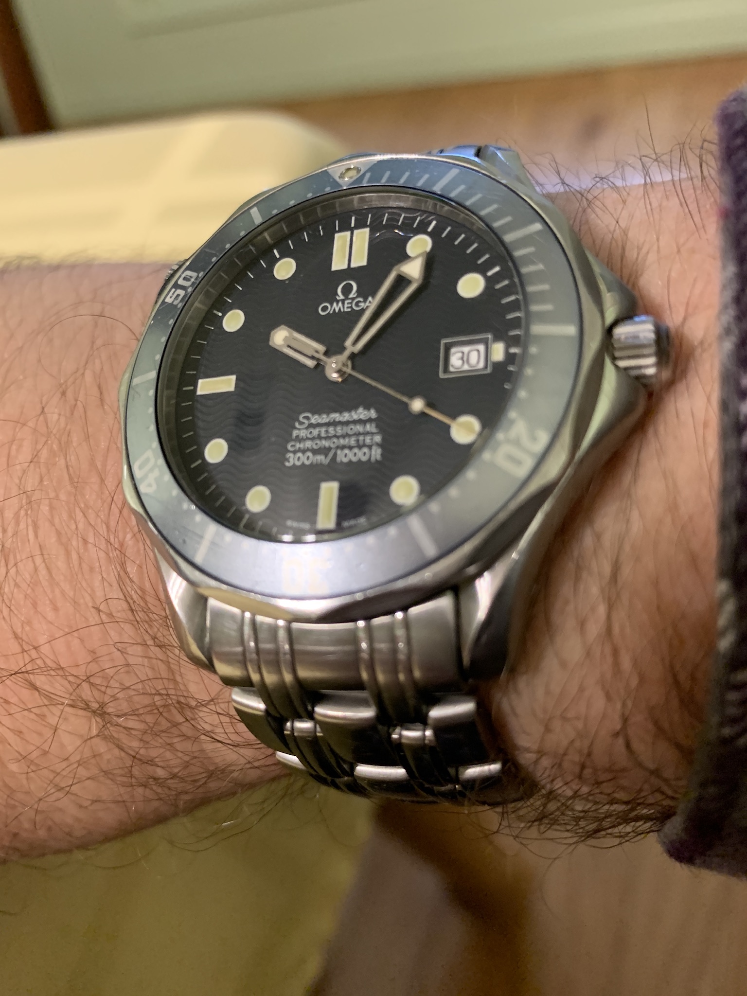

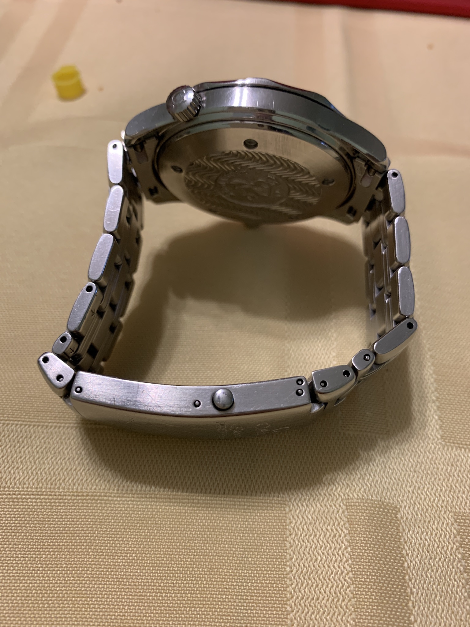

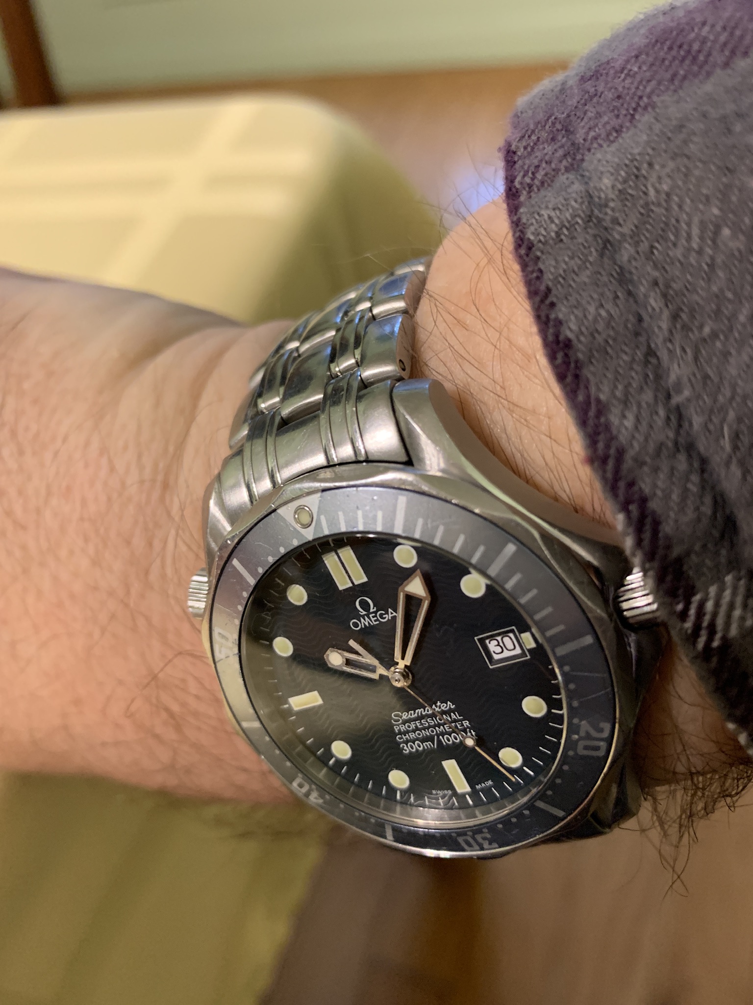

Good question, and, yes!

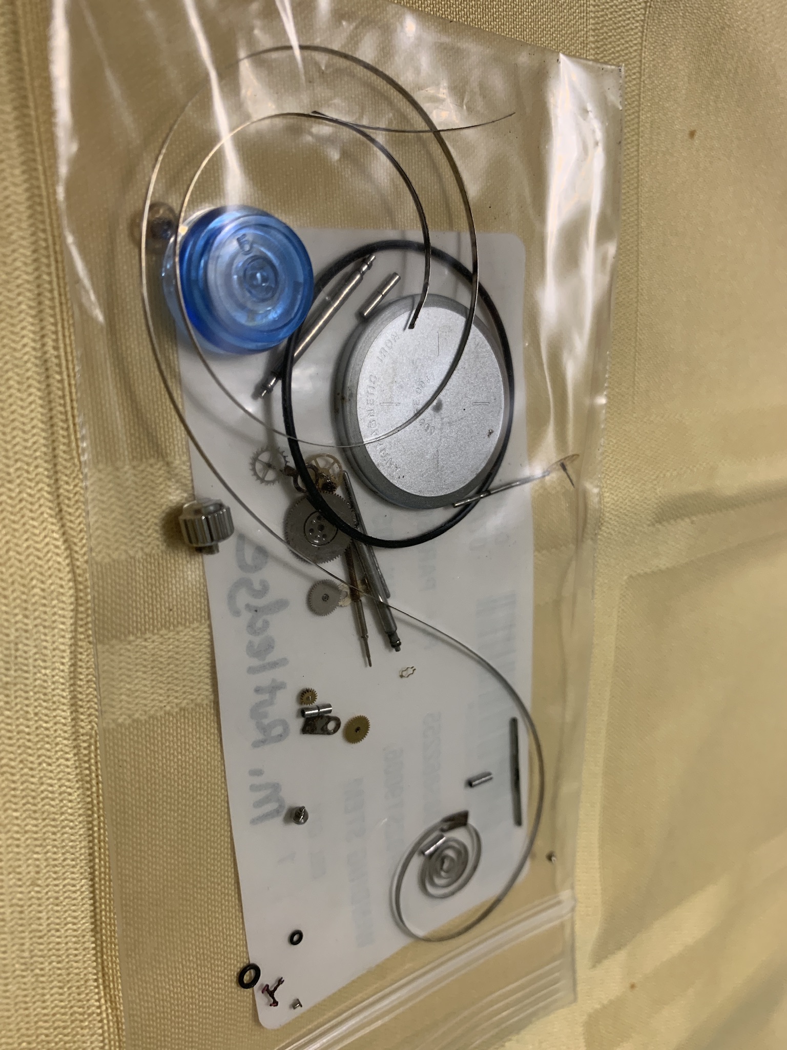

@Archer initially told me that he was busy until the end of August. I sent it to him in early August, hoping perhaps he would get to it sooner.
The watch was returned to me a couple weeks ago, so he had it just a bit over 2 months. He did a complete service, but I asked that he not polish or renew to case or band.
The watch looks exactly as it did when I went it in, except cleaner. Not polished, just cleaned. The watch was running and the date was correct when I unwrapped it. I have been wearing it daily, and I have not had a need to wind it manually.
Many, many, MANY parts were replaced due to wear/rust, as expected. The watch seems to be keeping accurate time, but I am not obsessive about this and have not tested it. It's good enough. I was worried that the dial and hands would require replacement, but that was not that case, the original ones were retained.
The price he quoted for the service was what he charged me, but the cost of the parts replaced totaled quite a bit more than the labor. He sent me all parts that he replaced. He also sent me a CD with what I assume are pics taken during the service, but I have not had time to review that, he also sent a printout detailing the pressure testing. I requested that he do a full pressure test, as I actually dive with this watch.
No doubt, I could have saved many hundreds of dollars if I had had the watch serviced as soon as I saw fog in the crystal, but that's on me. I'm just happy that he brought it back to its original self.
Overall, I am satisfied with what I got, there were no unhappy surprises and I would recommend him if you find yourself in need of a watch service.
And now some pics...
If I've missed something, I'm happy too answer any questions.
Michael
Michael
Great job and you did the right thing not replacing parts for cosmetic reasons. It would have felt like a different watch. Now it keep's it's character.
