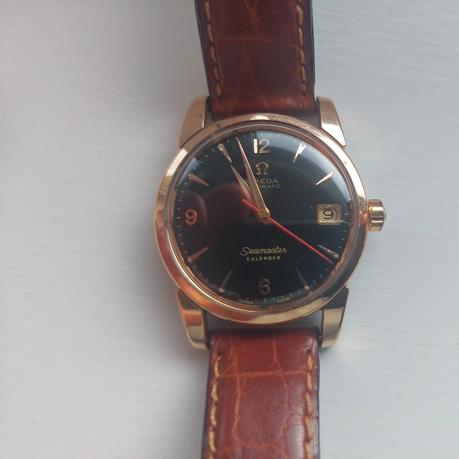

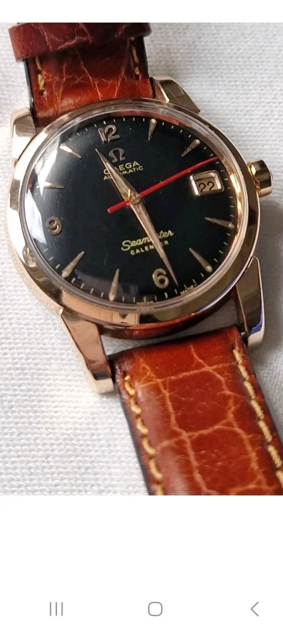

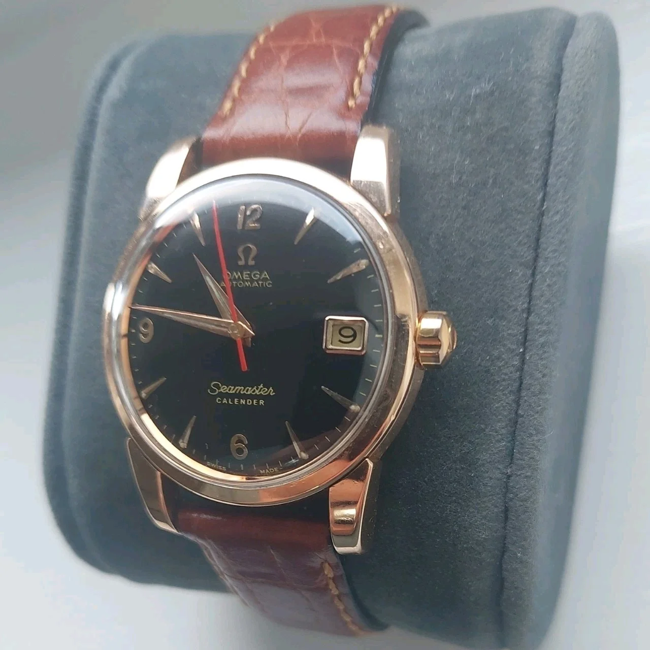

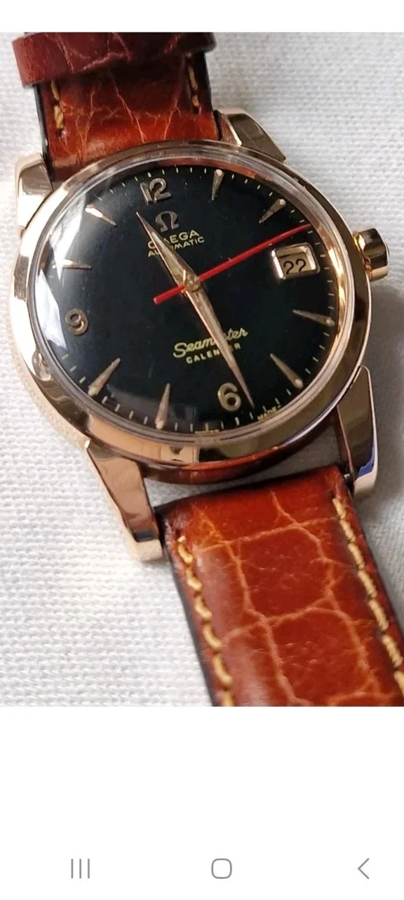

Hello thinking of this one,case and movement in great condition
But whats holding me back is,dial looks too good,calender spelt wrong and is the "swiss made" too far apart
apart from the red second had of course
Is there any way this can be a genuine misspelling from factory and not a redial,I want to believe
Thoughts please and reasons why
Much obliged
720
2,109
Well, "Calender" should be the one giveaway to stay away. No point in overanalyzing.
No idea how a redial job will go to so much trouble but misspell. It's as if stamping "Omaga" and calling it passable.
325
511
It’s a redial as pointed out by other posters. Case seems to be ok. Is it rose gold or rose gold plated?
3,681
8,015
No.

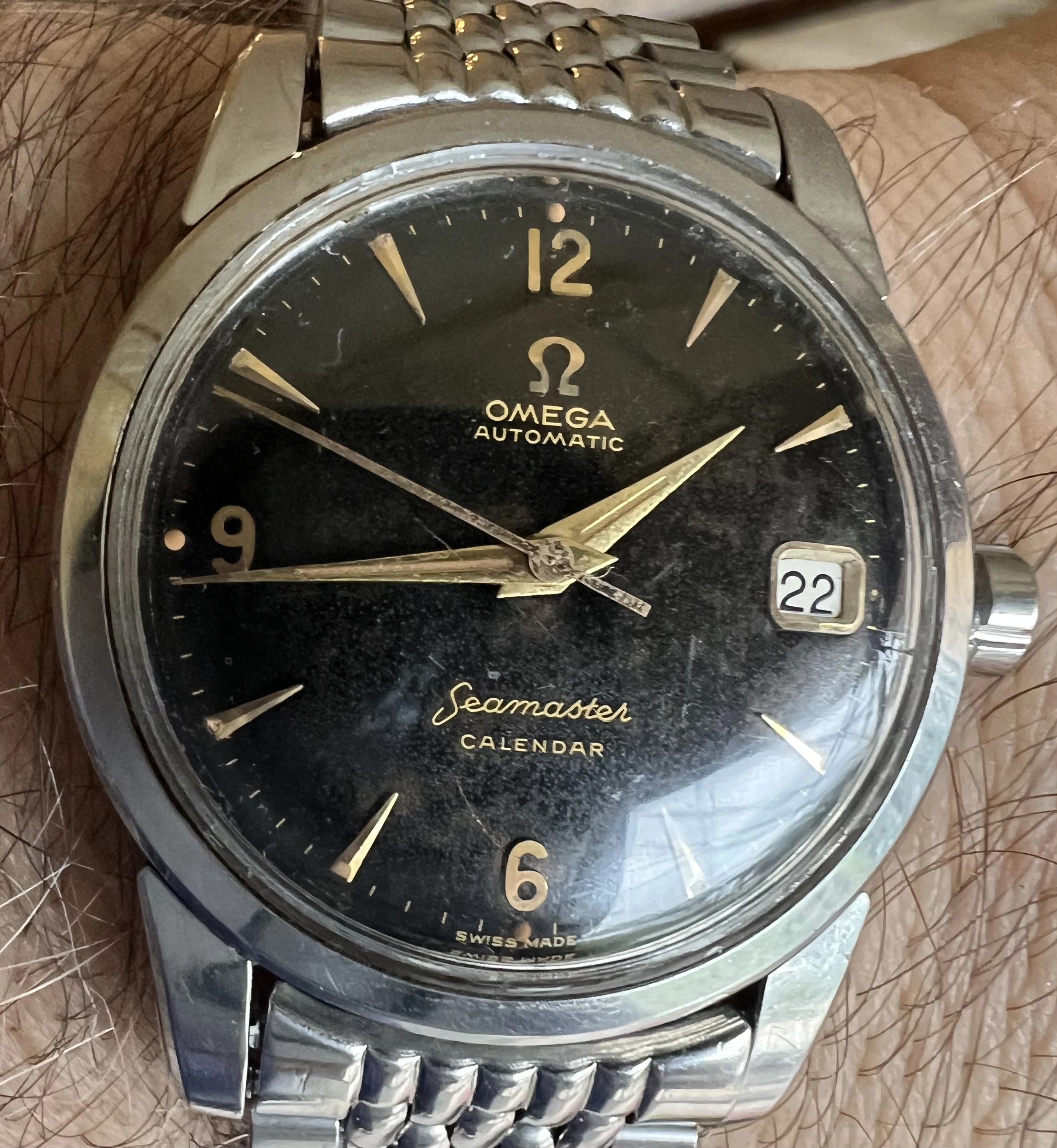

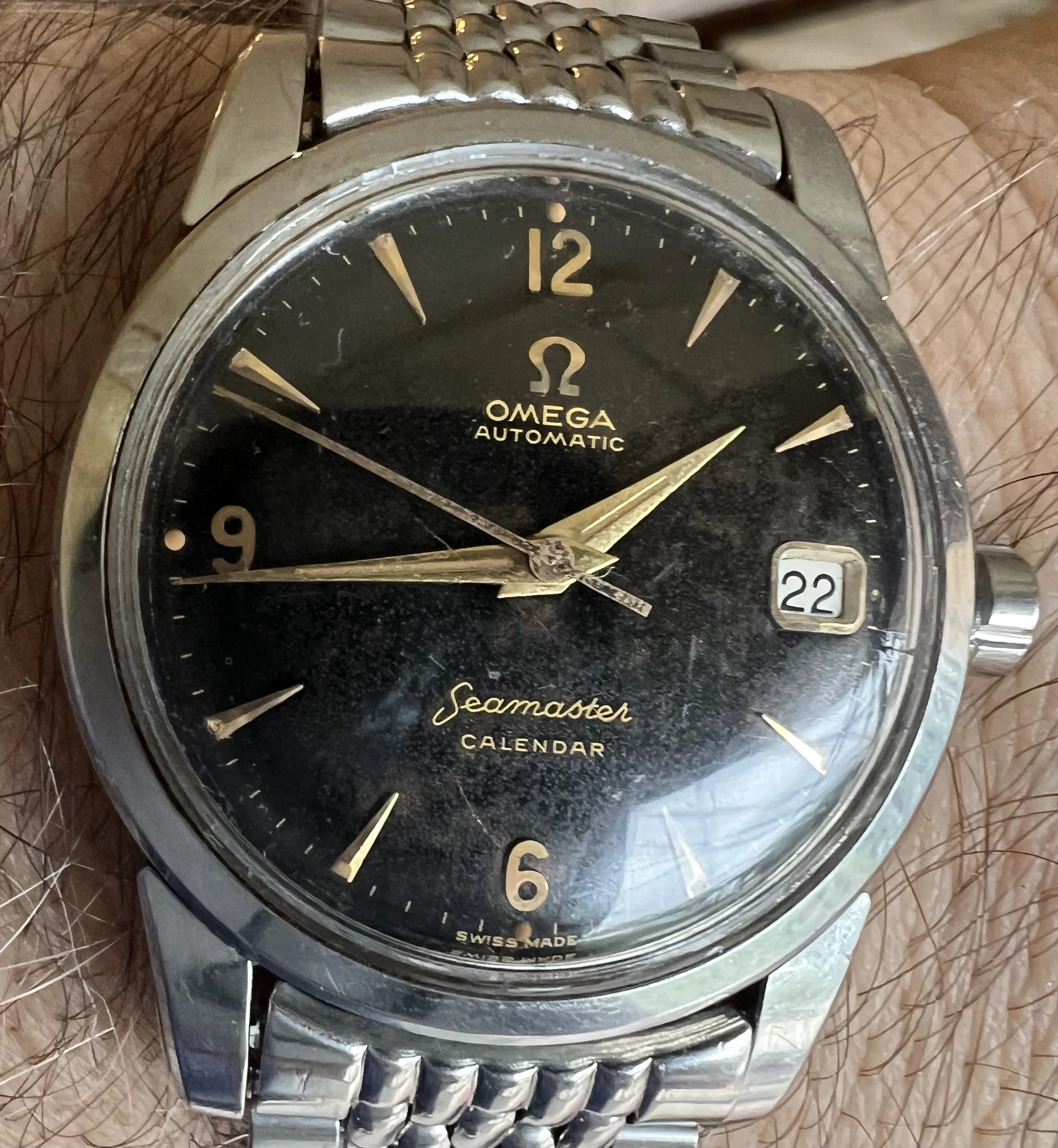

Here’s what they look like for future reference
