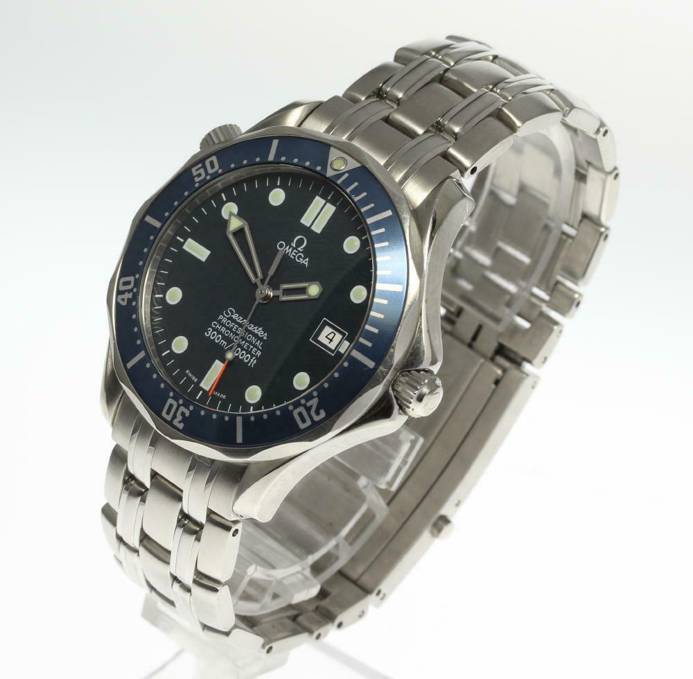

I would just send it to Omega. They aren't going to force you to replace parts for cosmetic reasons. At the very least, you'll have an idea as to the repair cost. Omega tends to replace a lot of watch parts within their full service whether those parts require replacement or not, simply because it's more expedient for them to do so (i.e. the parts are cheaper for them than the labor). They also replace the crown and HE valve at no charge. This policy might actually serve you better in a situation where the movement has water damage.
7,724
14,298
Send it to Omega, if you like their quote and what they propose to do then you can procede. If not then you can regroup and decide in what other direction you want to go. This is the definition of a tool watch, I wouldn't be concerned about a replaced dial or hands if Omega insists it has to be done. Goal is to get a well running watch with the proper WR at a reasonable price.
81
41
This watch has such a nice patina that matches up with all the years of service it’s given you. Restoring this to new shiny hands, bezel and dial would be a mistake IMO. That movement isn’t in-house or rare nor are its parts, I’d imagine. I’d stick to a local or semi-local Omega Certified watchmaker if it were me. That bezel fade is aces.
1,171
6,083
Keep in mind that the $500 service quoted by Omega does not include replacement parts, and there is a good chance you may need parts. Also The has an Omega Cal. 1120, or less likely an ETA 1109. The Omega movement is based on the ETA 2892 and this is an even more common movement. Any good watchmaker should have not issues working on this. I did a search on the forum and found this quote for a watchmaker in Nashville, "You might check out Ratt and Son. This is not a recommendation just a result of a google search." It kind of looks like you have tritium lume from the photo, a replacement dial should have superluminova and this may benefit you during diving. Another option, although not the best, is to search eBay for 'Omega 2531.80.' A good used example of that watch runs $1,500 to $2,000. I am posting a photo of mine which I paid $1,530 for. Whatever you decide, be sure to post pictures of the watch when you are done with the repair. Every story needs a happy ending.
