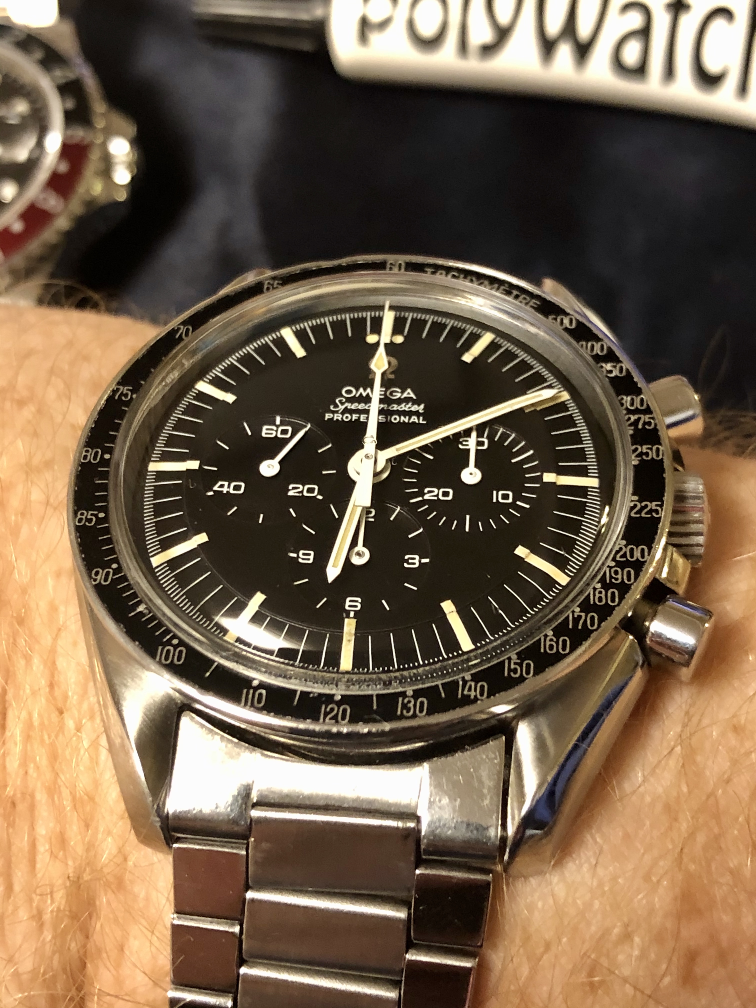

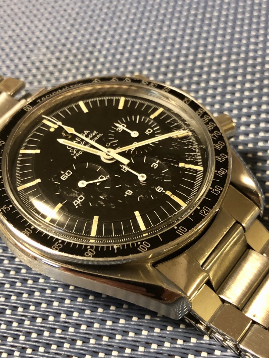

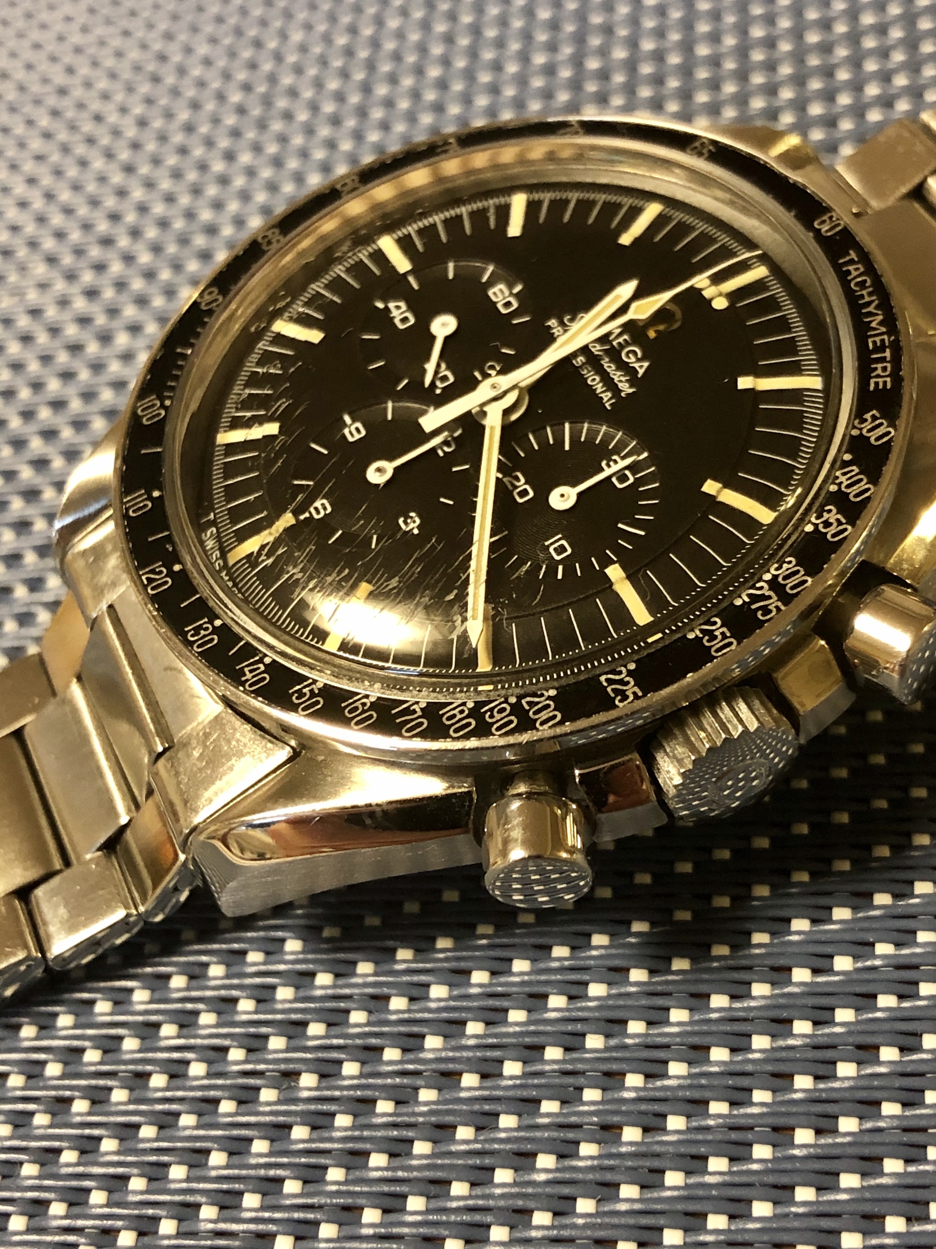

I took a slight tumble the other day wearing my Speedy and found that I had scratches to my Hesalite crystal and a slight dent to my bezel (at around 58).
My question is, can I polish out the scratches in the crystal and is that dent repairable? I have tried polishing with polywatch for a bit but still some fairly deep scratches remain. Is this salvageable and if so, what would you recommend to proceed with? Also, for the bezel, is it possible to replace the bezel and keep the insert or are these things necessarily paired?

Easy crystal replacement or more elbow grease on the poly-watch.

A couple min with Polywatch should get most of those scratches out.

Don鈥檛 mess with the DON bezel. That鈥檚 a significant component of the total value of the watch. Any competent jeweler should be able to restore the crystal to pristine condition as long as it鈥檚 not cracked.

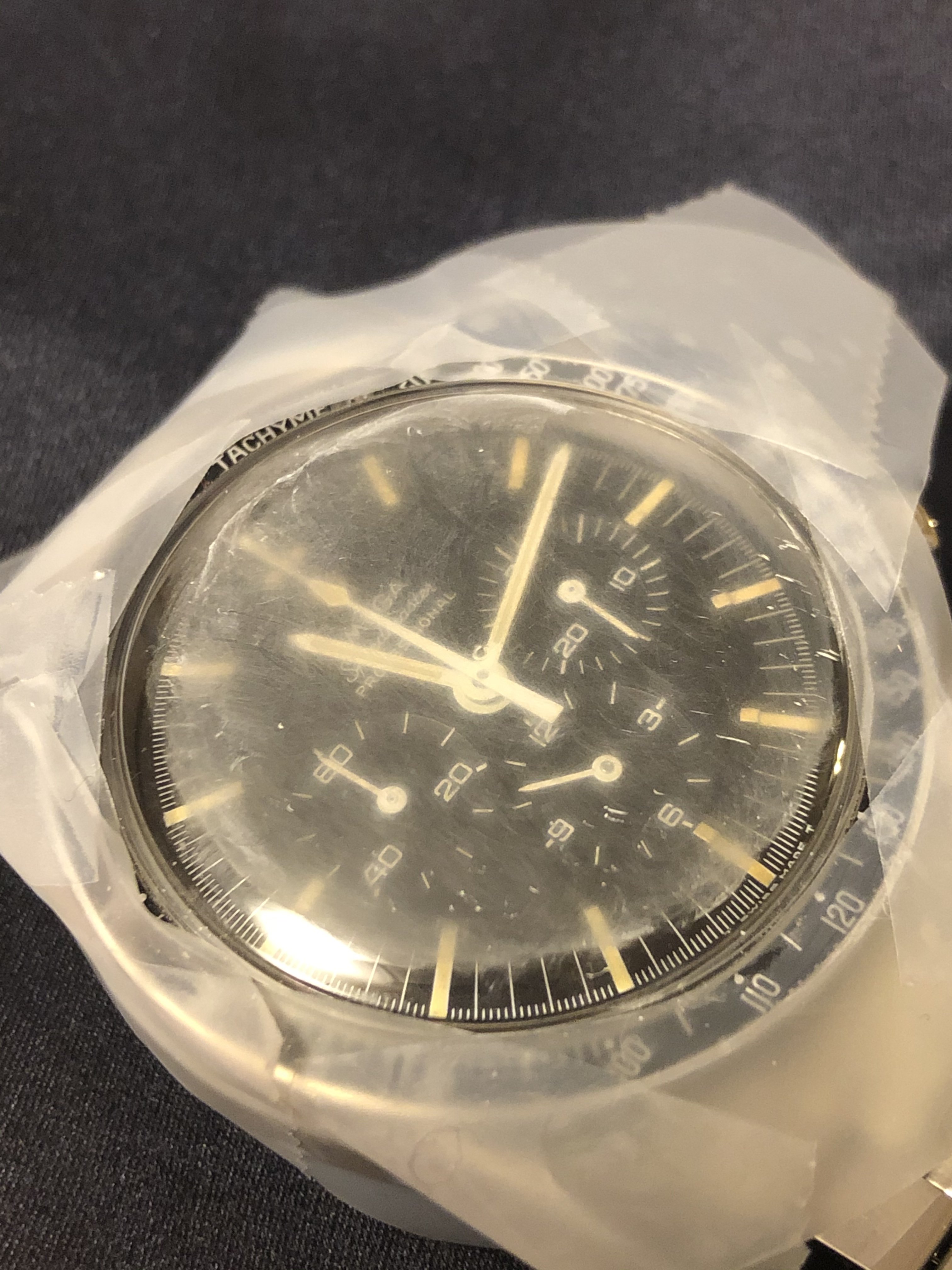

It is easier to sandpaper the crystal first to remove deep scratches. Mask off the bezel carefully with tape, then 2000 grit cloth going up to maybe 6000 to finish in a circular action over the whole crystal to keep it even. Lastly use the polywatch and you will get a great result.

Thanks all for the replies. I have spent a little time with the polywatch already so may give the sandpaper a shot and see how that goes. Good idea to tape the bezel and watch first. Hopefully I'll be able to post some great before and after pics. Will definitely leave the DON as-is. That was the first thing I checked when I noticed the scratched crystal.

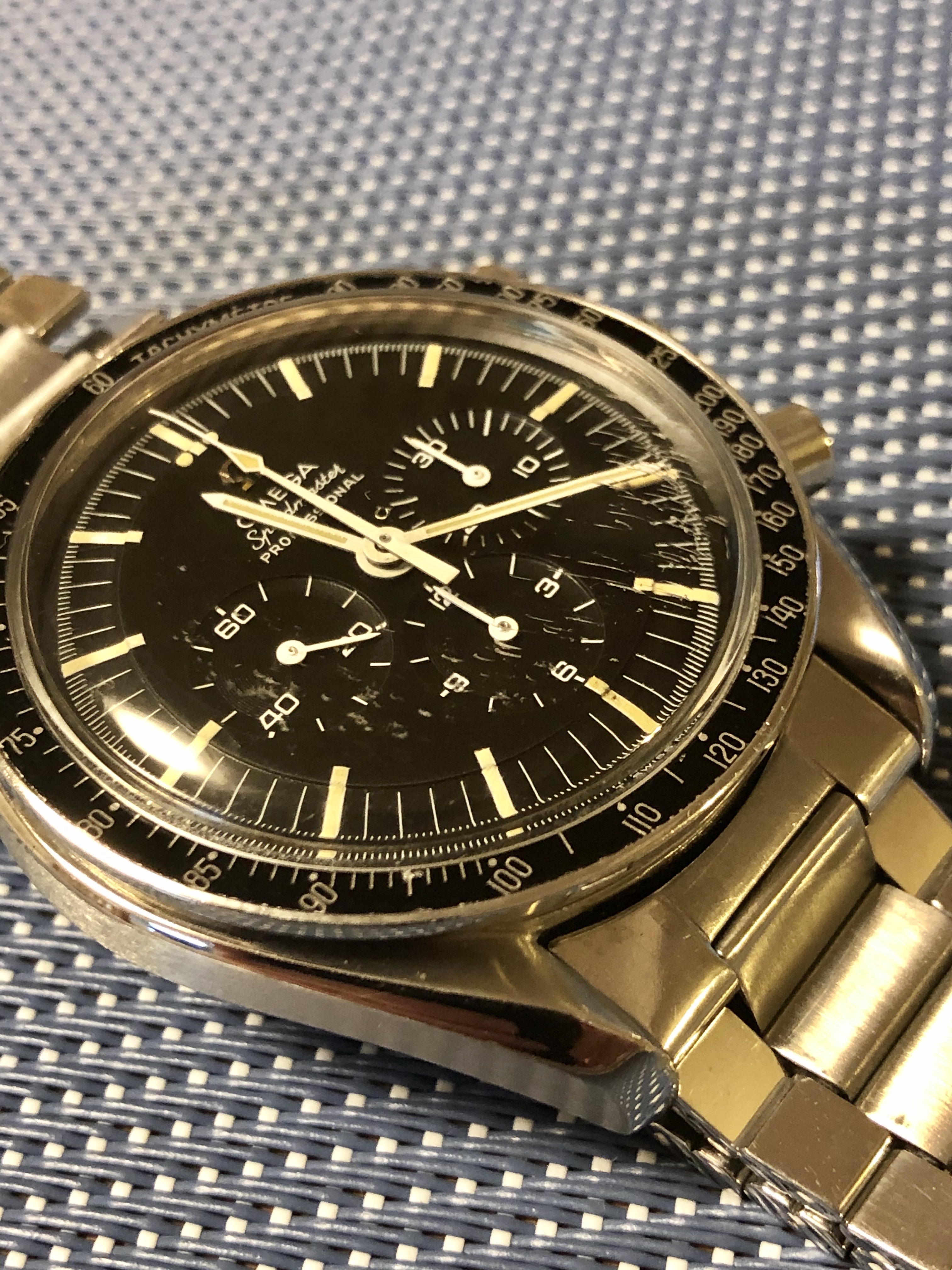

Thanks to everyone鈥檚 advice, I gave a shot at polishing out the scratches. Started with 1000 grit sandpaper then went to 1500 then to 2000, on to 4000 and then finished off with polywatch. I am quite satisfied with the results. Here is the before and after.
