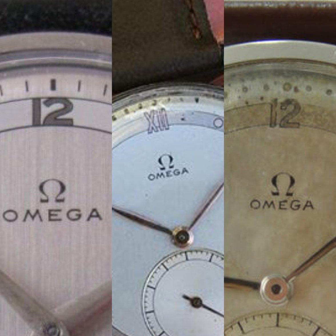

Too cheap I thought...opinions on dial and price?

I've seen NOS dials for this reference for sale.
This could be one. But I don't think this is dial the watch was born with.

Redial, IMO. Looks too perfect. No spotting, discoloration, etc. Also, the spacing of the letters in "OMEGA" looks off to me. Too much space between each letter.

I would be very suspicious - to me the dial looks a bit too new with the vertical grain. Omega text looks kind of wide, but they used a lot of fonts on the jumbos. For this dial style track, usually the hour markers are a bit out of the concentric circles from what I have seen. Also, I usually see this dial design with little dots for the minute track and leaf hands.
Kyle, don't you think the center and right pictures are more obvious redials?
