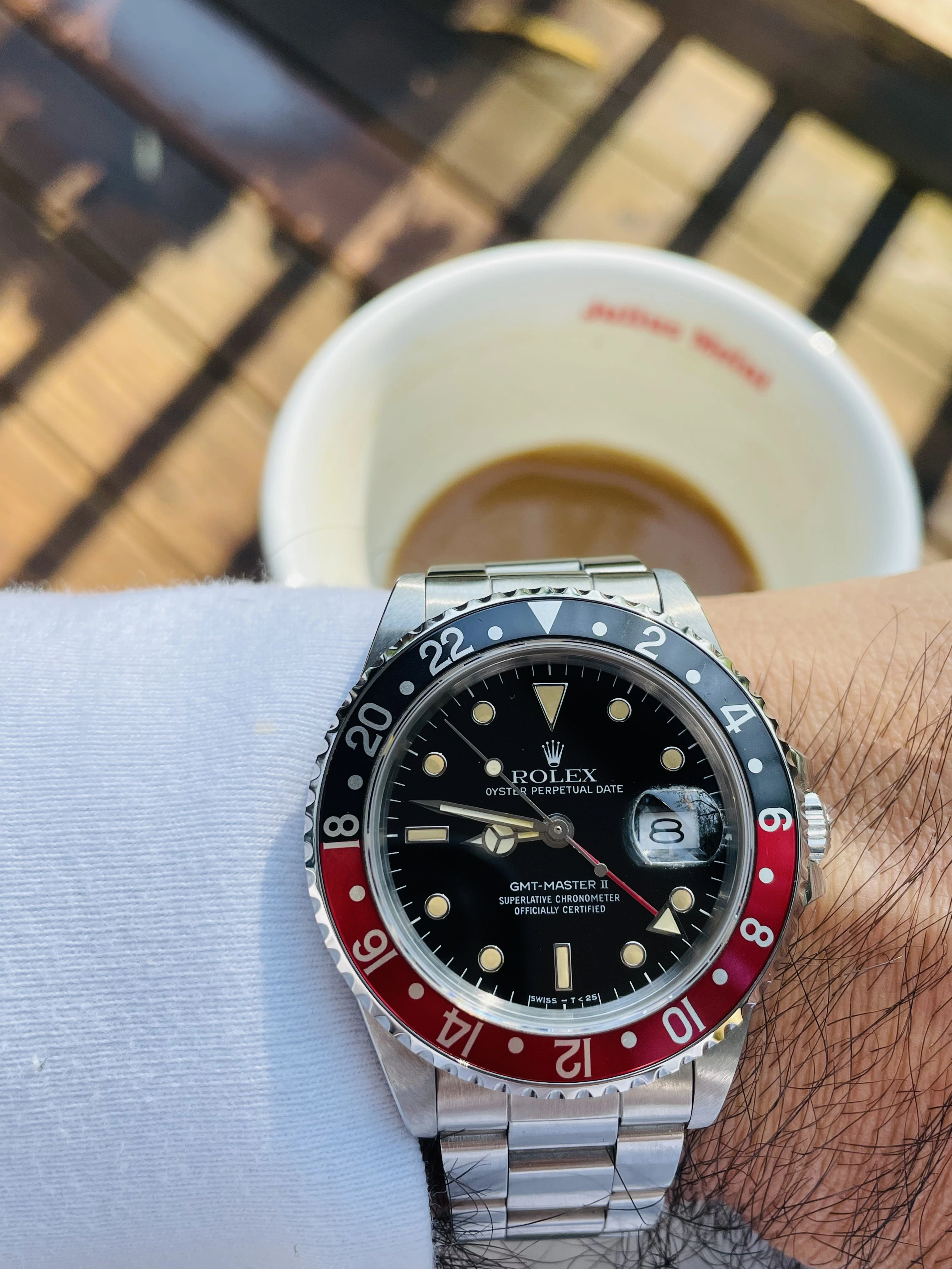

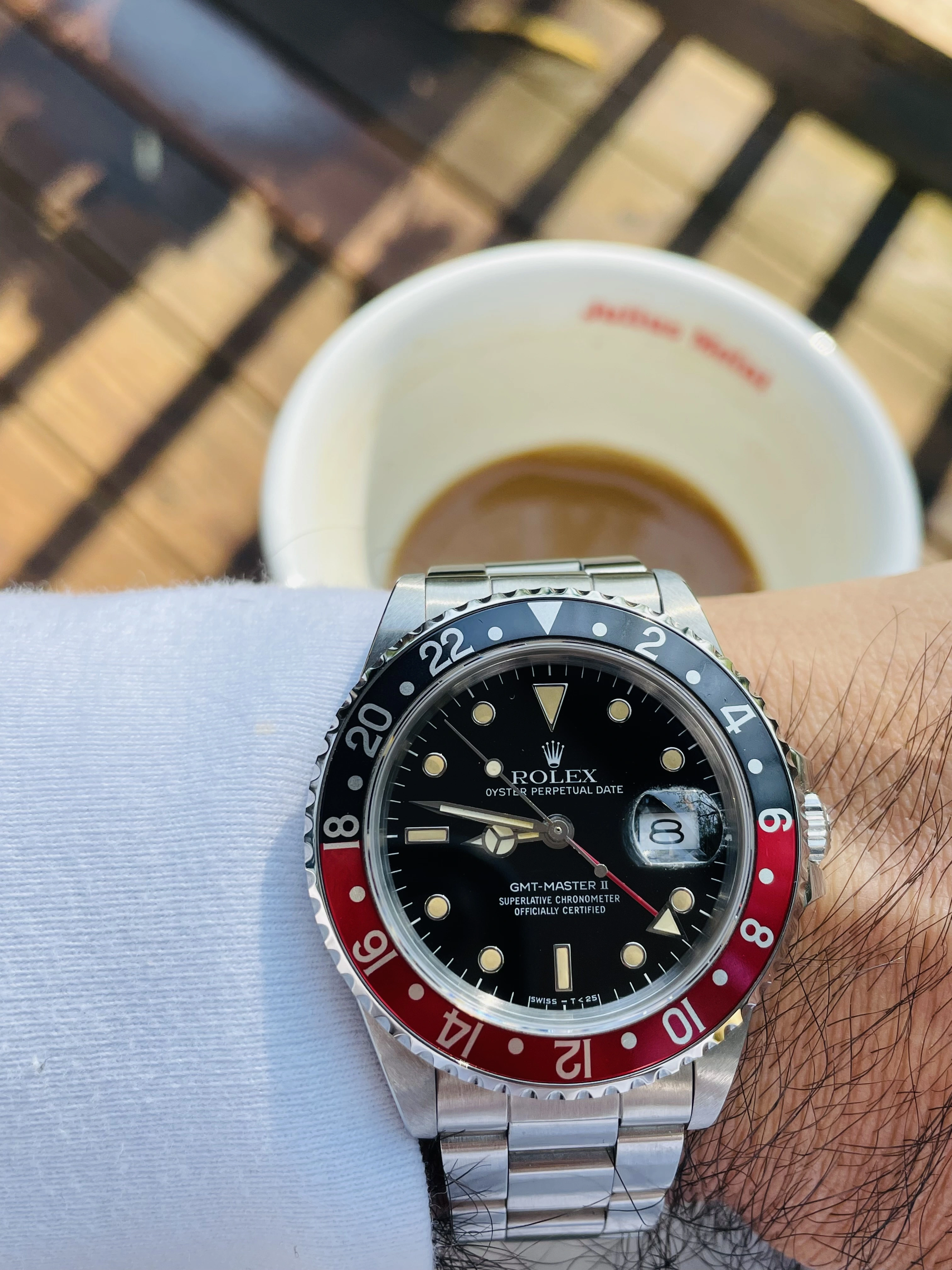

Here is an example of my 16760, hands are a shade lighter.

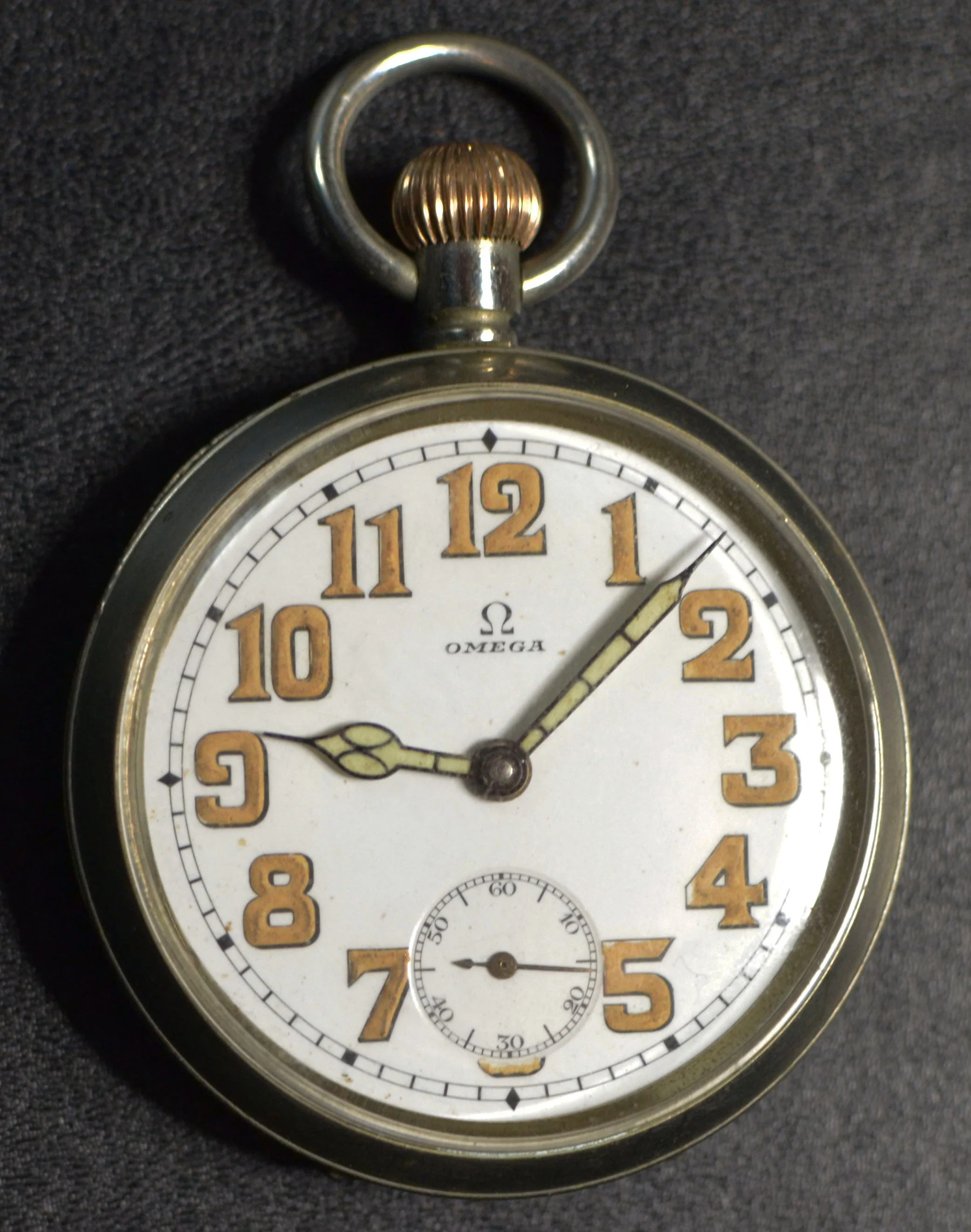

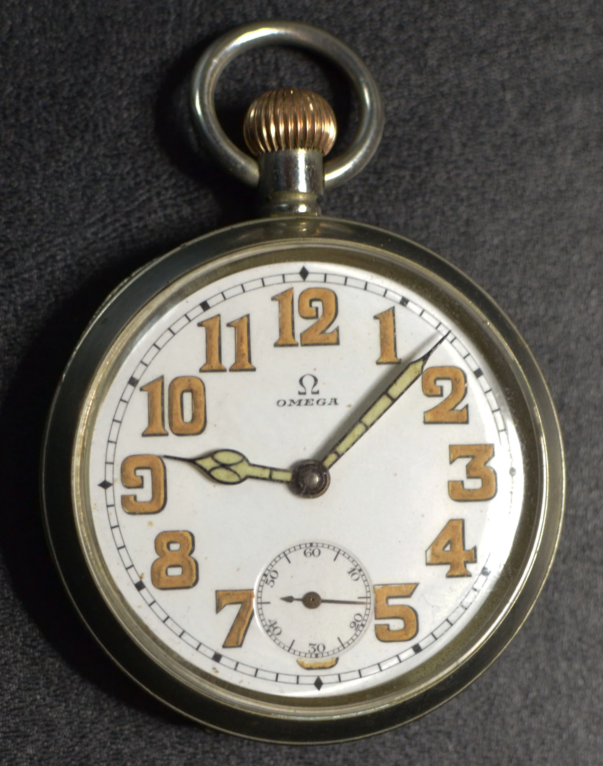

Sometimes it can be a deliberate, but not deceptive, act to relume the hands and leave the dial untouched.
Perhaps this watch had damaged lume in the hands (which have obviously been relumed) or they were relumed to reduce the overall amount of radium. Thankfully the dial remains untouched:

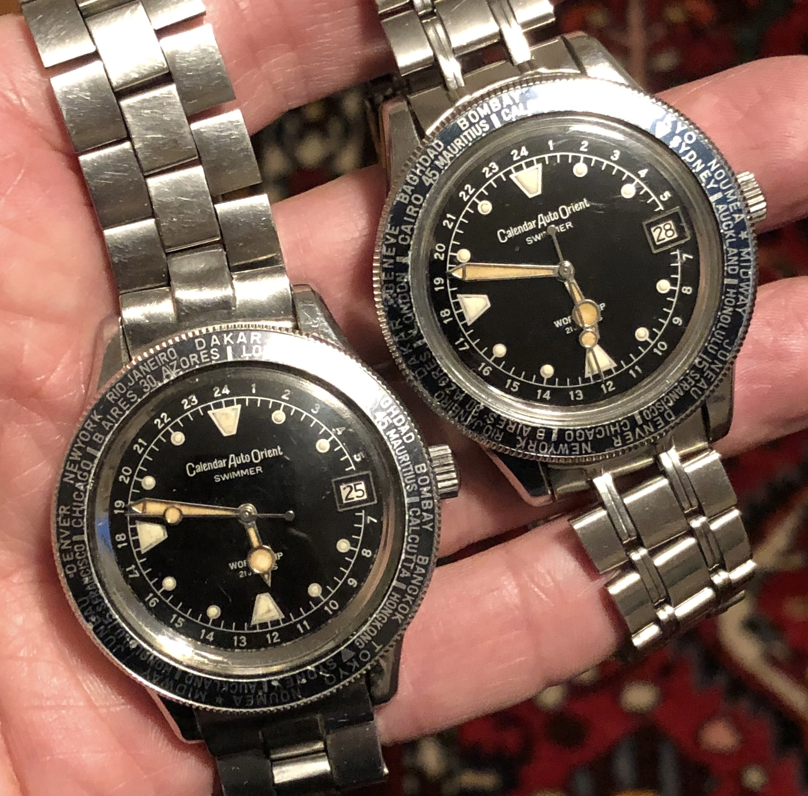

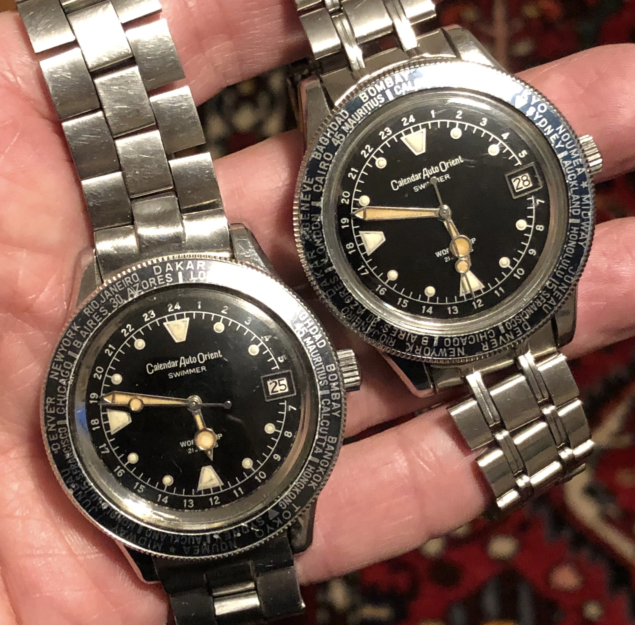

Straying a bit from the question here, but some watches deliberately used two different colors of lume for hands and dial, so it would be easy to tell the difference. Some used different color lume for hour and minute hands, and some used a different color of lume for certain markers on the dial (e.g. 6 o'clock).
