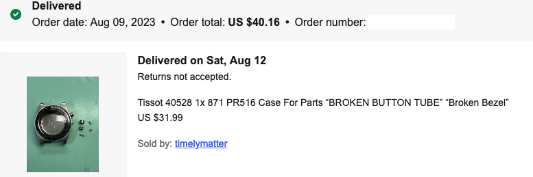

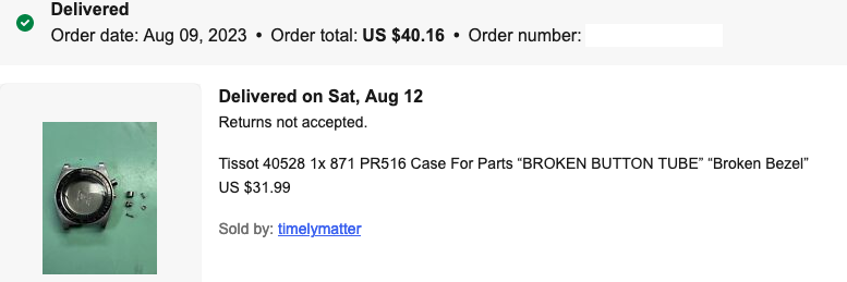

I saw an auction for a Tissot case no movement. To my surprise I got it for close to my low bid. It also came quicker than I expected.

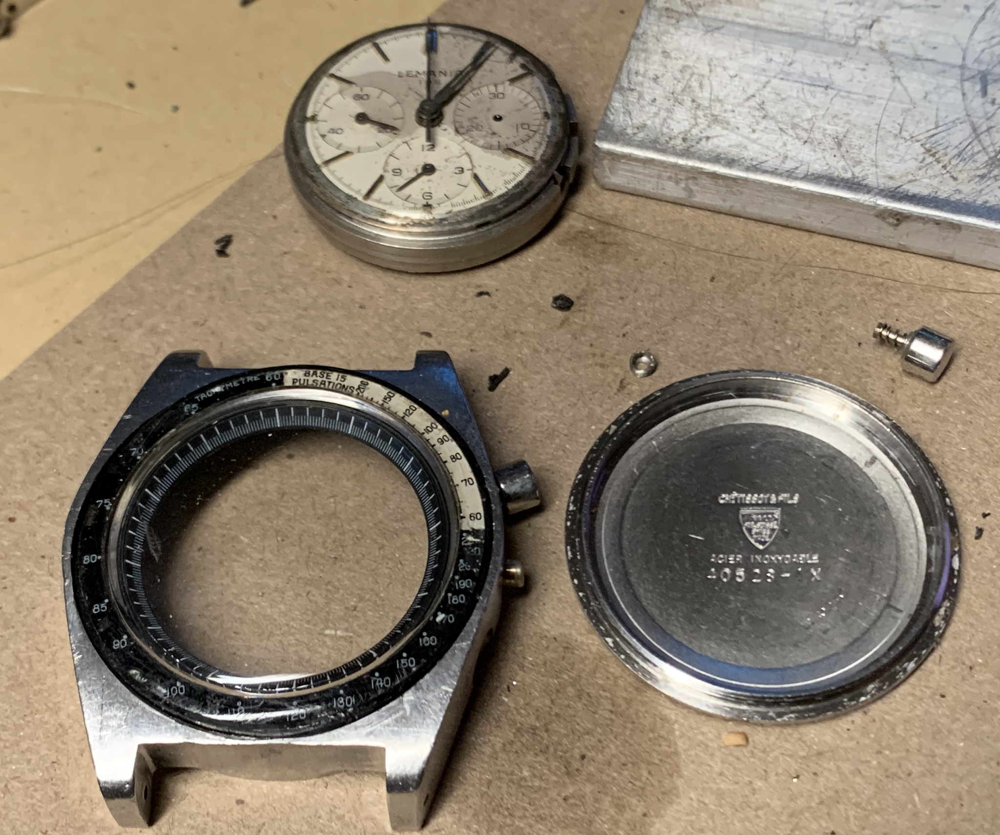

Lemania pretty much only fits into Omega and Tissot cases. I have a T-12 chronograph with the UFO donut case. I also noticed that the L-1280 movement which still has a movement ring would probably drop right into it.
So I deciced to take a chance on the 40528 case. Not quite the 1940s/50s case I was looking for. A workable case is better than no case. This is a proper Frankenstien case.

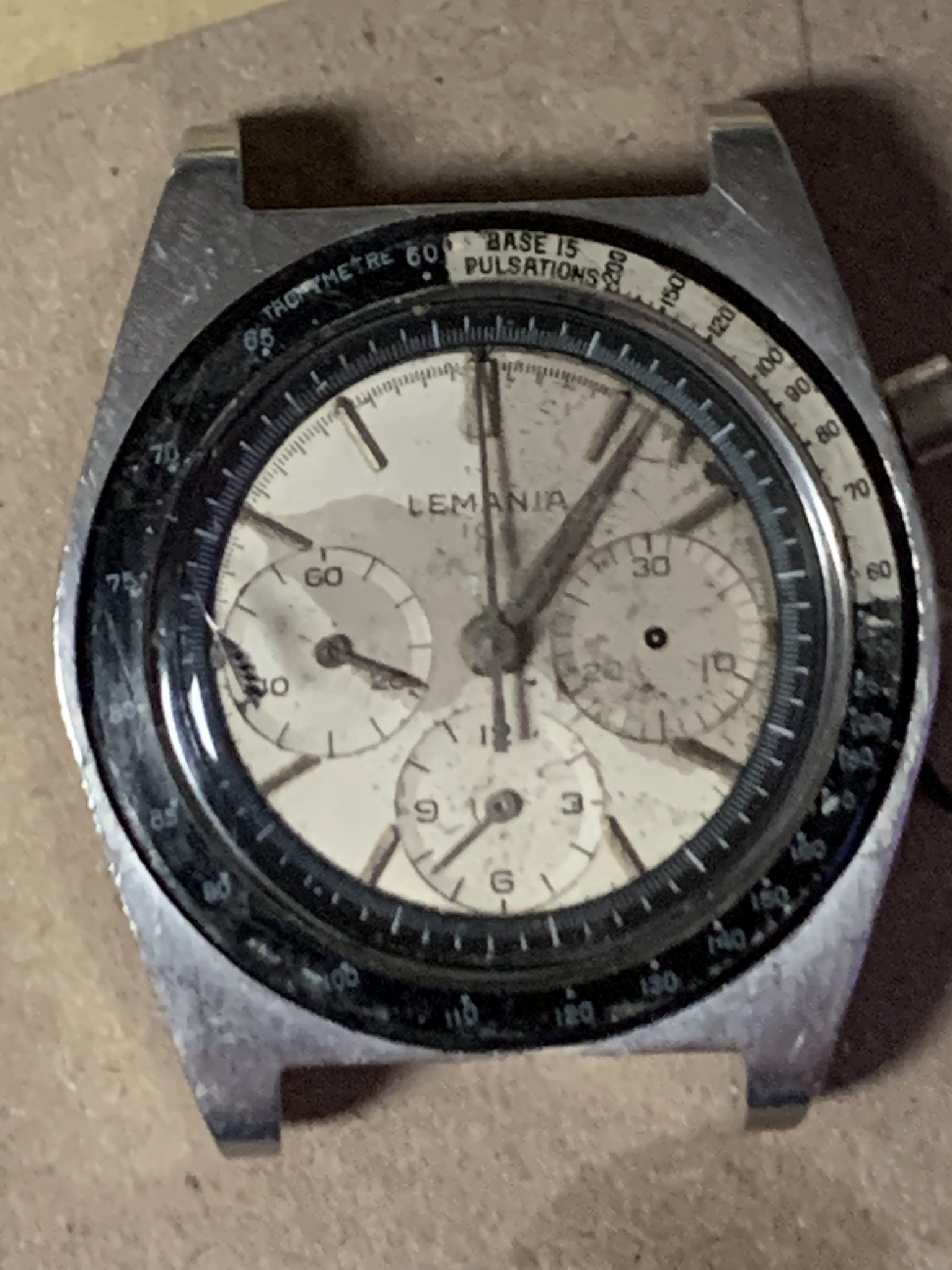

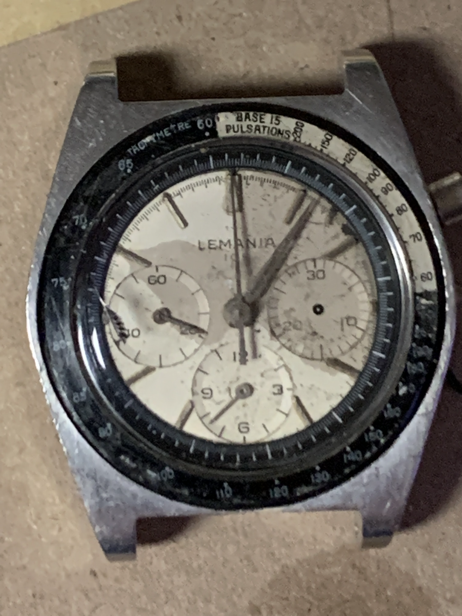

The actual case is better than I expected. The auction photographs made it look like a chunk of bakelite bezel was missing. It actually looks quite good to the naked eye. To my surprise the bezel is complete and has a DON 90 marking. There is some delamination in the protective cover which catches the light and makes it look flakey.
The crystal is cracked which might be a bit of a challenge.
Over the years the Telimiter markings have worn off the 105 dial so having the inside chapter ring is a plus. The sweep hand is a bit long for this though. The hour hand is missing, so this will need a new handset anyway.
This can never be anything but a Franken Marriage. Still it has a nice Bride of Frankenstien vibe to it when the movement is placed into the case.
It is also a penny for pound watch as it needs a crown as well as a new pusher. I did get a stem for it.
In the meantime, it goes back into the drawer, until I do find these case parts and an interesting handset. Curious the hour hand broke off, but not the minute. The register hand will be a bit tricky.
