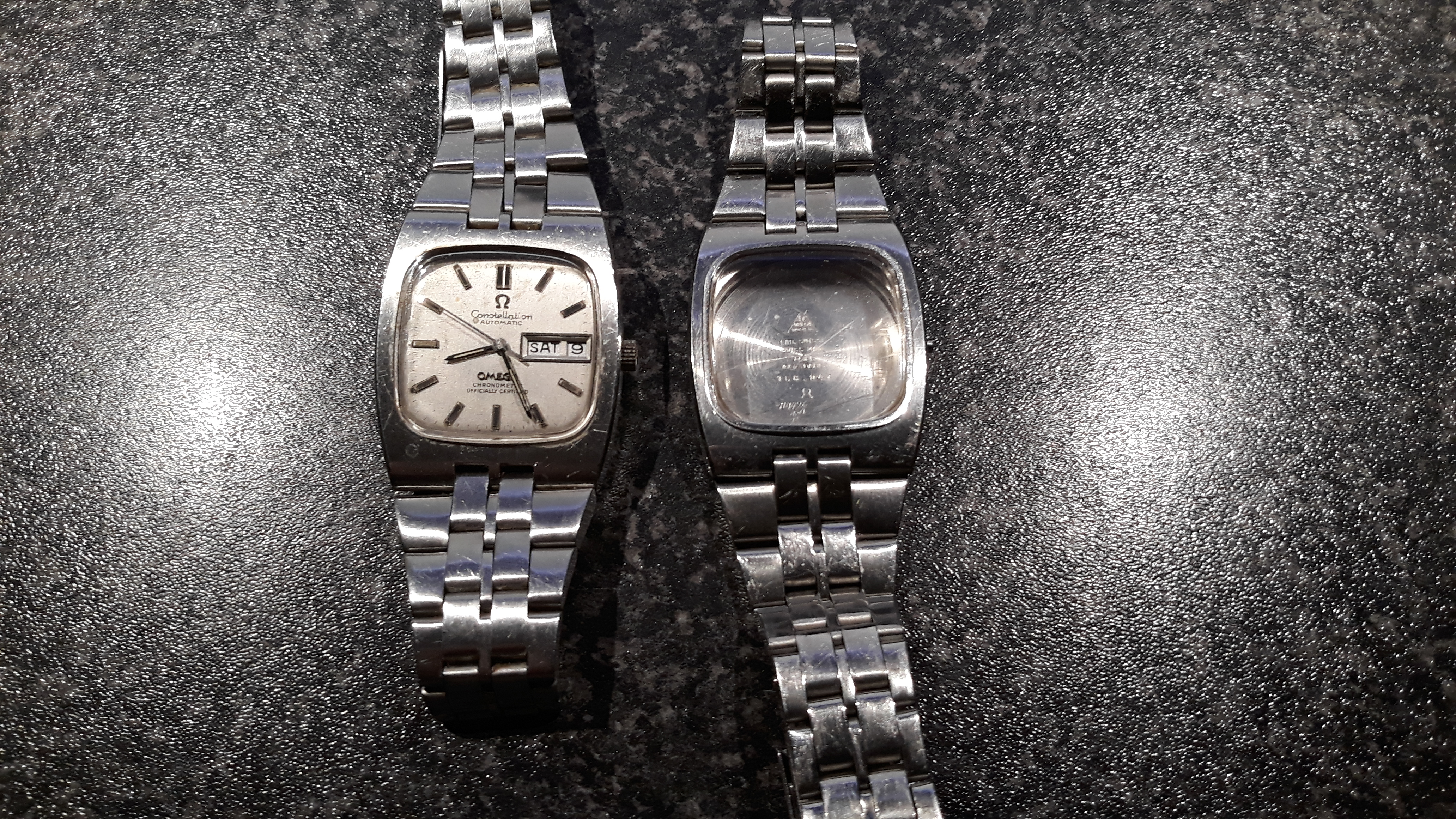

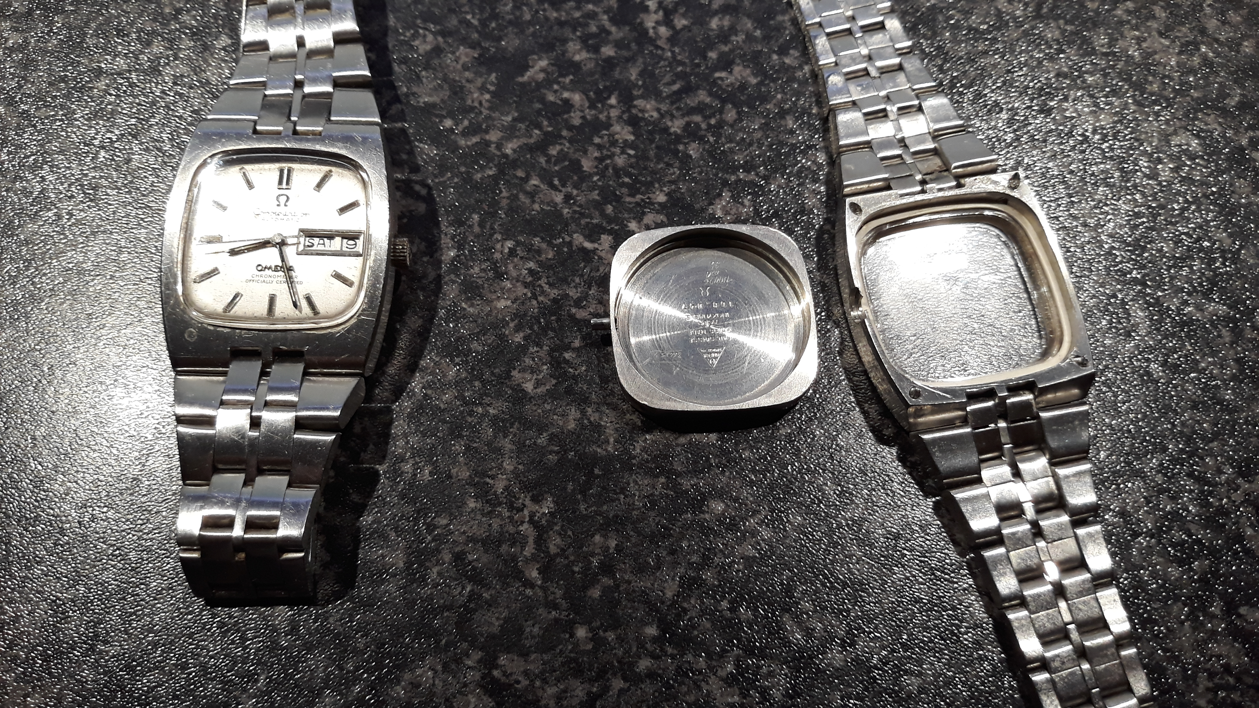

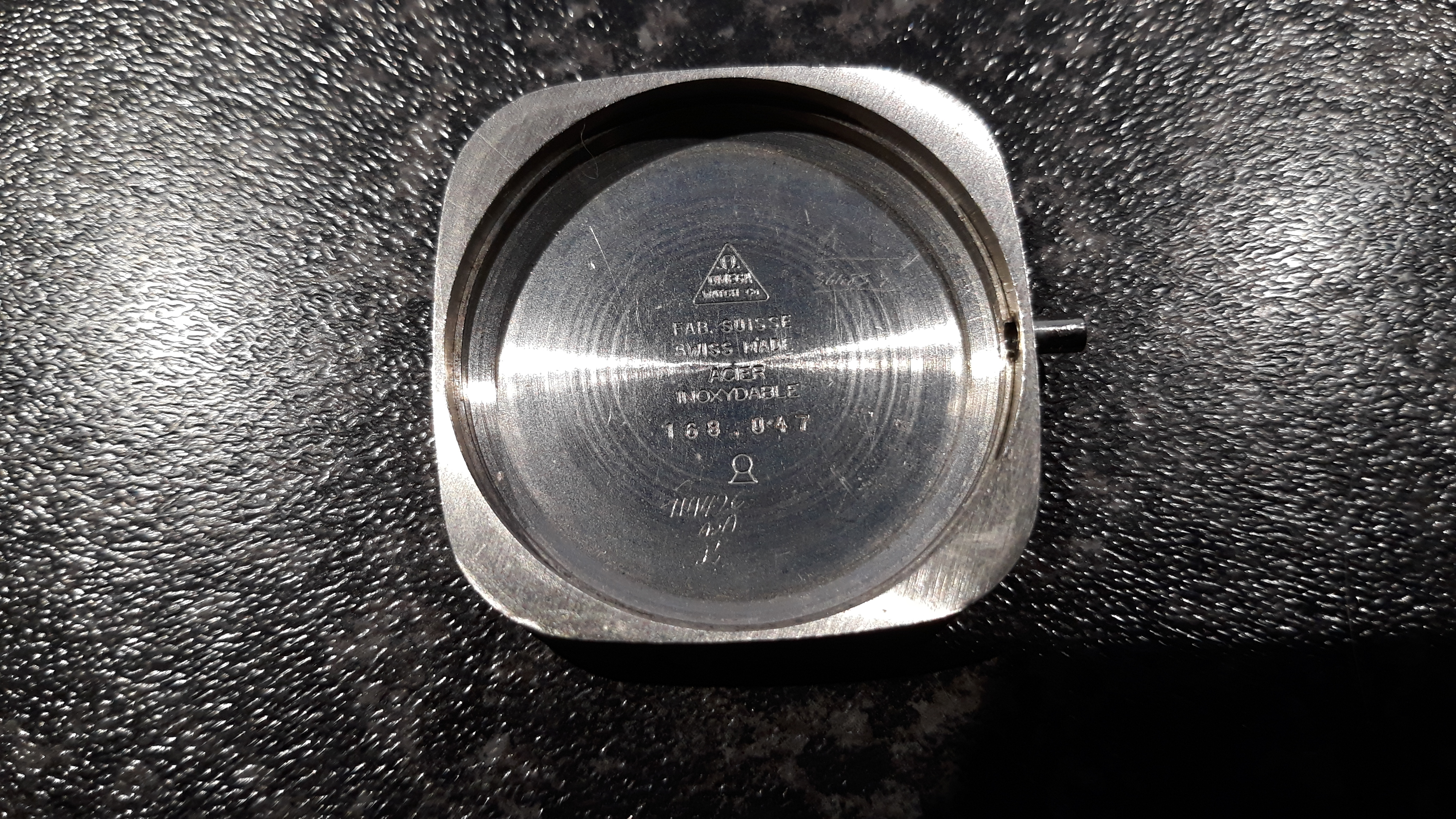

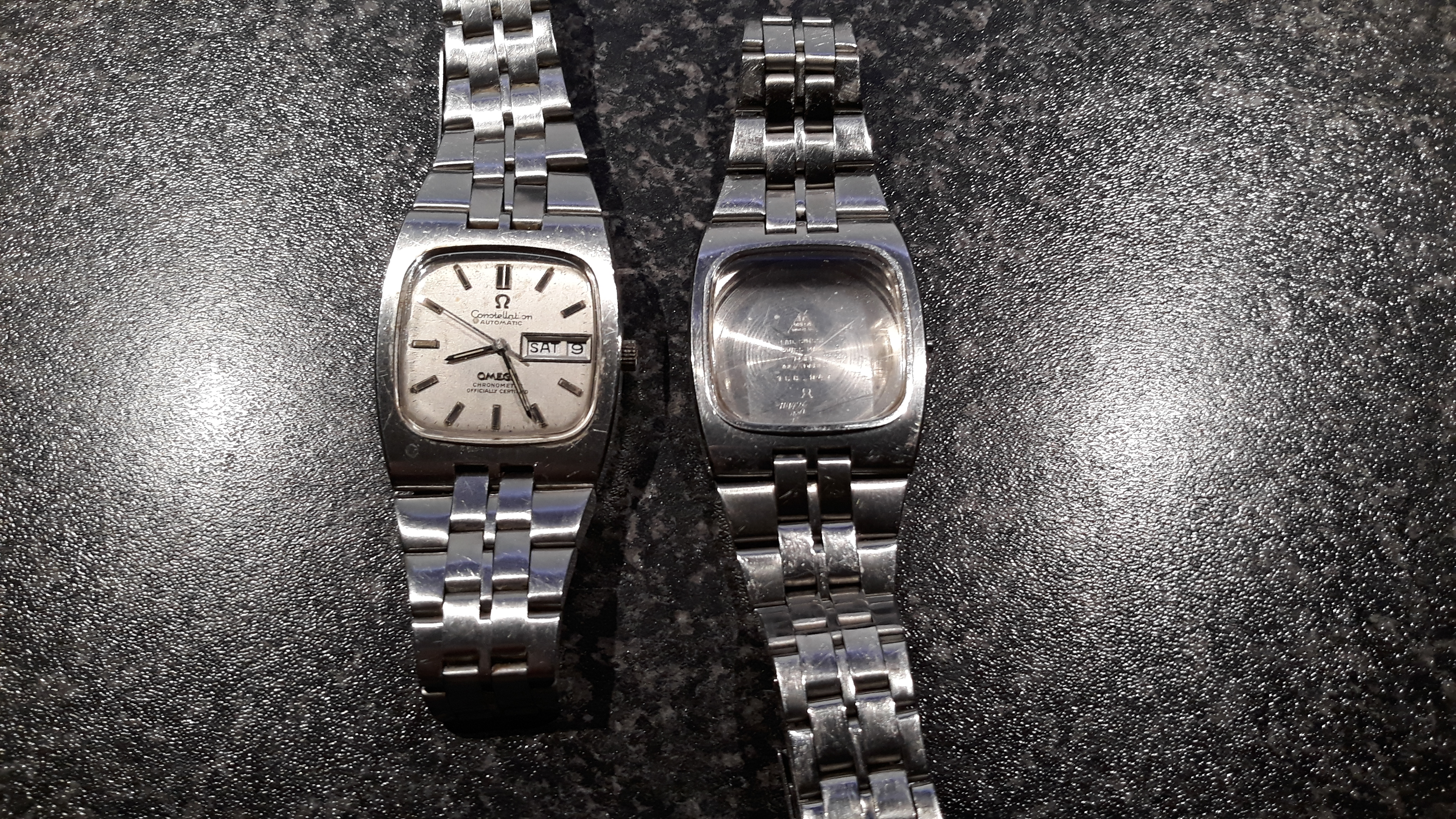

I hope someone can help with a Constellation case puzzle.
The case is stamped as genuine, it comes with a detachable backplate marked Constellation held by 4x angled screws and looks real with the Omega Triangle, stamped FAB SUISSE SWISS MADE ACIER INOXYDABLE (sic) 168.047
My problem is that the movement sets into the backplate with the stem passing through a captive tube Which means the movement must be fitted with the stem removed. But to lock the stem down (Or remove it again) I would need to access the back of the movement, which with the stem inserted I cannot do.
I have a Constellation movement that fits, but - It is in a similar but damaged case and I can't get it out to check its calibre.
It has the look of a catch 22-situation... Unless anybody knows better? I would be most grateful if anybody can throw some light on this puzzle

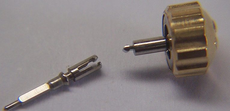

As noted above.
Pic courtesy Mark Sirianni AKA Watch Doctor.

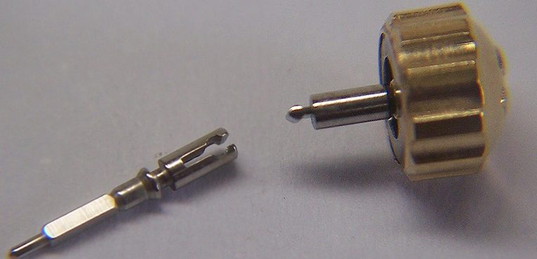

Thanks for the clarification, I see how it works, Forgive me for being thick but....
How do I get to separate (or join) the split stem when it is within the tube with no detectable movement beyond the movement set pull 1 & 2?
30,285
78,160
The male part of the stem is fitted to the movement before you install the movement into the case. Then the female part, attached to the crown, is fed into the case tube, and when you line them up and press, they snap together.
To remove the crown, you pull it out to the farthest setting position, and then grip the crown an pull - it will pop right off.

As simple as that. I had guessed, but didn't dare to pull too hard in case I broke it. Thank you.
