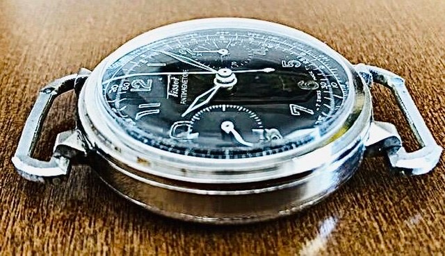

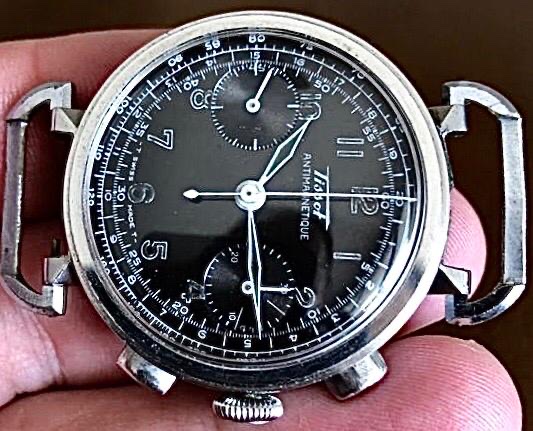

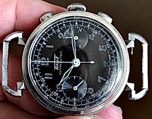

Hello guys, I am posting just to get some help from you on this beautiful Tissot. I just only want to be sure if everyting on it is as original as it should.

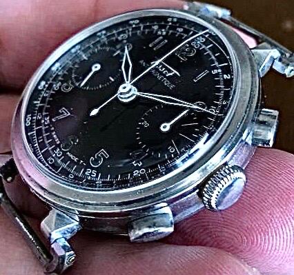

Hi @edwatches74 and welcome to the forum!
Unfortunately, the dial has been repainted on this example so it is no longer original. Vintage watch collectors call this a "redialled" watch. If you're a vintage watch collector or you want to learn about the hobby, you've come to the right place. Please stay for a while and read the threads about what collectors look for in a vintage watch - and what they avoid, like redials. 😒

Thanks a lot Vitezi. I am relatevely new on this subject and at risk to fall in some traps like this. To improve my knowlodge could you plese tell me how to I spot a redial likenthis one for example?
If you're new to vintage watches and you think collecting a few might be a fun hobby to pursue, I would encourage you to read all of the information available (for free) on this forum before you buy anything. Here are a few threads to get you started:
https://omegaforums.net/threads/for-the-new-members-read.23288/
https://omegaforums.net/threads/horology-101-understanding-your-watch.76731/
https://omegaforums.net/threads/condition-condition-condition-and-other-pieces-of-advice.1716/
https://omegaforums.net/threads/learn-how-to-fish.52603/
This thread will show you what other vintage collectors like to wear: https://omegaforums.net/threads/wruw-today.567/
Take some time to browse through other threads on this forum - there are many threads that analyze redialled watches from Omega and other brands. By this time you finish your eyes will be bleary but you'll have a good understanding of what to look for in a vintage watch. Don't be afraid to ask lots of questions. Have fun!
