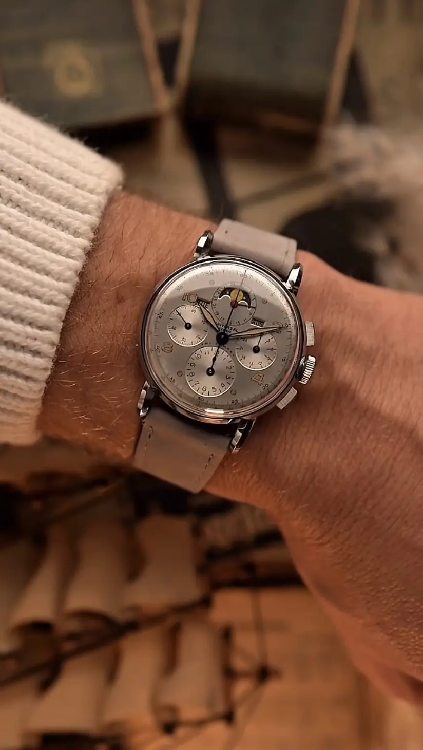

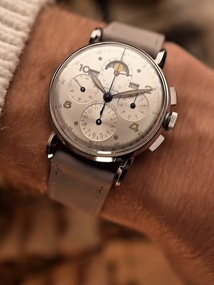

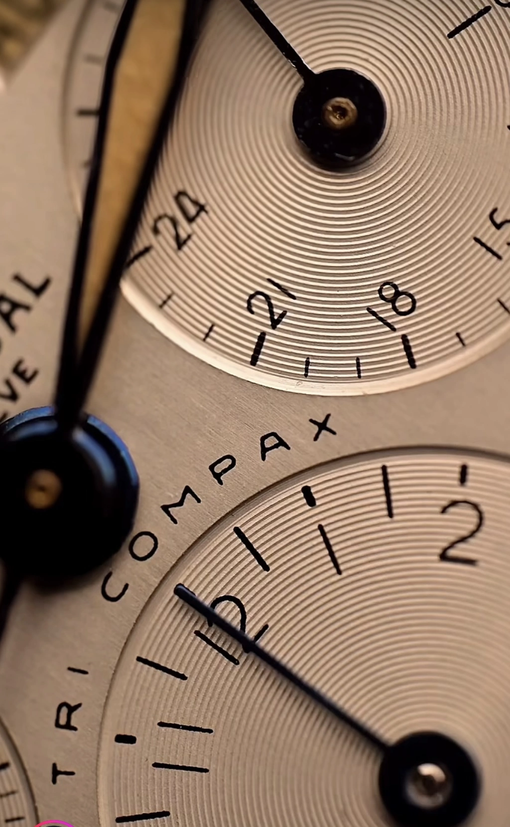

Hi,
Appreciate thoughts on this tri-compax. Not sure of price yet. Pretty reputed vintage dealer (goldammer) - drops next Thursday. Apologies pics aren’t great - had to take screenshots from a video. (Ref 22250)
Thank you!

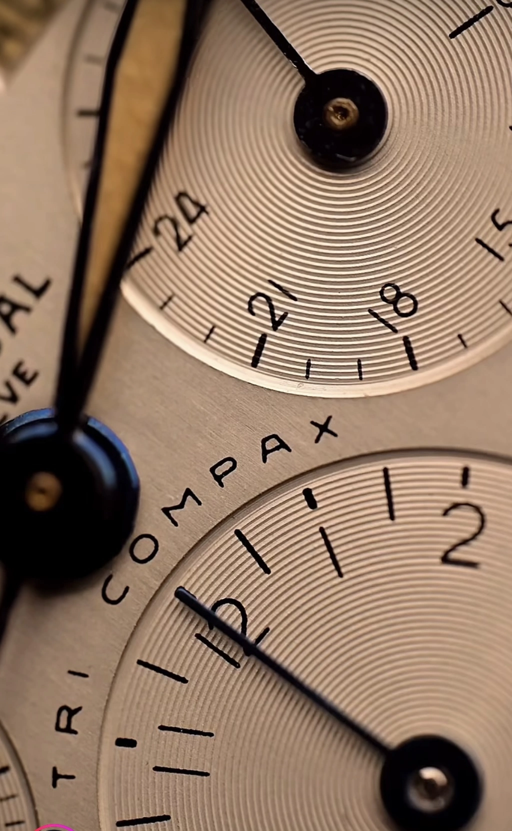

There is some inconsistencies with the between-minute markers(see the length of them compared to eachother!), and the '2s' on the calendar are super inconsistent. Not sure if that is authentic or a redial though, if its a redial, it is pretty expertly done (OR, this level of inconsistency is just normal on UG?).

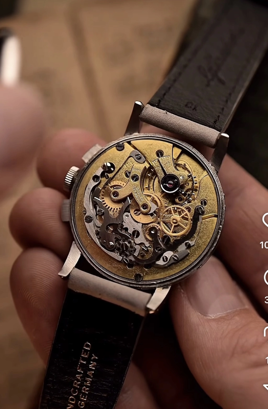

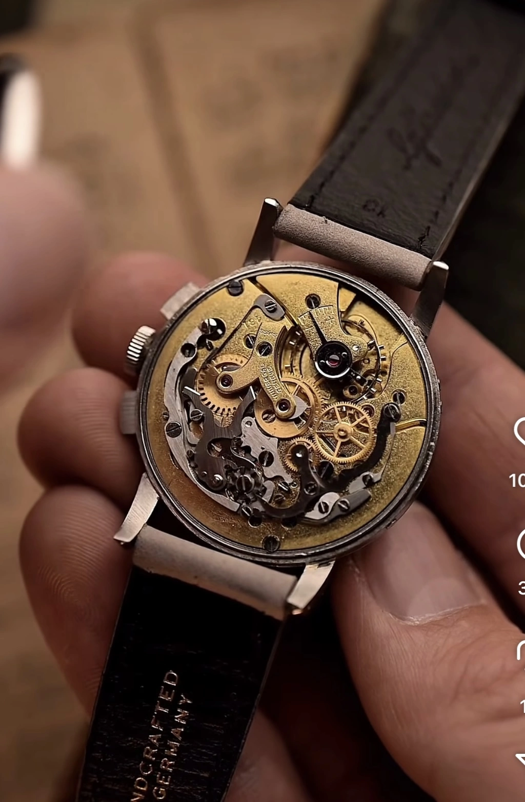

Overall a pretty watch! Though that chrono movement resizing is kinda silly! Rather than a movement ring, they just made all the plates that much bigger on a smaller chrono movement! Thats a funny way to do it, 281->481 apparently is just some plate-resizing, rather than making anything bigger!

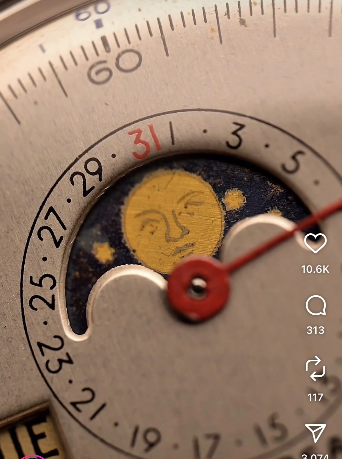

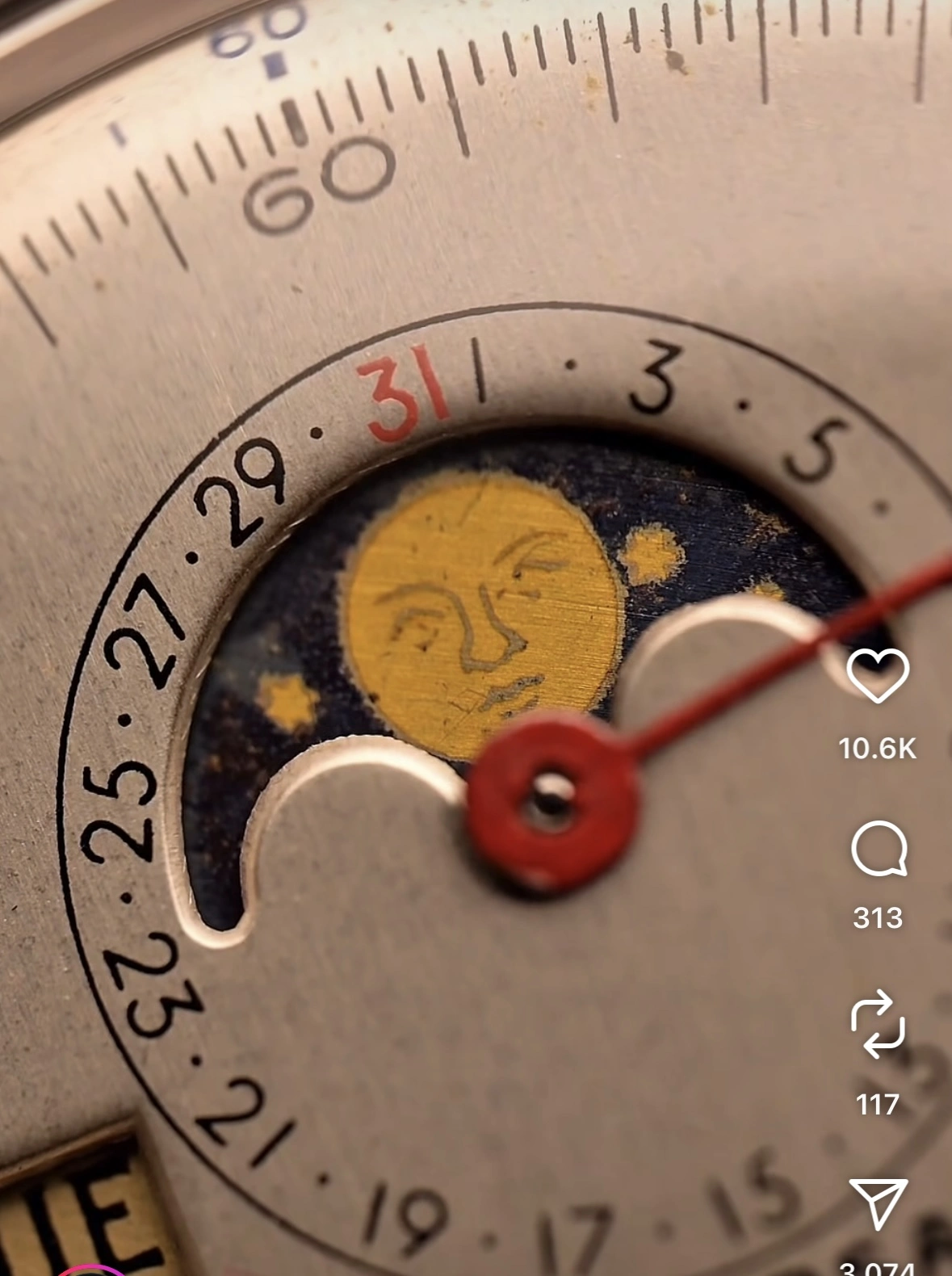

Not a redial. It is a factory replacement dial (early 60s) that has been frequently discussed here on OF. Hands have had a re lume regime. Case is correct and sharp. The moon disc appears to be ok as well as I found an ad with that style in Sala. Generally they replaced the moon to a faceless one when changing out the dial because the original discs deteriorated. This is a nice watch.

yah that’s the classic UG service dial. All the parts are UG but it looks put together and heavily prepped. Not that there’s anything wrong with that…..if that’s your jam.

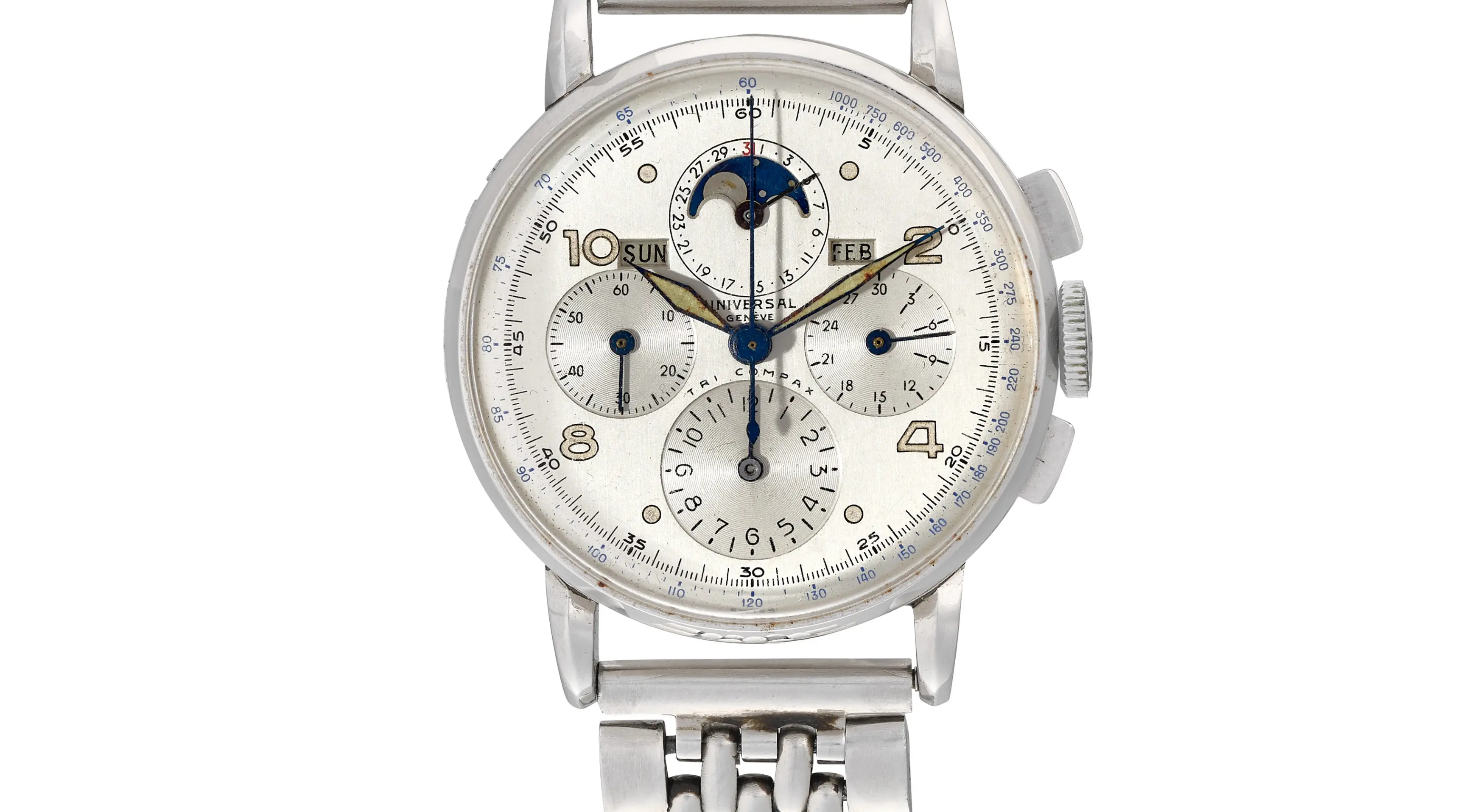

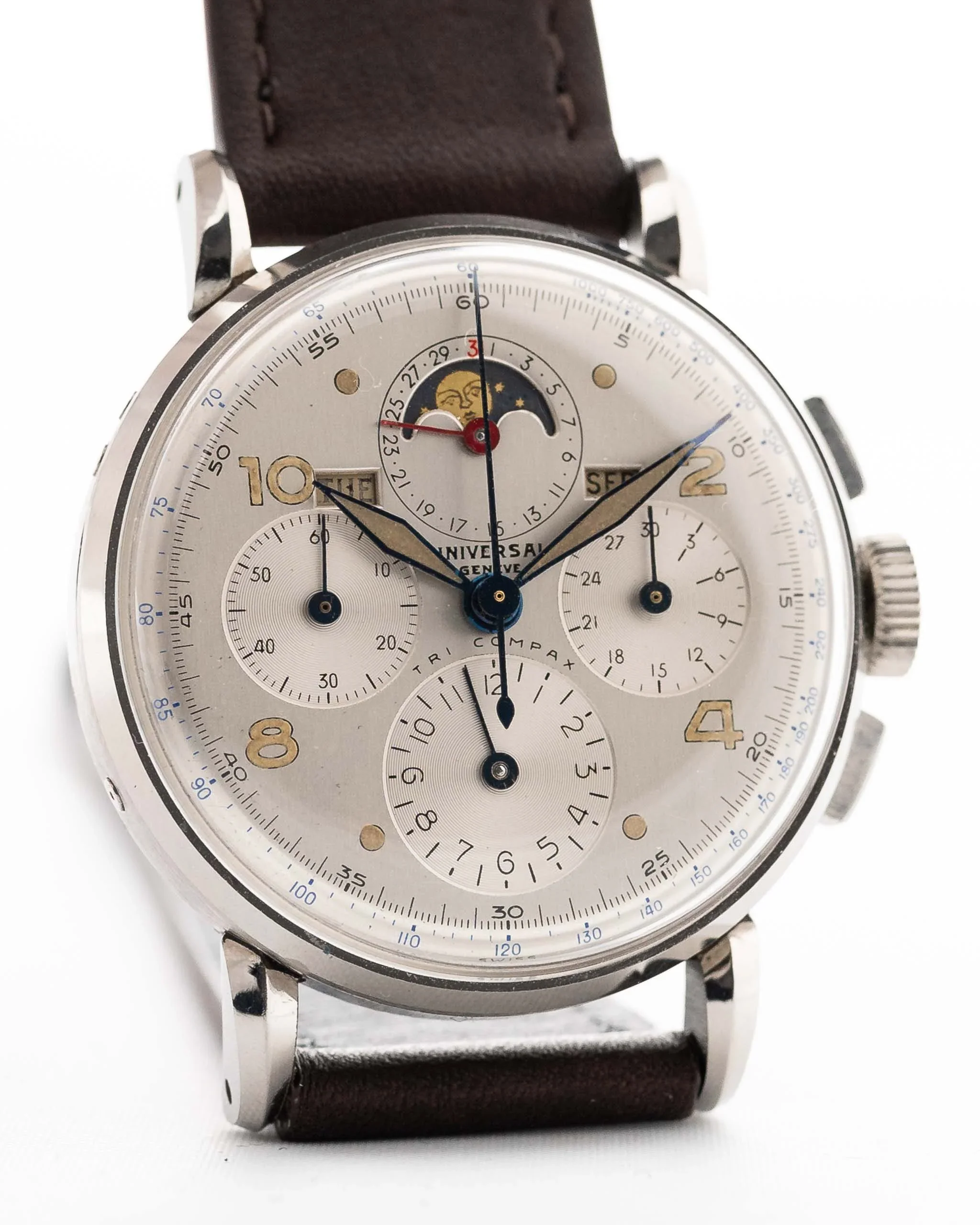

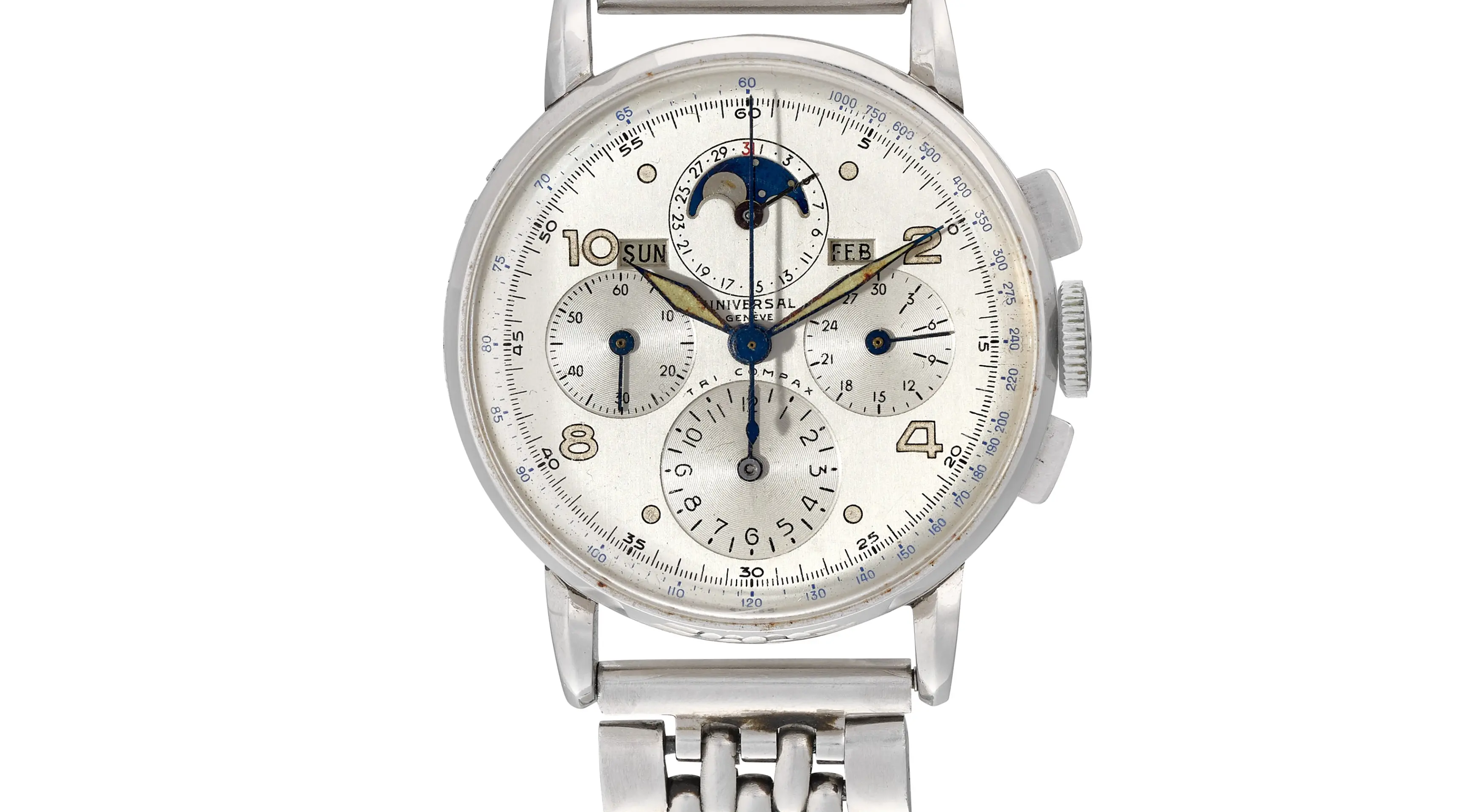

There's a similar example coming up for auction soon (see link)

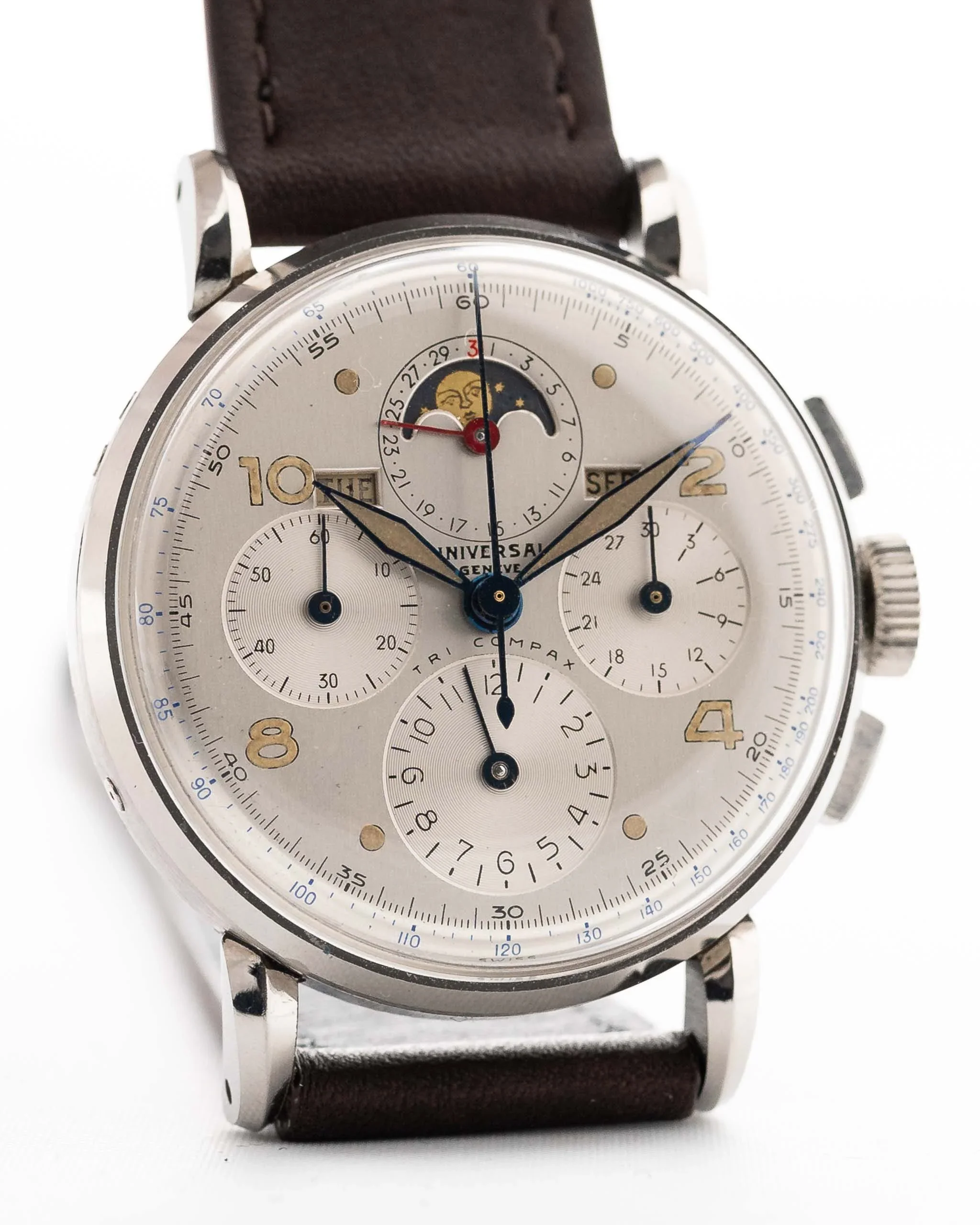

This watch looks to have a service moon phase disk in addition to a service dial. Wish there were more pictures readily available, but I'm sure the auction house will provide more if you ask

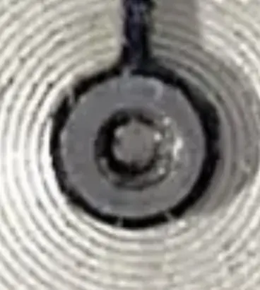

Also, the chrono hours and date hands don't look right to me:
But similar package to the Goldammer watch, and you'll have more time to think about the price/condition report/pictures

Yep.. this is what i would expect to see if UG had done the service.

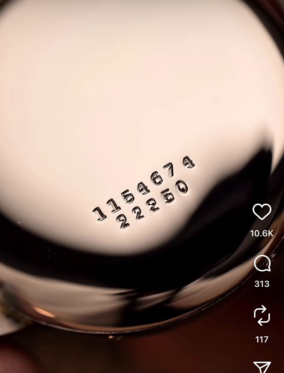

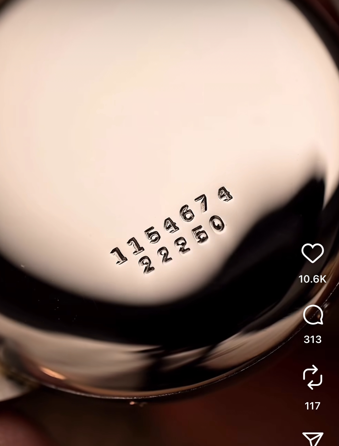

Actually if you compare the serials of all the three 22250 they sold in the last years, they are all different. They bought a stock of NOS cases that they are slowly putting together...

Well UG is hot again so “make hay while the sun shines” I guess. Nothing wrong with that if the product is high quality and composed of SN /Ref appropriate UG parts. It’s not like it does not happen with other brands and models. I do believe the dealer blurred out the movement SN.

It’s in the discussion I posted, (although if you see three exact same case references, all with service dials, it’s a pretty clear pattern).

I would be checking case serials and movement serials to put a date on them.

Interesting--the Finarte tri-compax up for auction has a serial very close to the Goldammer 22250s: 1154805
I wonder if the same person cobbled together that watch as well...
