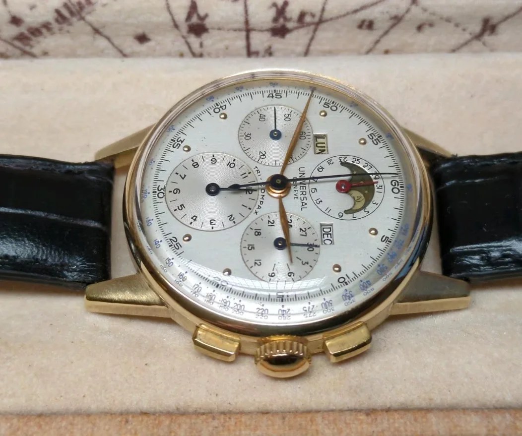

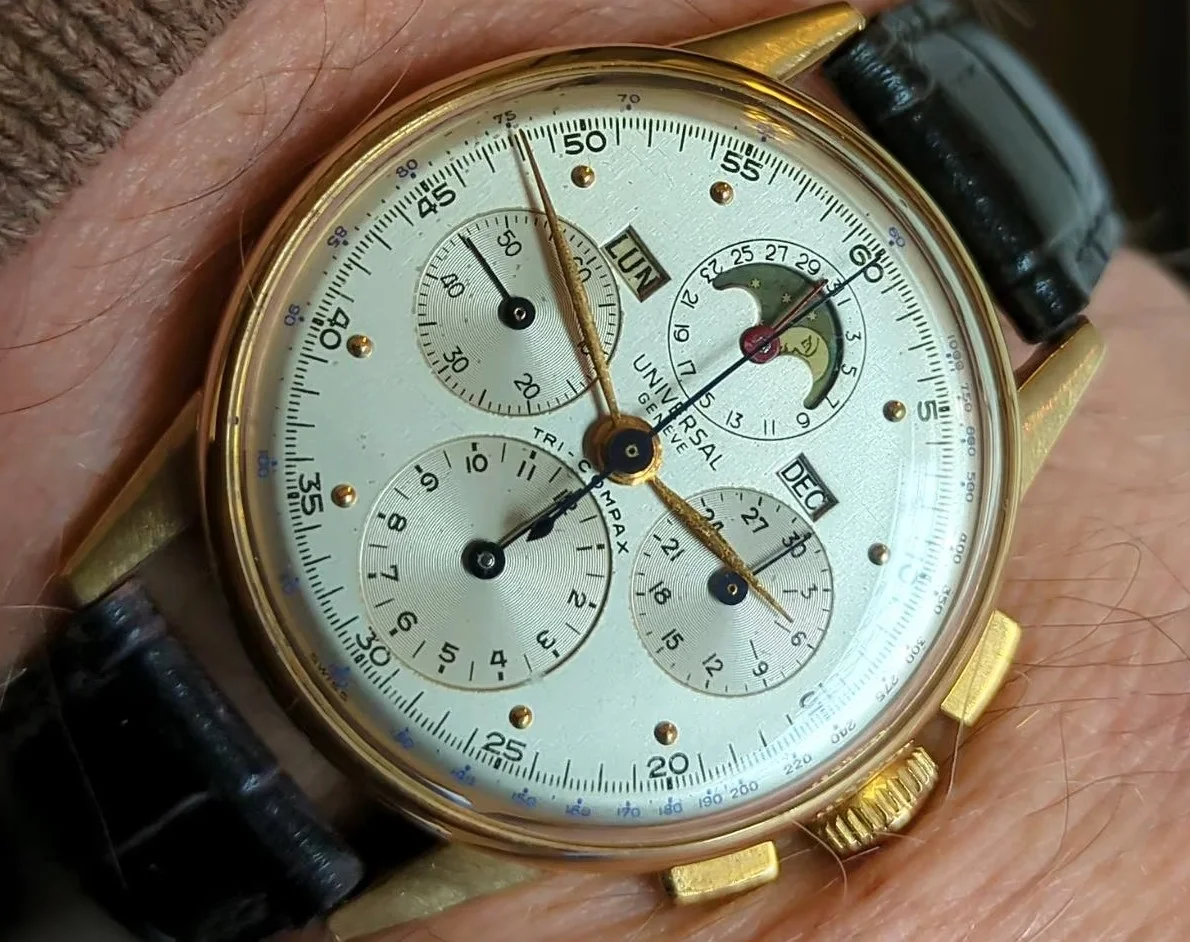

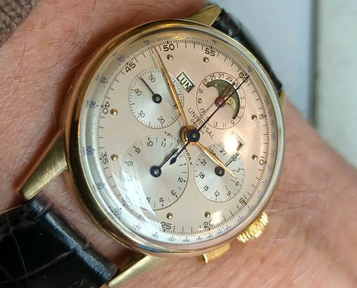

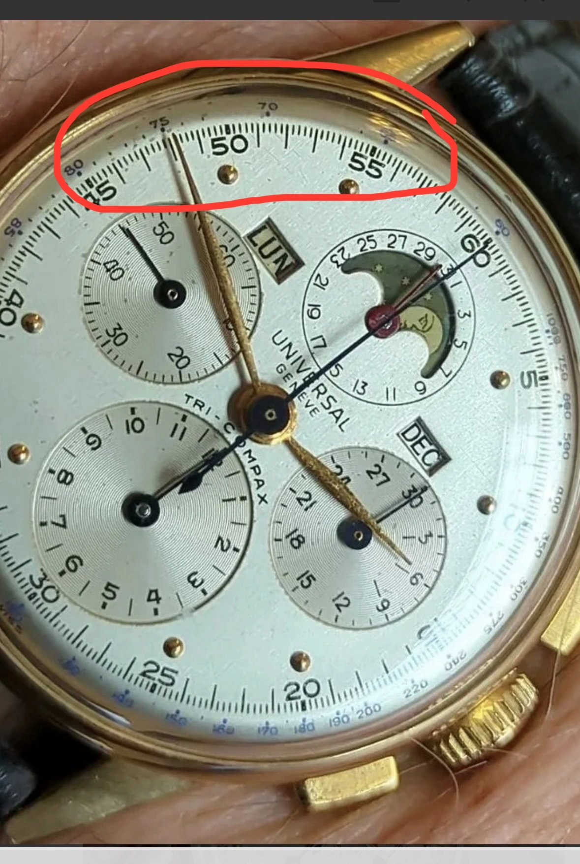

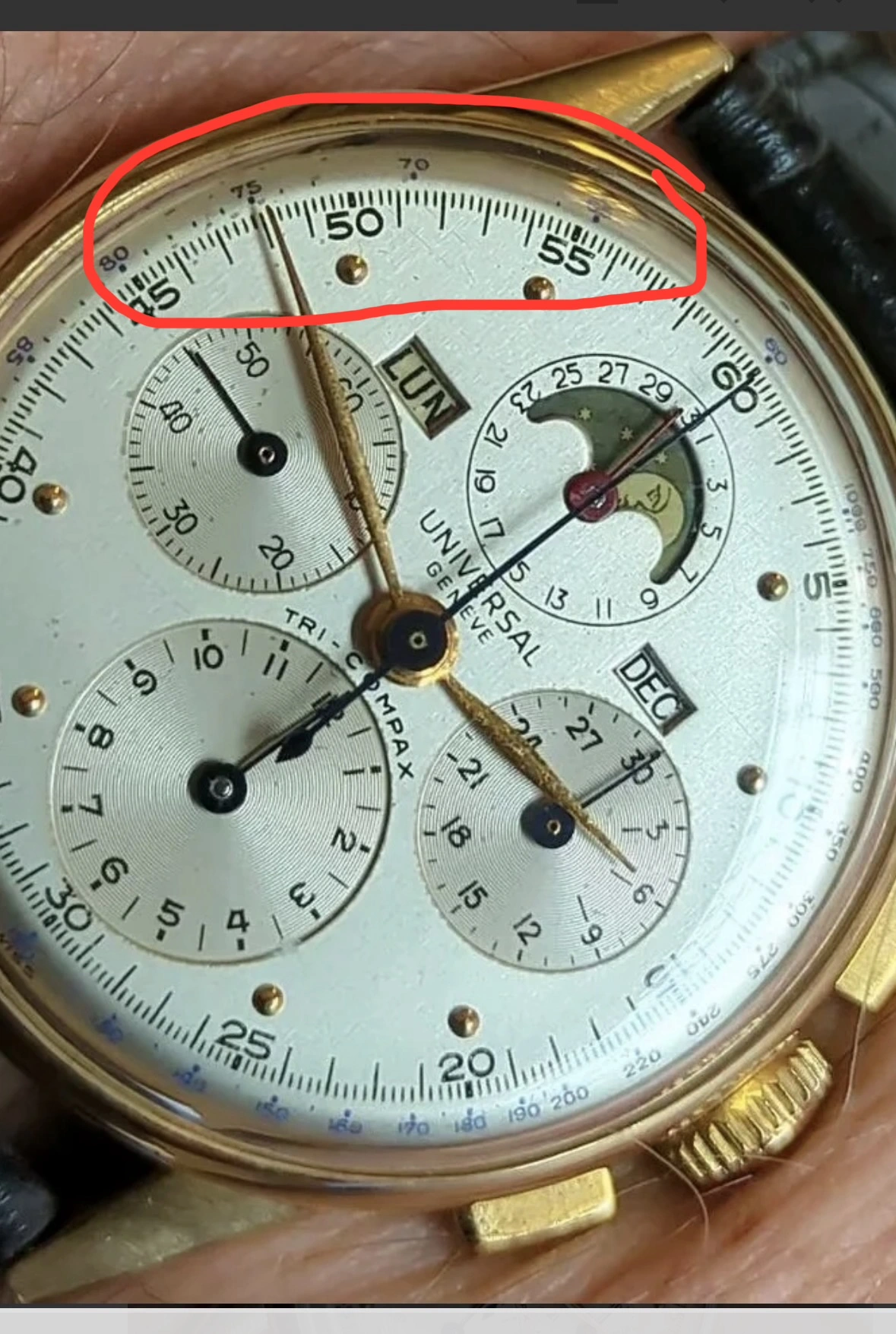

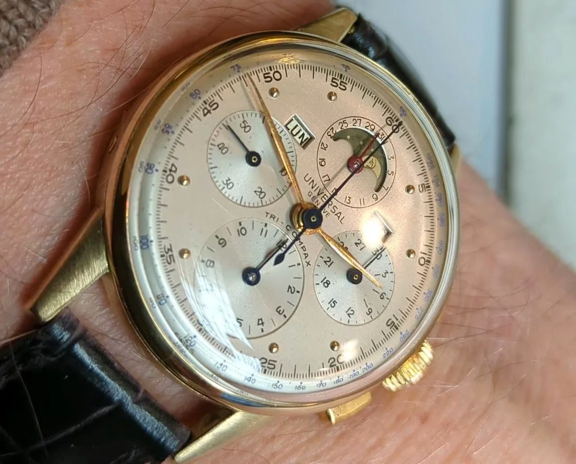

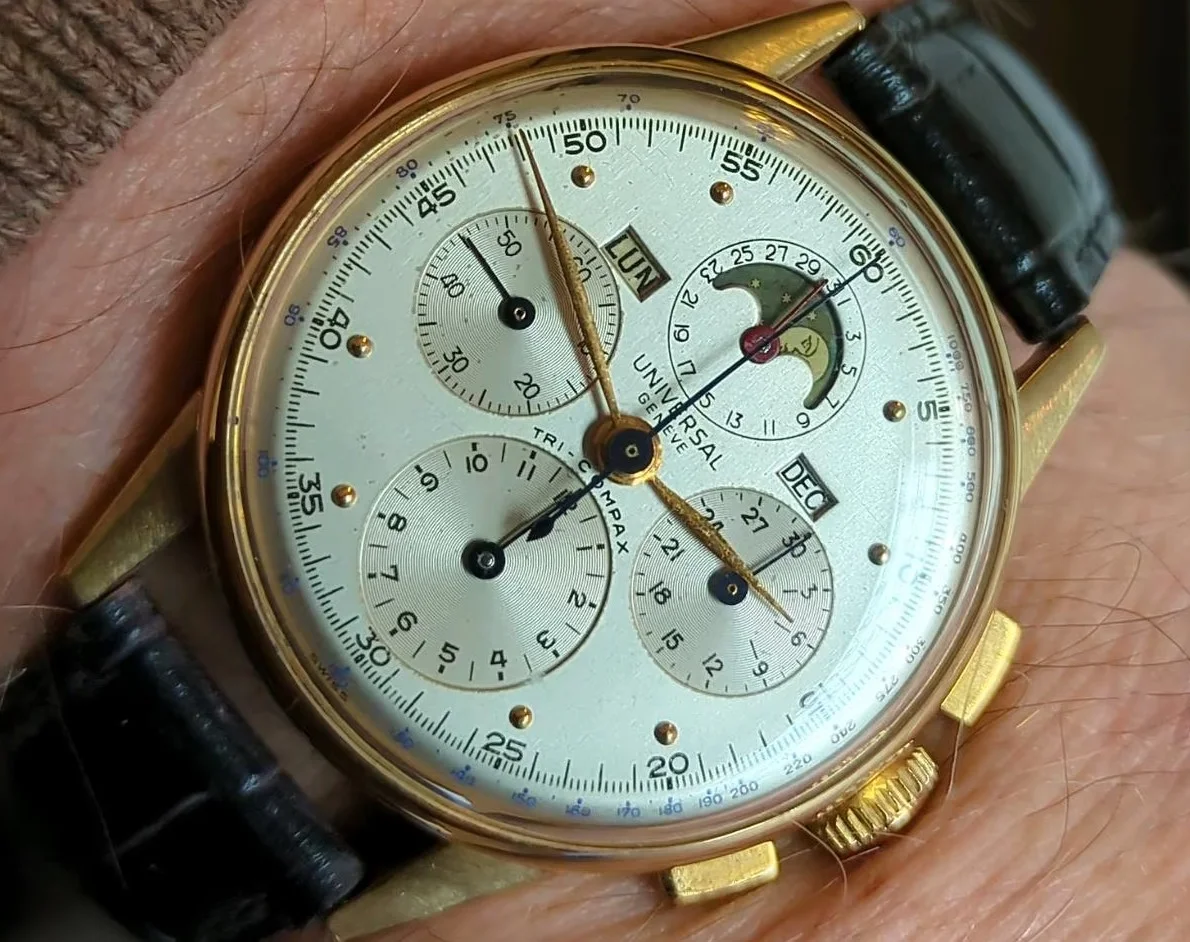

i found this UG Tri-Compax that I am interested in buying. The seller is asking 4.400€ for this solid gold Ref. 12253. For my eye everything looks legit, but like with every brand, "the devil lies in the details" as we say in Germany 😉
Any red flag, especially regarding the dial? Any feedback appreciated, also regarding the price. Thanks in Advance!

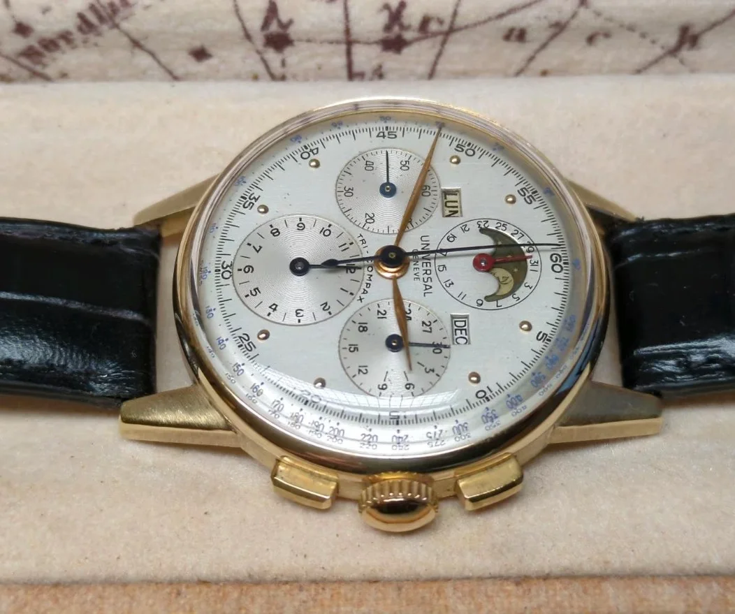

Hey guys,
Nico
To my untrained eye, the dial seems off. Take the tachymeter for example, it should have more markers between 75-60. Could also be the angle and Crystal making them not show up, but I think theres something else hiding.
13,999
54,301

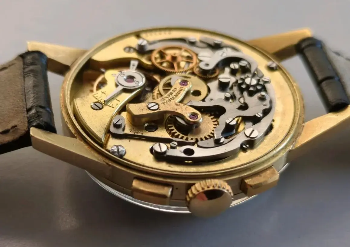

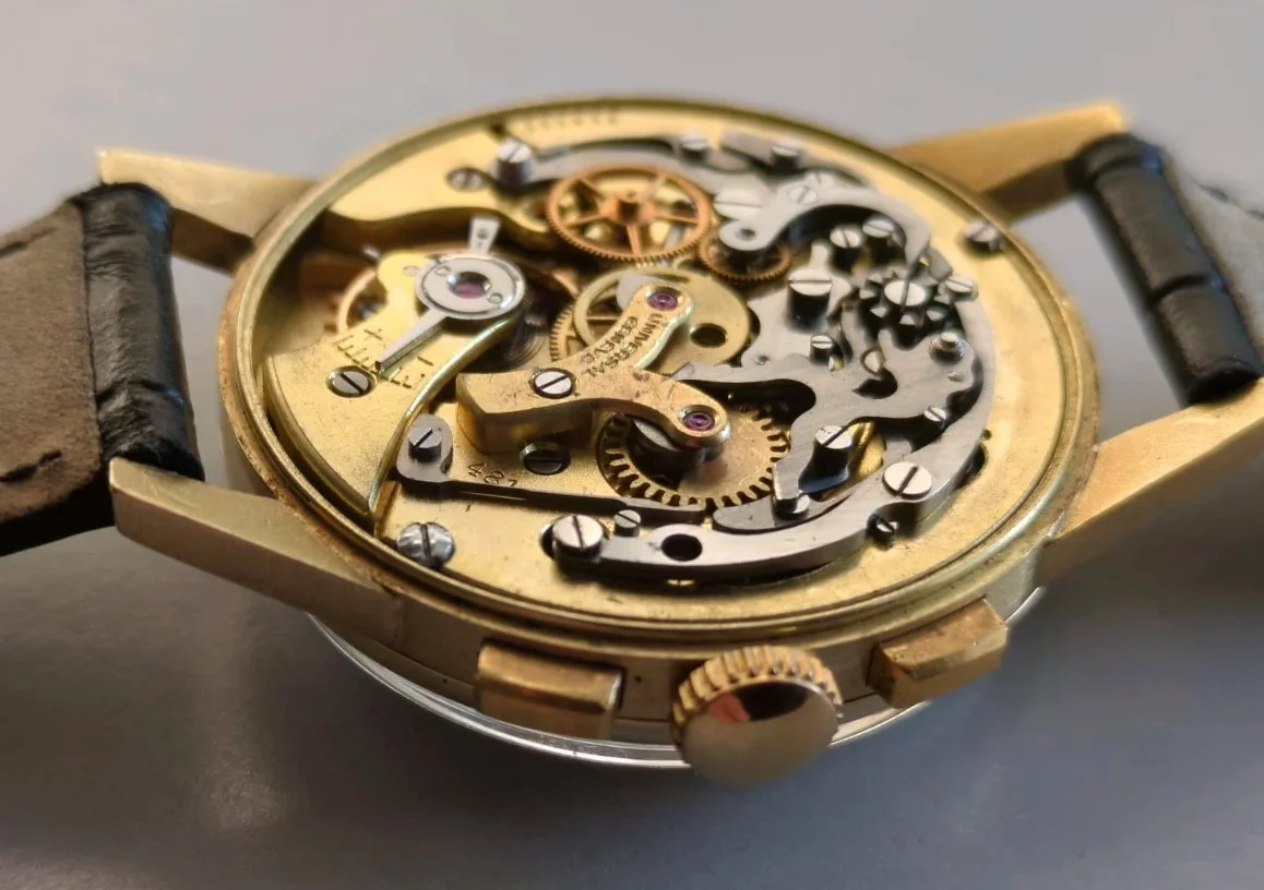

Nothing amiss here. Case is a bit soft and weirdly finished which I think is dragging on the price . Movement looks to be due for a service. Love the moon …
1,127
3,952
I think it is a redial. I could be wrong, but I think this watch has already been posted here in OF
13,999
54,301
Yep … Just noticed the hour counter 3 …retouched perhaps but not completely redialed..
1,127
3,952
Thanks guys, you saved me a lot of money 😀
