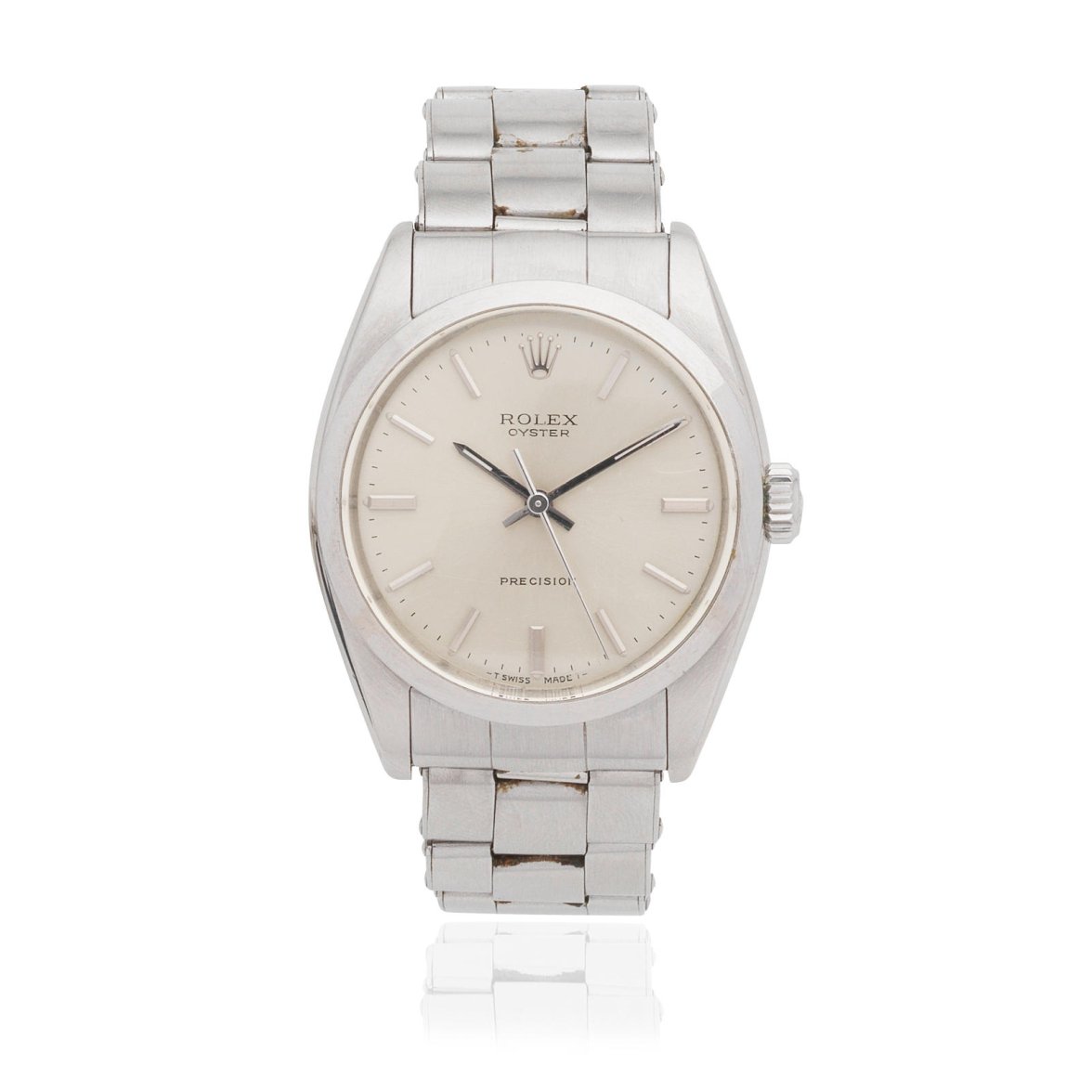

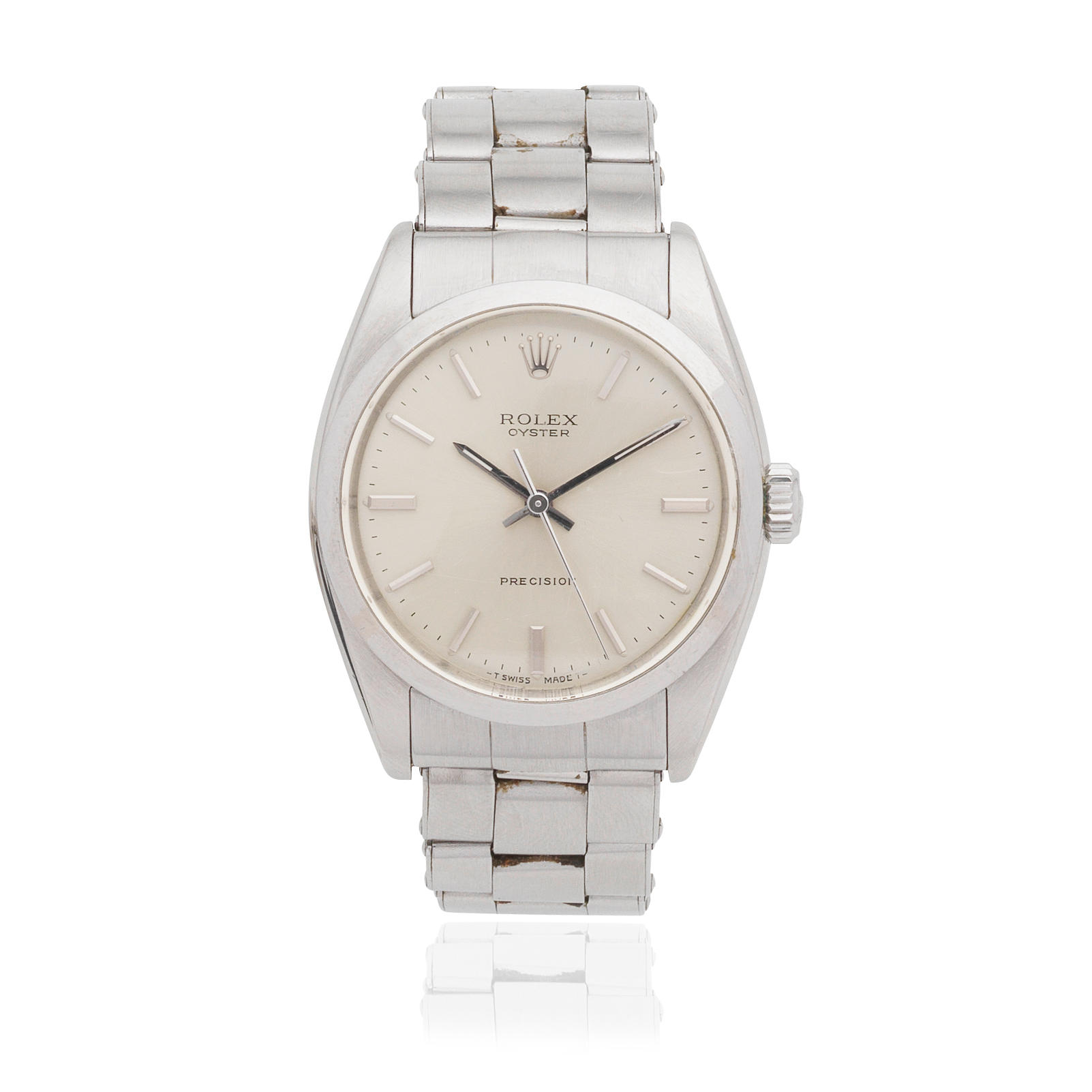

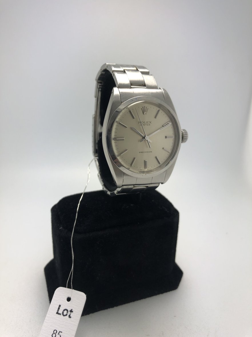

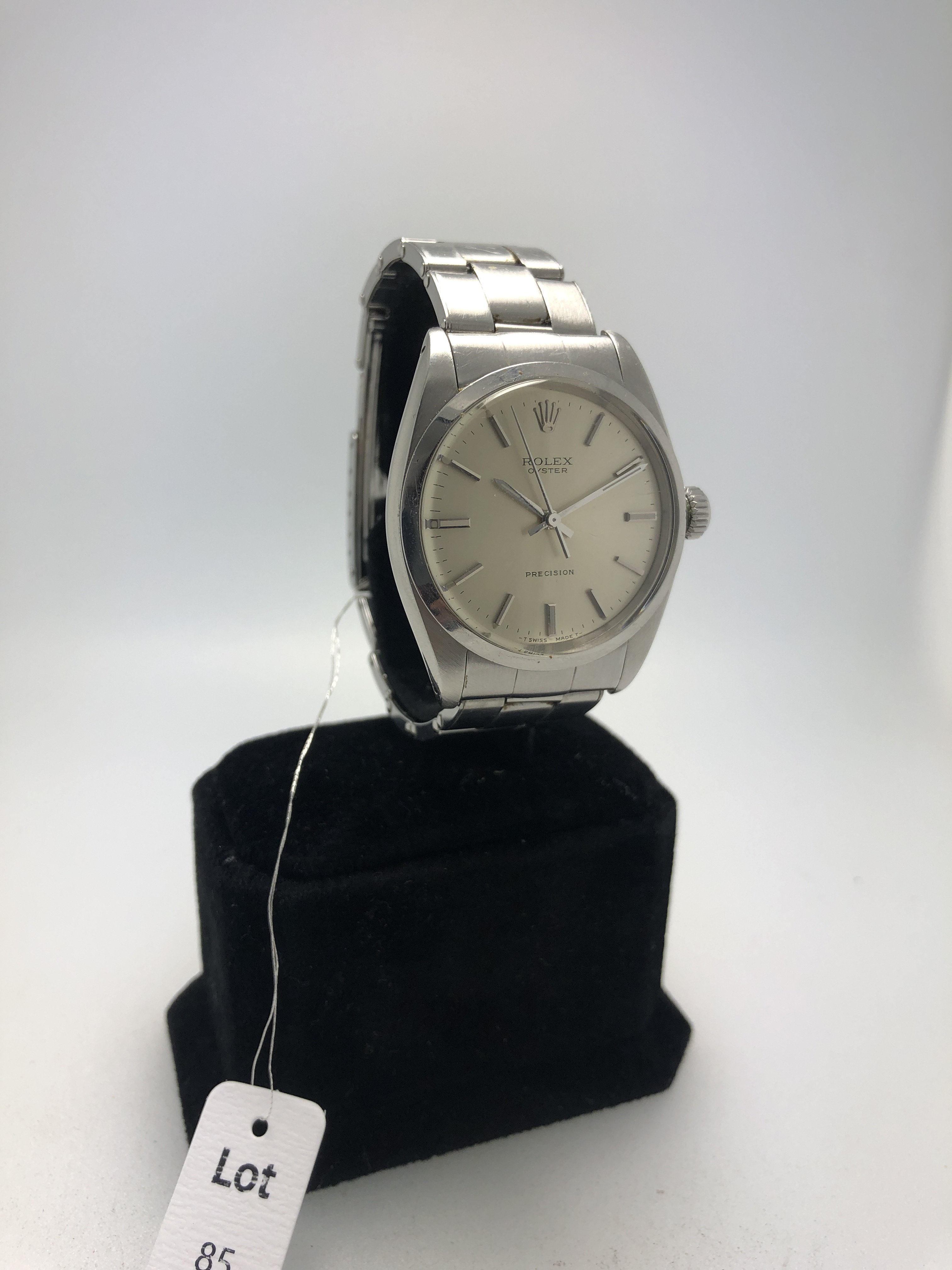

It’s coming up for auction next week. They say the year is 1959. I’m wondering about the lume which looks quite new, and also the Swiss made text - should it not be Swiss?

Hands and dial are most likely service replacements. Is this a big oyster 36mm 6424? The hands look like airking hands post mid 60’s and are a bit short for the dial with perhaps a correct second hand.
