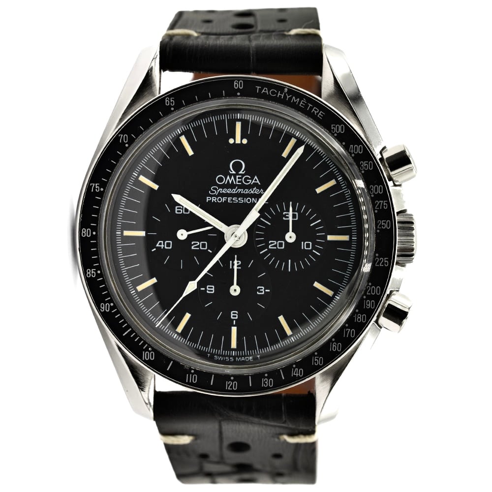

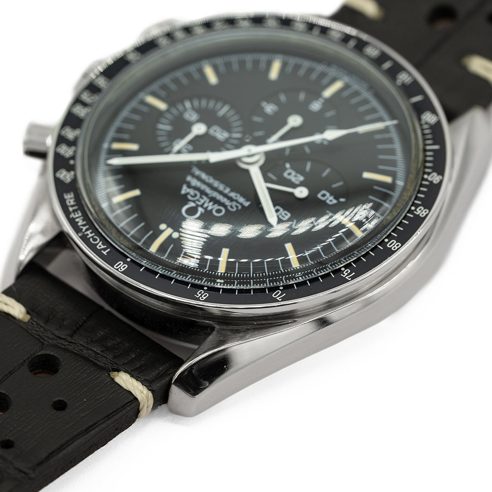

All, I would value your expertise here. I am looking at picking up my first Speedmaster and have come across the example below.
No box or papers - doesn’t bother me in the slightest, but it does make pinpointing this watch trickier than I anticipated. A few questions if I may:
- This is being sold as a 1990 145.022 but I believe this is actually a slightly later 3590…correct? Serial begins with 48.
- Hands are definitely a service replacement with SuperLuminova. Bezel has an accent above the ‘e’ - this must therefore also be a later service replacement, correct?
- Case has definitely been polished but it looks acceptable enough to me - thoughts?
Part of me thinks I should just spend the extra money and plump for a new 3861, but there’s something about the colour of the tritium lume that I can’t resist…
Thanks in advance.

That patina does look very nice. Not too dark, and just enough to give a unique vintage look. It's a shame that the hands are luminova replacements.

My (inexpert) thought - a 1996 3570.50, given the number. Be interested to hear from an authority.

Judging by the number, I’d go with 1997. Watch appears to be in a pretty nice state, although I do suspect you’re right concerning the hands being a service replacement.
Back to 1997 being the likely year of production; the bezel could actually be original.
Ultimately, the purchase decision would be down to (1) whether you like it and (2) wether the price is right. These are great entry level vintage Speedmasters and still comparatively easy to obtain, so I’d be picky. 😉

While the dial lume looks nice, the fact the hands were replaced ruins it for me. If you think you can live with the mismatch, then it looks nice otherwise. It I suspect you’d always wish you had matching hands.

Not sure if I read correctly, but if the serial starts with 48, it can even be a model from 1986 (31 Dec 1986 is 48221238). Now looking at the bezel it's probably from the 90's, but based on the serial, it could well be 1990.

See the caseback picture above, the full serial is visible, it is 48.37m which using www.Ilovemyspeedmaster.com does point to manufacture circa 1997, and supports the suggestion it could be an early 3570.50. The mismatch in hands and dial is unfortunate and would annoy me long term. Finding good sets of tritium hands is now tricky and expensive.

Thanks all for your expertise and wisdom - greatly appreciated. I’ve now seen pictures of the movement (serial matches up with the case) and it’s definitely an 1861 which means this must be mid 1990s (1996 onwards?).
The mismatch on the hands is unfortunate but isn’t a dealbreaker for me personally. 😀

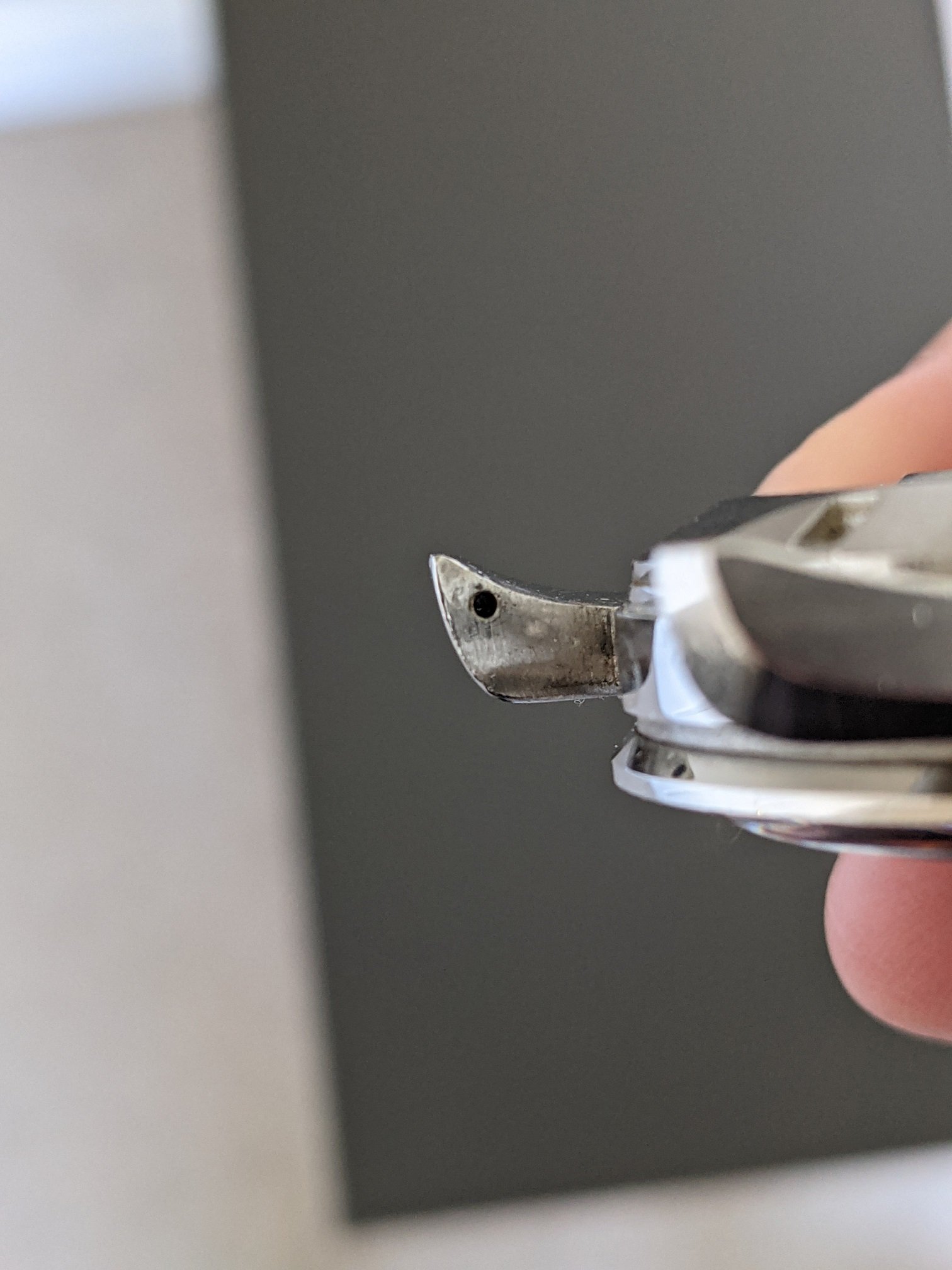

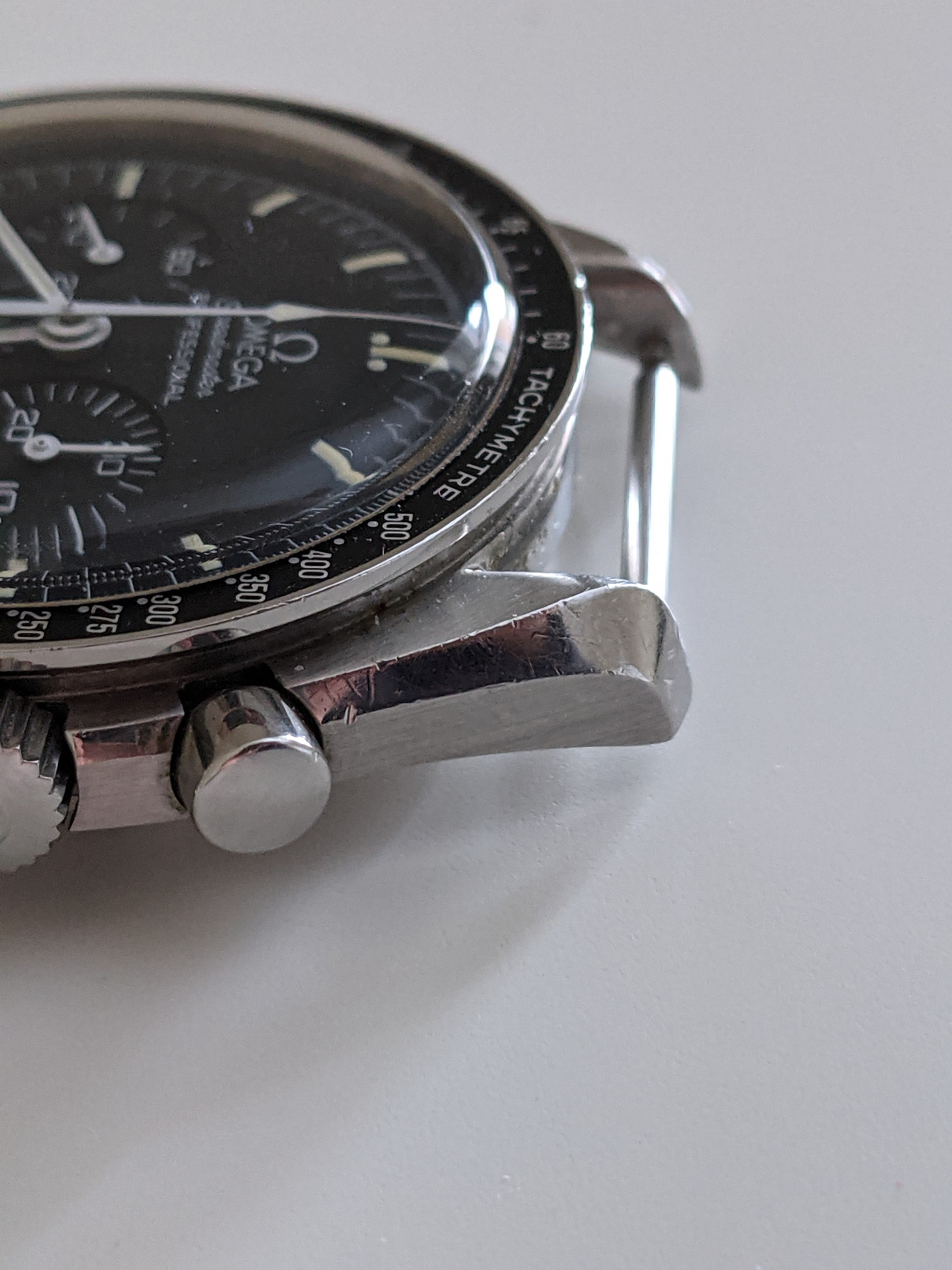

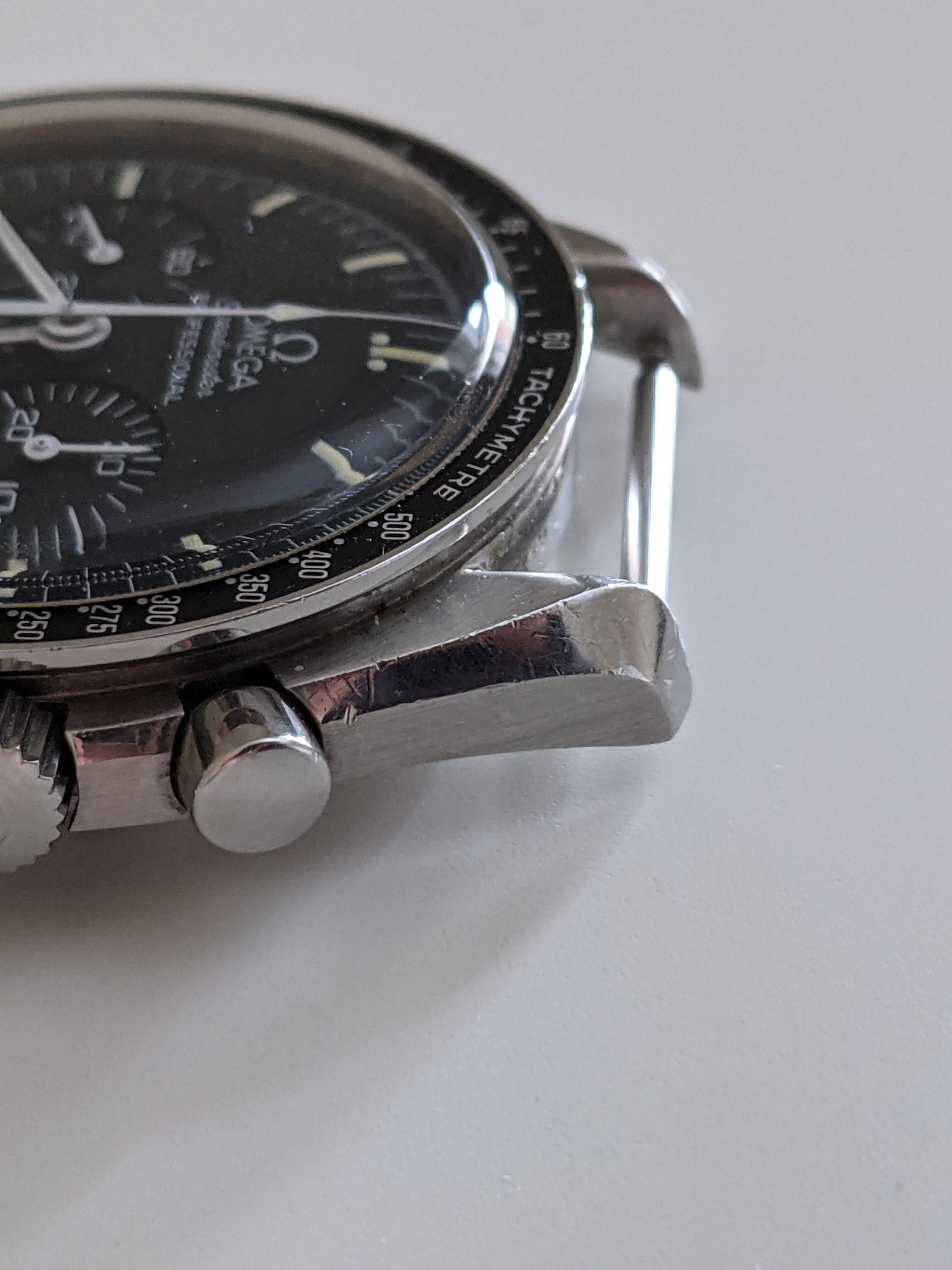

All, I purchased the watch and it arrived today. The dial is absolutely beautiful but there is one point of concern I have - one of the springbar lug holes looks quite close to the edge of the case, I’m guessing through a combination of enlargement over time and polishing.
Would this worry you enough to consider returning it?

What do the other holes look like for those of us who dont have a strapless Speedy on hand?
To my eye the overall look of the watch is good. The hands dont look too bad to me and if the price was right, it certainly wouldnt bother me. Ive seen far worse that is for sure.

The other holes are pretty close, but after looking at other examples of my watch online it seems many of them do sit very close.

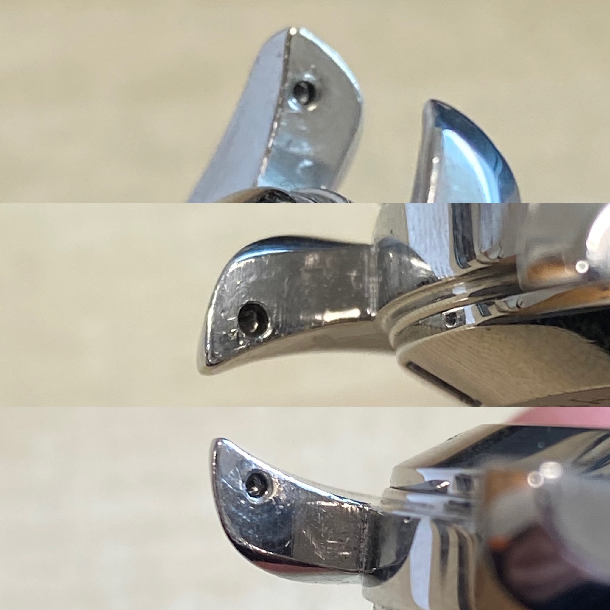

These are the other three holes:
270
674

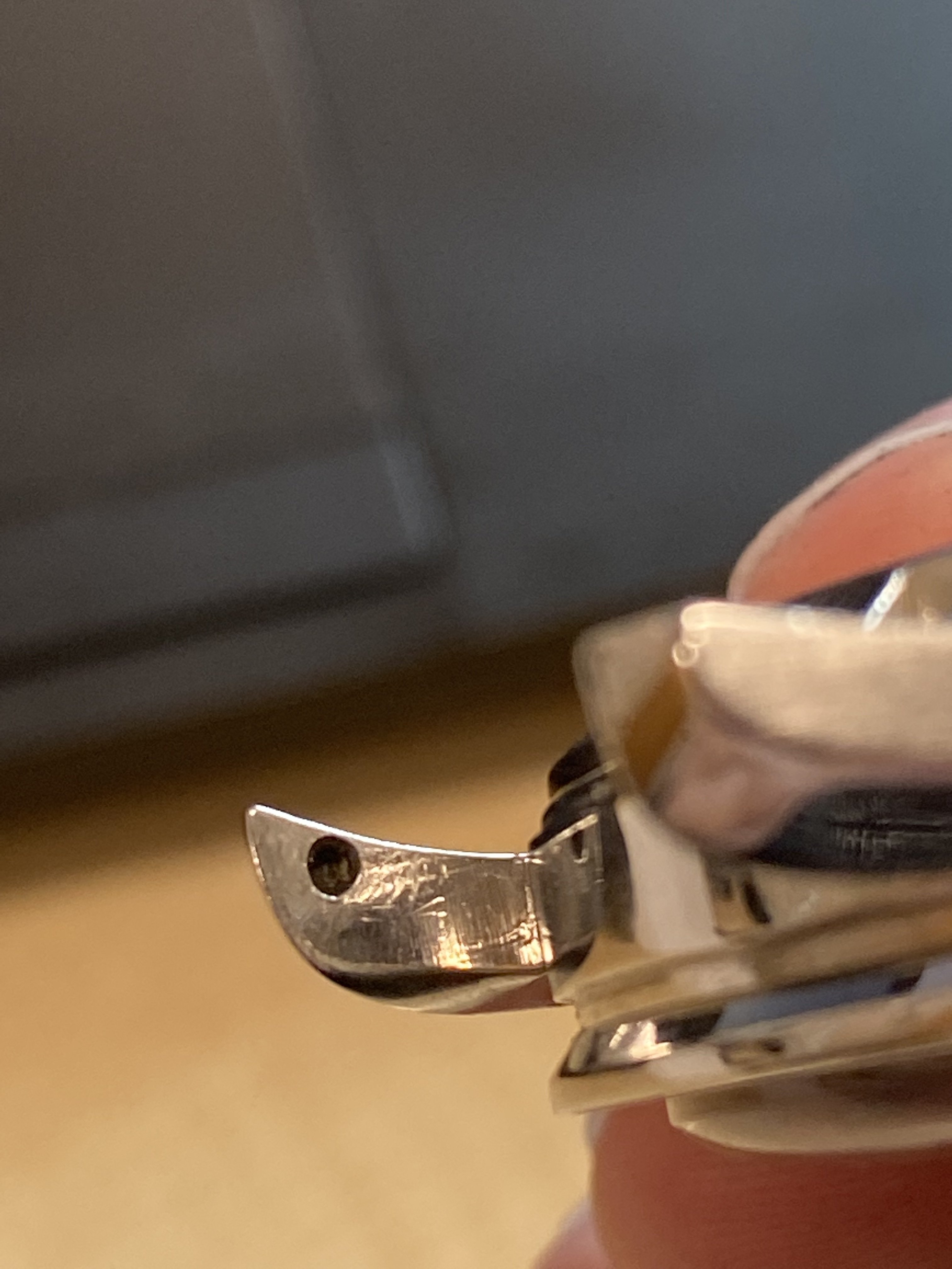

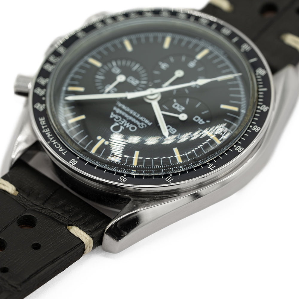

For reference, my circa 1993 3590.50:
Interesting - thanks. Yours do sit quite close to the edge too although clearly my case has taken quite a bit more polishing. Still not sure how to feel about this!

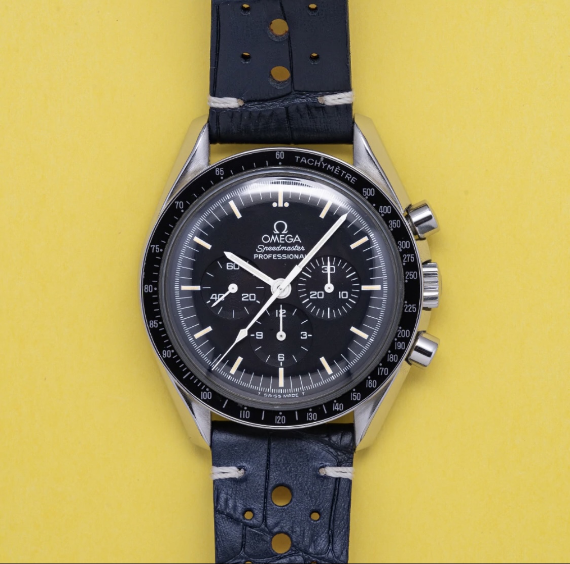

Mmm, yes it's a tricky one depending on how much it bothers you. I'm like you, I like the creamy lume and so I narrowed it down to the early 90s models and had to be patient. I guess for you it's a little more complicated as you were considering a brand new model, which I wasn't.
Just for further reference on mine I'll add a pic of the case profile. I don't know the history of it, I bought it around 6 months ago basically in 'as-found' condition no box or papers with little to no polishing and plenty of small nicks and nibbles here and there. Really it ticked all the boxes for me as I was happy to get an example that had seen use but what I think of as 'authentic' use; which is what I'm happy to buy in (what is to me still) a tool watch.
I'll be getting it a sympathetic service and clean at some stage - the money has had to go into one or two other non-watch things lately. In the meantime it has seen sparing use.

@bulldog77 thanks for your wisdom! Your watch looks absolutely beautiful.
I ultimately decided to return it to the dealer I purchased it from - it was a beautiful watch but I just felt like I’d never be happy with it, particularly for the money I paid. The case had definitely seen one too many polishes for my liking.
