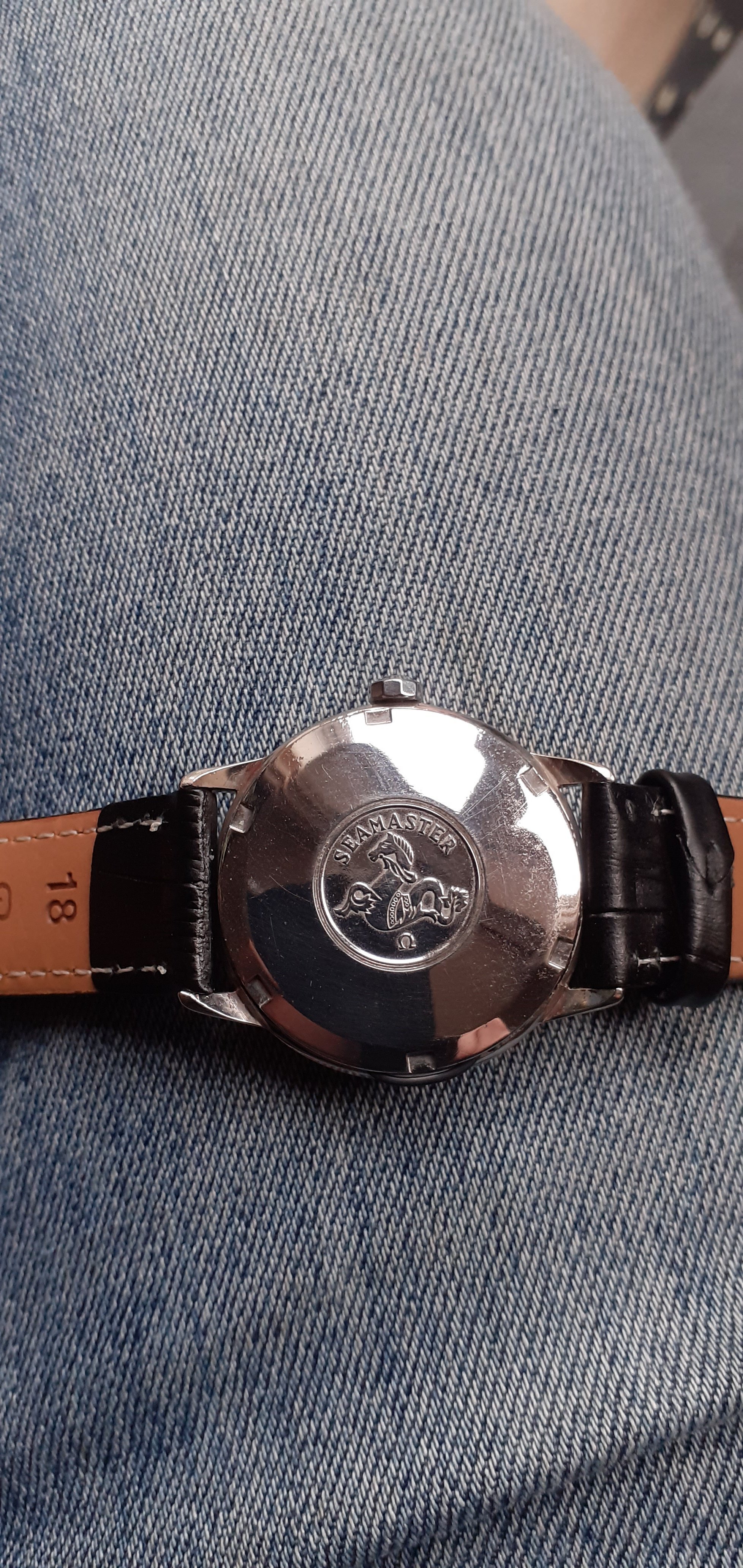

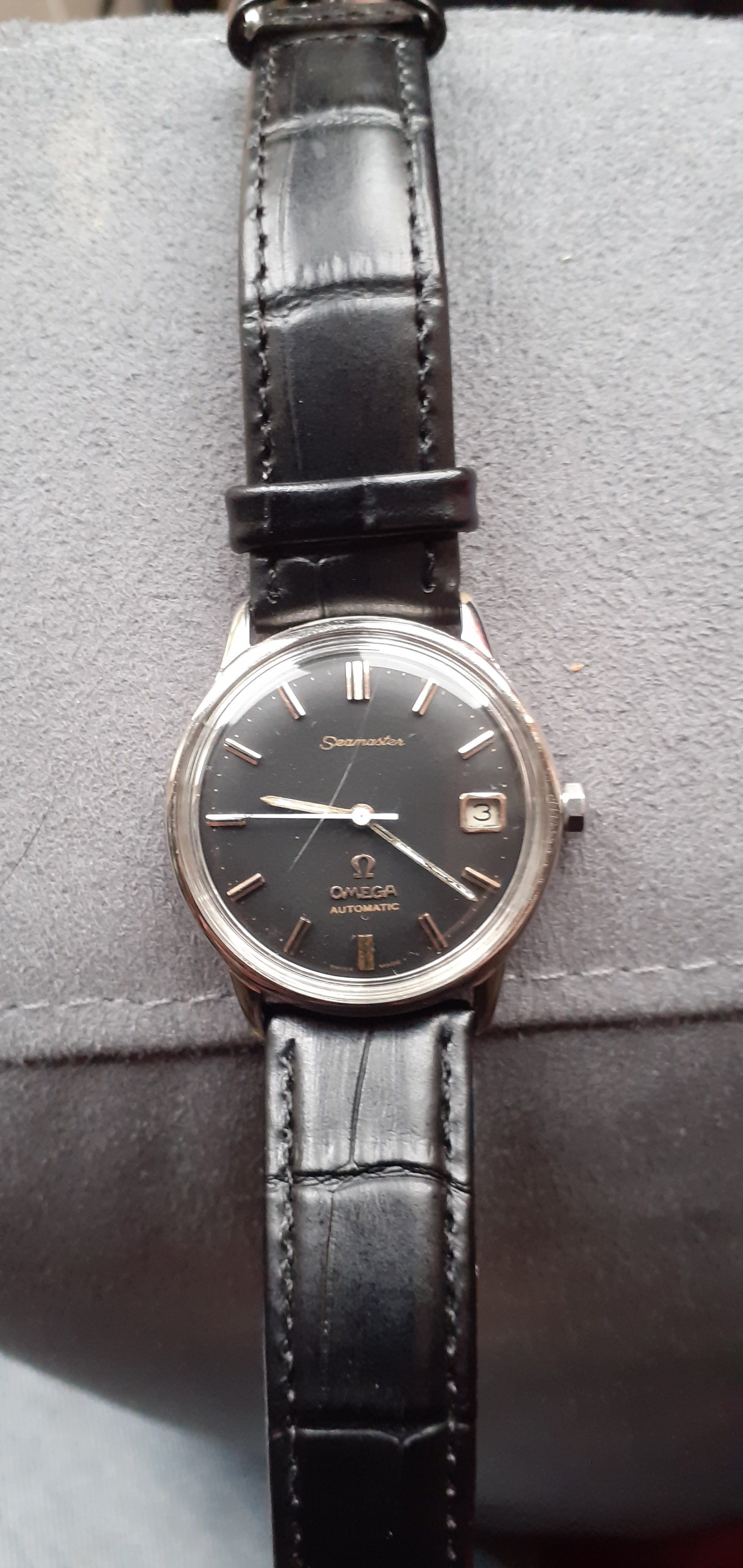

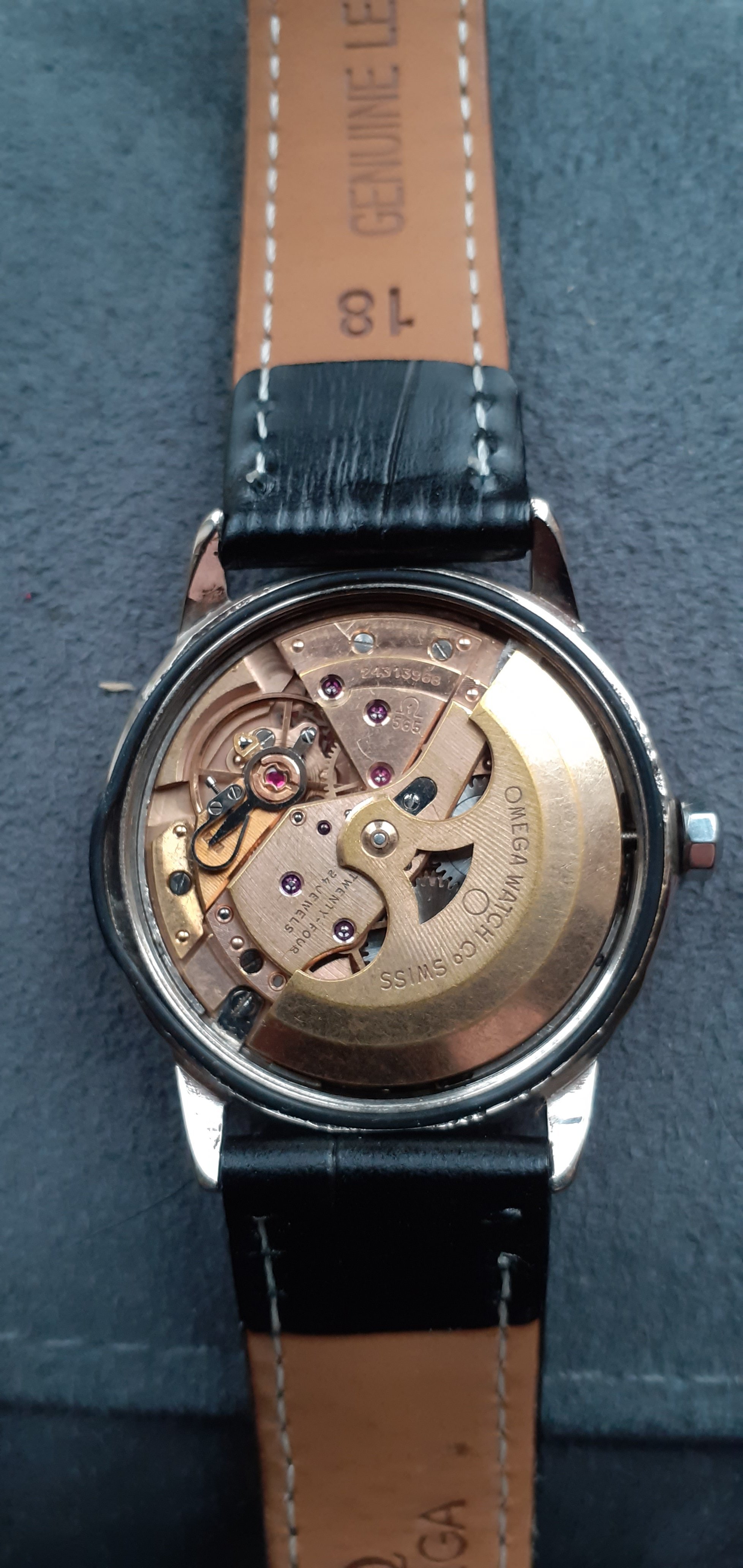

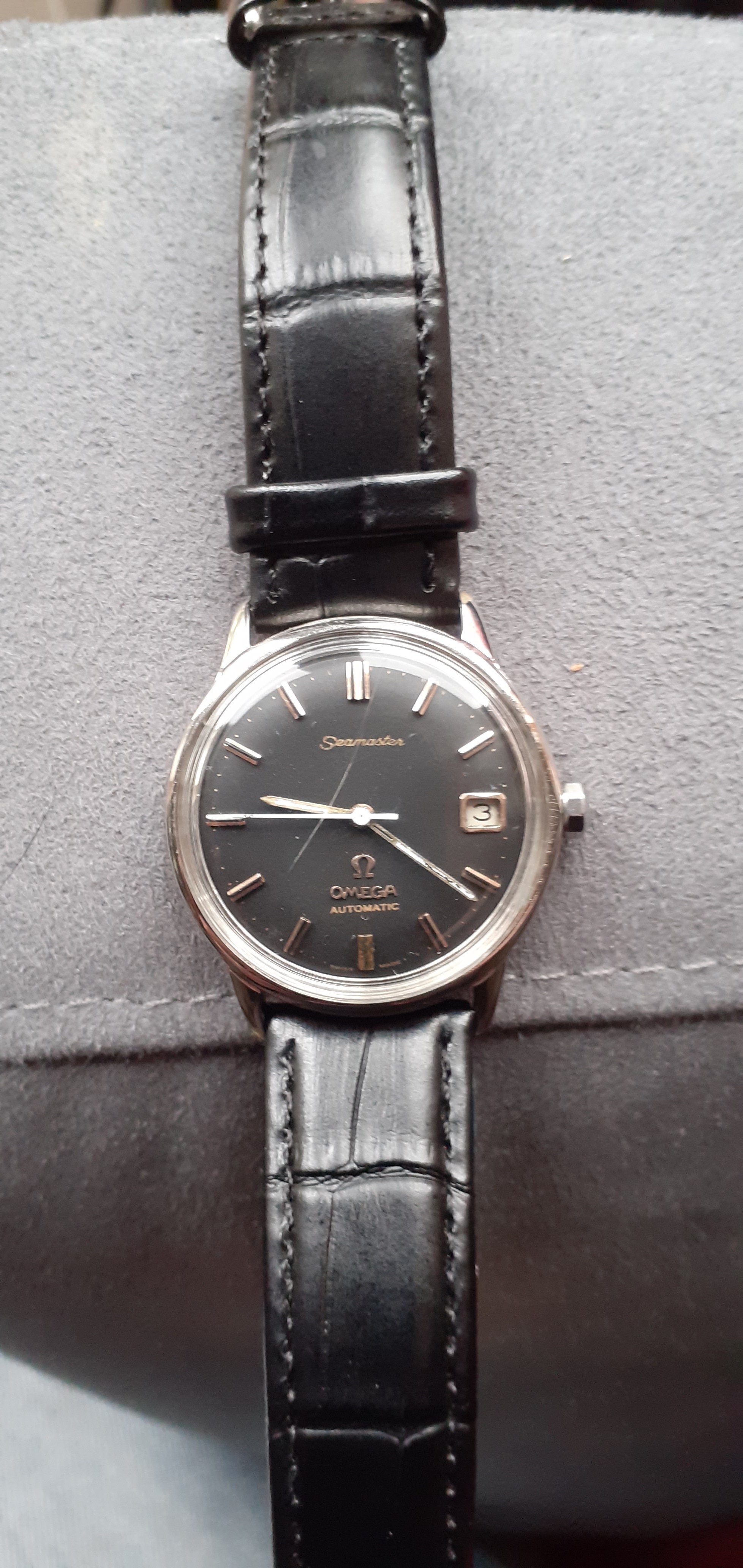

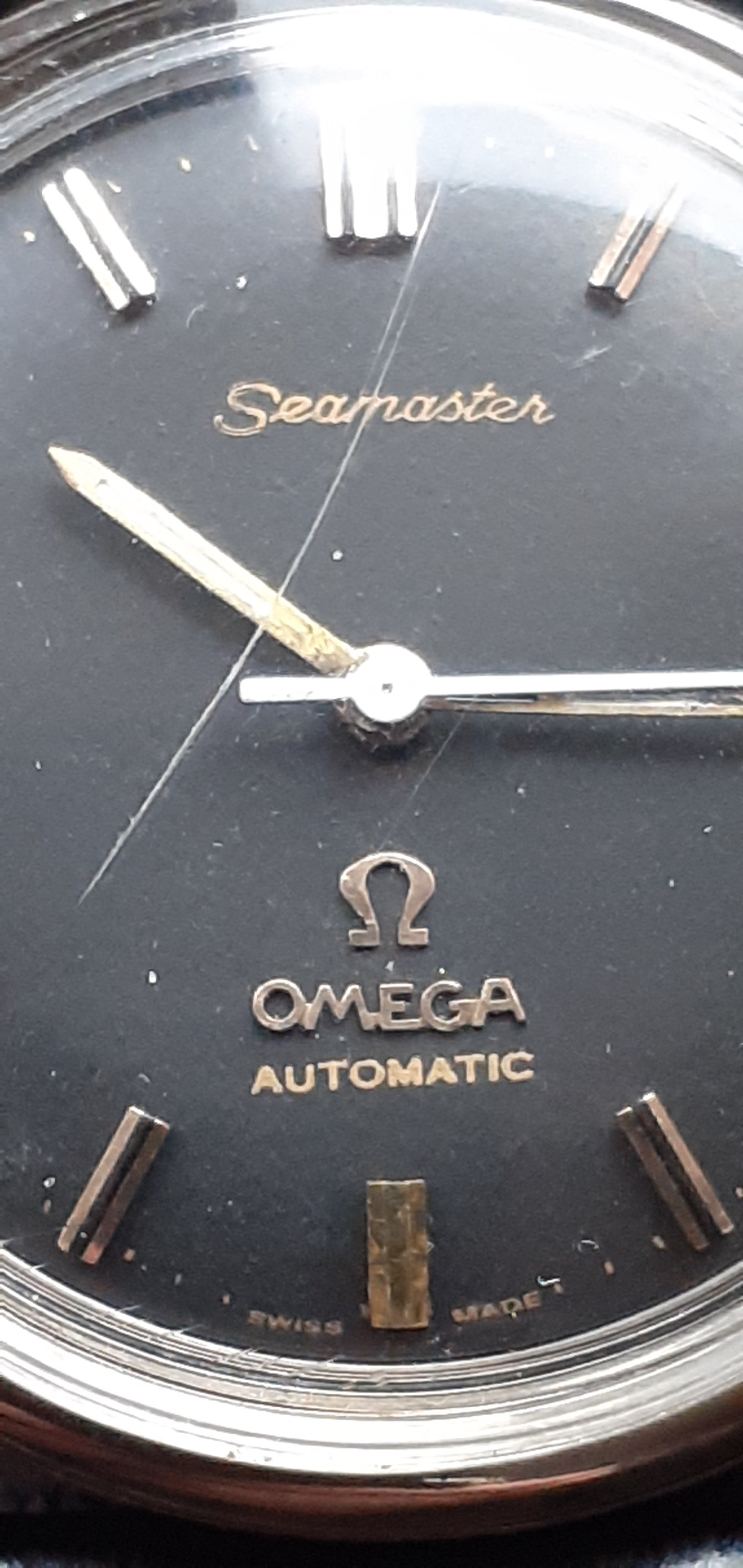

You have probably all heard this plea before and like a lot of newbie's I only thought of looking in the right place for information after purchasing. In my case my heart won out over my head and I bought the item below as have desired owning an Omega for years and this was in my price range (cheap).
What I would like opinions on is it a bad dial restoration or genuine.
I bought it because I thought the position of the logo was different, not realising how different until I was unable to find more than one other Omega with it at the 6 o'clock position.
Will still enjoy wearing it even if not gen', as can be seen by the scratch on the glass, my bad. I believe the movement and case to be good unless anyone tells me different.
any help is much appreciated.

A poor redial. Sorry
But we all have a newbie tax watch. 馃槈
Kudos for starting with an Avatar and a bit about your watch.
Plenty here will help you with your future Nice looking next piece if you ask us before.
13,491
31,809
Sorry but a really bad redial.

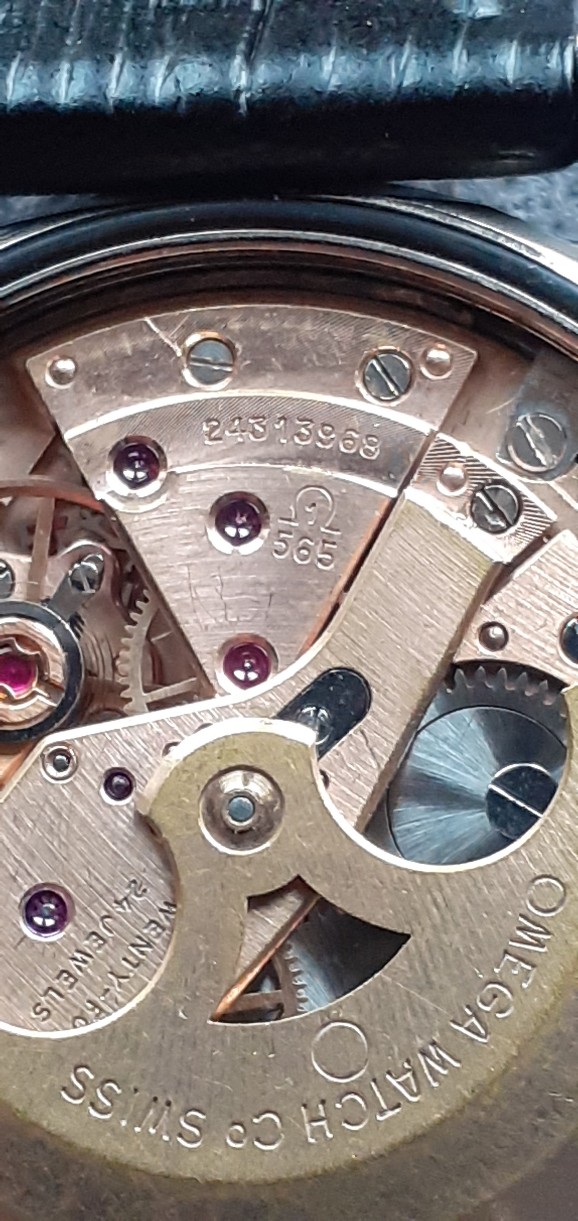

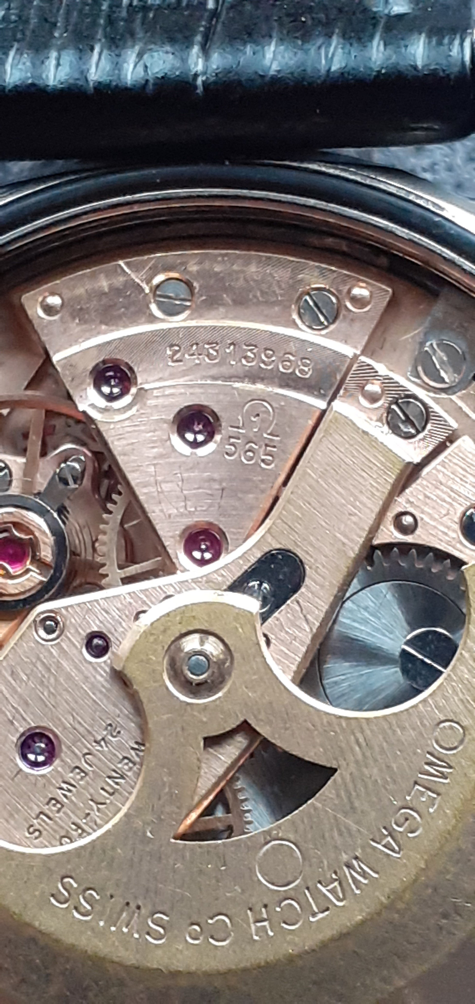

Incorrect movement as well, the case is supposed to have a NO date movement.
Crown is incorrect as well and the case is very badly worn/polished.
Can you return it and start over?

Thanks for the quick replies, much appreciated.
You have all confirmed what I thought and then some.
@X350 XJR As I am just starting out on the journey I am curious to know how you could tell the movement is in the wrong case. Is it what I have heard called a Frankenstein piece?
@STANDY thanks for the advice I will most certainly be asking everyone's opinion in future.
Will not be returning it as some lessons are hard learned and as mentioned I did not pay a fortune.
I hope to go on a BHS coarse on watch servicing and repair when a spot becomes available as want something to do during retirement and have always been fascinated with mechanical watches. Will probably use it as a project/restoration depending on cost of vending parts 馃榾
thanks again.

Rule of thumb is that vintage black dials require extra care. It must be something with the lacquer they used but they're never in good shape and 90% are redials.

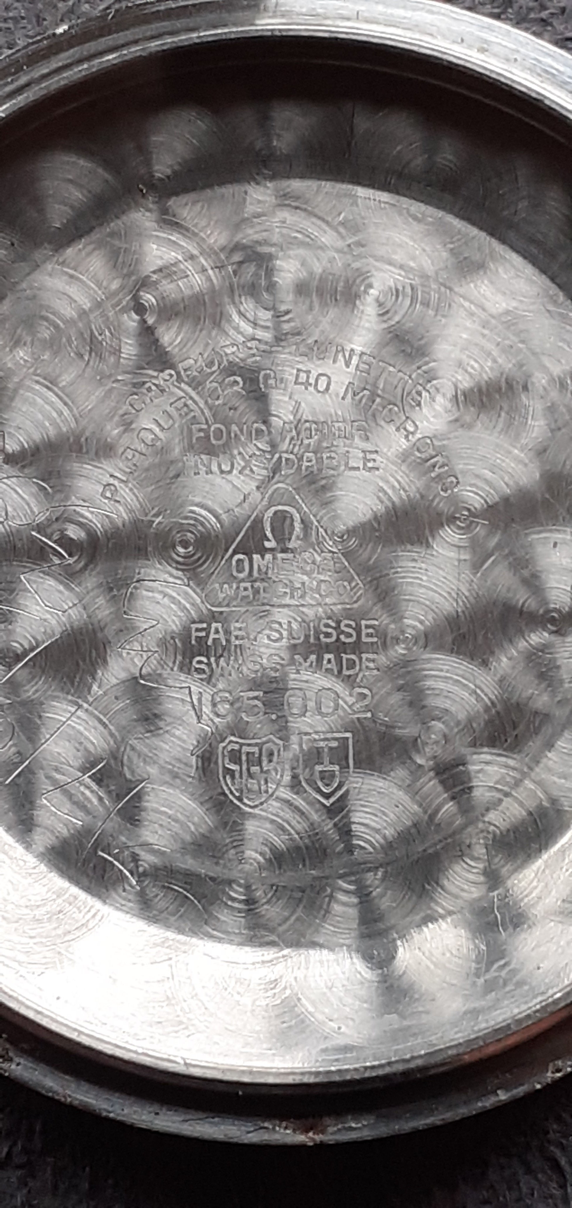

In the case of your 165.002, the reference pictures I found shows it without the date. So having a 565 movement (non-chronometer movement with date) won't be the correct movement for the 165.002. If you look at other 165.002, you'll see how different yours is compared to others (lugs, crown, dial, etc.).
Omega picture of 165.002: Vintage Watch: Seamaster OMEGA ST 165.0002 | OMEGA US庐 (omegawatches.com)
Chrono24 pictures from other sellers of 165.002: Omega Seamaster 165.002 | Ref. 165.002 Watches on Chrono24

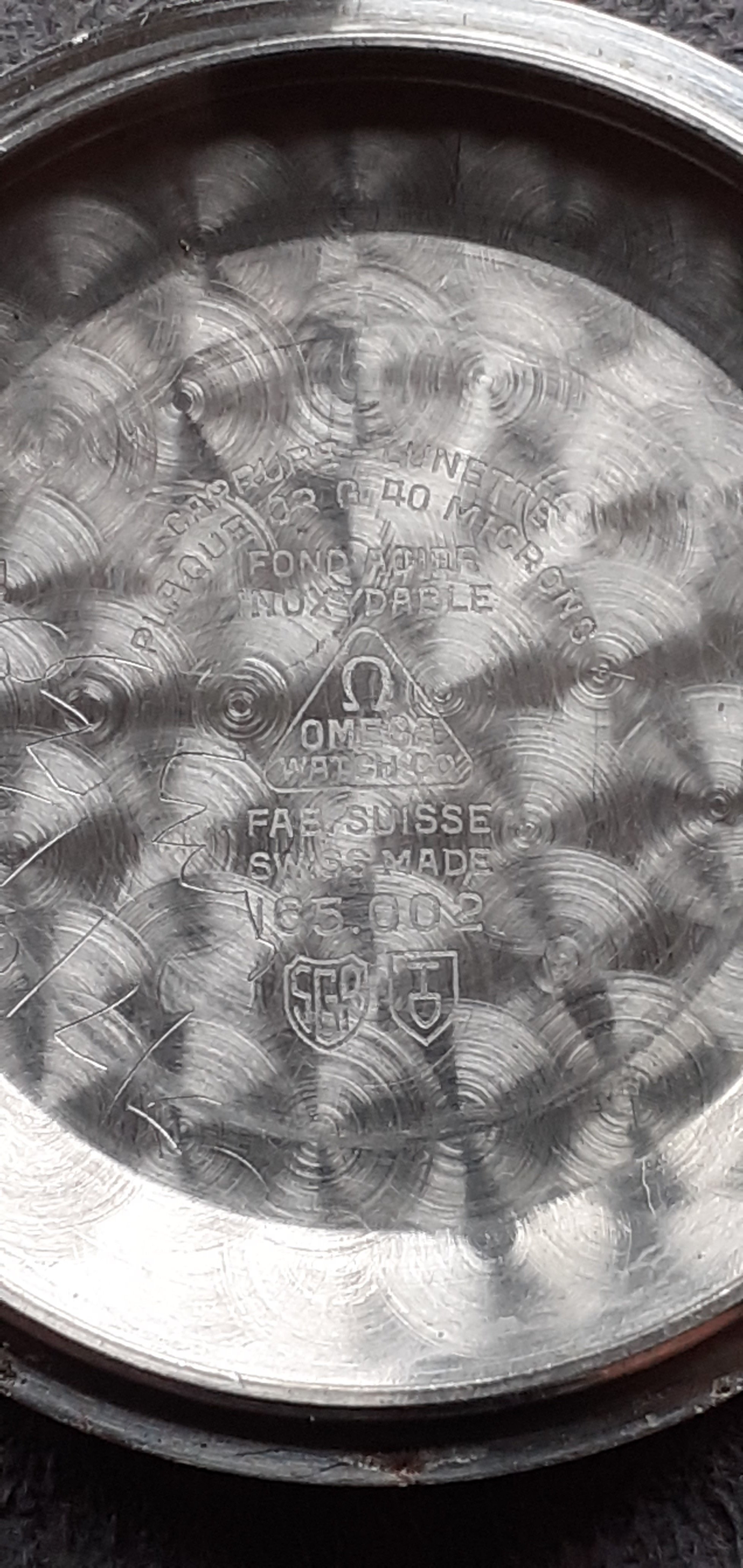

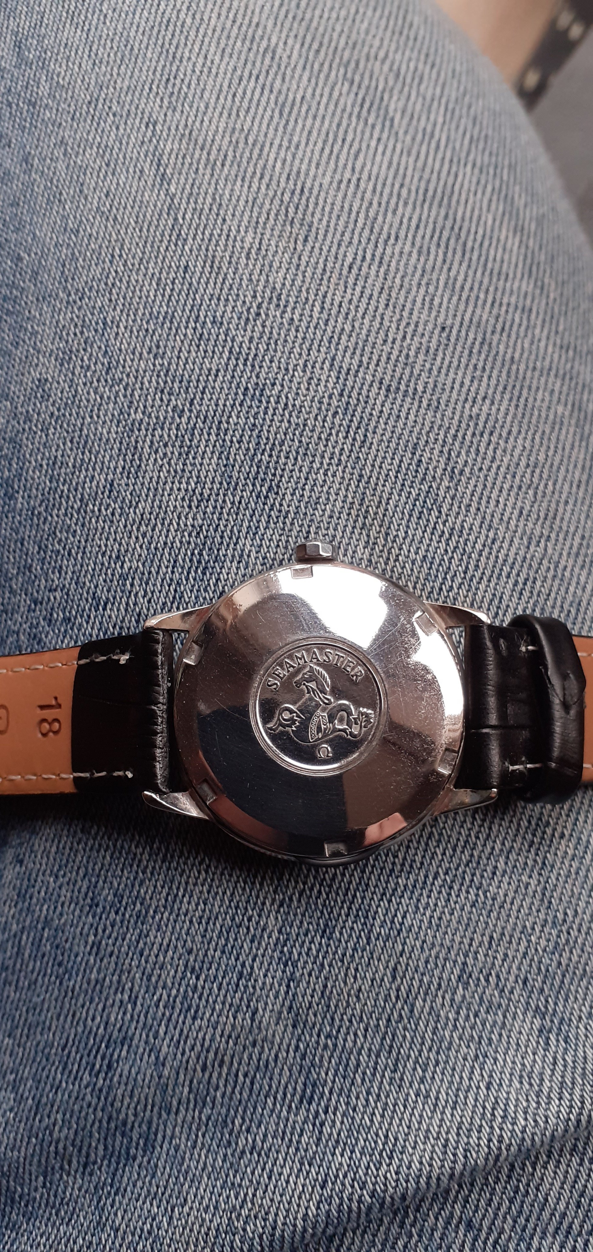

The reference number marked inside the case back, in this case, 165.002 tells us the movement should be a caliber 552 24-jewel or 550 17-jewel (US market) movement.
Yes, also sometimes referred to as a "bitsa" bits of this and bits of that. Would also appear that the movement has been put together from random parts as well. Note how the rotor is of a different color than the other parts, probably switched out from another watch to cure a worn rotor bushing which is evidenced by rub marks inside the back.

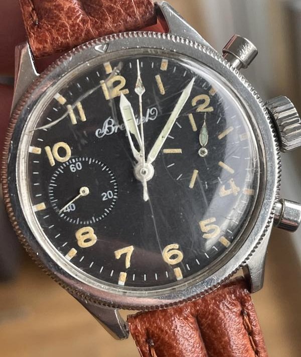

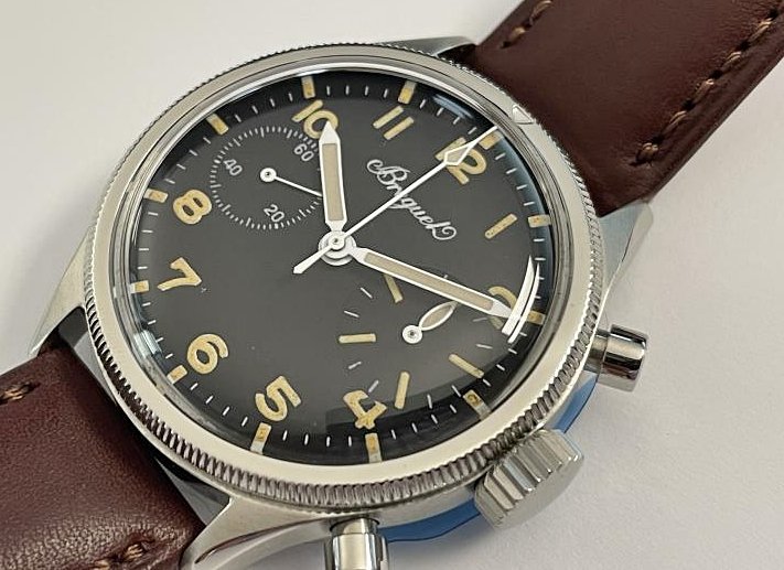

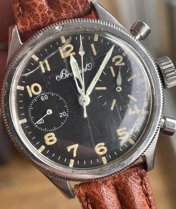

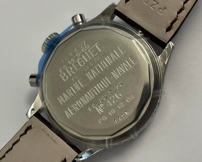

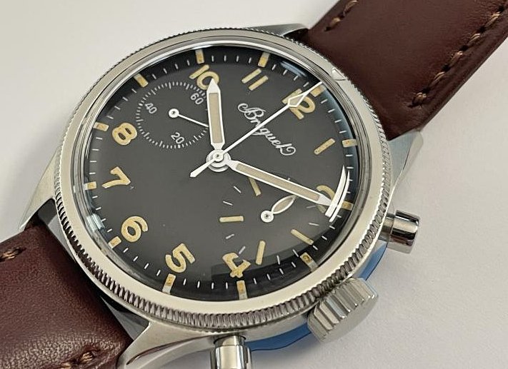

Thirty years ago, it was also preferable to repaint the dial.

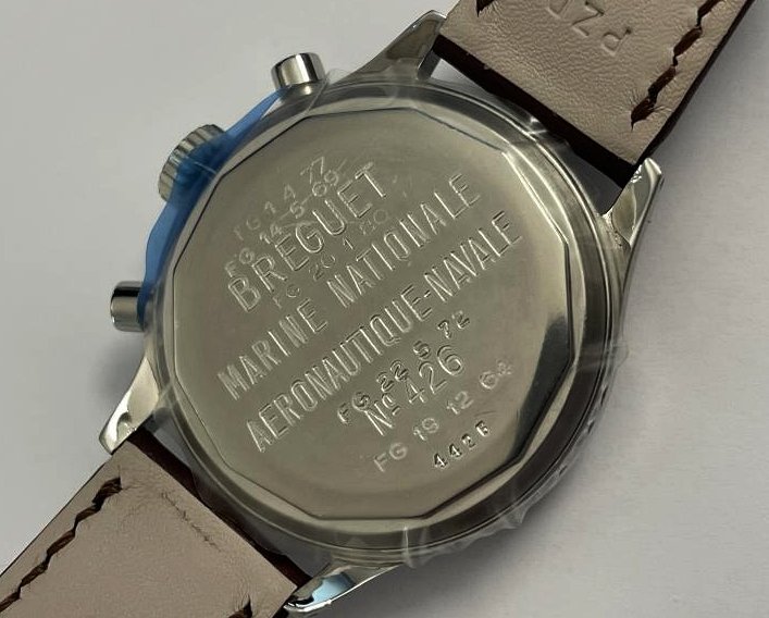

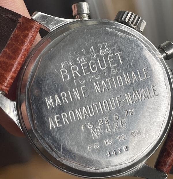

Not only dials but also hands. This is a rare watch DESTROYED by Breguet! (my2cents)
before: "overall patina with radium" IMO original later hands relumed with ???
after: polished to "new" and with SL (OK, due to silly regulations)
price : 4500 Euro for this "service" by Breguet (in the "Apprentice Department"?)
