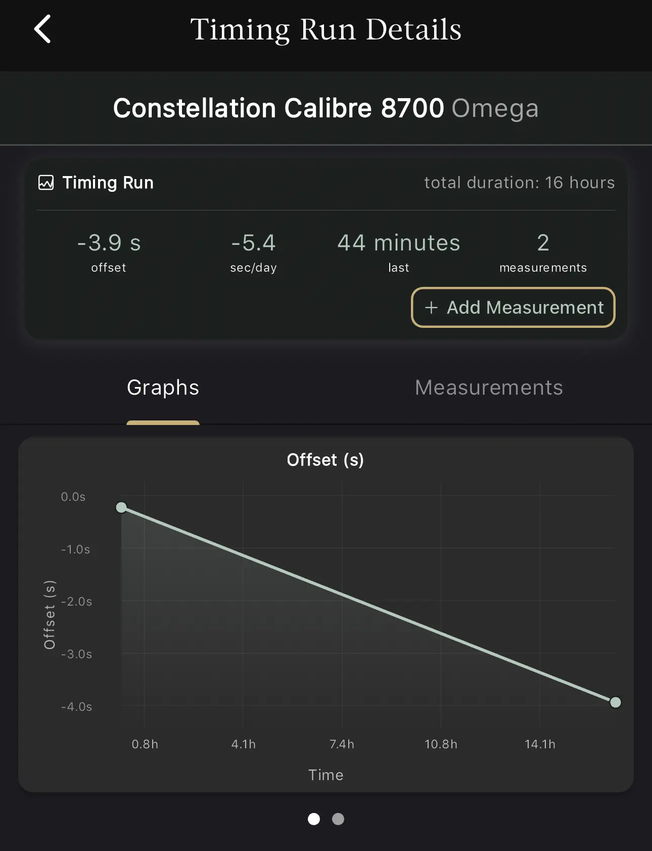

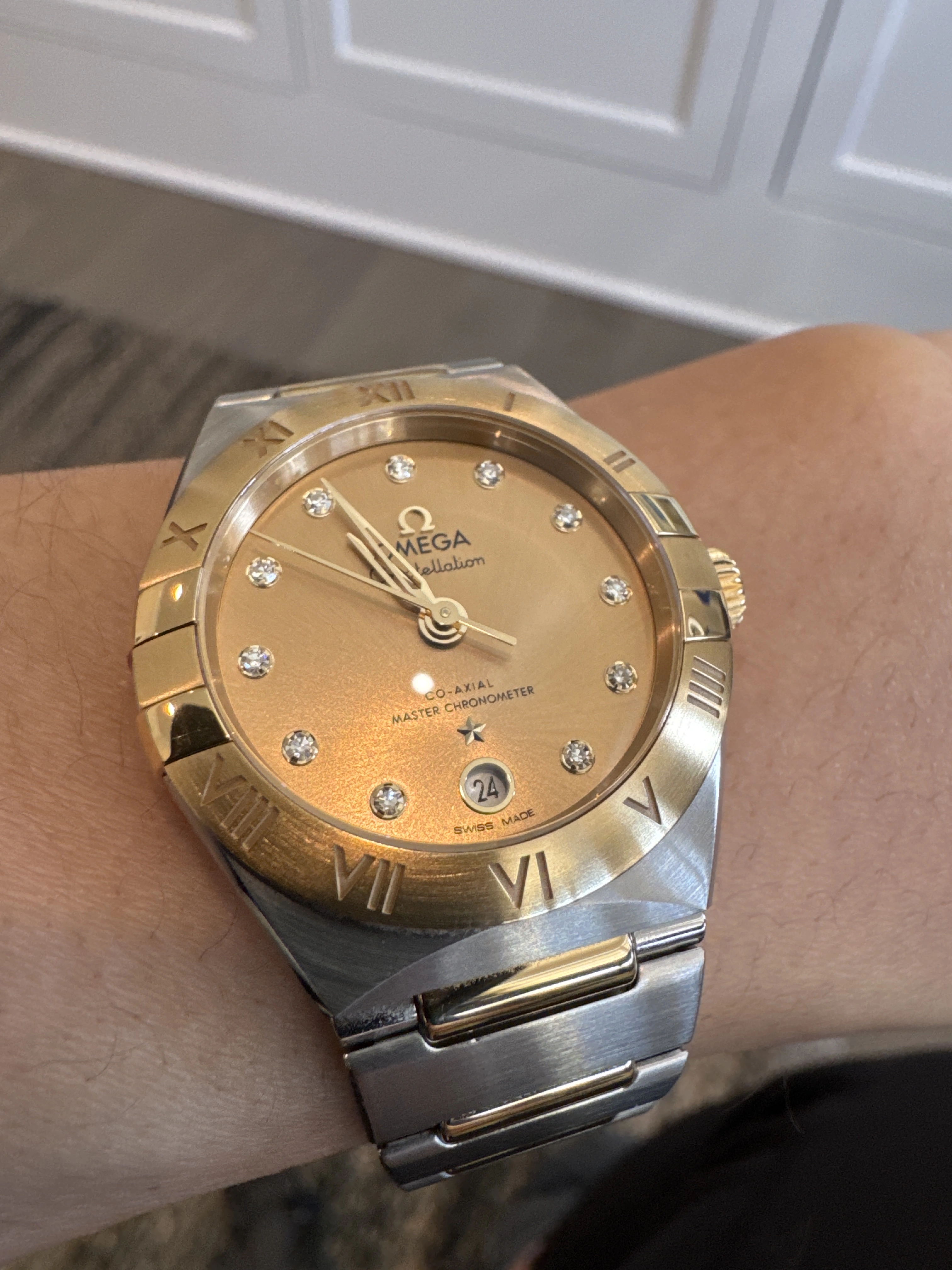

Hi all! I’m new to owning an omega watch. An anniversary gift from 2022 in Europe. Constellation with Co-Axial Master Chronometer and Calibre 8700.
I don’t wear it everyday. Mostly for work or occasions and I take it off overnight when sleeping, showering, or during exercises. I think I generally take good care of it as I do with most jewelry items.. a few days ago I was helping my husband with muscle massage with a Theragun operating at 40Hz frequency and 16mm oscillation for about 15-20s. I didn’t realize I was wearing my omega watch until I was done operating the massage device and really regretted doing so since I learned the vibration could damage the motor. Since then I did some research and wanted to see if my timepiece is still fine and accurate.
I downloaded a clock sync app and timed it for the first time - once over about 6 hours during normal wrist wear and once last night with it dial up resting in a drawer for about 10 hours. Both times come down to about ~4-5s slower per day. I read this Calibre /Motor specs 0-+5s so -5spd is kinda bad. I also read this helpful article below but since both days and different positions resulted in the similar 5 seconds slower, should I be concerned or send it in early for service? Did I do timing correctly? Fyi I didn’t wind the watch just normal wear for two days.
Thanks for any advice you can offer!

Firstly, congratulations on owning such a beautiful watch!
My initial advice would be to stretch your timekeeping observations over a period of days -- let's say up to a week -- before coming to a conclusion on how your watch may be performing. My experience has been that on some days a watch seems out of spec, but over the longer-term, it is working as expected. Wearing the watch while holding a theragun may not be the best idea, but I can't imagine doing that would cause permanent damage.

Thank you! Are you suggesting timing the watch over a longer period of time - like a week to calculate the seconds per day deviation?

if you really want to do a test you could do a 6 day test. First day set the time, wind the watch fully, let it rest dial up for 24h, check the gain/loss (I use watchcheck app for Android) and repeat the next 5 days in the other Cosc positions. The average will tell you whether it runs to COSC/Metas spec.

If the average is still 4-5 seconds slower per day, would you suggest it’s a service/regulation worthy issue?

If so that looks like to be out of Metals spec so I would send it in for regulation/service. Is there factory warranty applicable?

Still timing the accuracy everyday— been about-5~-6spd across two days in 24hr intervals. I wear it during the day and rest it dial up overnight. I wind it 30-40 rounds before putting it away. My plan is to keep doing this for about a week and see how the accuracy deviates. If consistently -5spd I may live with it until closer to 4-5 year warranty limit time; if it worsens significantly I’ll send it in for service. As it’s a pretty new watch occasionally worn not sure I want to get it open just yet 🙁
