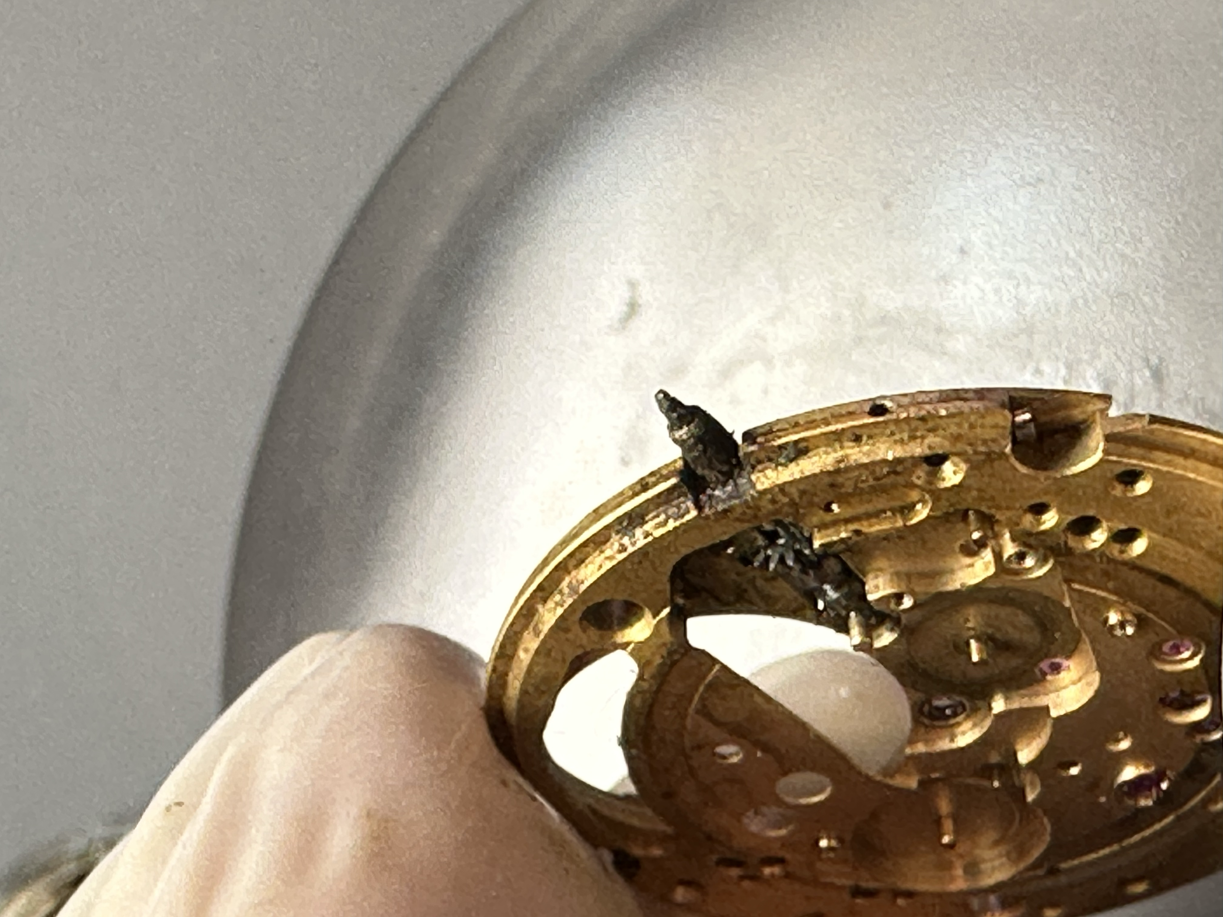

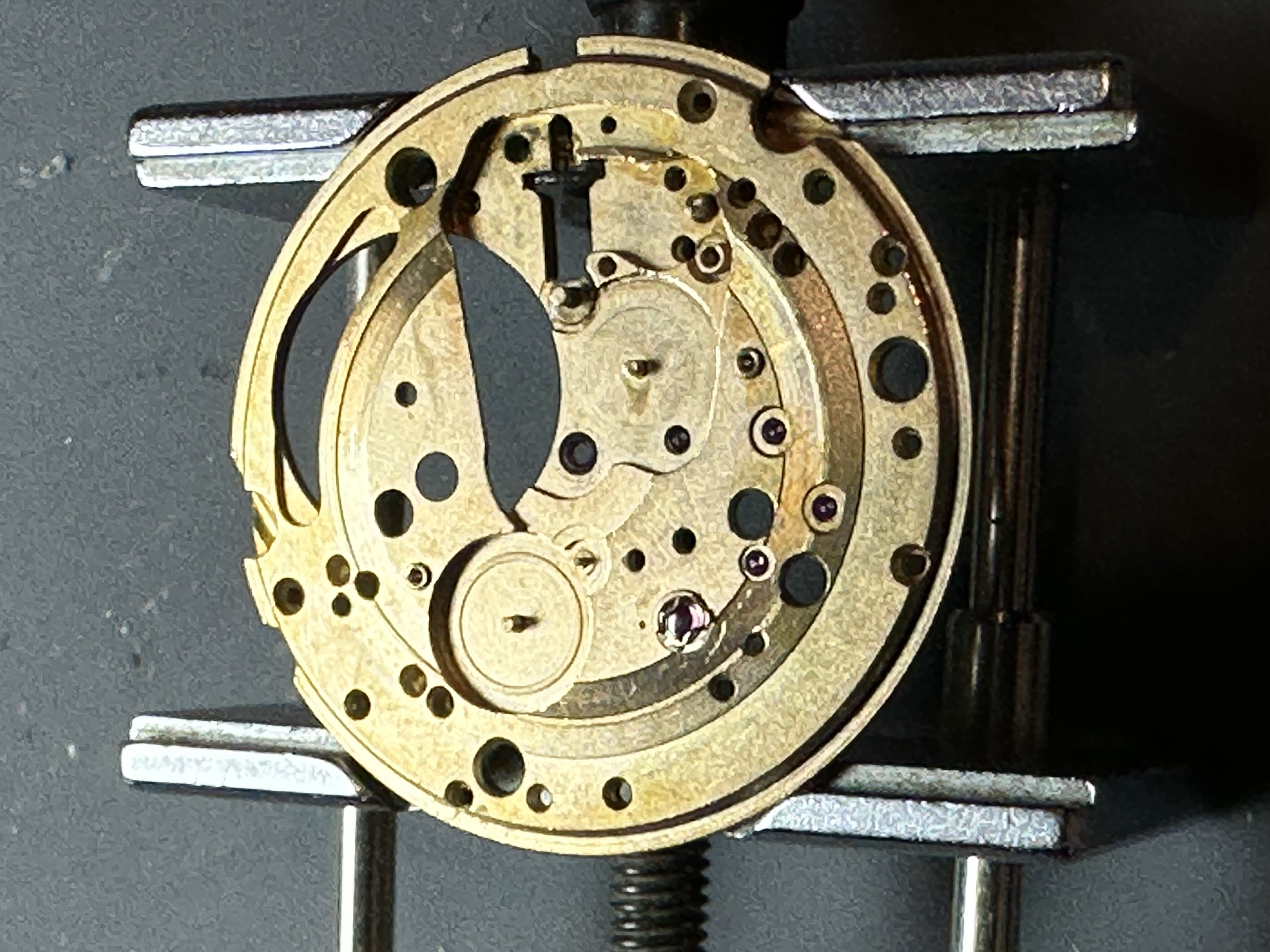

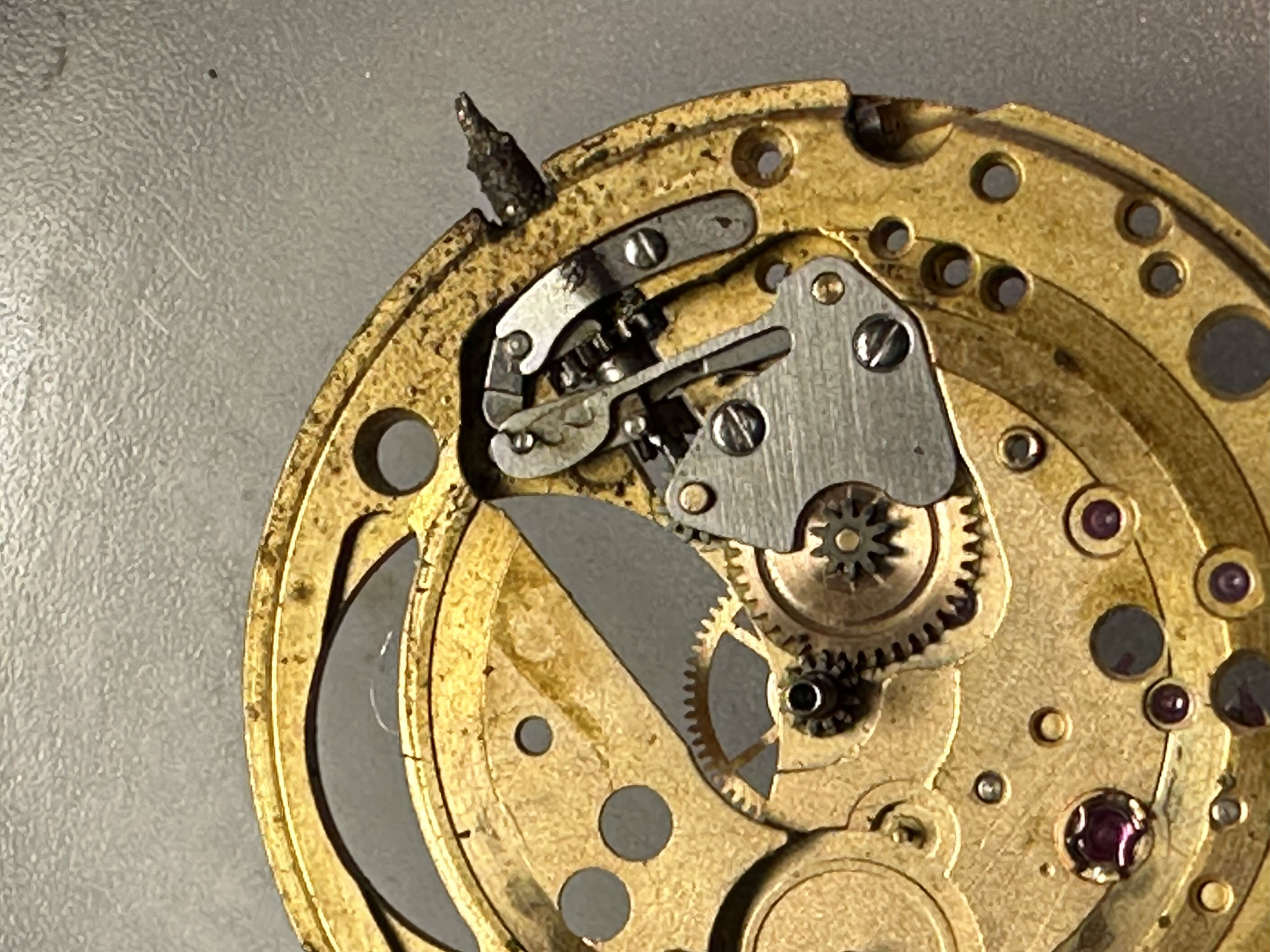

First off: Hi, I am an watch enthusiast from the Netherlands and new to this forum. Last week I bought a vintage Omega Geneve Automatic that was running (kind off) but look as if it as been buried for at lease twenty years.
The crown is missing and the stem was rusted stuck inside the watch case and even in the main platine.
Since it is a front-loader the stem is a split stem. I managed to remove the movement from the watch case but for this I had to remove the bus (is that a correct naming?) that makes the casing watertight. With a little patience and some drops WD40 I was able to the stem. Although the watch is in a horrible condition ( a lot of gunk inside) I am considering restore it to a good working condition and keep it. It all depends on the cost of some parts.

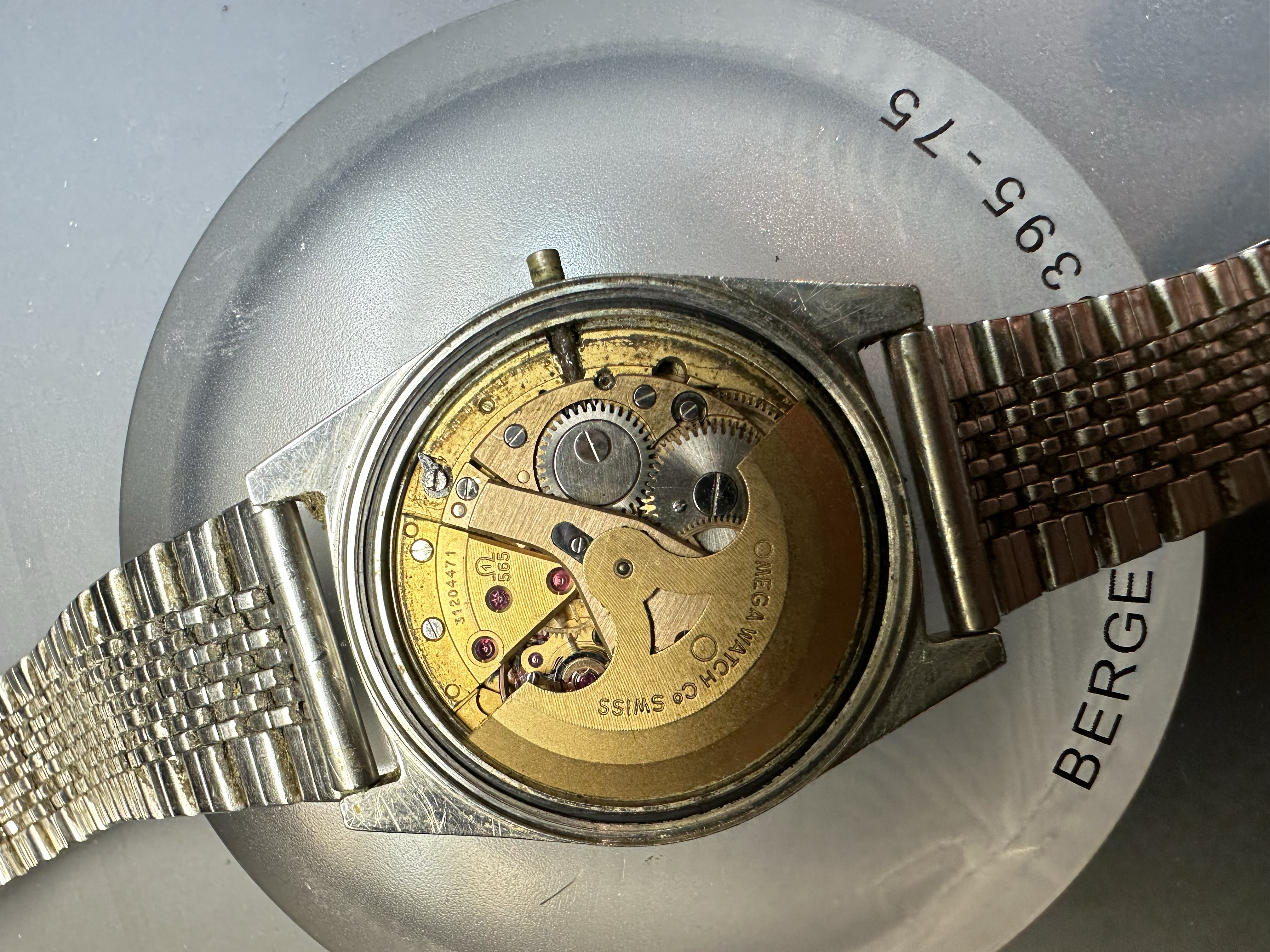

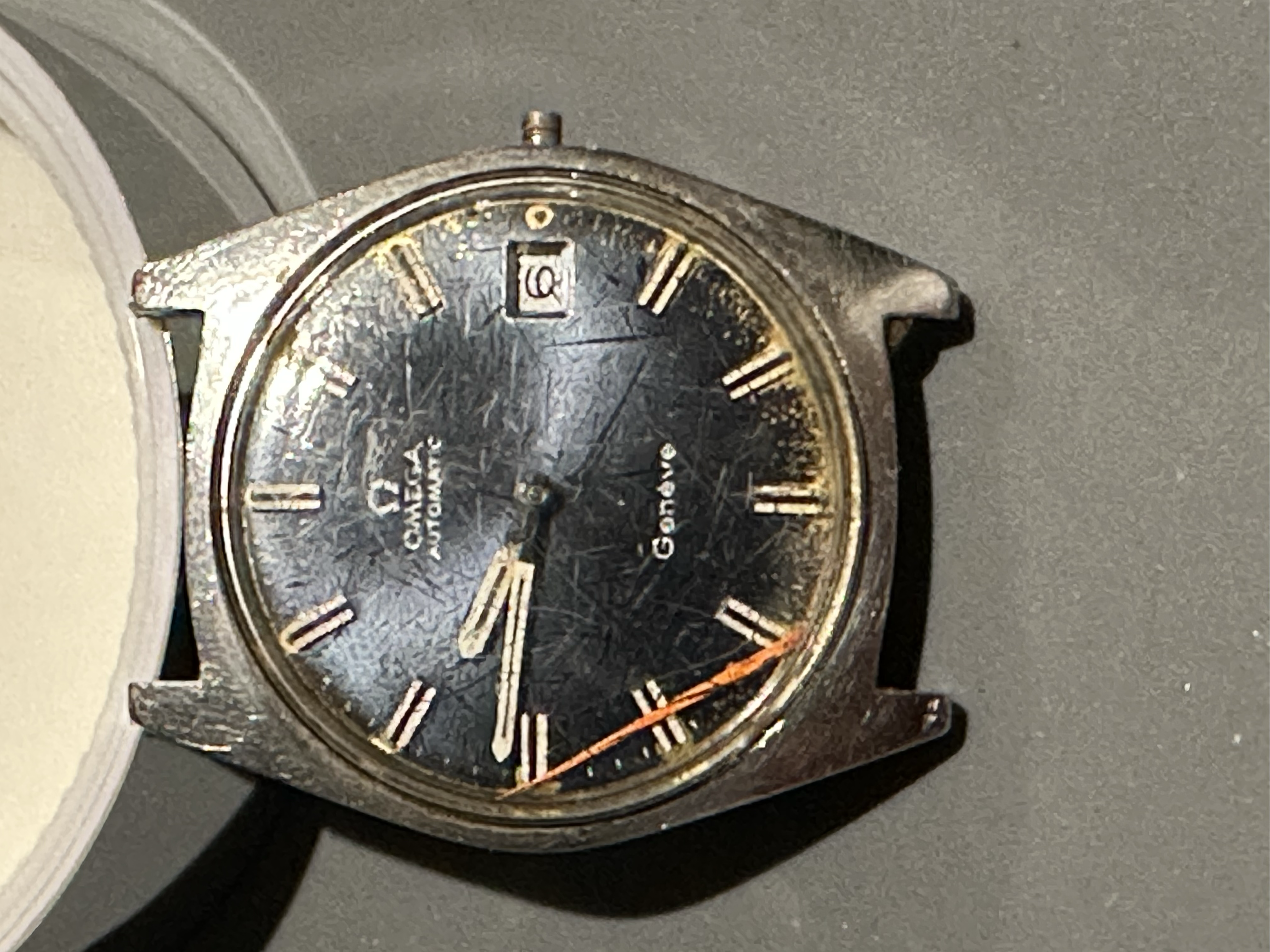

It's a 166.041 to my eyes, therefore not a front loader and no need for a split stem.
It could be saved, but it will be a draining project (on the wallet) unless that dial is pristine and worth saving the whole watch.
It doesn't look like a front-loader. Did you upload photos of the wrong watch?
And a regular stem for a cal 565 can easily be found on eBay for a relatively small amount. If you want to fiddle around with it and practice, this might be a good project. I don't think it'll be worth it financially, but that doesn't necessarily have to be the main motivation, of course.

Not a split stem, not a front loader either. You may want to leave this one to a competent watch guy...not sure it is really worth it considering the state of the dial though.

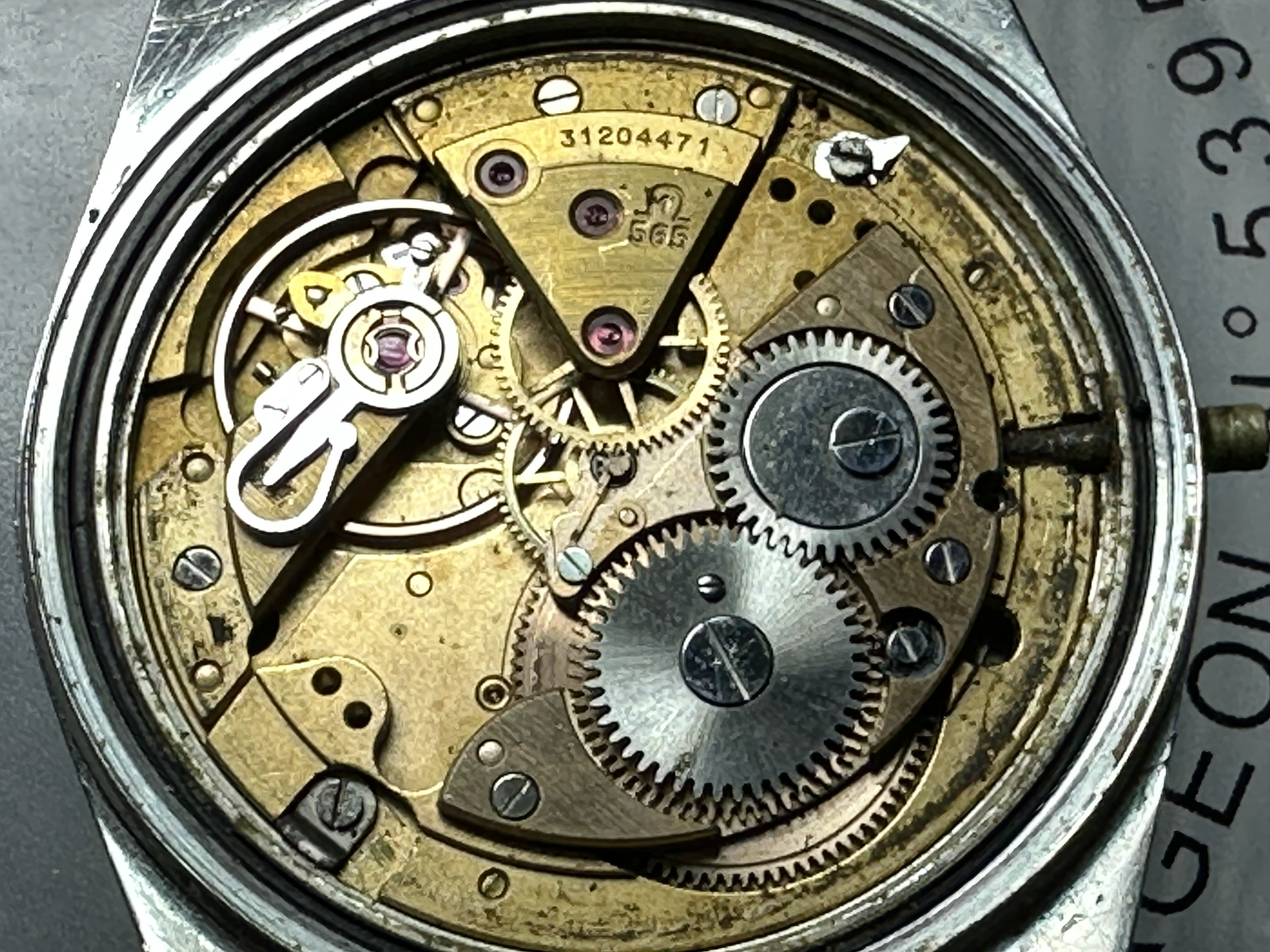

Other than the rusted out stem and one of the case clamps looking like its the wrong one for the case, this movement just looks dirty to me.
That the seconds hand is floating in the case it a little bit concerning, but especially since it sorta runs this one is likely salvageable.
Like other have said, more as an exercise in learning than as an exercise in money making.
These are wonderful movements to work on, and like janice&fred said, the parts that are immediately obvious as needing replacement shouldn't cost TOO much.

Okay, Thanks sofar for all the comments. To be short: There was a split stem. It was rusted. WD40 is NOT as abrasive as some of you guys think and it is quite commonly used, It works like a dream and it is cheap. As you can see, the dial has a lot of patina 😀 I like that on an old watch. The watch is a write off to many but not to me. I do this more often but yeah I am not a professional by any means. I just love to get this thing back on a wrist, not for the money but for the love of watches. It does not have to be pristine, I just want to save it as a watch. I already found the split stem and I have ordered a new glass. Total expenses sofar: about $25. Still looking for the tube and the crown though.
4
On the comment of Front loading: there was no way to remove the movement from the back since the stem was stuck as it was. Even with the bare plate (without the keyless works and all) the stem was still stuck. Removing the glass was an easy way to get the movement out and strip it bare. Although I already have a new split stem, I still consider using a normal stem instead if that is more original (I do not know this movement in this case). Most tools I have, but what I lack is a bit of knowledge and a lot of experience.
